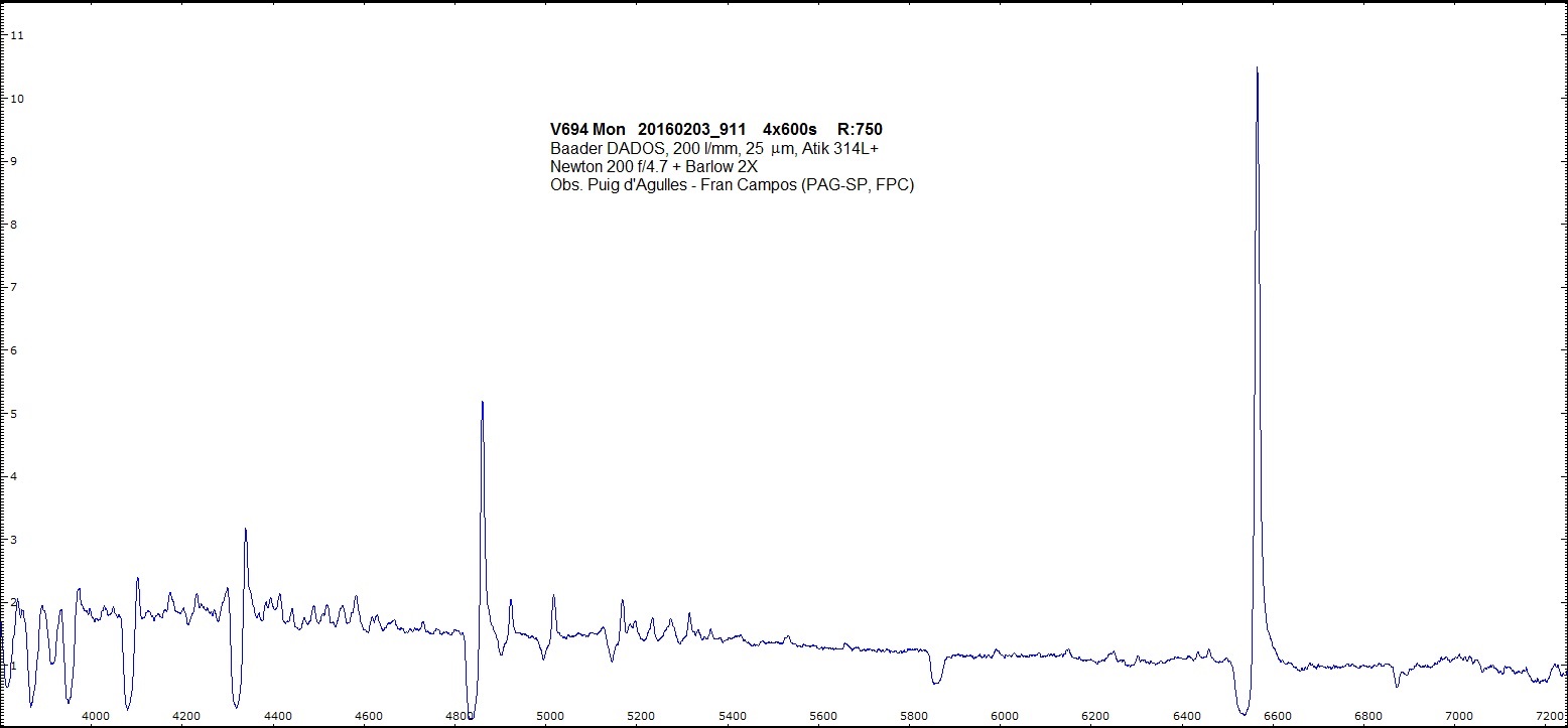

Francisco Campos
Posts: 88
Re: v694 Mon
Post by Francisco Campos »
the promised spectrum taken yesterday. The resolution is not as good as David one's (good job!), but happy to see how the DADOS works:
I have calculated Doppler shifts for the main Balmer bands, but my results are considerably lower than David one's: 1300-1600 km/s. Difficult to measure, due to the very broad absortion peak.
