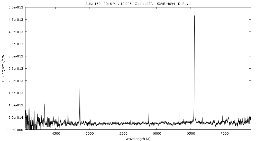

Here is a flux calibrated spectrum of StHa 169 taken last night 12th May. It was relatively faint at V=12.92, B-V=0.88. Unfortunately clouds stopped the run after only 25 mins so the result is quite noisy but the Balmer, He I and He II emission lines are clear.
Re: Symbiotic StHa 169 in outburst
Nice, despite the low SNR.

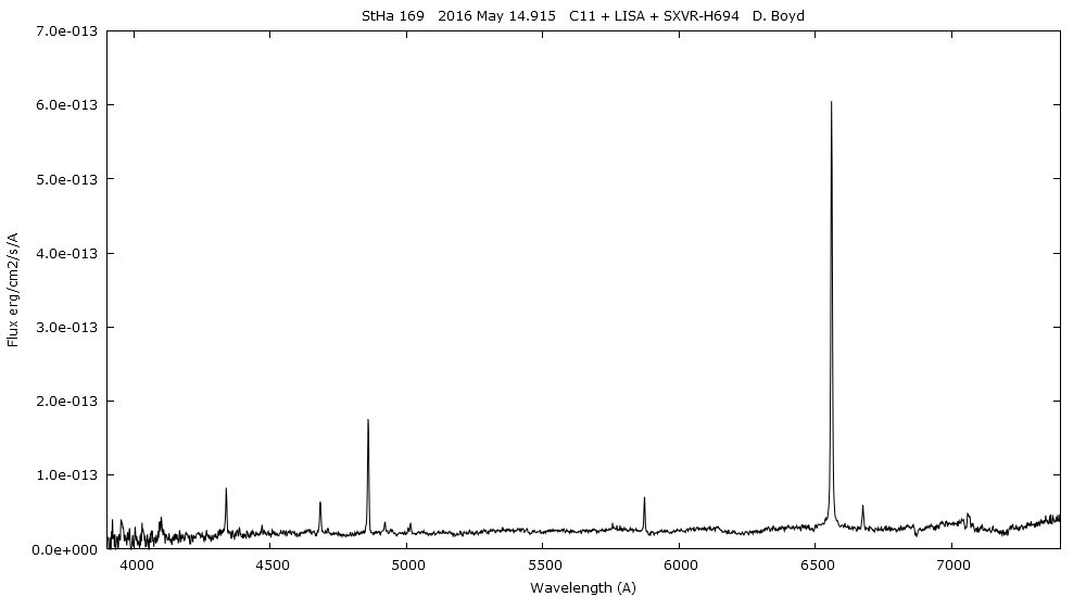

Post by David Boyd »
Here is another flux calibrated spectrum of the symbiotic star StHa 169 taken on 14th May. This was a 75 min run with improved SNR. The star has faded slightly to V=12.98. Measuring the spectrum with ISIS gives Hbeta flux as 9.9x10(-13) erg/cm2/sec and HeII 4686 flux as 3.2x10(-13) erg/cm2/sec. The Hβ/He II line ratio is 3.1.

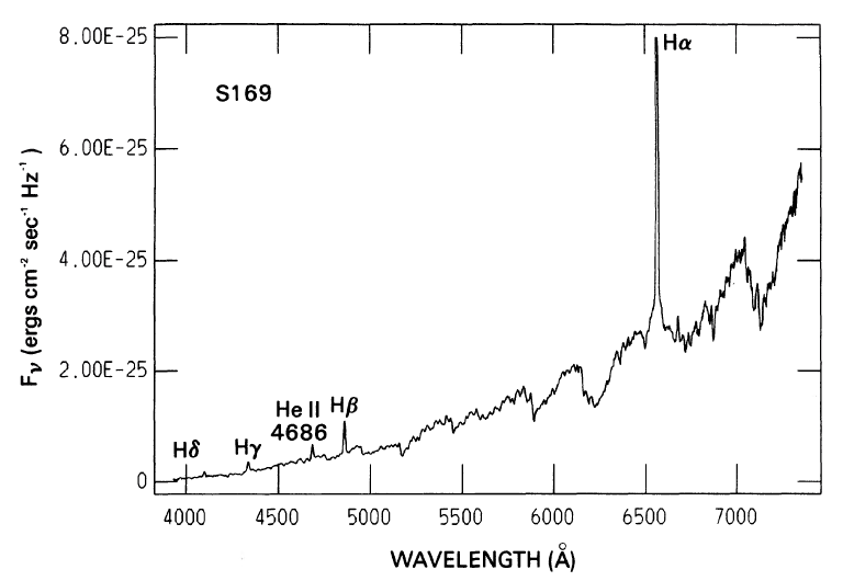

This spectrum of StHa 169 during the current outburst is very different from the optical spectrum published in Downes & Keyes, AJ, 96, 777 (1988) (below) which was the basis of StHa 169 being classified as a symbiotic star.
Downes & Keyes spectrum 1988.png (47.24 KiB) Viewed 7493 times
According to Ramsay, Hakala & Howell, MNRAS 442, 489 (2014) the cool component is a pulsating red giant with spectral type around M2III. The nature of the hot component is less clear. They argue that is it not a white dwarf but possibly an A0V star.

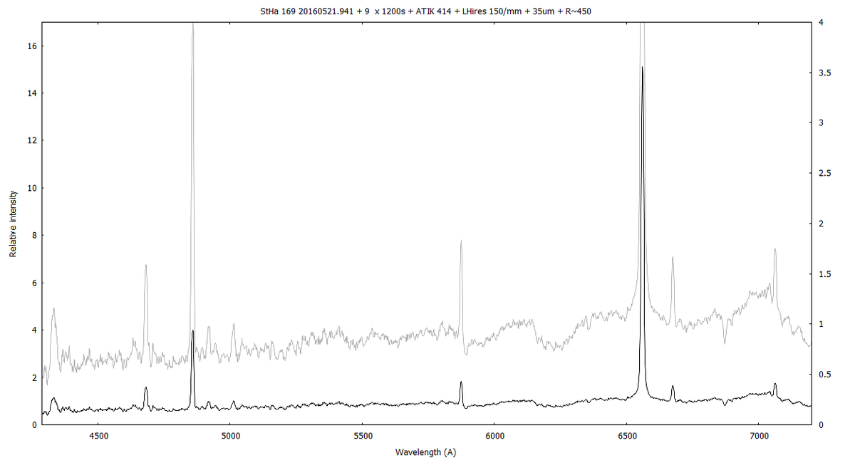

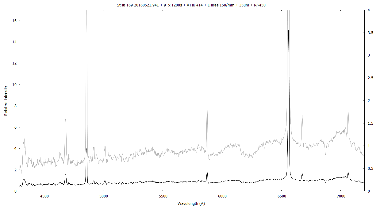

Had this star a sleeper project for the 2nd half of the night:
Had some veils meanwhile, basically slept it over.
Comparing to David Boyd's data from 05.14, doing gauss filter of 2.5/ISIS showing only a minor drop of Balmer and HeII 4686 as a difference, otherwise everything very similar (note that my LHires gets defocused in H-gamma). Had to use 1 sec exposures, that is my typical limit for slit-based guiding (means a star roughly at 13 mag, +/-0.5).
I can measure an EW ratio of Hb/HeII of 3.5 in ISIS.
