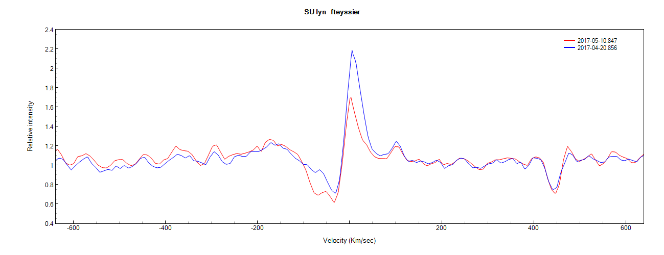

SU Lyn tonight
Impressive change in the absorption of H alpha
