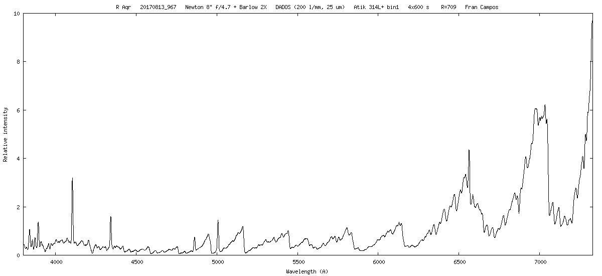

Re: R Aqr spectra requested by Margarita Korovska
here is my contribution for R Aqr. The comparison star is HD 222847 (B9 V).
I wonder what is the optimum frequency of observation: a spectrum every week? 15 jours?
Greetings
Fran
Greetings
Fran

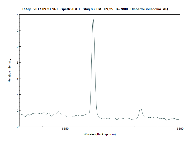

- Posts: 248
Bonsoir à tous, voici ma contribution. Umberto

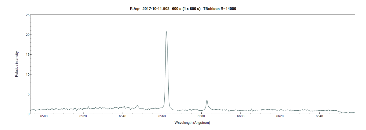

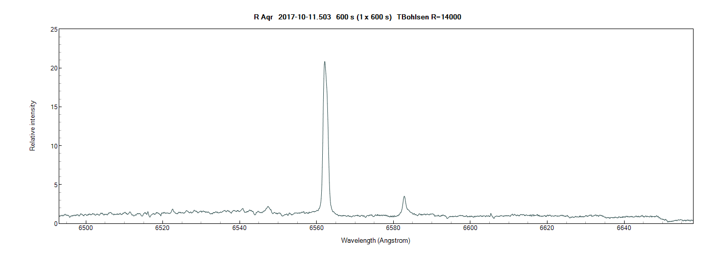

Terry Bohlsen
- Posts: 191
From last night (11/10/2017) Australia time
B=11.44
V=10.07
Spectra of Ha region R=14000
B=11.44
V=10.07
Terry Bohlsen
Armidale NSW
Australia
Armidale NSW
Australia

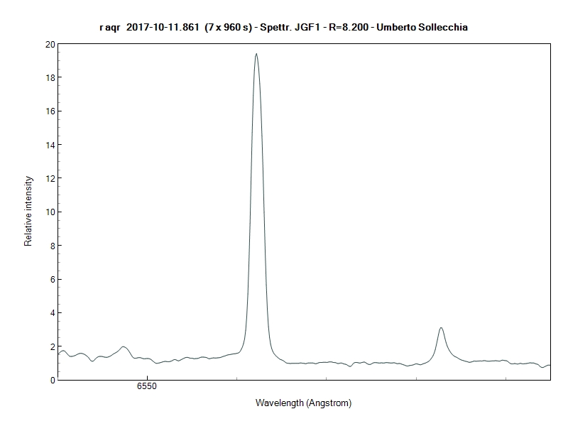

- Posts: 248
Bonne journée à tous, ma collaboration avec l'observation du 11-10-2017.
