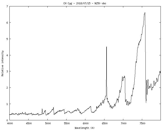

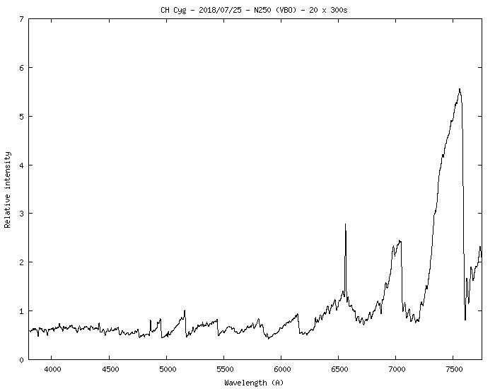

Please find my contribution to this topic with a low resolution spectrum taken during the last OHP workshop.
20x30s with Alpy600 spectrograph on 250 mm F/4 Newtonian telescope.
Vincent
CH Cyg 2018
Vincent Bouttard
Re: CH Cyg 2018
- CH_Cyg_20180716_071.png (5.42 KiB) Viewed 13509 times
Vincent Bouttard
Re: CH Cyg 2018
Hello
CH Cyg last night. 20 x 30s with Alpy600 on 250 F/4 Newtonian telescope (I've made a mistake on the title of this image about the exposure time).

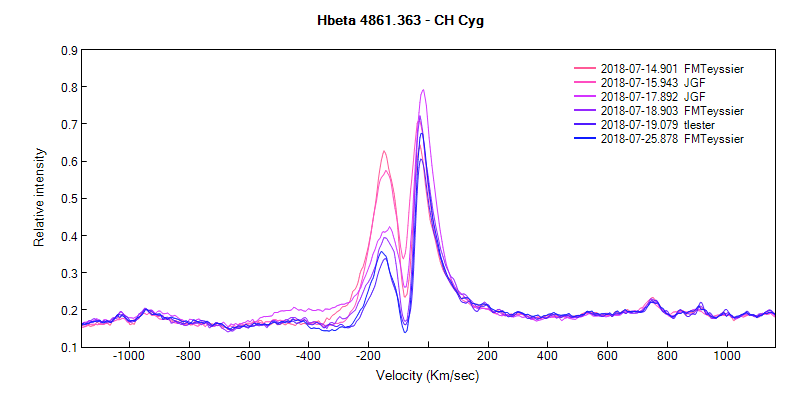

Hello Francois,
I think the H-beta is considerably affected by the B component's flux level - hence can be mixed by a similar absorption that's prominent clearly in the UV: The green line is my new observation, unfortunately got bad weather here and can't shoot for 1-2 weeks.
What I suspect, the jet in the line of sight is precessing towards the 0 km/s vrad (maybe approached it by now).
I'd rather recommend looking at the sudden EW(H-alpha) drop happening since 07.12 - that's what the daily spectra show in the database, just cannot graph so many data.

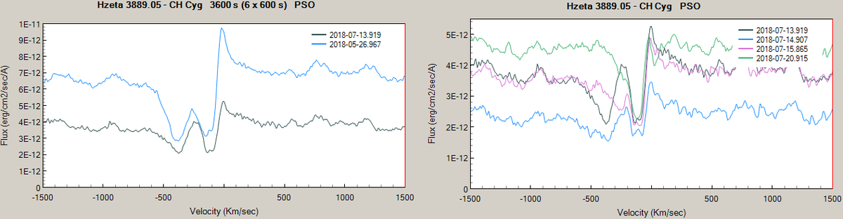

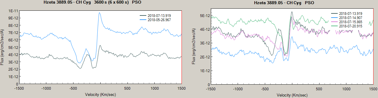

CH Cyg went into a blue minima again (see aavso).
By fortune with yesterday session, I've got 2 spectra close by 1 week showing high & low state having their own flux (using the wide slit, ref.: Vega/calspec): Included my spectrum on 2018.07.07 which was in the middle of the earlier minima.
I am curious what is causing these events.

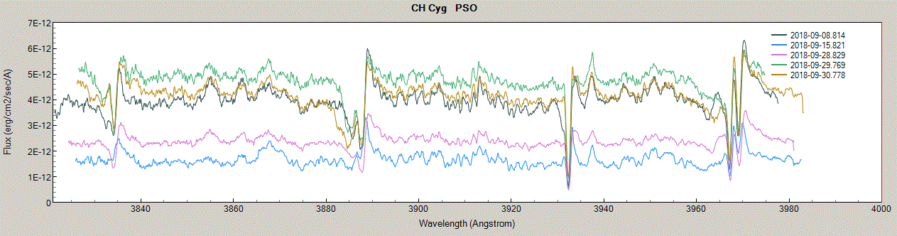

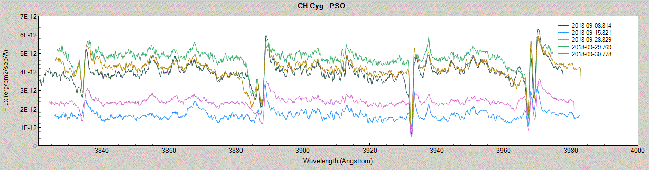

This lucky weekend (3-days serie) allowed to follow the rise after this 2nd dip again, presenting within the whole month:
Each spectra flux calibrated (ref: Vega), using the wide slit.

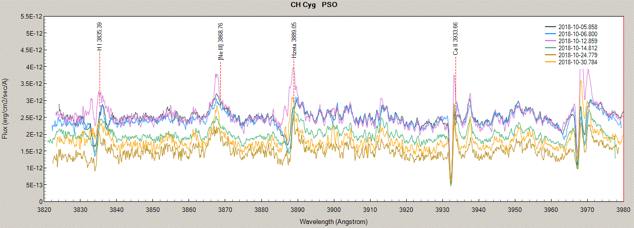

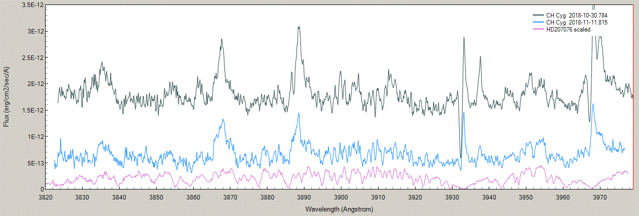

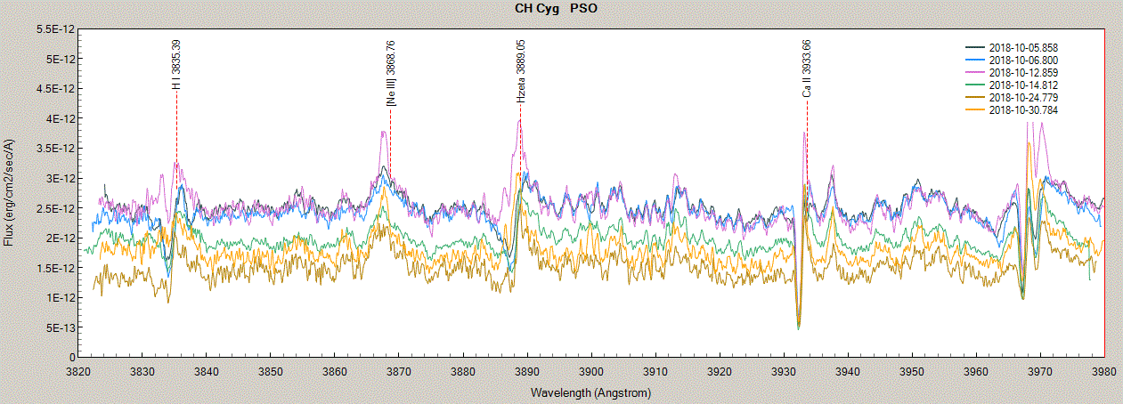

Just reporting a sudden flux drop of CH Cyg in the 3860-4000A range from OCT.30 to NOV.11, comparing to the previous low states: It was extremely hard, switched to 20 minute to get real photons at low ADUs (with clouds in between).
The flux capture with the wide slit was yet at good sky conditions (Alpy Lyr + 2 x 5 minute CH Cyg), but had to do atmospheric correction (10% lower level than without the correction). The emissions with similar integrated flux amount confirming the continuum drop.
With pink color, showing hd207076 that I've scaled it via a rough human eye estimate (that when I subtract, then emission features become symmetric).
I'd assume, it should be a must for the Alpy owners to follow the decrement, and observers should make sure the low level in the UV is properly exposured.
During october, the flux level was flickering between low- and medium level (of 2018): The emissions flux level were a kind of constant, except 1-2 observations.
- Peter
