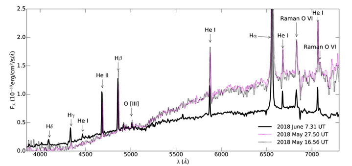

1. Research note of the newly identified yellow symbiotic Hen 3-1768 (≡ASAS J195948–8252.7), based on spectra obtained by Terry Bohlsen. Congratulations to Terry!

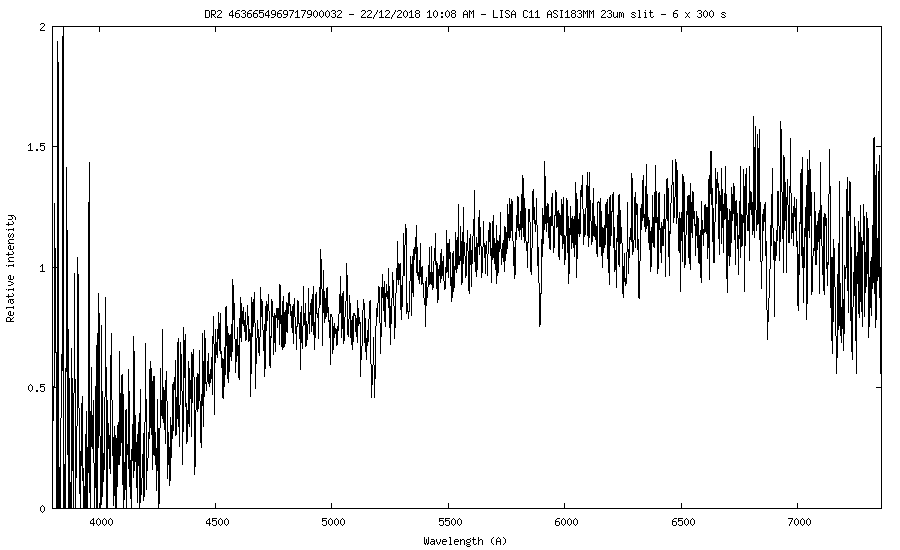

We have had poor weather in December so I haven't been able to do much observing. I did have some clear skies last night but with a full moon.
I observed GAIA DR2 4636654969717900032 which I have observed before. It is a mostly flat featureless spectrum.

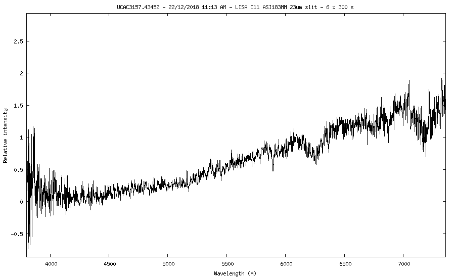

I also observed the second star on the list without a name but it is UCAC3 157:43452 at mag 12.3 in CMa.
It shows some features but no emission. Both were 30 mins of exposure. More time is probably needed but since there wasn't any emission I didn't persevere.

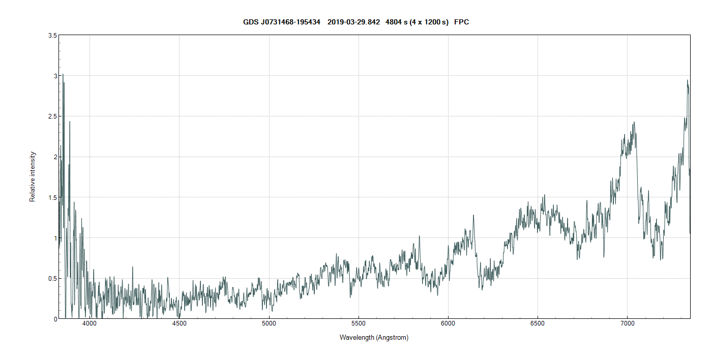

here is a recent spectrum of the suspected symbiotic GDS J0731468-195434. No emission lines have been detected, the signal is low but enough to discard the presence of medium or strong emisison bands.
Greetings,

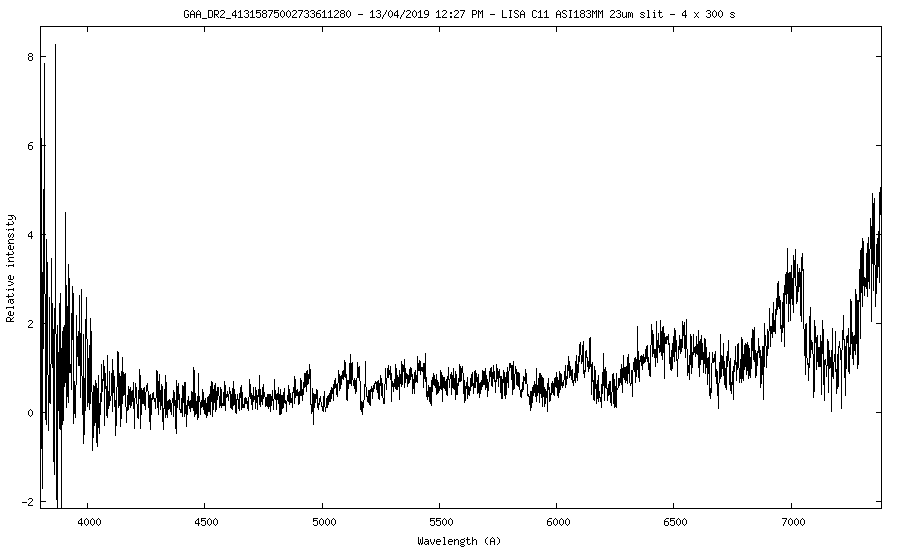

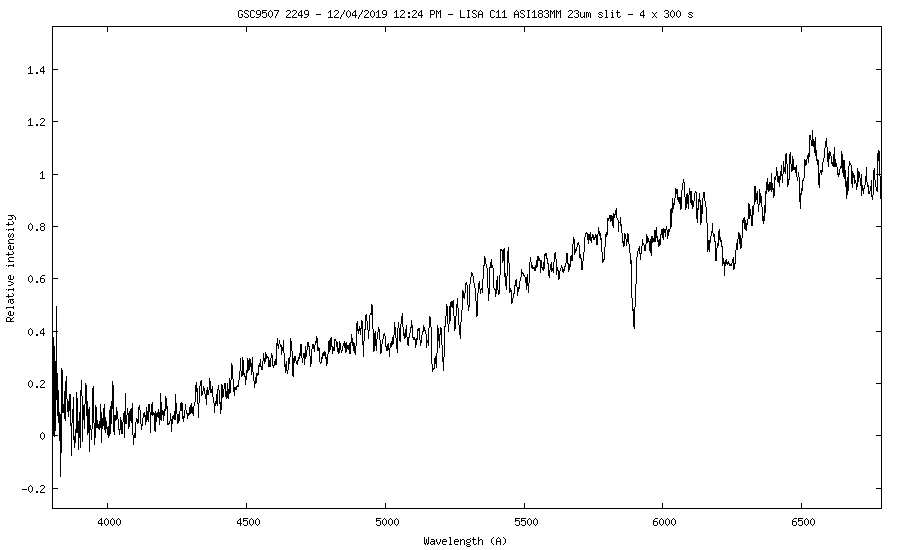

These stars are starting to become visible in the evening again. I have taken spectra of 2 further targets.
GSC9507:2249 which is the 6th star on the list with no name.
GAA_DR2_41315875002733611280
Terry
