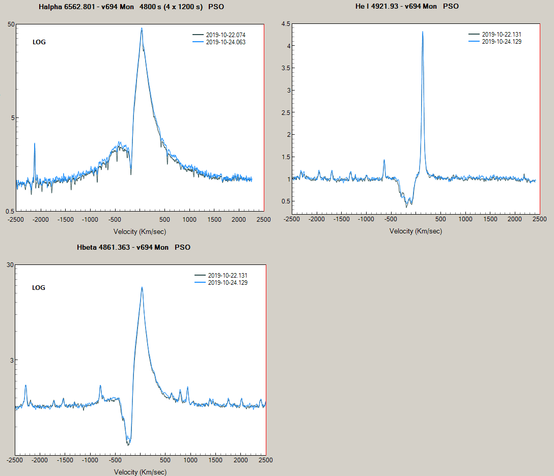

Nice coverage with the HST, Terry and Woody!
I can shoot it only in the morning skies - managed at least bracketing the critical time (2 days before - vs - today):
4 x 20 minute H-alpha, 4 x 20 minute H-beta
The He I 4922 change is visible also visually on raw spectra, it's the most obvious above noise level.
H-beta show some smaller RV changes (far above noise), and H-alpha some global EW change.
- Peter

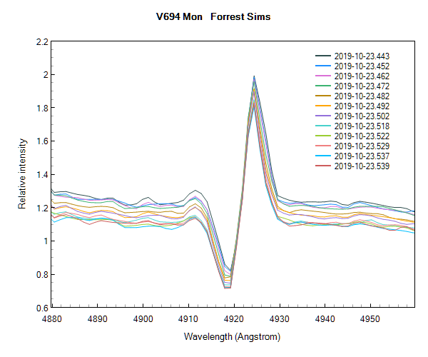

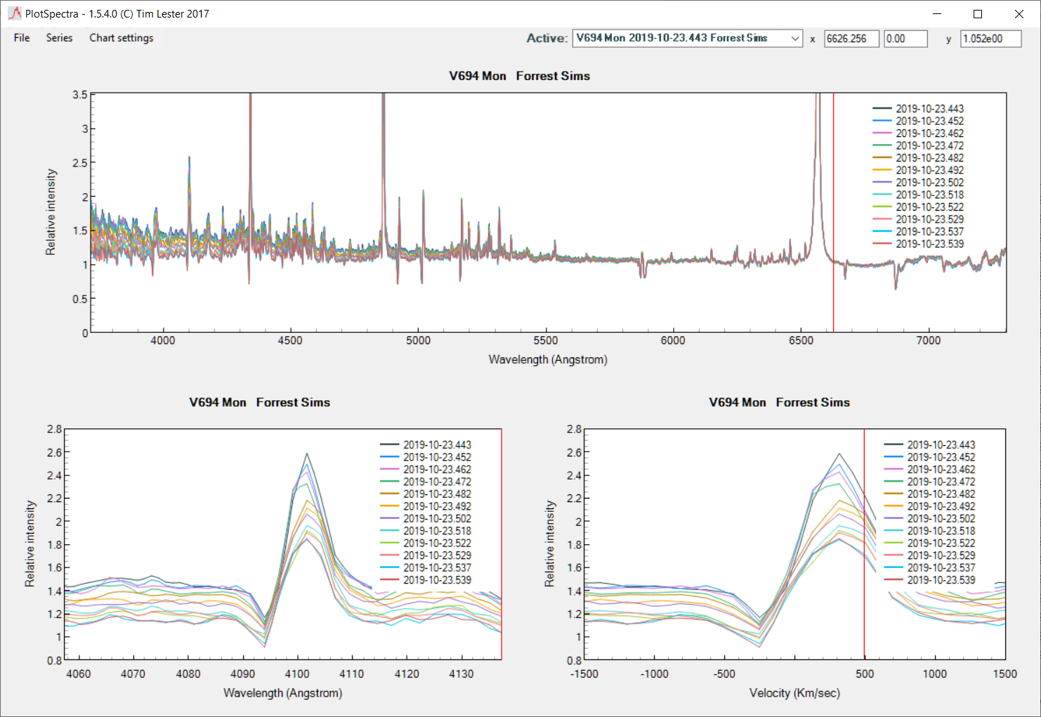

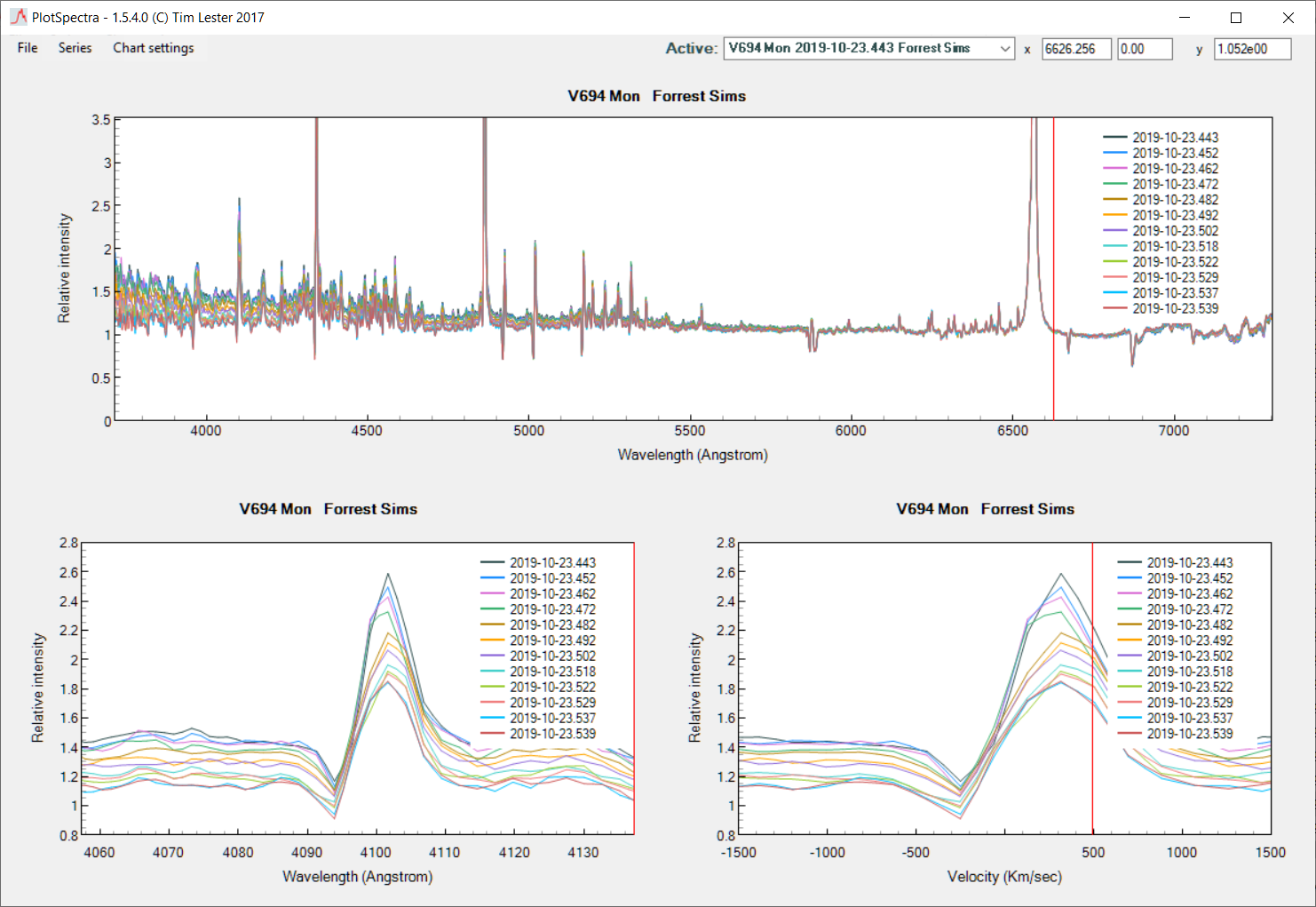

I was able to capture a sequence of spectra with my LISA of V694 Mon early morning before the HST window on the 23rd. I took 12 sequences of 7 images each starting with exposures of 120 seconds and ending with exposures of 80 seconds. Even so I still saturated Halpha in some of the sequence as the altitude increased and the sky brightened after astronomical dawn. Here are two PlotSpectra charts, the first one showing the 12 sequences with attention drawn to Hdelta at 4101.73 and the second one showing the PlotSpectra subplot for your HeI 4921.93 line. In the case of the Hdelta line, maybe there is some real change taking place over this several hour period. I suspect the general spread in the lines is due to having to choose one Reference star (therefore one Response curve) and apply it to all 12 sequences. But it still looks like there might be an amplitude change over time. And the other plot shows the HeI line Peter described but lower resolution than Peter's.
Woody Sims
v694mon_4922 subplot.png (49.47 KiB) Viewed 10993 times

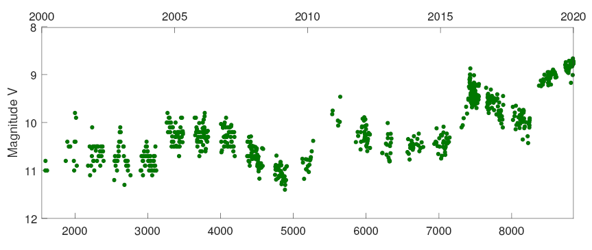

The extraordinary V694 Mon (MWC 560) is at its historical brightest luminosity. The previous record was ~ 9 during 1990 visual outburst.
Daily monitoring is recommended (very fast variation)

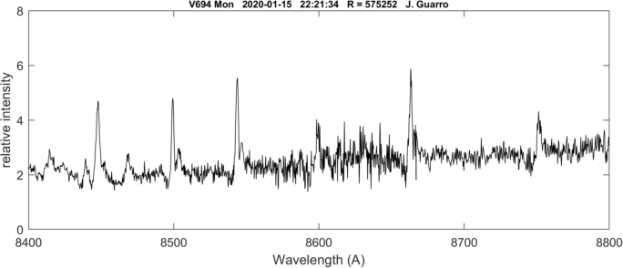

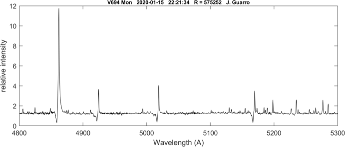

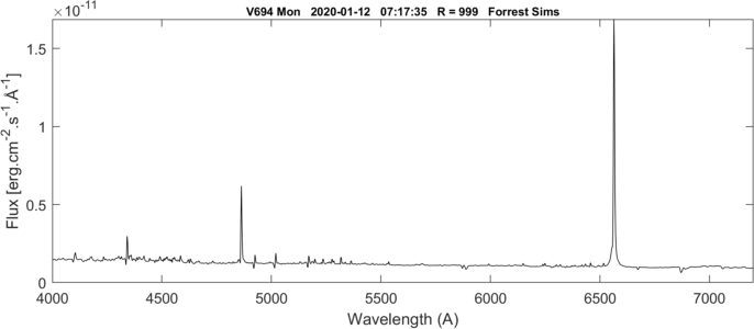

Flux calibrated spectrum obtained by Woody Sims

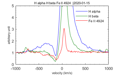

Echelle spectrum obtained by Joan Guarro;
_v694mon_20200115_932_J. Guarroa.png (13.68 KiB) Viewed 10232 times
_v694mon_20200115_932_J. Guarrob.png (22.08 KiB) Viewed 10232 times

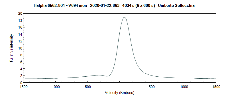

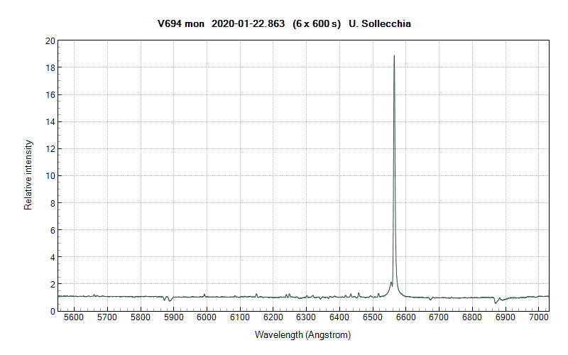

Bonsoir à tous, ma contribution sur cette symbiotique.
Vitesse radiale
v694mon_20200122_863_V.R._U. Sollecchia.png (12.94 KiB) Viewed 10114 times

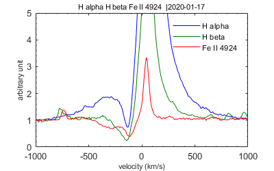

From echelle spectra obtained by Joan Guarro and François Teyssier:
asdb_v694mon_20200115_932_H alpha H beta Fe II 4924.png (15.12 KiB) Viewed 10081 times

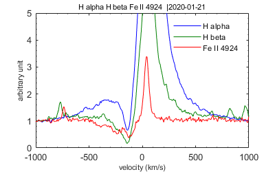

asdb_v694mon_20200117_917_H alpha H beta Fe II 4924.png (14.91 KiB) Viewed 10081 times
asdb_v694mon_20200121_886_H alpha H beta Fe II 4924.png (15.52 KiB) Viewed 10081 times

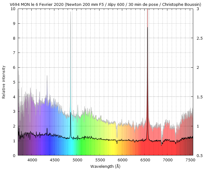

Here is my contribution to the monitoring of V694 Mon.
The spectrum below was obtained on February 6 at 22 h 59 TU (Alpy 600, resolution 502, JJ = 2458886.4577, 6 exposures of 300 s) :
V694 Mon on February 6th, 2020
_v694mon_20200206_958_Christophe Boussin_3700_7570.png (76.68 KiB) Viewed 9691 times
Hoping for clear skies for the next days...!

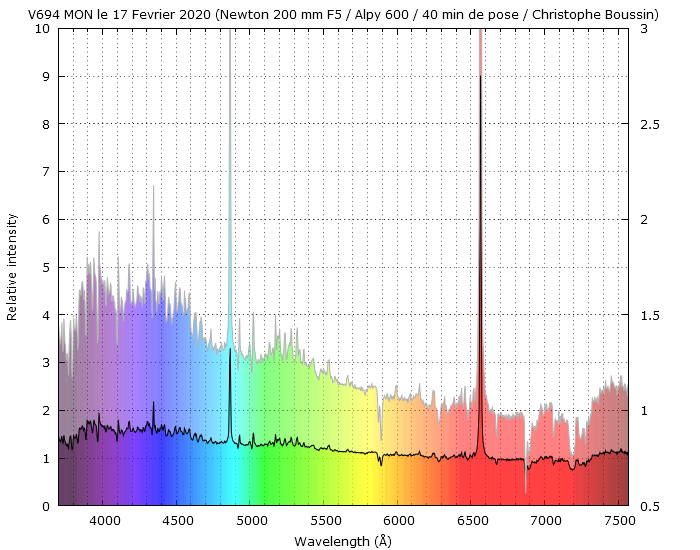

After several cloudy nights, a « window » of clear weather opened last night to resume the monitoring of V694 Mon !
The spectrum below was obtained, on February 17 at 22 h 25 TU (Alpy 600, resolution 504, JJ = 2458897.4341, 8 exposures of 300 s) :
V694 Mon on February 17th, 2020
_v694mon_20200217_934_Christophe Boussin_3700_7570.png (76.62 KiB) Viewed 9482 times
Clear skies to all !

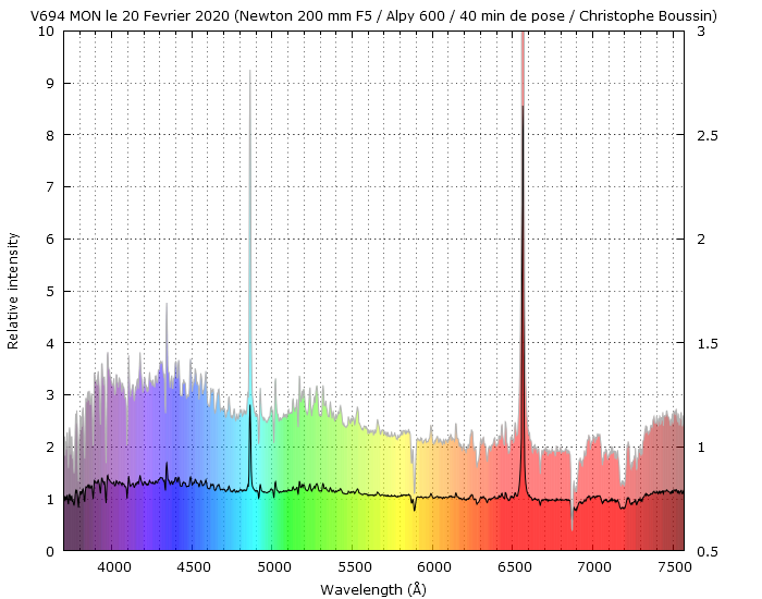

After a heavy rain shower...I got a new spectrum of V694 Mon under a very clear sky !
The spectrum below was obtained, on February 20 at 23 h 05 TU (Alpy 600, resolution 505, JJ = 2458900.4623, 8 exposures of 300 s) :
V694 Mon on February 20th, 2020
_v694mon_20200220_962_Christophe Boussin_3700_7570.png (71.79 KiB) Viewed 9367 times
