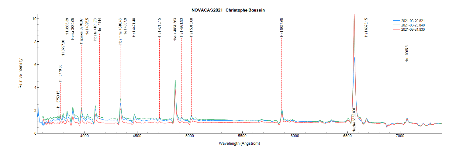

Here is my update for the monitoring of the nova Cas 2021.
The following spectra were obtained with my Alpy 600, respectively, the 23th of March at 20 h 10 TU (resolution of 525, JJ = 2459297.3404) with an acquisition time of 36 min (12 x 180s) and the 24th of March at 19 h 55 TU (resolution of 529, JJ = 2459298.33) with an acquisition time of 18 min (6 x 180s) :
Nova Cas 2021 on March 23th, 2021
_novacas2021_20210323_840_Christophe Boussin_3600_7395.png (96.19 KiB) Viewed 16172 times
Nova Cas 2021 on March 24th, 2021
_novacas2021_20210324_830_Christophe Boussin_3600_7395.png (84 KiB) Viewed 16172 times
Nova Cas 2021 on March 20th, 23th and 24th 2021 (identification of some lines from PlotSpectra)
Clear skies,
