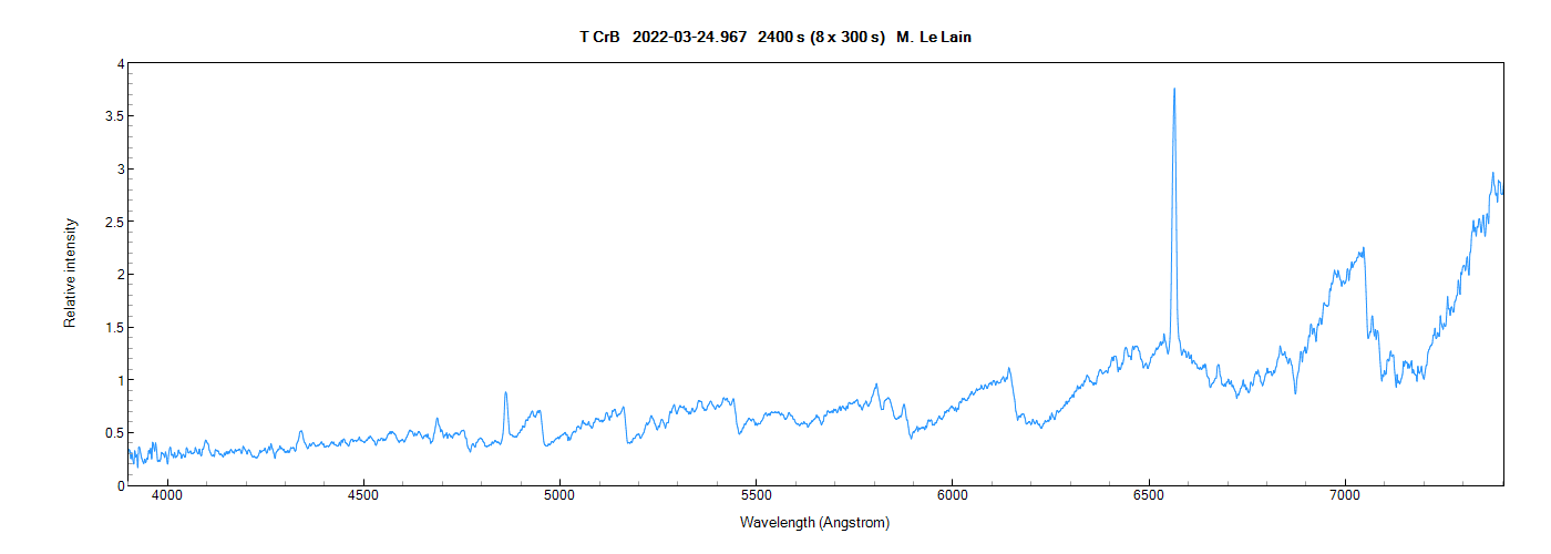

Matthieu Le Lain
- Posts: 24
- Joined: Mon Apr 15, 2019 4:33 pm
Re: T CrB before its new nova event
Here is a new spectrum of T CrB with an alpy on C8 (24/03/2022)
Matthieu
Matthieu

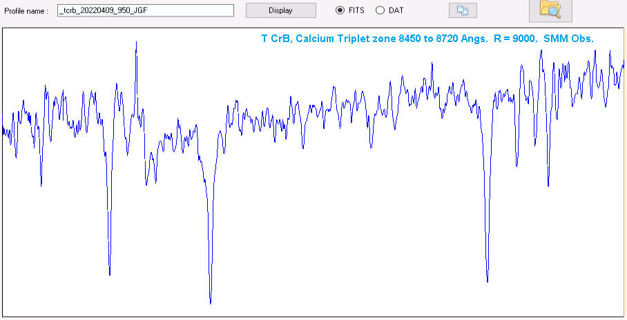

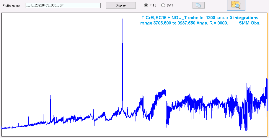

- Posts: 731
That's T CrB from the SMM remote Observatory this last night.
Regards, J. Guarro.
Regards, J. Guarro.
- T CrB1.png (24.2 KiB) Viewed 21040 times
- T CrB2.png (30.15 KiB) Viewed 21040 times
- T CrB3.png (14.08 KiB) Viewed 21040 times
- T CrB4.png (27.37 KiB) Viewed 21040 times

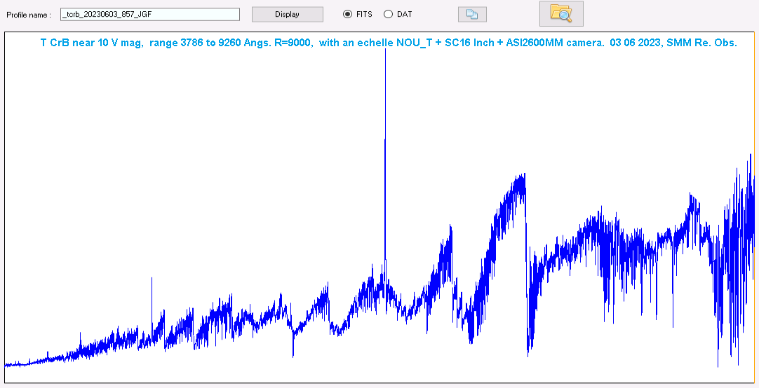

- Posts: 731
Hi there,
This is a T CrB graphics from the SMM Remote Observatory in this bad weather season.
Cheers, J. Guarro
Cheers, J. Guarro
- TCRB 20230603.png (37.98 KiB) Viewed 19397 times

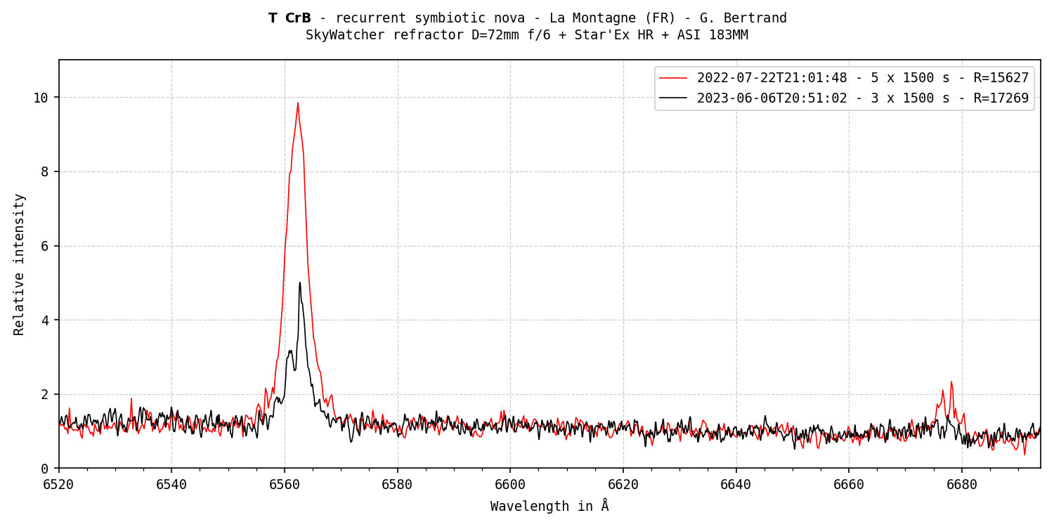

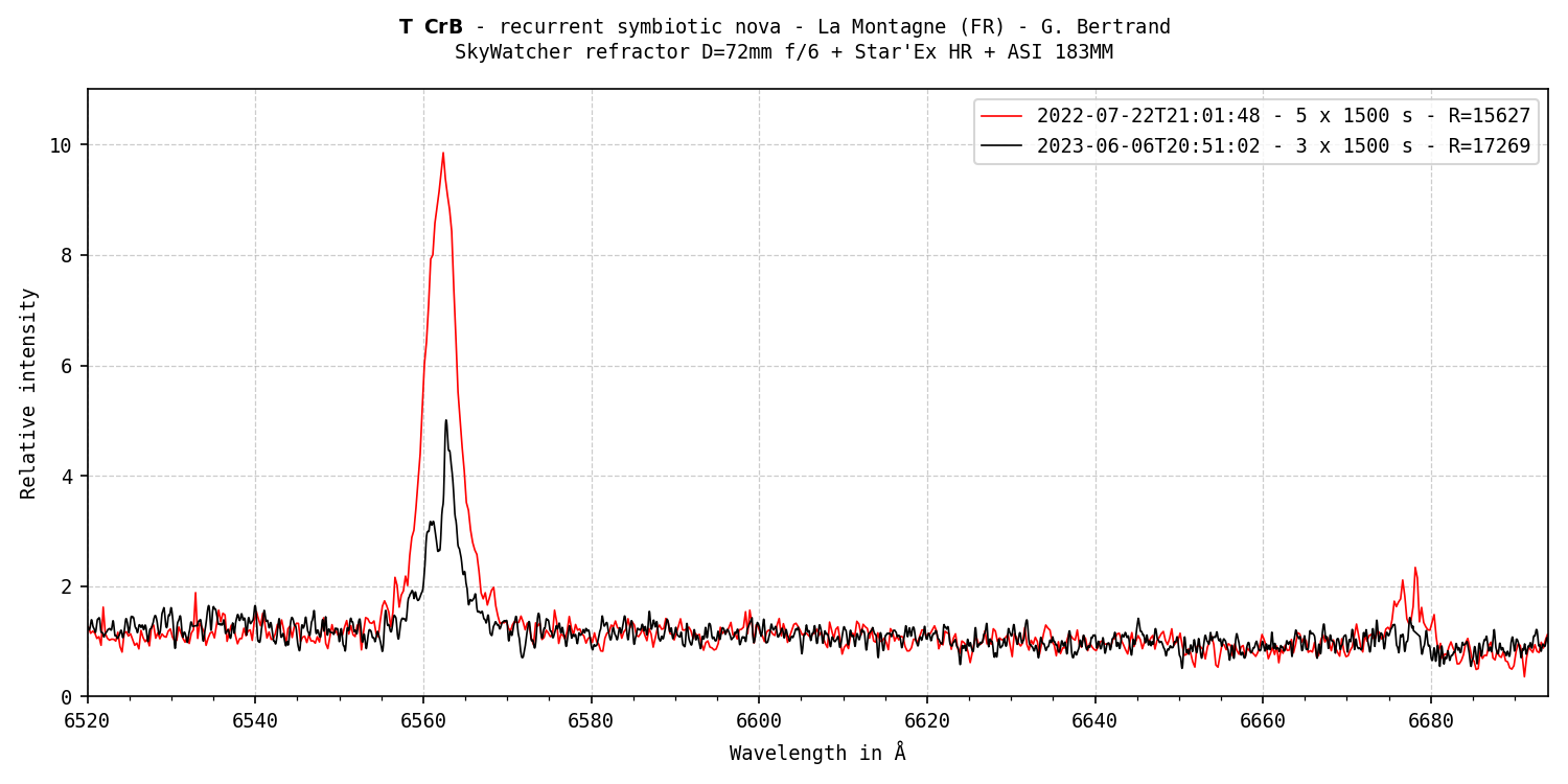

Guillaume Bertrand
- Posts: 16
- Joined: Tue Jun 14, 2022 8:18 pm
- Location: Nantes
Here's a new spectrum of T CrB with my little 72mm refractor. (A bit of a challenge
) In red, for comparison, a spectrum from a year ago.
Guillaume
Guillaume

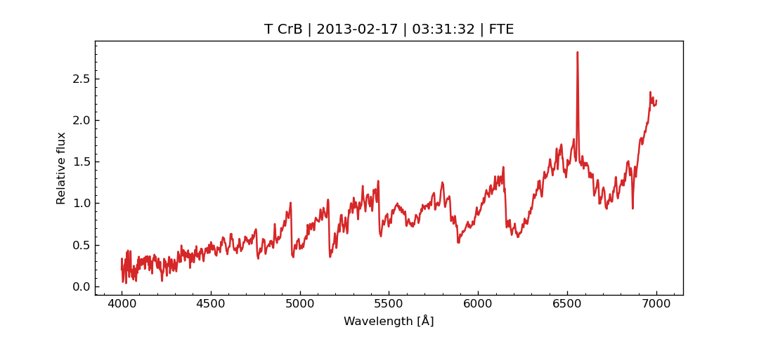

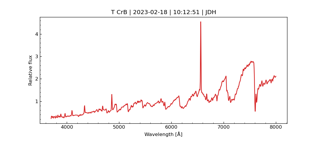

- Posts: 1562
Yes, the spectrum returns to the pre-high state aspect: the continuum is dominated by the M4 III red giant. The emission lines becomes fainter (even if He II and He I are still present)
During the two last months, the EW grew a little bit according to orbital phase. But the global trend is decline.
First low res spectrum in the database, more than 10 years ago.
Guillaume's comparison shows the decline observed during the last months.
But a word a caution: the flux and profiles of the lines are strongly dependent of the orbital phase. Thus the most accurate comparison should use spectra acquired at the same orbital phase
This is a key point of the symbiotic stars monitoring: long term and high cadency observations can produce very valuable results
It needs much more abnegation than short observing campaigns.
This is my conception of the contribution of amateurs to the community (in fact exactly the same state of mind as in photometry since one and half century)
And it is very appreciated by number of professionnal teams working on eruptive stars.
Our T CrB dataset (more than 760 spectra in 10 years) is a treasure for the research (even if it raises more news question than it solves !)
I'm working on a presentation for the SAS 2013 symposium. It will be ready next week.
Bonne continuation! Keep on the very good job!
