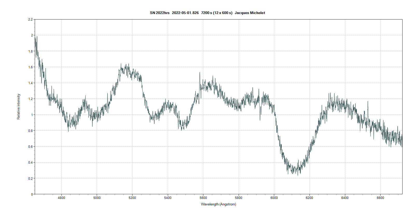

Captured with an RC12-Uvex600-Atik460ex configuration, a somewhat noisy spectrum of the supernova. Recognising any line pattern is really challenging.
Jacques
SN 2022hrs spectrum
SN 2022hrs spectrum

Jacques Michelet wrote:Captured with an RC12-Uvex600-Atik460ex configuration, a somewhat noisy spectrum of the supernova. Recognising any line pattern is really challenging.
Jacques
Yes the lines are so doppler shifted and blended by broadening making identification of the lines difficult (classification is generally done by matching to spectra of known supernovae at the same age.) This paper by Fillipenko is a good starting point
https://ned.ipac.caltech.edu/level5/Mar ... rames.html
and specifically for type Ia this review paper
https://arxiv.org/abs/1402.6337

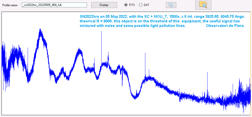

Taking advantage of last night's good seeing, I attempted to observe SN2022hrs, it's a bit out of my instrumental possibilities, but also it is possible that it would be useful for you, so I left its fits and information files here.
https://drive.google.com/file/d/1pwPFcb ... sp=sharing
Cheers, Joan Guarro.
_SN2022hrs_20220505 GRA.png (30.91 KiB) Viewed 7551 times

Hello Joan
Fantastic spectrum of SN2022hrs with your échelle NOU. I thought that at resolution 9000 it was not possible to obtain spectra of such faint objects. An exposure of 3.5 hours is perfectly acceptable.
Greetings
Juan José
