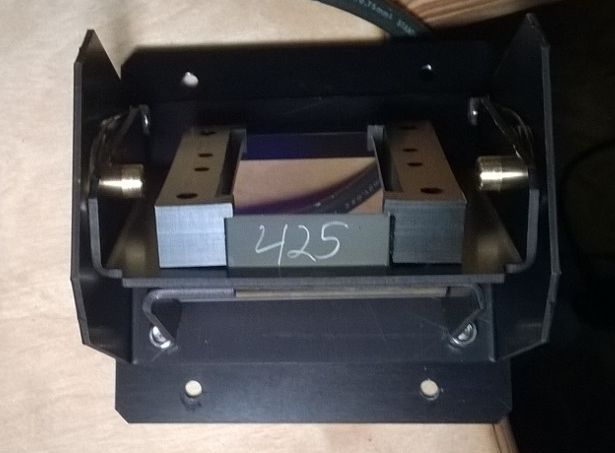

Hi Franck,
Thanks for your post, which is very interesting. Here is a photo of my 2400l/mm grating, and it does appear as though the grating may be under pressure at the edges. I'm not too bothered, as long as I can find the problem and fix it.
2400 l/mm grating
2400 l/mm grating
I've emailed Shelyak to see what they think.
Thanks,
Andy
Franck Houpert
Posts: 47
Joined: Sun Oct 02, 2011 8:21 am
Re: Lhires III fine tuning
Post by Franck Houpert »
the grating is maintained only by the double sided tape over its entire rear surface.
me too, 2400l/mm
Hi Andy,
I suspect astigmatism. This means best focus for the narrowest spectrum vertically ie you star spectrum) does not correspond with the focus with narrowest spectrum lines horizontally (ie your neon spectrum). You could check this by taking a sky spectrum or perhaps a G/K star say with many lines. The sharpest spectrum will probably correspond to the sharpest neon (and star in focus on the slit), not the narrowest star spectrum.
I have seen this a couple of times. Check that your grating is not pinched, which can bend it slightly in one direction. The clamps should just clamp the grating, just enough to stop it sliding in the holder. (Actually, thinking about it, this is odd. I thought the gratings were permanently fixed these days, unlike my original ones where the gratings could be changed in their holders) Also check that the collimator lens is not tilted in its holder (Do the neon lines move significantly back and forth when you turn the collimator for example ?)

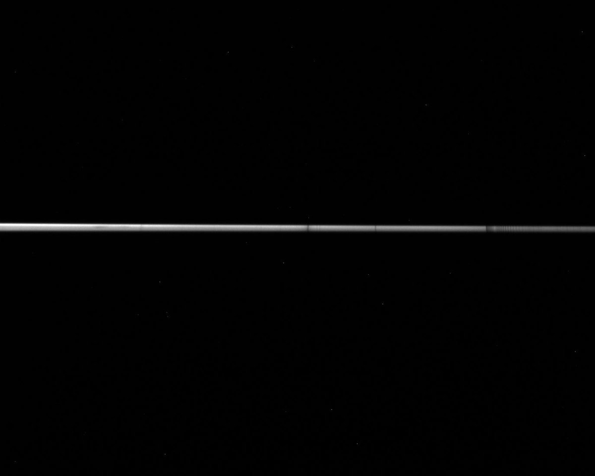

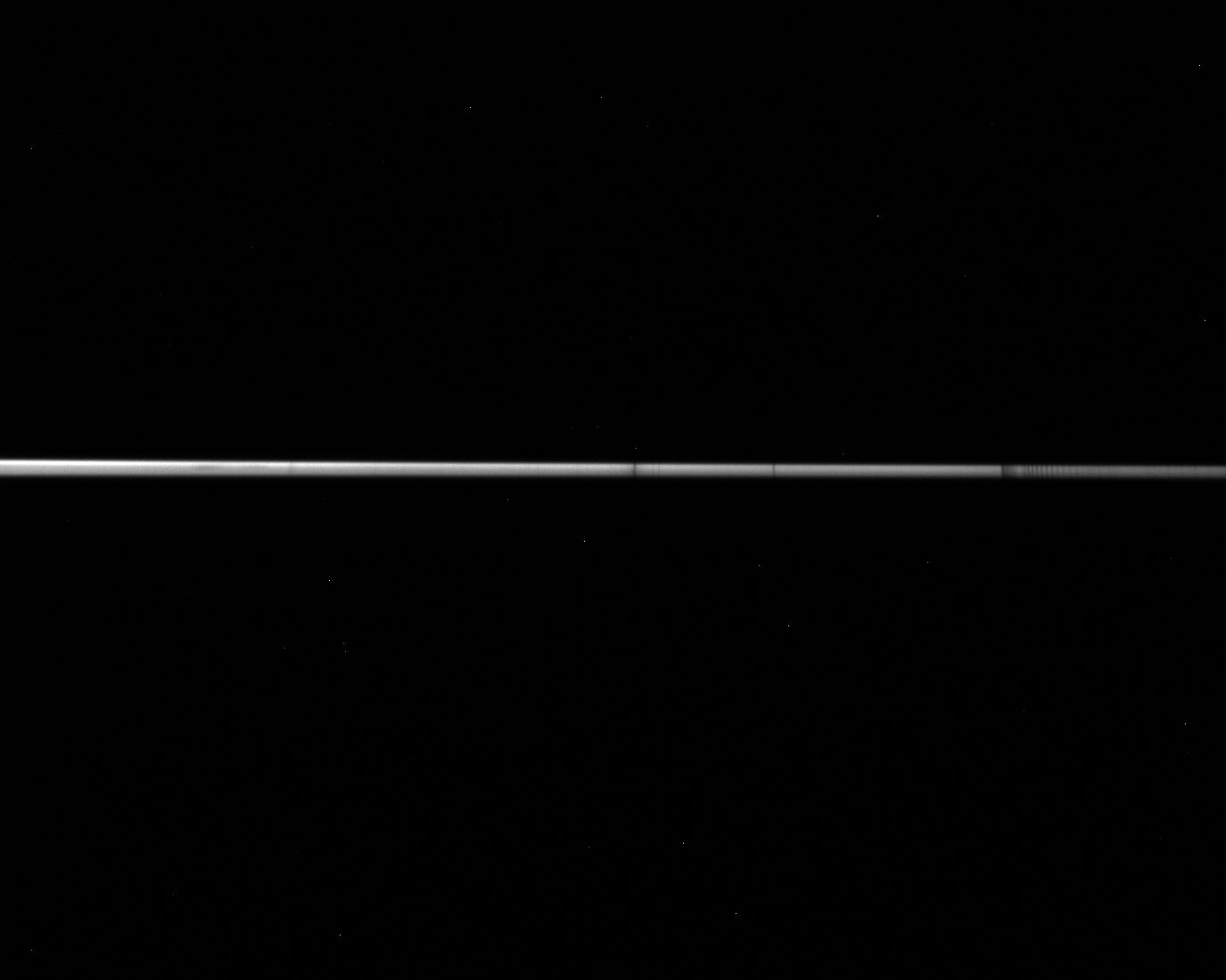

AndyWilson
Posts: 31
Joined: Wed Feb 18, 2015 9:02 am
Post by AndyWilson »
Thanks Robin, Franck and Mike,
I've not got to the bottom of the problem yet, but I think the best candidate is pinching of the grating.
I have tried to loosen the grating holder for my 2400 l/mm grating, but no matter how hard I try I cannot loosen the screws and I risk damaging something.
I did swap to my 600 l/mm grating and I got the following result. Though not perfect it is a whole lot better than with the 2400 l/mm grating. I'm not sure if the extra lines per mm of the 2400 grating would exacerbate any astigmatism or back focus issue, or whether this indicates it is a problem specific to my 2400 l/mm grating.
Spectrum with 600 l/mm grating.
600 l/mm grating
600 l/mm grating
Thanks,
Andy
Ken Harrison
Posts: 197
Post by Ken Harrison »
Andy,
I assume that image was obtained with the target star "focused" on the entrance slit and the neon lines in focus??
If so, it looks much better.....
