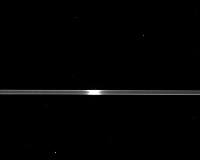

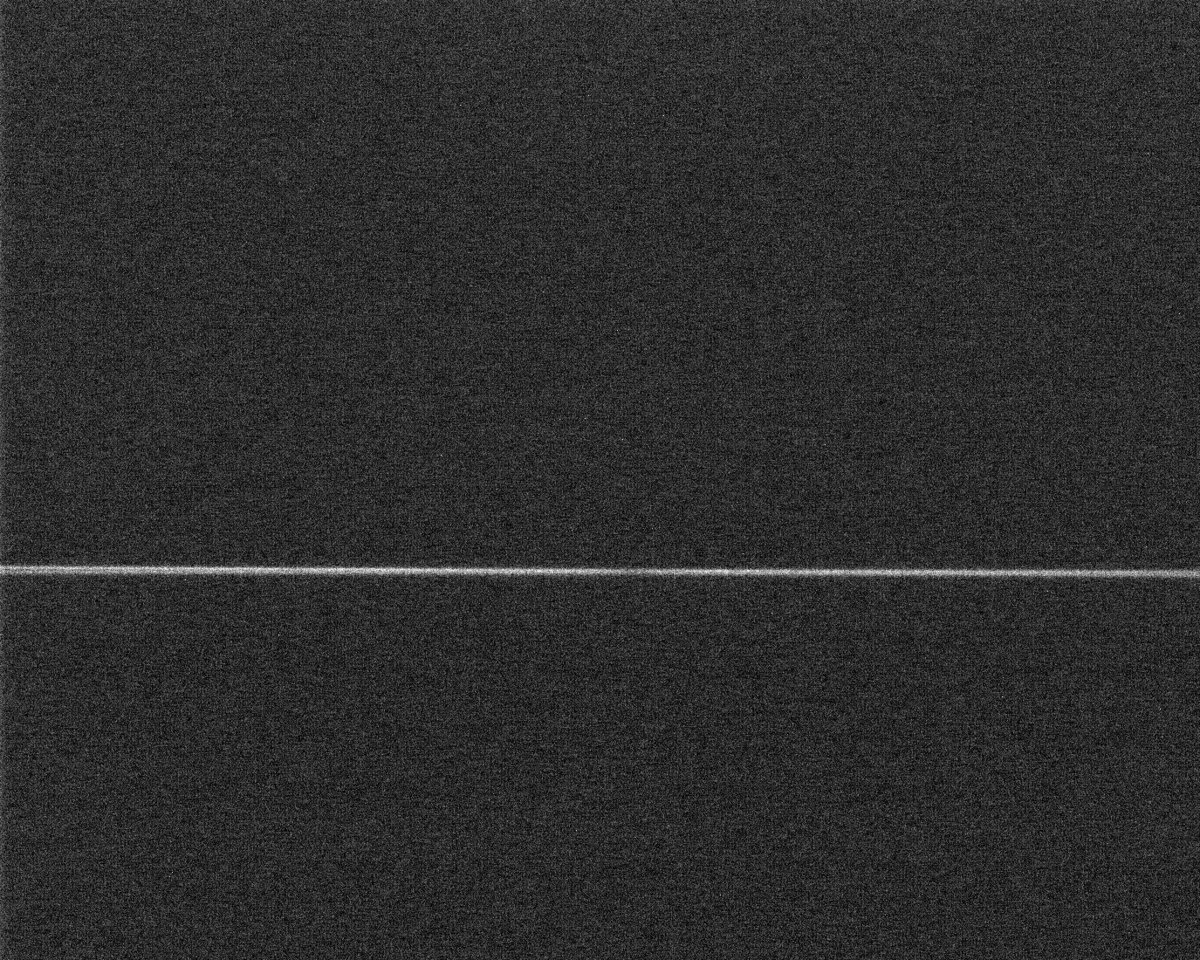

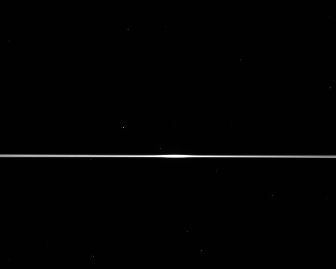

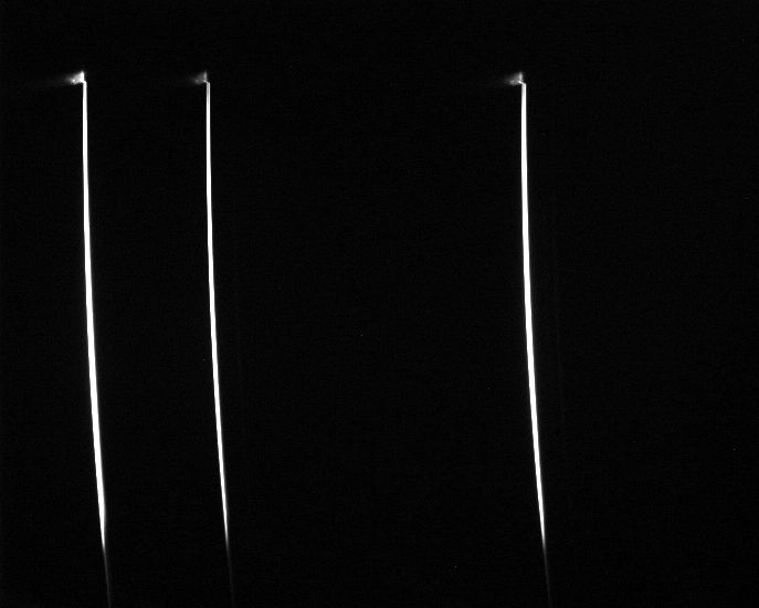

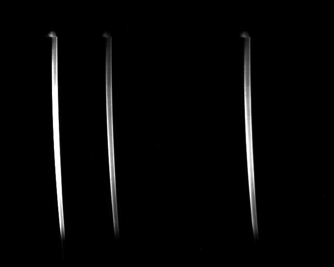

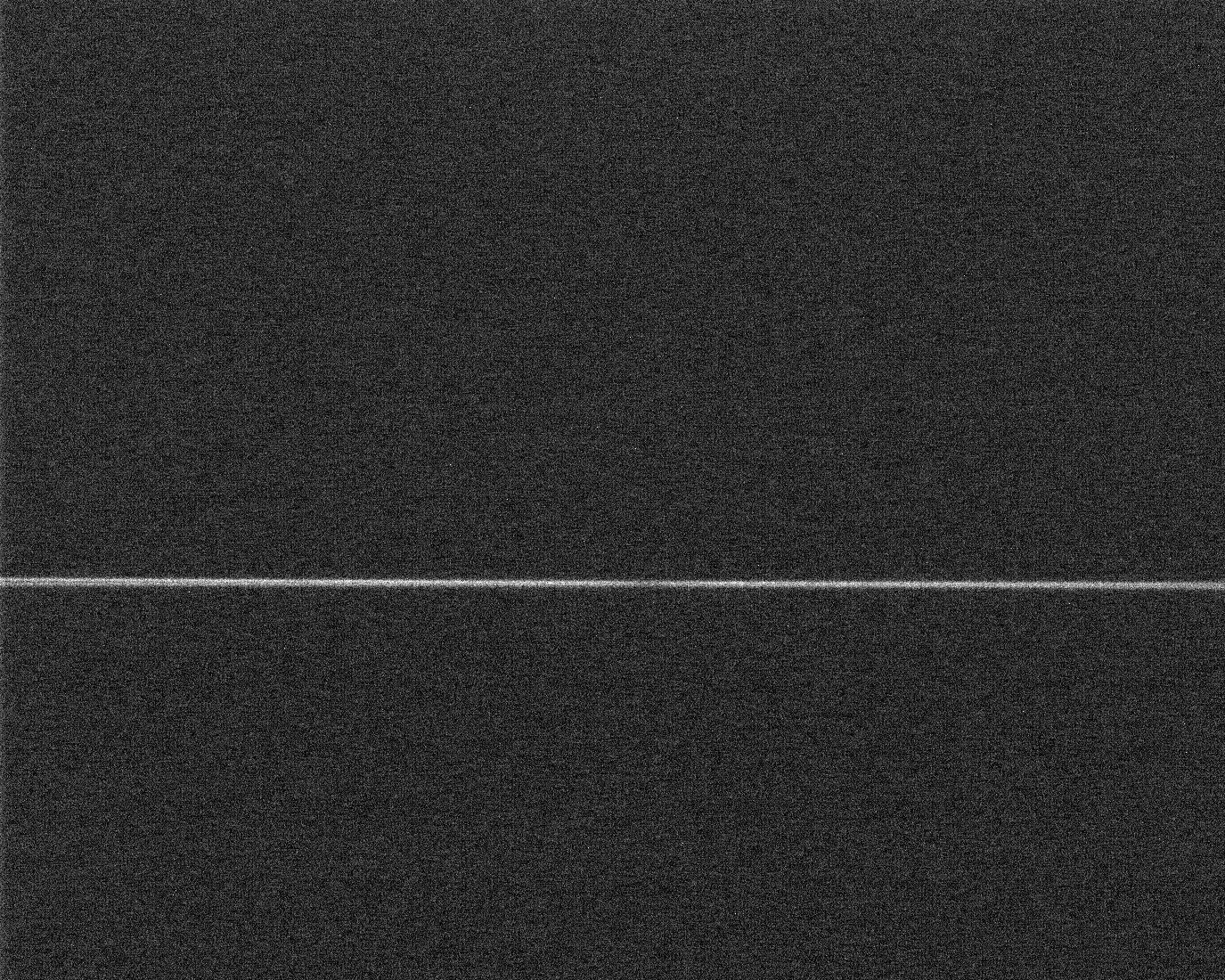

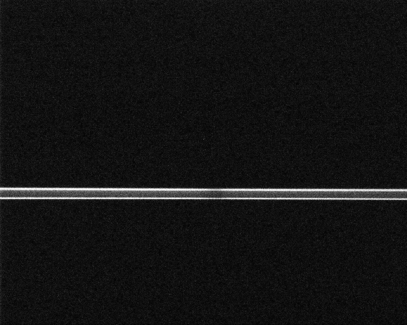

I am seeing a similar issue with my Lhires III. The best collimator focus for the neon lines appears to be different to the best focus for the stellar spectrum. I wonder if this is what I would expect to see if my imaging camera position was not at the correct distance?
I'm reasonably confident that the star is focused on the slit. The slit appears as a fairly narrow dark line in the guide camera and when the star appears focused this maximises the signal in the spectrum. I've also tried focusing the telescope while ignoring the guide camera but this does not solve the problem.
I attach 2 sets of images. The first are with the collimator lens at position 1, with the neon lines at best focus and you can see the star looks out of focus as it is a doubled line (this is with a Ritchey-Chretien telescope so it has a large central obstruction). The second pair of images are taken with the collimator lens in a position that gives the tightest spectrum but the neon lines are way out of focus and I think this is also true of lines in the stellar spectrum.
Neon lines collimator focus position 1
Neon focus position 1
Stellar spectrum collimator focus position 1
Star spectrum focus position 1
Neon lines collimator focus position 2
Neon focus position 2
Stellar spectrum collimator focus position 2
Star spectrum focus position 2
Any advice would be appreciated!
Thanks,
Andy
Ken Harrison
Posts: 197
Re: Lhires III fine tuning
Post by Ken Harrison »
Andy,
My take on it....
Position #1 with the sharp neons is correct....
The star focus ON the slit is out - if you set the collimator to #1 and then re-focus the telescope to give the narrowest stellar image I think is the answer....
AndyWilson
Posts: 31
Joined: Wed Feb 18, 2015 9:02 am
Post by AndyWilson »
Hi Ken,
Thanks for your reply.
Trying to focus the telescope with sharp neon lines is actually what I have previously tried many many times, but without ever being able to achieve a nice sharp line for the stellar spectrum. The best I can get is what I've shown as position 1. I get nice results from the spectrum, but clearly the stellar spectrum is smeared. I've also tried re-collimating the telescope in case that was the problem, but this appeared to have no effect.

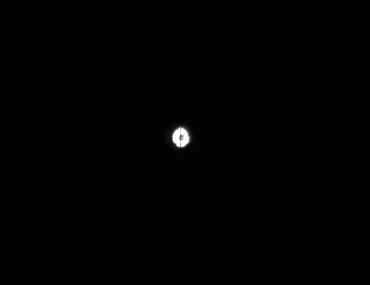

I've just given it a quick go again now as the sky is still clear this morning. I attach my results, this time showing the guide image and the stellar spectrum. In both cases I've focussed the spectrograph doublet to get nice sharp neon lines, and not touched it while changing the telescope focus between the 2 sets of images.
Guide image telescope focus position 1
Guide image star focused in guide camera

Stellar spectrum telescope focus position 1
Star spectrum star focused in gude camera
Guide image telescope focus position 2
Guide image star spectrum tight
Stellar spectrum telescope focus position 2
Star spectrum star spectrum tight
