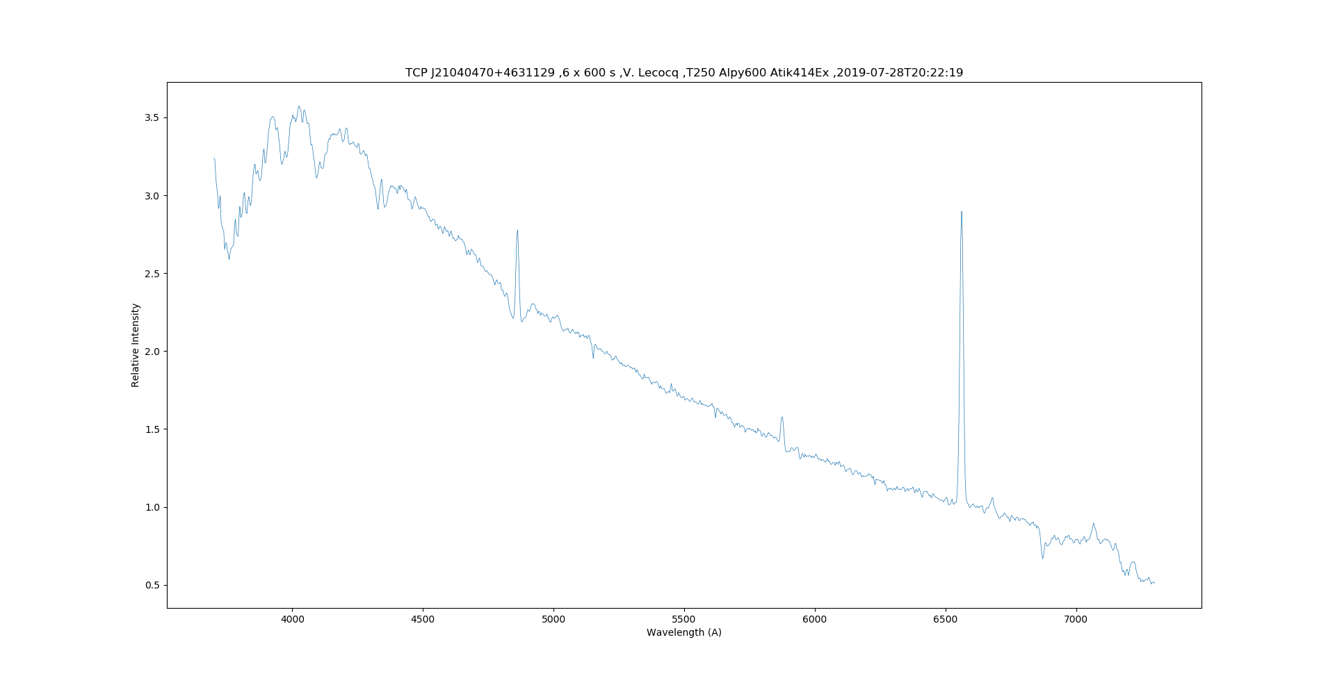

and here is my contribution to TCP J21040470+4631129:
Vincent

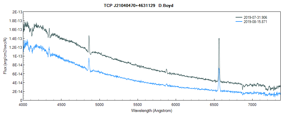

Does anything change in the spectrum during these dimmings ?
David Boyd
Posts: 164
Re: Transcient in Cygnus
Post by David Boyd »
Hi Robin,
I can't comment on the dimmings but although superficially similar there are subtle differences in the spectra at similar magnitudes during the main outburst and in the second rebrightening. The spectrum on 15 August near the top of the second rebrightening at V=12.3 is proportionally stronger in the blue than the spectrum on 31 July, close to the end of the main outburst at V=11.7. This is also indicated by a bluer value of (B-V) at the same V magnitude during the rebrightening. The Balmer emission lines are up to 50% wider (FWHM) during the rebrightening than in the main outburst.
