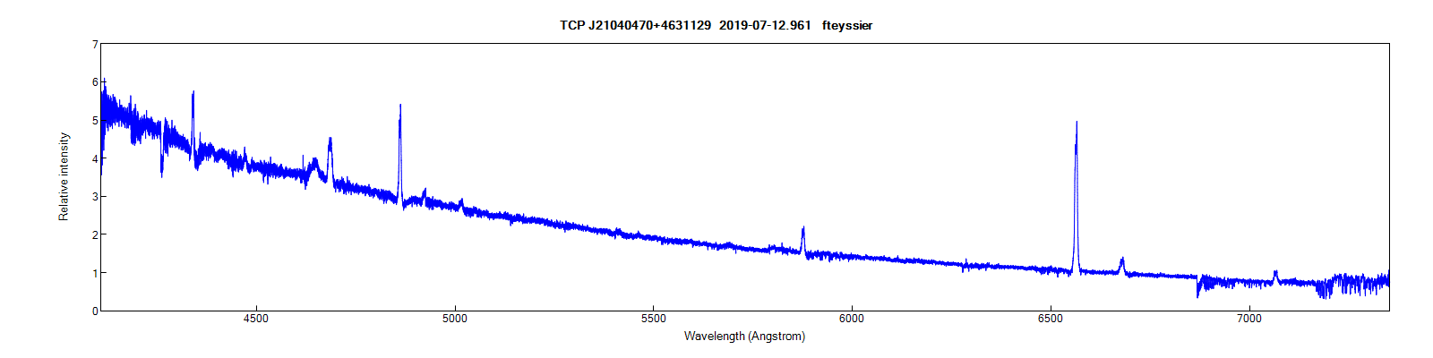

Discovery at mag 9.2 : PSN J21040470+4631129 2019 07 12.4900* 21 04 04.70 +46 31 12.9 9.2 U Cyg 9 0
by by Hideo Nishimura, Shizuoka-ken, Japan
http://www.cbat.eps.harvard.edu/unconf/ ... 31129.html
Image 300 secondes with Echelle spectrograph R = 11000
Send spectra to francoismathieu.teyssier at bbox.fr for ATel and inclusion in ARAS database
f
Last edited by Francois Teyssier on Sat Jul 13, 2019 12:49 am, edited 2 times in total.
Re: Transcient in Cygnus
Just a dwarf nova in outburst
FWHM (H alpha ) = 330 km/s and 1/2 FWZI = 500 km/s
Dommage

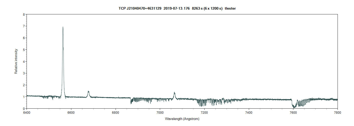

Tim Lester
Posts: 168
Location: Arnprior Ontario
Post by Tim Lester »

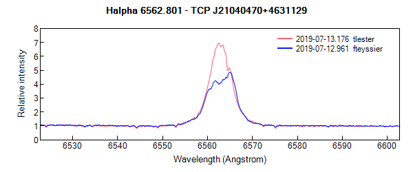

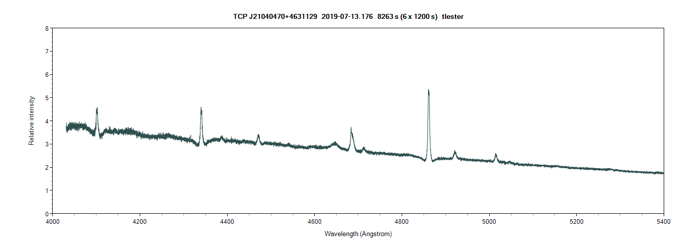

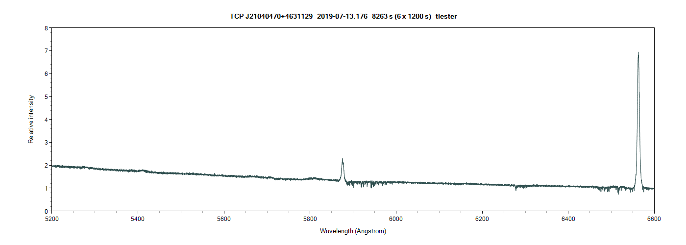

My spectrum from a little later the same night.
Impressive changes in a few hours
Paolo Berardi wrote:Not a classical nova but I've never seen such a bright cataclysmic outburst!
Indeed! Are there other examples where the H alpha emission in a dwarf nova outburst completely dominates the absorption like this ? (an asymmetry and line of sight effect ?)

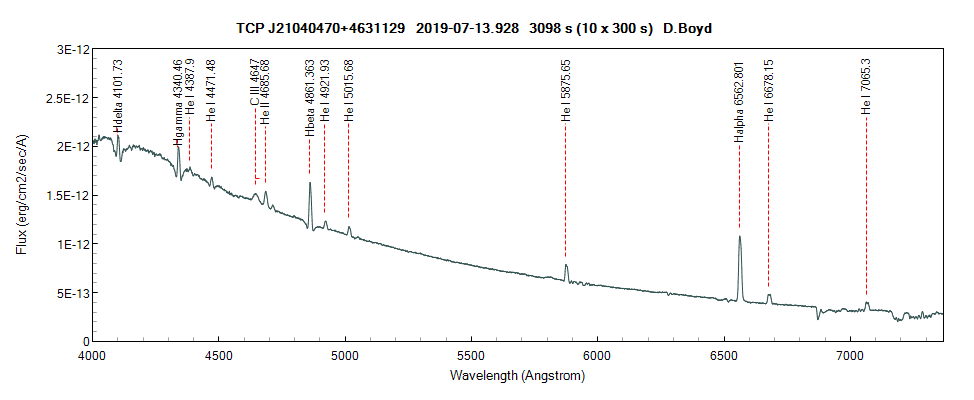

Spectrum of TCP J21040470+4631129 taken on 13th July with a LISA spectroscope (R=1100) on a C11 and flux calibrated with concurrently measured mean magnitude V=9.14, B-V=-0.23.
Nice spectrum, David
Robin:
To my knowledge, this is the first time we get high res spectra of a DN in outburst
The change of the profiles reflect probably the orbital motion of the hot spot.
The profile is the combination of the disk in itself (about 20000 K) and the hot spot.
f
