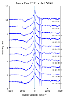

Another peculliar nova
Plateau at maximal luminosity, no jitters or oscillations at the date.
The various emission lines remain strong.
He I lines persist.

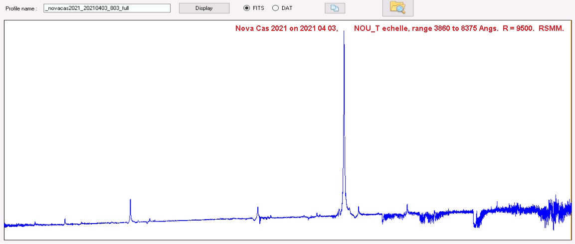

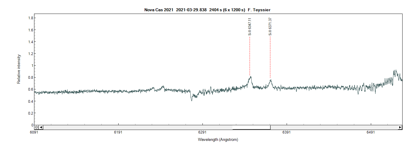

Variation of a few lines from Echelle spectra secured by Joan Guarro and François Teyssier at the remote station SMM-SP and Olivier Garde (2021-03-28.145)
Note the very fast changes in the absorption profiles in less than 1 day (spectra obtained on March, 28th.
Echelle spectrum secured by F. Teyssier with the remote station SMM-SP using the new echelle spectrograph designed and build by Joan Guarro:
It works well!
More details about this new wonderful tool: http://spectro-aras.com/forum/viewtopic ... 7&start=40

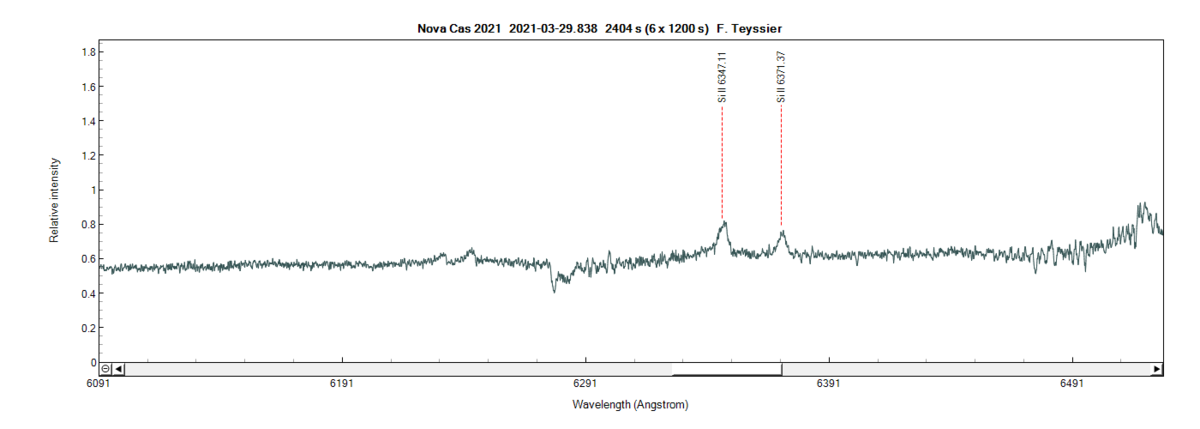

The various identification of lines are correct.
Note that even in low resolution spectra one can add Si II

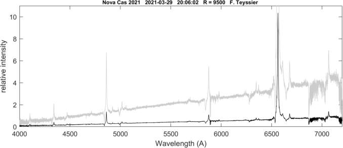

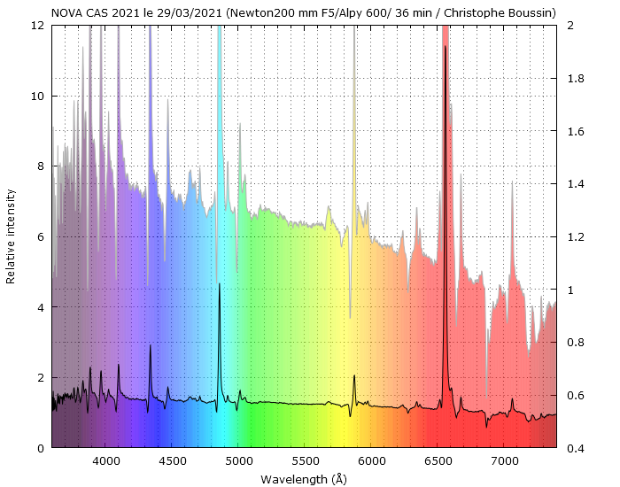

- Posts: 1424
Visible part of the spectrum for Mach 29.138 (Star'Ex 600 lines/mm spectrograph + Newton 200 mm):
Red and infrared spectrum for March 30.120 (Star'Ex 600 lines/mm - composite of two spectra):
Detail of Pashen series:

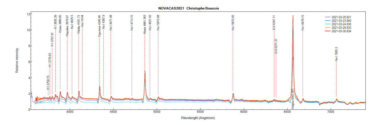

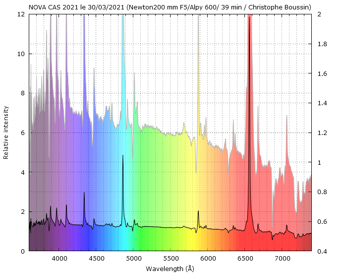

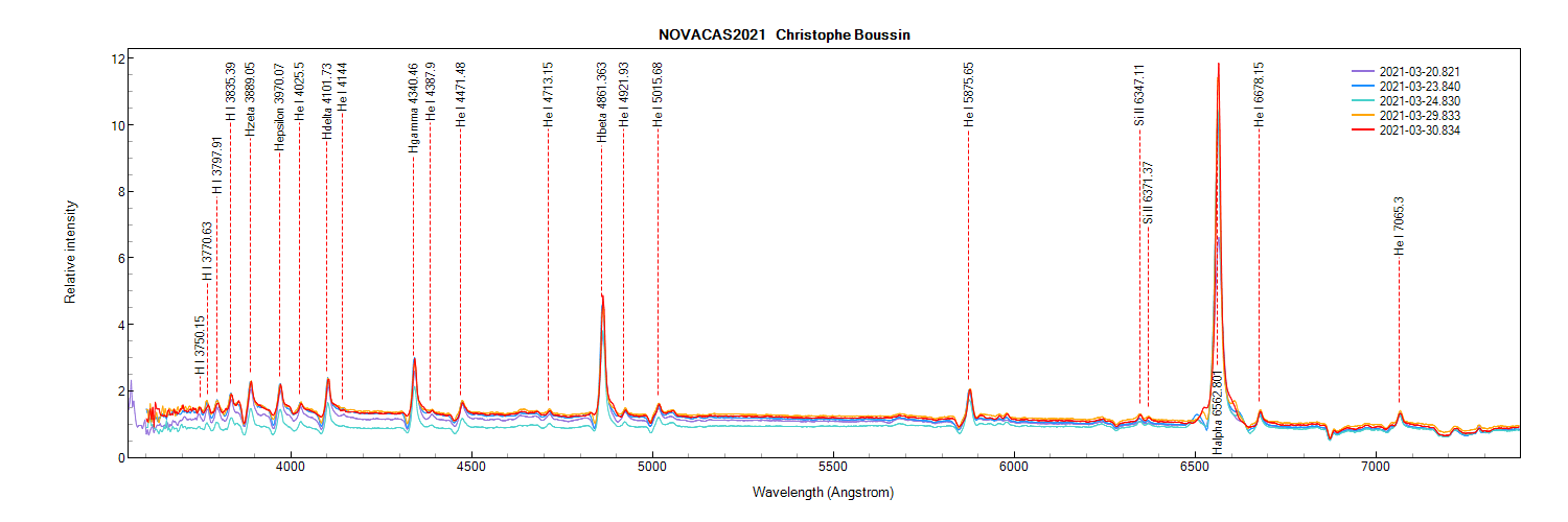

- Posts: 173

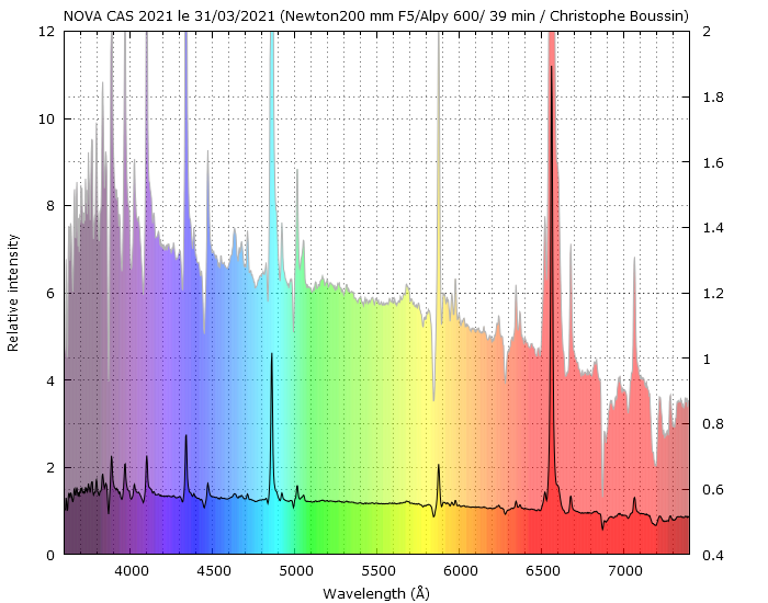

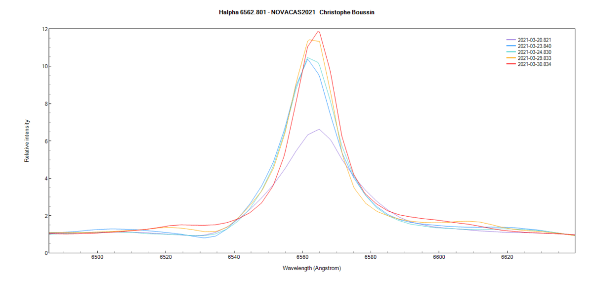

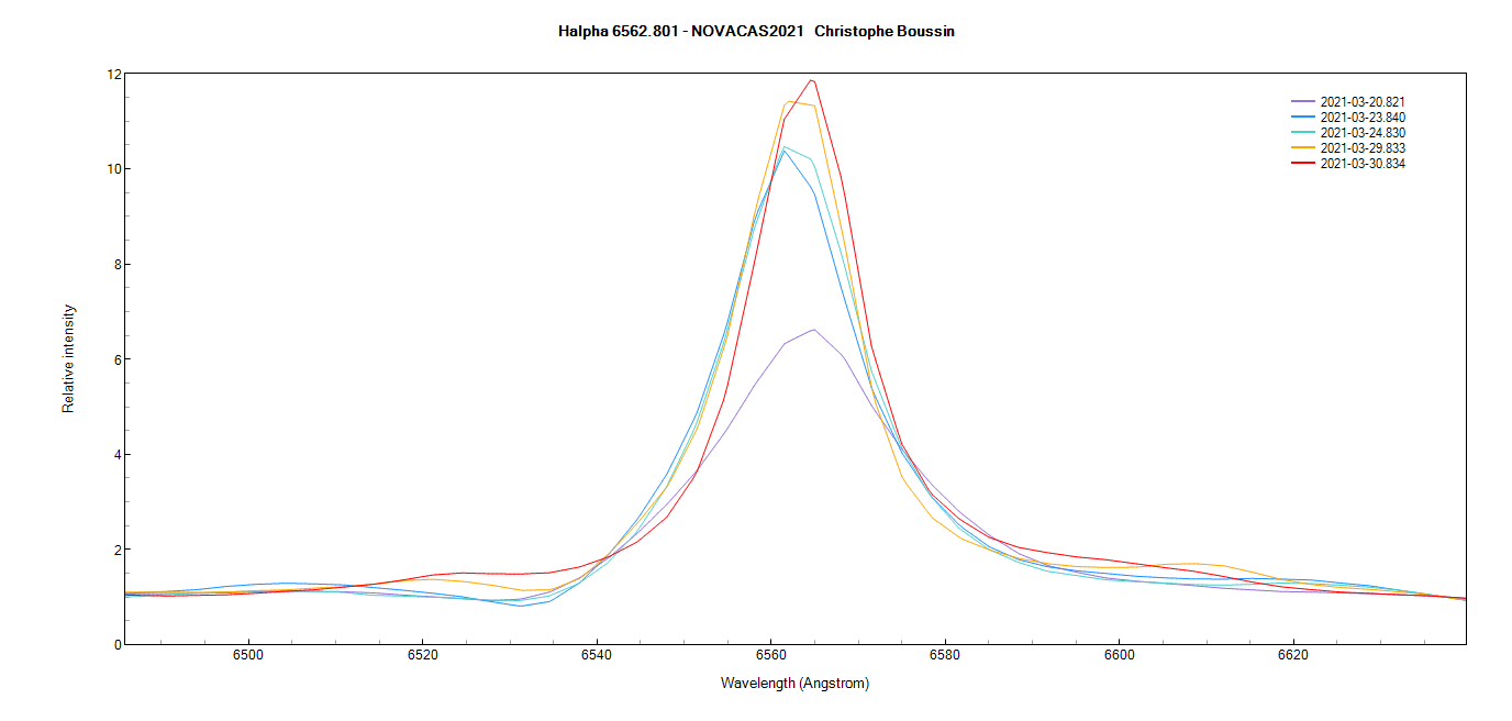

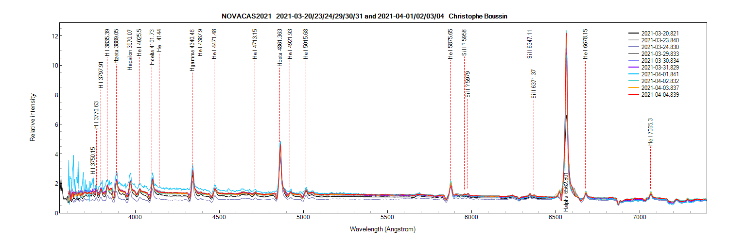

Here is my update for the monitoring of the nova Cas 2021.
The following spectra were obtained with my Alpy 600, respectively, the 29th of March at 20 h 00 TU (resolution of 528, JJ = 2459303.3334) with an acquisition time of 36 min (12 x 180s) and the 30th of March at 20 h 01 TU (resolution of 518, JJ = 2459304.334) with an acquisition time of 39 min (13 x 180s) :

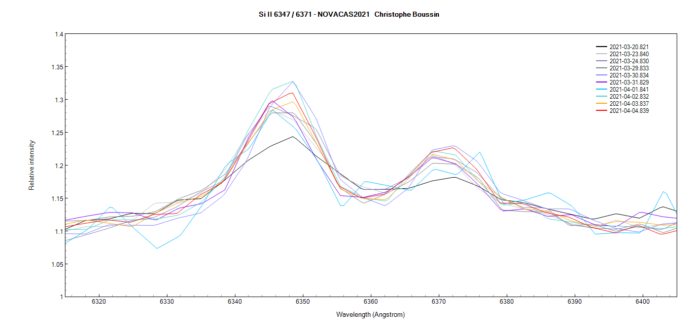

Evolution of the Nova Cas 2021 from March 20 to 30 with the addition of the identification of the Si II lines (see previous post by François Teyssier) :

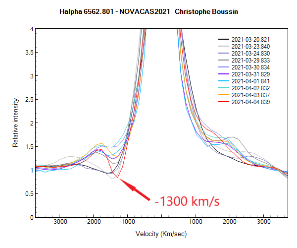

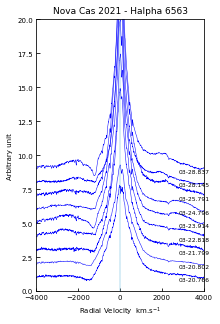

Evolution of the Halpha line : the changes are obvious even at low resolution !
Clear skies,
Clear skies,

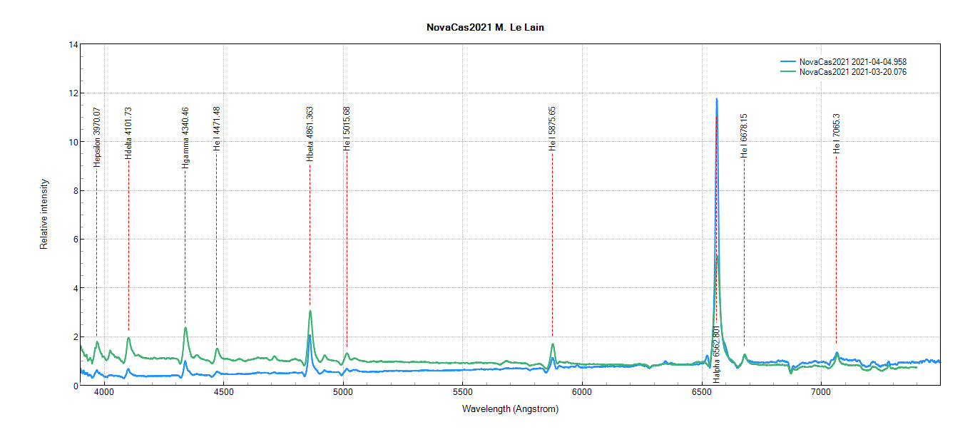

Matthieu Le Lain
- Posts: 24
- Joined: Mon Apr 15, 2019 4:33 pm

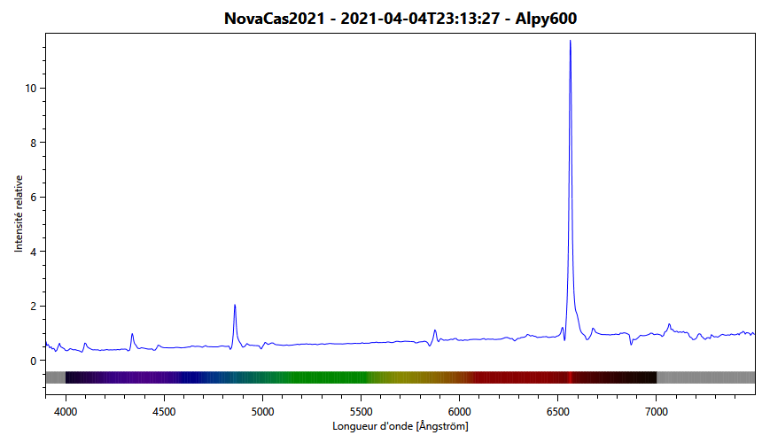

Very interesting all this data about the Nova and his evolution. Good follow Christophe
Here is a new spectrum of the Nova Cas 2021 with an Alpy600 the 4th of april, on C8 f/6.3 - Atik460Ex - 16 x 90s exp.
Matthieu
Matthieu

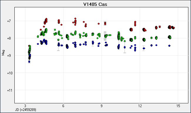

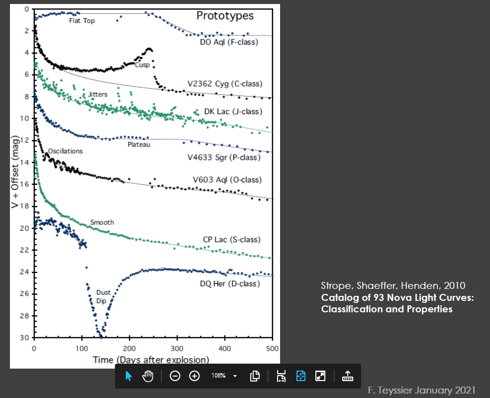

- Posts: 1562
A long plateau (and no oscillations) at max.
From my knowledge, it looks that the envelop remains at giant dimension (~ 1 uA as an order of magnitude) , doesn't recede (as in the case of a classical nova),
and emits a continuous wind (until the accreted material is burnt)
Of course this behavior deviates strongly from a "uniform model".
No problem, I'll have a place in Hell and good company.
Of course, daily coverage is strongly recommended! Even if (and because) the variations are very faint.
Thanks in advance,

- Posts: 731
That is Nova Cas 2021 two nights comparison, it seems there are a recurrent tendency to come back to a Halpha "P Cyg" situation.
Regards, J. Guarro.
Regards, J. Guarro.
- NOVACAS2021_20210403-06.jpg (66.57 KiB) Viewed 16145 times

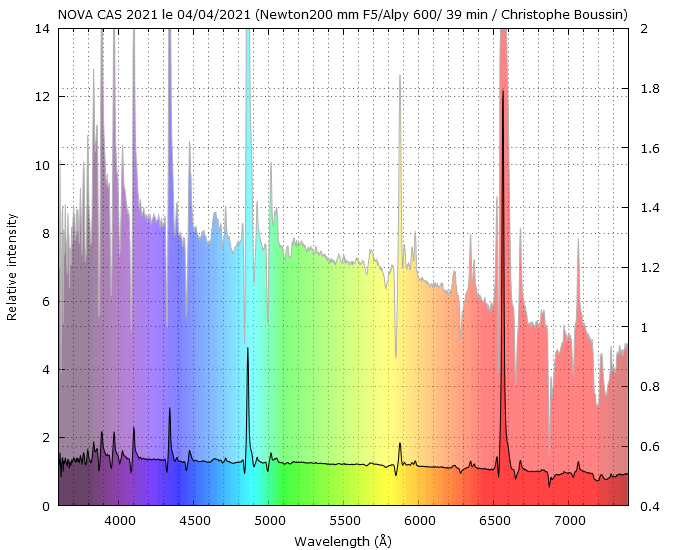

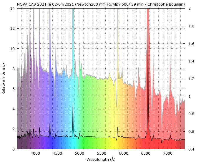

- Posts: 173
Thank you Matthieu, I also hope that you will be able to follow the evolution of this nova and make a presentation of it on your website stellartrip.net
Here is my new update for the monitoring of the nova Cas 2021.
The following spectra were obtained with my Alpy 600 :

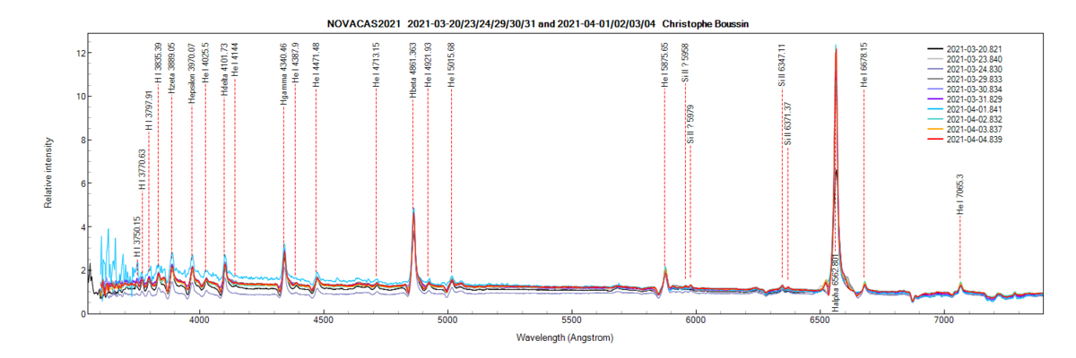

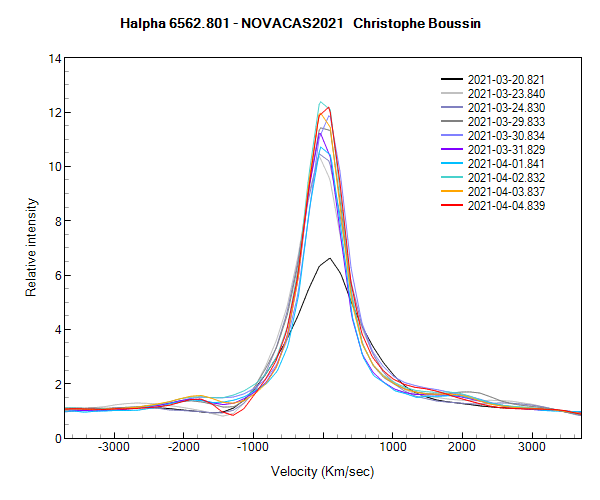

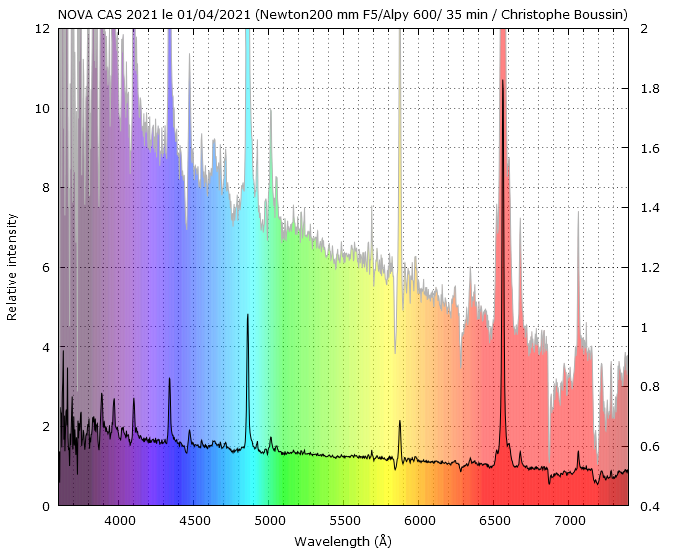

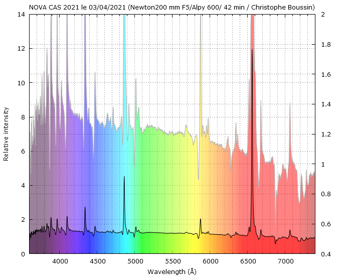

the 31th of March at 19 h 53 TU (resolution of 528, JJ = 2459305.3286) with an acquisition time of 39 min (13 x 180s) the 1st of April at 20 h 10 TU (resolution of 515, JJ = 2459306.3406) with an acquisition time of 35 min (7 x 300s) : the 2nd of April at 19 h 58 TU (resolution of 522, JJ = 2459307.3318) with an acquisition time of 39 min (13 x 180s) : the 3rd of April at 20 h 05 TU (resolution of 523, JJ = 2459308.3365) with an acquisition time of 42 min (14 x 180s) : the 4th of April at 20 h 09 TU (resolution of 526, JJ = 2459309.3394) with an acquisition time of 39 min (13 x 180s) : Evolution of the Nova Cas 2021 from March 20 to April 4 : François, thank you for these informations !

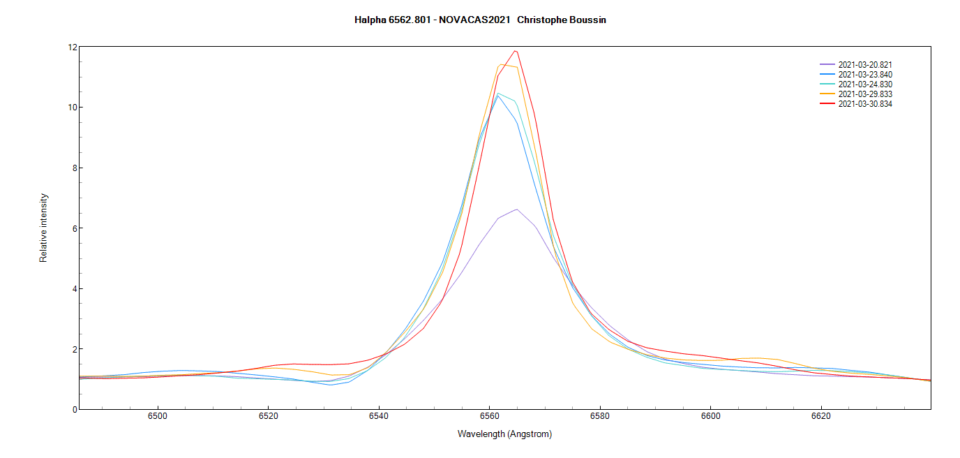

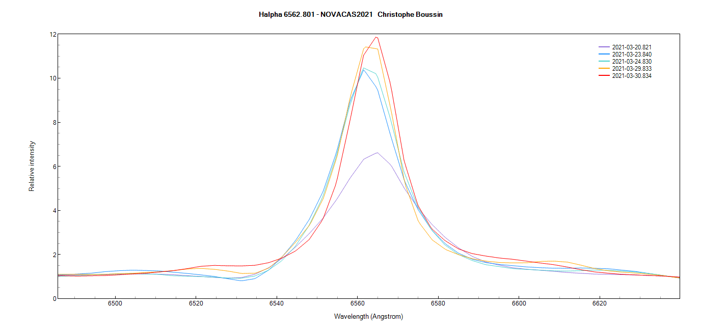

I note that the general appearance of the spectrum remains the same over the days with variations mainly visible on the Halpha line.
Evolution of the Halpha line : Joan, I agree the P Cyg profile is once again clearly visible even at low resolution !

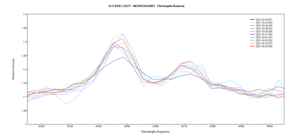

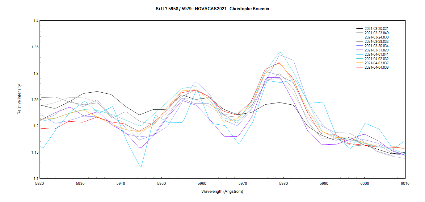

The Si II lines at 6347 and 6371A are still clearly visible. And, it also seems to me that 2 other lines of Si II at 5958 and 5979A are visible in the spectrum of the nova... ? Unfortunately, the weather did not allow me to continue this daily monitoring...
I hope others spectroscopists will have better luck !!
Clear skies to all !!
