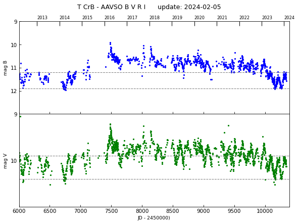

- Posts: 1562
Re: T CrB before its new nova event

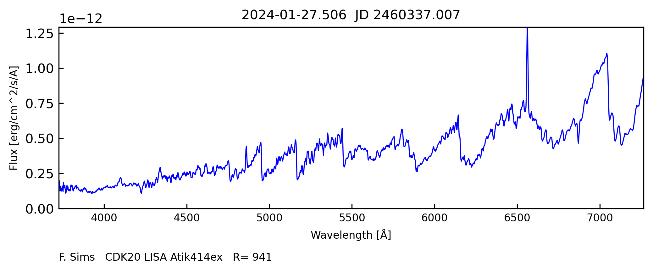

The new season of observations after the solar conjunction is begining.
Since the detection of the end of the high state (2015-2023), T CrB evolves in the same way as before the high state with orbital variations of the photometry and spectroscopic appearence.
First spectra for the new season were secured by Woody Sims.
The aspect of the spectrum (continuum and emission lines) are compliant with the spectroscopic evolution of the traget before the "big active phase" 2015-2023.
We undergo the monitoring before the next nova event. One key point of this monitoring is: Are there any warning signs of the outburst?
One spectrum (both low and medium resolution) by week should be a good cadency at this state.
For spectrographs with short wavelength range the zone 4600-5100 is recommended.
Flux calibrated spectra are a must. Due to the strong flickering (especially B and V) the photometry should be acquired during the acquisition of the spectrum (some duration) and the flux calibration should use mean or median value of the magnitude V.

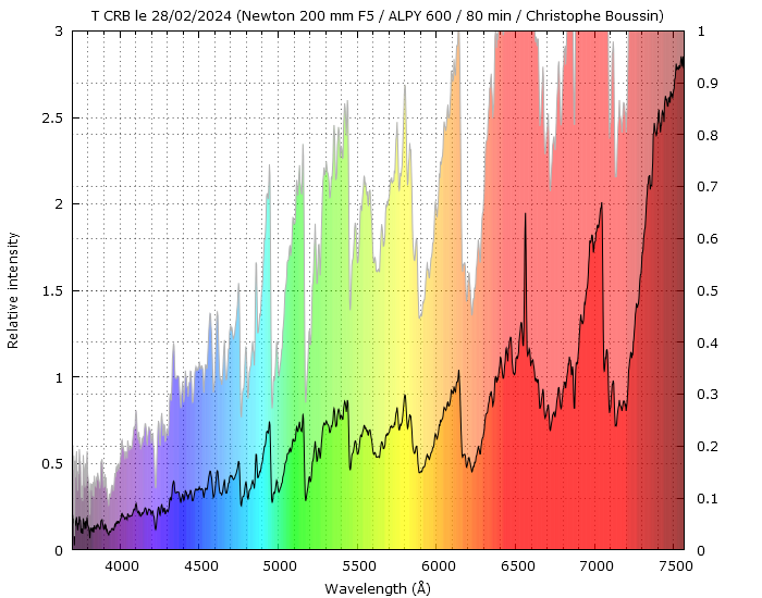

- Posts: 173
The weather forecast isn't looking good for me at the moment...so when an opportunity presents itself, I can't miss it !
So here's my first T CrB spectrum for the year 2024, obtained with my Alpy 600 on February 28 (resolution of 515, JJ = 2460368.5673) and an acquisition time of 80 min (8 x 600 s) :
Clear skies,
Clear skies,

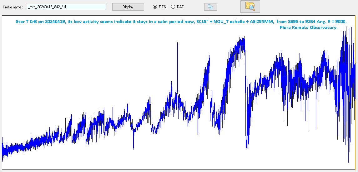

- Posts: 731
Hello at all,
The T CrB outburst current year predictions has grown the interest for this star, as the same that the observers who targeted it I found T CrB in a really normal state until now.
Also you can see in its spectrum how the ASI294MM works, the graphic is the result of 6 x 1800 seconds integrations with this camera.
Meanwhile I took V photometry, improveable in my opinion, it was made by an old NIkon 300mm. F/4 objective, Bessel-V filter and an ATIK460EX camera. I hope to show better results from it in the future.
Regards J.Guarro.
Regards J.Guarro.
- T CRB20240419.png (44.76 KiB) Viewed 17224 times
- T CRB 20240419.gif (13.71 KiB) Viewed 17224 times

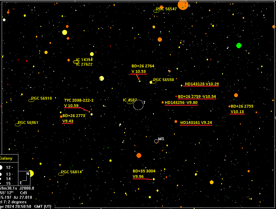

- Posts: 731
Hi again,

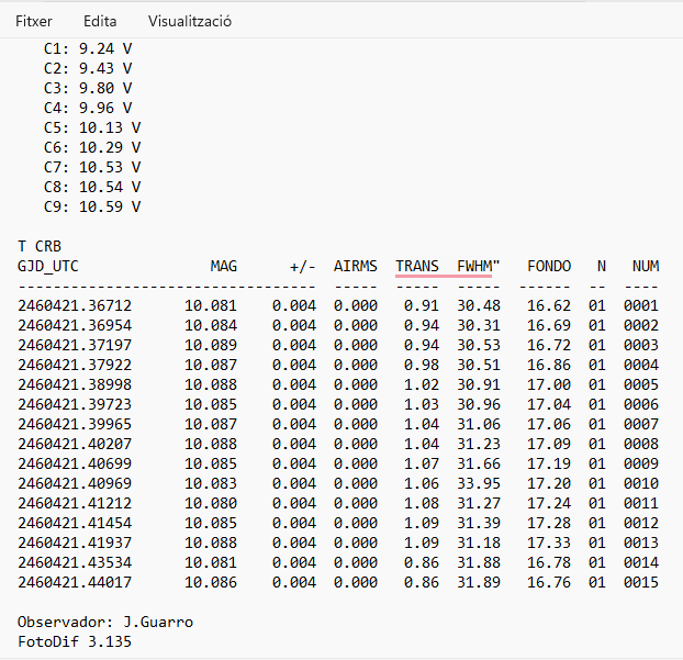

As a curiosity, I used these stars as a V photometric comparison.
J.G.
J.G.

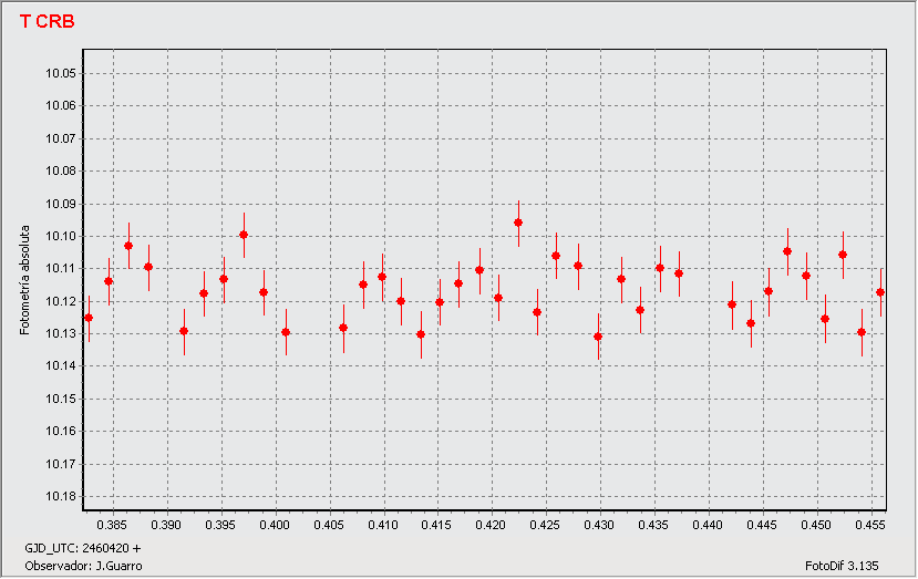

- Posts: 731

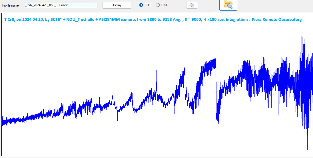

These are yesterday night's T CrB outcomes, its spectroscopy graphic, is only by 4 x1800 seconds integrations, due to the night becoming cloudy, despite it, the photometric measures have one reasonably good dispersion of +/- 4 thousandths of V magnitude.
Best regards, J.Guarro.
- TCRB 20240420.png (41.4 KiB) Viewed 17192 times
- TCRB_PH_20240420.png (31.28 KiB) Viewed 17192 times
- T CRB 20240420.gif (15.23 KiB) Viewed 17192 times

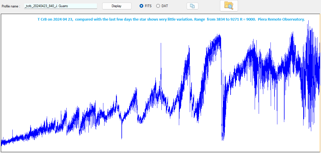

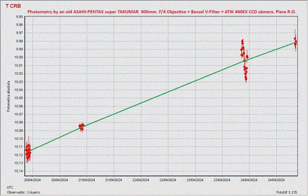

- Posts: 731

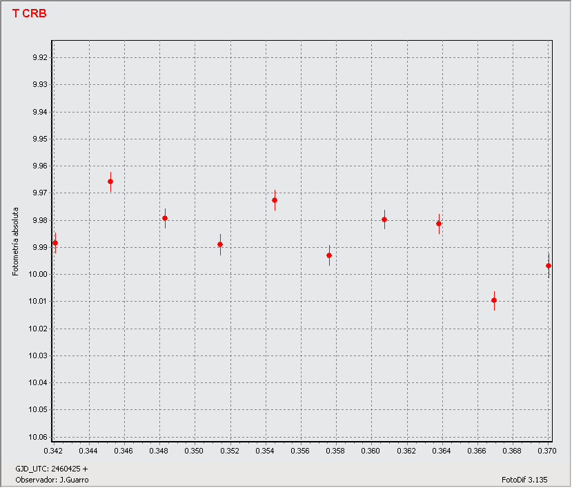

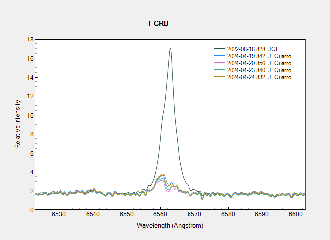

I've attached two graphics today, in the first one you can notice the notable difference between T CrB H Alpha activity on 2022 08 18 and the current little oscillations on its weak signal nowadays.
In the second picture, there are only 10 photometric points taken in not more good conditions. The weather is changing here for the next few days.
Regards, J.Guarro.
Regards, J.Guarro.
- comparison.png (29.21 KiB) Viewed 17140 times
- T CRB 20240424.gif (14.49 KiB) Viewed 17140 times

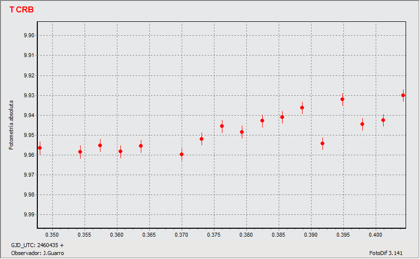

- Posts: 731
Unfortunately, bad weather persists here for a lot of weeks, and the forecasts can't say how many times it will last.
Meanwhile, I attached here this graphic where I gathered these four photometric observations, you can see a change in magnitude tendency that is difficult to notice to see them separately.
From my point of view, monitoring this star, or other ones, with spectroscopy and photometry could be useful to their study, it could be very good complementary AAVSO information.
Photometry is easy to obtain at the same time one is taking spectroscopy and could give surprising outcomes, due to, in my case, I need to give between two to three hours to take a spectrographic observation of T CrB and other similar weak stars with my equipment, it permitted take sufficiently long photometric sequences too.
Regards, J.Guarro.
Regards, J.Guarro.
- T CRB_TENDENCE4days.gif (137.24 KiB) Viewed 16560 times

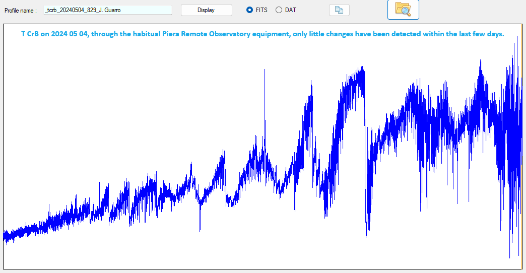

- Posts: 731
T CrB seems to be a relaxed season despite little variations in its Hydrogen lines.
Photometry is moving too, the empty is due to bad weather.
Cheers, J. Guarro.
Cheers, J. Guarro.
- TCRB 20240504.png (36.19 KiB) Viewed 16449 times
- T CRB 20240504.gif (12.55 KiB) Viewed 16449 times
