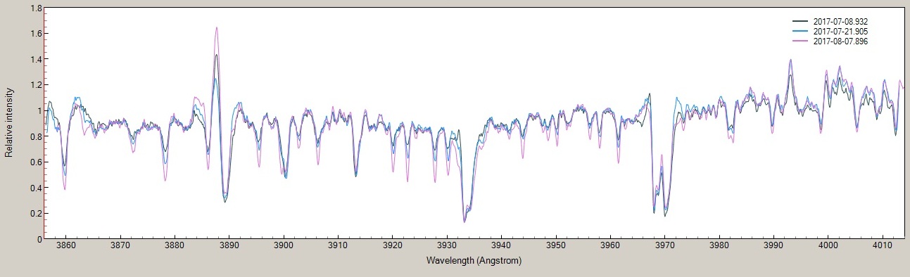

- Posts: 420
Re: VV Cep: Fe absorptions increase around Ca II doublet

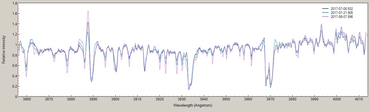

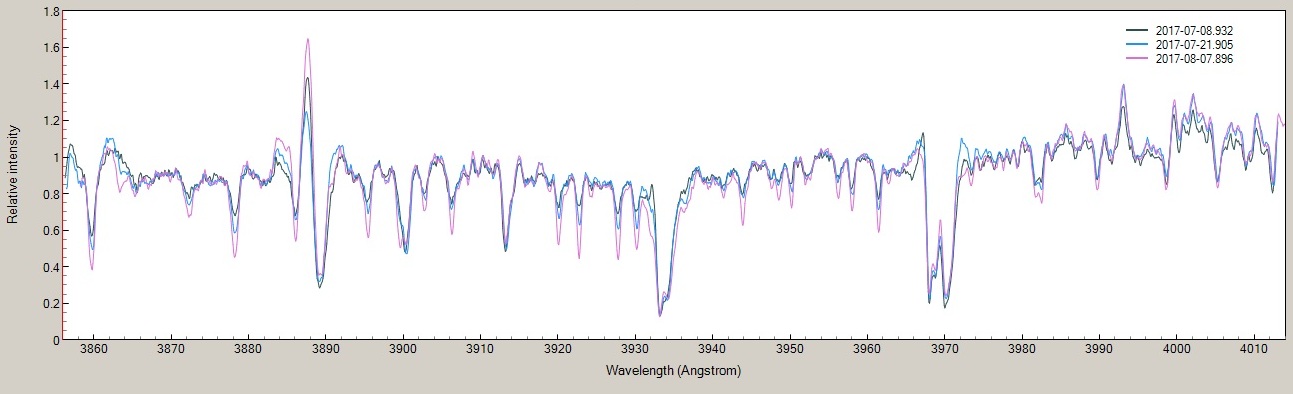

Result from this week:
Seems the Fe I depth increased further (linearily by eye - to measure later), whilst the TiII 3900, 3913 mostly unchanged.
Don't draw too far conclusions of these 3 "well chosen" spectra (other than increasing absorptions), chosing other set of spectra have different shortterm variations even on the continuum, but especially on the main features.
Cont. observation 1-2 weekly. Meanwhile started also a serie for the 3700-3860A region as well, however I may shoot that part less frequent.
- Peter
- Peter

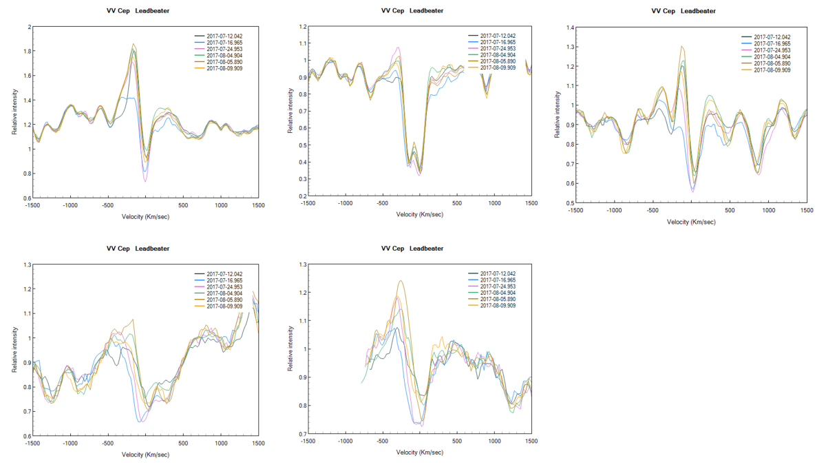

Hi Peter, Ernst
As you know, I am also following this region as suggested by the PI for the AZCas campaign Dr Cezary Galan, Nicolaus Copernicus University, Poland
http://www.threehillsobservatory.co.uk/ ... tra_43.htm
I am not seeing much change in this region yet except for some large and fast variations in the Balmer line profiles which seem larger than at H alpha. (AZCas showed no emission in these Balmer lines.) See attached Hdelta -H10. In particular the event on 20170716 for example. Did anything happen at H alpha on that date ?
EDITED to correct the Balmer line nomenclature
- VVCep_H4-H8.png (228.57 KiB) Viewed 39427 times
Last edited by Robin Leadbeater on Sat Aug 12, 2017 6:46 pm, edited 1 time in total.

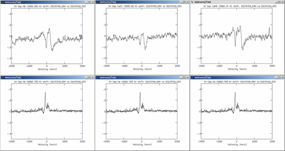

As an example - and to satisfy Robin's questions what happened on 07.16, I've quickly generated this difference graph (sorry for the size, this is what I could generate for now): These graphs are differences to a somewhat "typical" state (2017.07.08) and a somewhat "exceptional" one (2017.07.15-16 night). I did see such an "exceptional" state on 2016.10.30 as well.
What is easily seen, a huge inverse P-Cyg profile (like a 800 km/s) happening on that exceptional day (both H5 and H6 shows - they confirm each other), whilst H-alpha velocity differences are small (+/- 100 km/s range) and CaII also moderate.
Feel free to download these spectra from the ARAS database, just got refreshed yesterday.

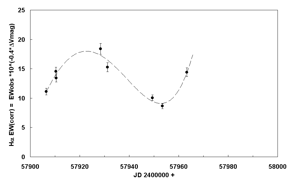

- Posts: 461
Hi Robin & Peter,
to my surprise, the Vmag-corrected Halpha flux shows within of a comparable time window a cyclic variability with a minimum approx. to that time, which Robin emphasized (JD 2457953). See the following Fig. Robin & Peter:
I would recommend to extend your analysis once more corresponding to the time window I am showing here.
Once more: accretion disk plus Be star disk?

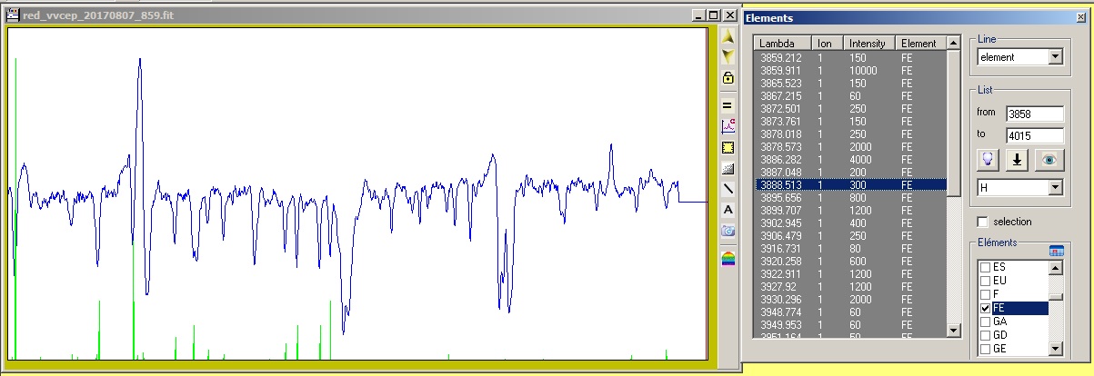

Please give me some time (already playing around), basically the red part of H6 (= big absorption) show any correlation, but I doubt an absorption was connected to Halpha, and too few checkpoints I have there yet (only 6).

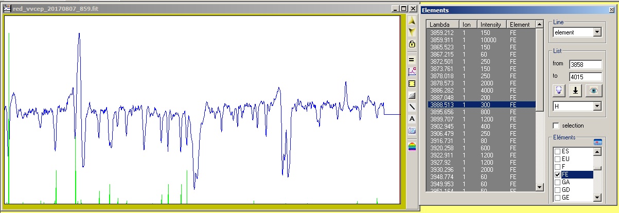

Currently what I'm stumbled into, that Fe line really needs removal (= it's after reducing Alp Ori by usual 1/6 multiplier - continuum much better after that):
Maybe I'll just manually fix that line at 3886.2A... nicer would be a tool (sth. like ISIS/H2O removal but with these Fe lines), pls let me know anybody if aware of such.
Cont. efforts later.
- Peter
