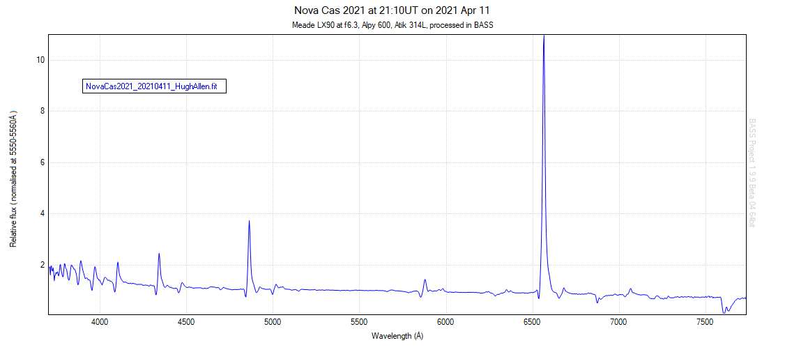

Nova Cas 2021 Alpy spectrum evening of 2021 Apr 11
Post by HughAllen »
Here is my latest Alpy spectrum of Nova Cas 2021 at 23deg above my northern horizon. Continued Balmer and HeI emission all with strong P Cygni profiles, such a stable nova!
Nova Cas 2021 on 2021 Apr 11 21.10UT.png (25.77 KiB) Viewed 42865 times
Hugh Allen

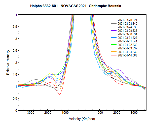

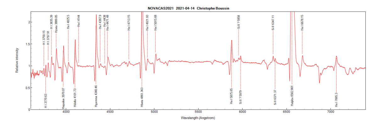

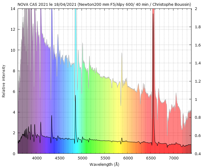

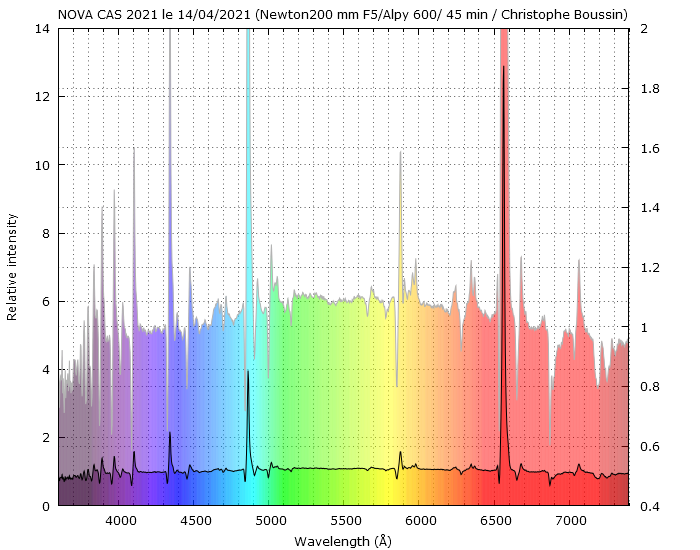

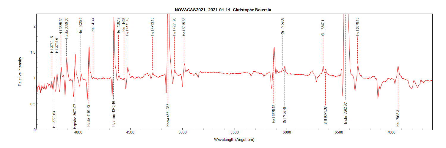

Post by Christophe Boussin »
Nice spectrum Hugh because the nova cannot be caught so easily above the horizon in the early evening !
For me, the nova now becomes observable in better conditions in the second part of the night and so, the following spectrum was obtained the 14th of April at 1 h 38 TU (resolution of 525, JJ = 2459318.568) with my Alpy 600 and an acquisition time of 45 min (15 x 180s) :

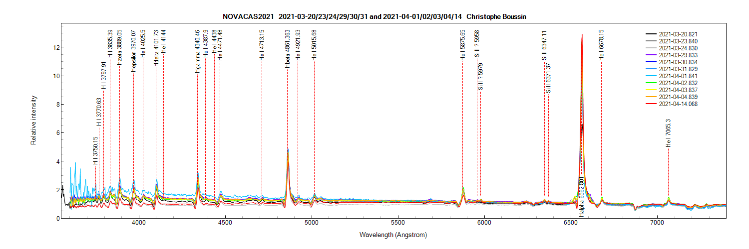

Nova Cas 2021 on April 14th, 2021
_novacas2021_20210414_068_Christophe Boussin_3600_7395.png (85.16 KiB) Viewed 42815 times
Nova Cas 2021 on April 14th, 2021 (zoom)
The Si II lines at 5958 (?), 5979 (?), 6347 and 6371A are still clearly visible.

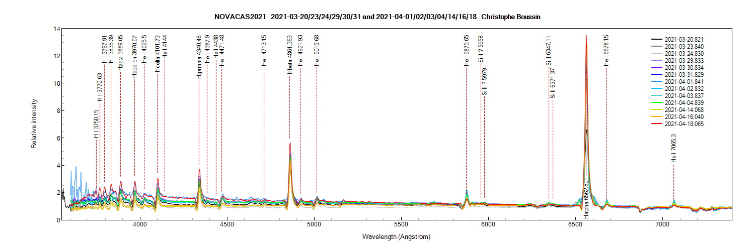

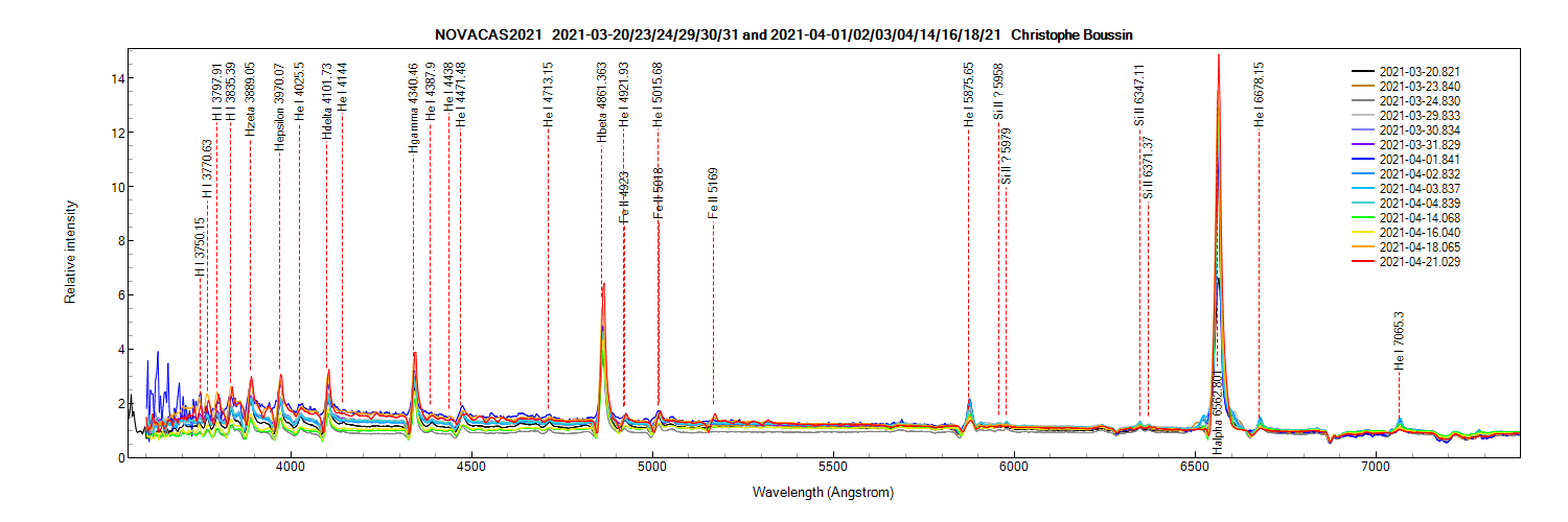

Evolution of the Nova Cas 2021 from March 20 to April 14 :
Nova Cas 2021 on March 20th, 23th, 24th, 29th, 30th, 31th and on April 1st, 2nd, 3rd, 4th and 14th 2021 (identification of some lines from PlotSpectra)
The general appearance of the spectrum remains steadly the same over the days.

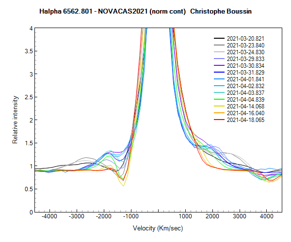

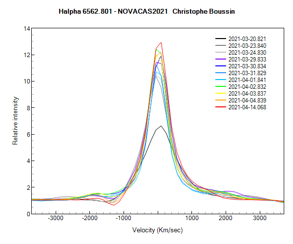

Evolution of the Halpha line :
Halpha line on March 20th, 23th, 24th, 29th, 30th, 31th and on April 1st, 2nd, 3rd, 4th and 14th 2021
novacas2021_20210414_068_Christophe Boussin_Halpha_vitesse.png (46.26 KiB) Viewed 42815 times
Halpha line on March 20th, 23th, 24th, 29th, 30th, 31th and on April 1st, 2nd, 3rd, 4th and 14th 2021 (zoom)
novacas2021_20210414_068_Christophe Boussin_Halpha_vitesse_zoom.png (53.36 KiB) Viewed 42815 times
Since April 4, the P Cyg profile of the Halpha line shows little changes at low resolution.
Clear skies to all !!

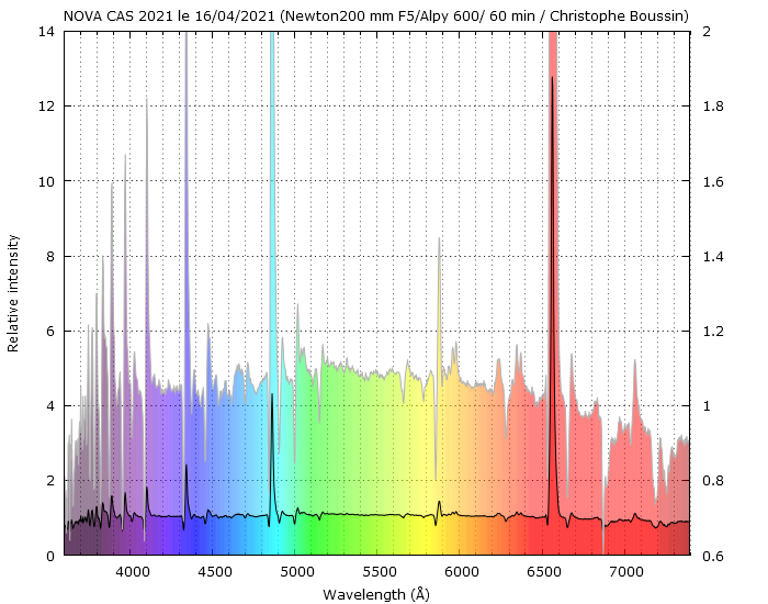

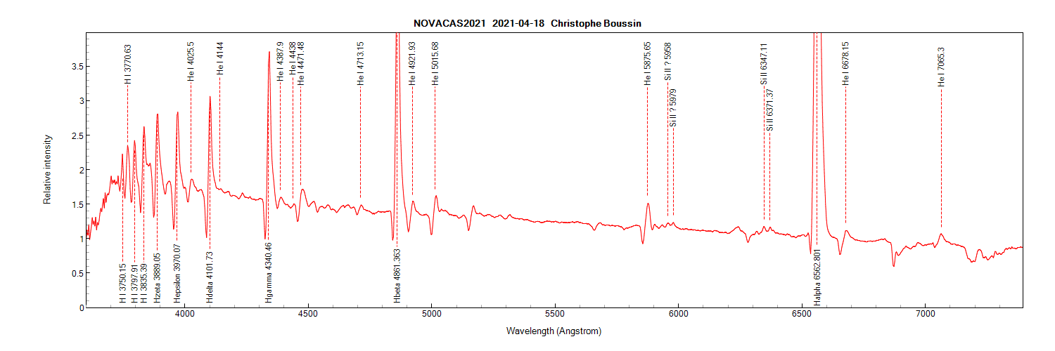

Here is my update for the monitoring of the Nova Cas 2021 with two new spectra.
The first one was obtained the 16th of April at 0 h 58 TU (resolution of 512, JJ = 2459320.5402) with my Alpy 600 and an acquisition time of 60 min (12 x 300s) :
Nova Cas 2021 on April 16th, 2021
_novacas2021_20210416_040_Christophe Boussin_3600_7395.png (84.07 KiB) Viewed 42743 times

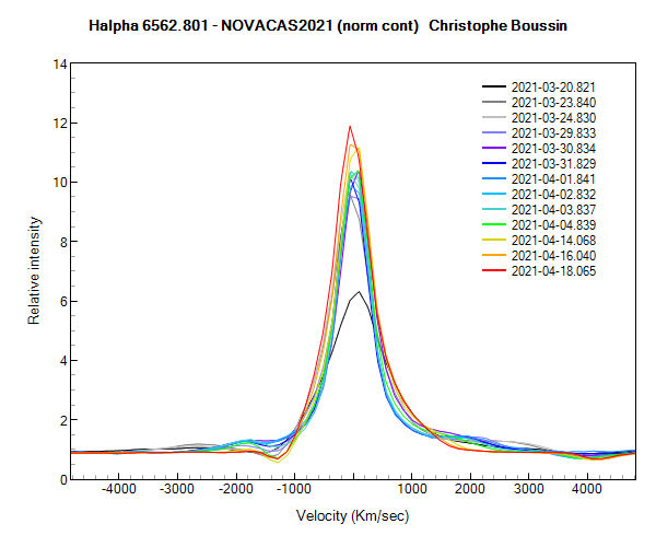

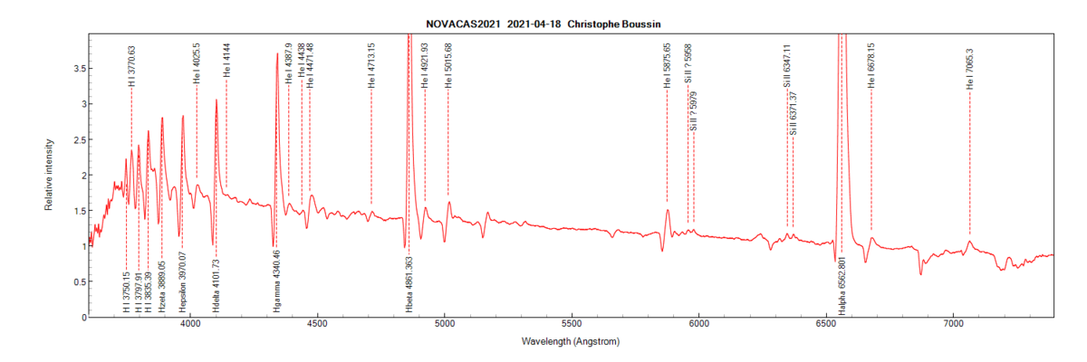

and the second one was obtained the 18th of April at 1 h 33 TU (resolution of 522, JJ = 2459322.5645) with my Alpy 600 and an acquisition time of 40 min (20 x 120s) :
Nova Cas 2021 on April 18th, 2021
_novacas2021_20210418_065_Christophe Boussin_3600_7395.png (98.89 KiB) Viewed 42743 times
Nova Cas 2021 on April 18th, 2021 (zoom)

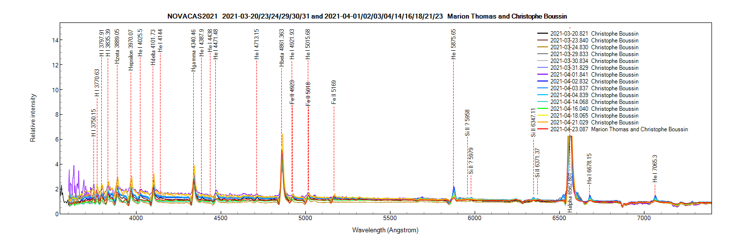

Evolution of the Nova Cas 2021 from March 20 to April 18 :
Nova Cas 2021 on March 20th, 23th, 24th, 29th, 30th, 31th and on April 1st, 2nd, 3rd, 4th, 14th, 16th and 18th 2021 (identification of some lines from PlotSpectra)
Halpha line on March 20th, 23th, 24th, 29th, 30th, 31th and on April 1st, 2nd, 3rd, 4th, 14th, 16th and 18th 2021
novacas2021(normcont)_20210418_065_Christophe Boussin_Halpha_vitesse.png (45.09 KiB) Viewed 42743 times
Halpha line on March 20th, 23th, 24th, 29th, 30th, 31th and on April 1st, 2nd, 3rd, 4th, 14th, 16th and 18th 2021 (zoom)
novacas2021(normcont)_20210418_065_Christophe Boussin_Halpha_vitesse_zoom.png (57.62 KiB) Viewed 42743 times

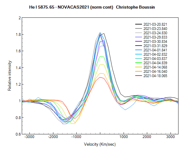

I note a decrease in the relative intensity of the HeI lines as well as a displacement of the "blue" part of the P Cyg profile (here on the HeI line at 5876A).
HeI line at 5876A on March 20th, 23th, 24th, 29th, 30th, 31th and on April 1st, 2nd, 3rd, 4th, 14th, 16th and 18th 2021
novacas2021(normcont)_20210418_065_Christophe Boussin_HeI_5876.png (57.25 KiB) Viewed 42743 times

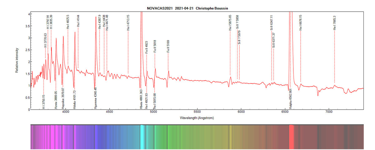

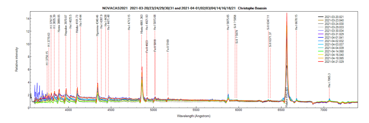

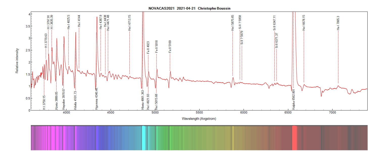

Here is my last spectrum of the Nova Cas 2021 obtained the 21th of April at 0 h 42 TU (resolution of 518, JJ = 2459325.5292) with my Alpy 600 and an acquisition time of 60 min (20 x 180s) :
Nova Cas 2021 on April 21th, 2021
_novacas2021_20210421_029_Christophe Boussin_3600_7395.png (101.15 KiB) Viewed 42598 times
Nova Cas 2021 on April 21th, 2021 (zoom)
The FeII line at 5169 A is clearly visible in the spectrum of the Nova Cas 2021 and the Fe II lines at 4923 and 5018 A are blended with the helium lines.
Evolution of the Nova Cas 2021 from March 20 to April 21 :
Nova Cas 2021 on March 20th, 23th, 24th, 29th, 30th, 31th and on April 1st, 2nd, 3rd, 4th, 14th, 16th, 18th and 21th 2021 (identification of some lines from PlotSpectra)

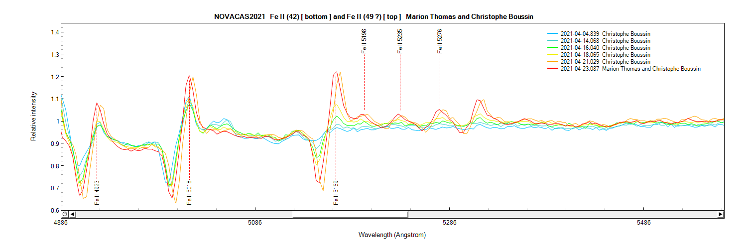

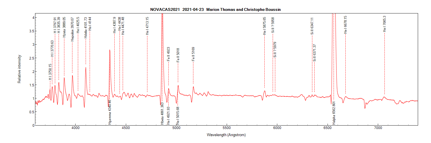

Posts: 173

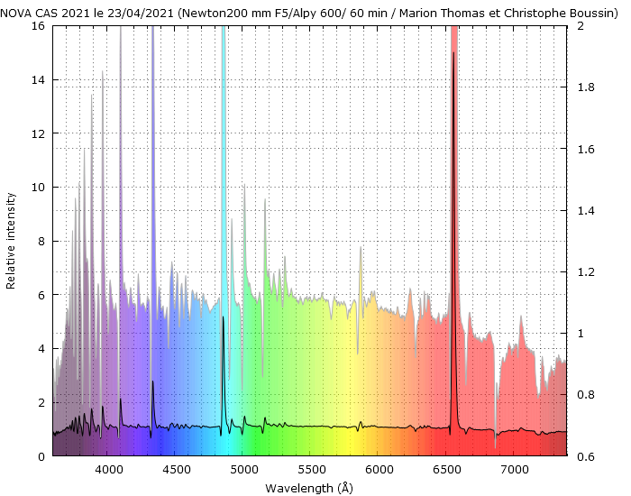

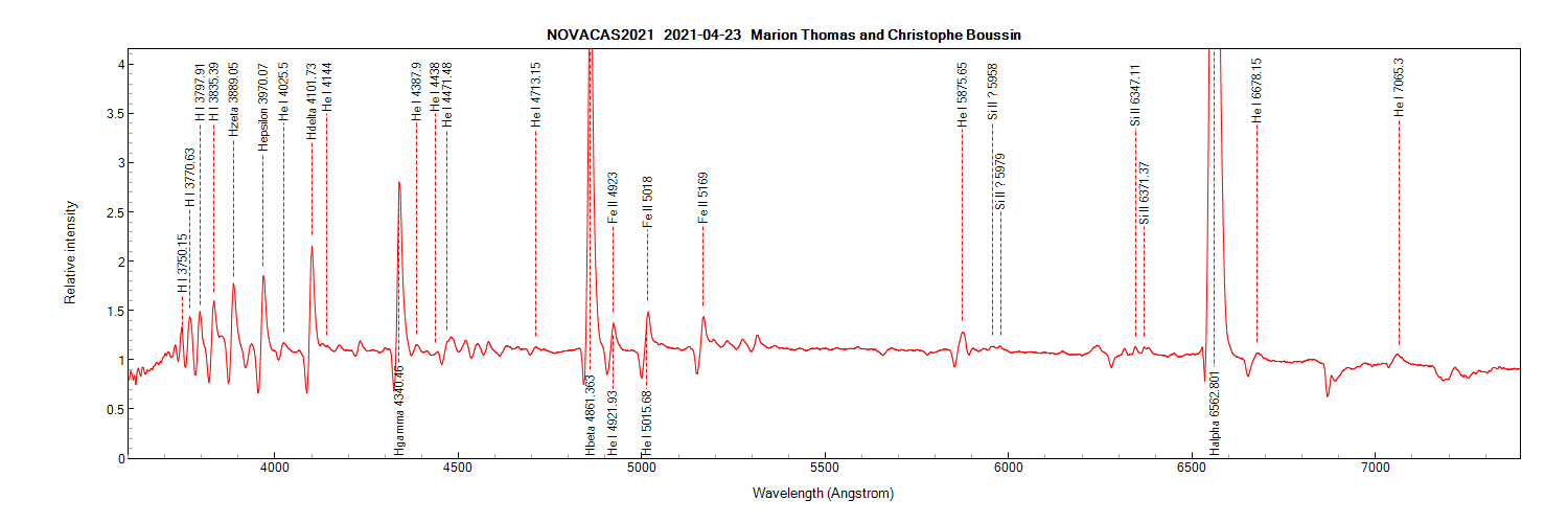

Here is our last spectrum of the Nova Cas 2021 obtained the 23th of April at 2 h 05 TU (resolution of 517, JJ = 2459327.5868) with an Alpy 600 and an acquisition time of 60 min (30 x 120s) :
Nova Cas 2021 on April 23th, 2021
_novacas2021_20210423_087_Marion Thomas and Christophe Boussin_3600_7395.png (91.79 KiB) Viewed 42536 times
Nova Cas 2021 on April 23th, 2021 (zoom)
Back to...the past, the Fe II line (42) at 5169A is visible from April 16 in our spectra...
The FeII lines (42) at 4923, 5018 and 5169 A have remained broadly unchanged since our last spectrum on April 21.
Fe II (42) and (49 ?) lines on April 4th, 14th, 16th, 18th, 21th and 23th 2021(zoom)
Could Fe II (49) lines be visible in our latest spectra ?

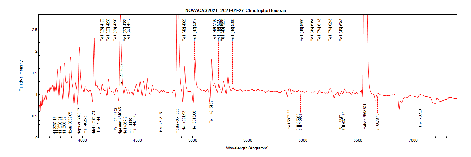

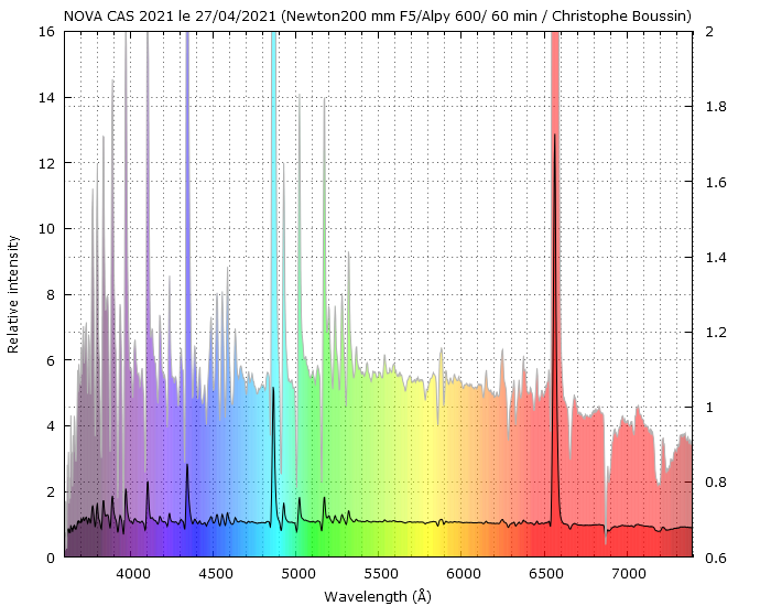

Here is my last spectrum of the Nova Cas 2021 obtained the 27th of April at 1 h 10 TU (resolution of 534, JJ = 2459331.5488) with an Alpy 600 and an acquisition time of 60 min (30 x 120s) :
Nova Cas 2021 on April 27th, 2021
_novacas2021_20210427_049_Christophe Boussin_3600_7395.png (98.25 KiB) Viewed 42286 times
Nova Cas 2021 on April 27th, 2021 (zoom)

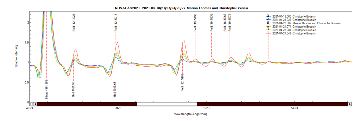

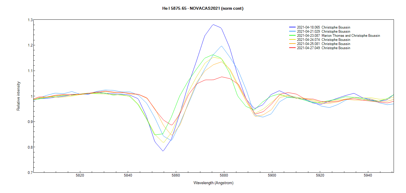

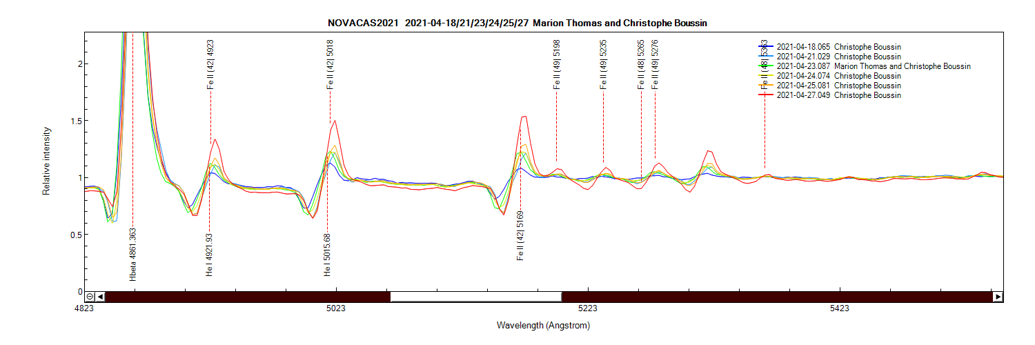

The relative intensities of the FeII lines have clearly increased since April 25 !
Evolution of FeII lines (42) between April 18 and 27 :
Fe II (42) lines on April 18th, 21th, 23th, 23th,24th, 25th and 27th 2021(zoom)

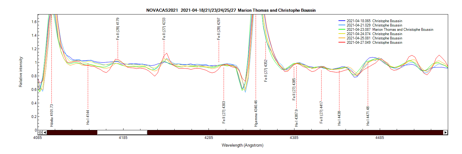

Evolution of FeII lines (27) and (28) between April 18 and 27 :
Fe II (27) and (28) lines on April 18th, 21th, 23th, 23th,24th, 25th and 27th 2021(zoom)

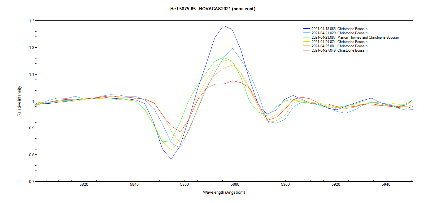

At the same time, the relative intensities of the HeI lines have significantly decreased !
Evolution of the HeI line at 5876A (for example) :
He I line at 5876A on April 18th, 21th, 23th, 23th,24th, 25th and 27th 2021(zoom)
