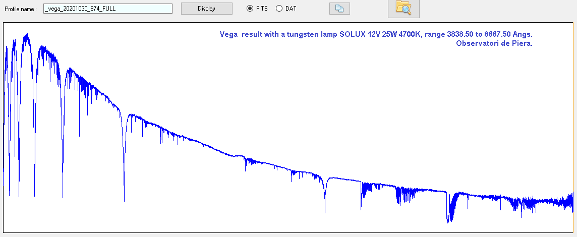

- Posts: 731
Sure you know the plates of our Schmidt-Cassegrains and their AR tratament are a border for blue and violet light but some part of this light achieves pass, that is C. Buil says in his excellent reporthere.
http://www.astrosurf.com/buil/asi6200mm/.
He also explains really efficient techniques for improve our echelle results and shows us the way to improve our ones.
I have changed the tungsten lamp OSRAM 3300K for one SOLUX 12V 35W 4700K and I achieved 3836 Ang. in the violet light in Vega. For more good results in the infrared region I need to focus better on this spectra part in detriment of the rest. The size of ATIK460EX sensible area is not big enough and is not permitted to get the Orders 25 and 24.
The other hand, the solid construction of the NOU_T, it has that it is not necessary do any more precautions for their stability about temperature changes, for example, this last night I have observed Vega, P Cyg, VV Cep and Gam Cas, I have started at UT 20:58:07 and finished at UT 00:34:10. Non, I am measuring their RELCO images and the reference light point in all of themis exactly the same, X = 668. Y = 831, the temperature had changed 2.5Cº. You have to keep in mind that the telescope and the NOU_T, they always are moving together.
I show here one new CHECK2, its current resolution and its graphic.
Greetings, J.Guarro.

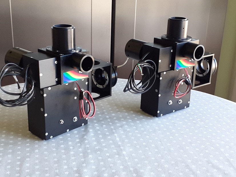

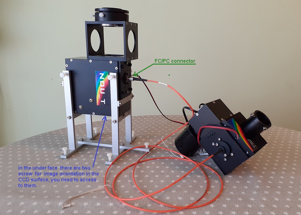

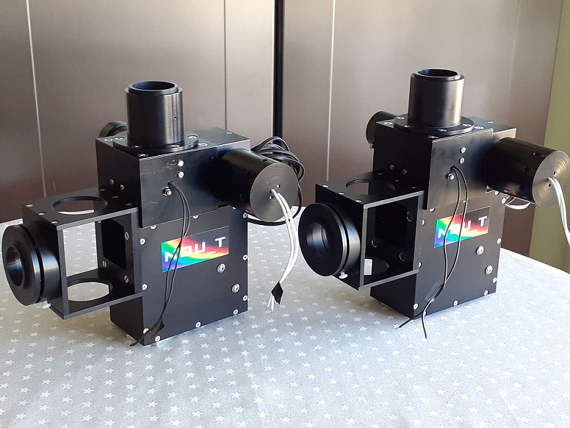

- Posts: 731
You can see the first two of the five NOU_T echelles with the mechanicals parts finished.
One of them is for one observer of this Forum and another is for the Santa Maria M. telescope.
I hope to show here the first light results in a few weeks.
Cheers, J. Guarro.
Cheers, J. Guarro.

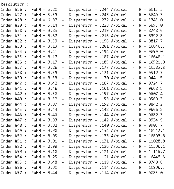

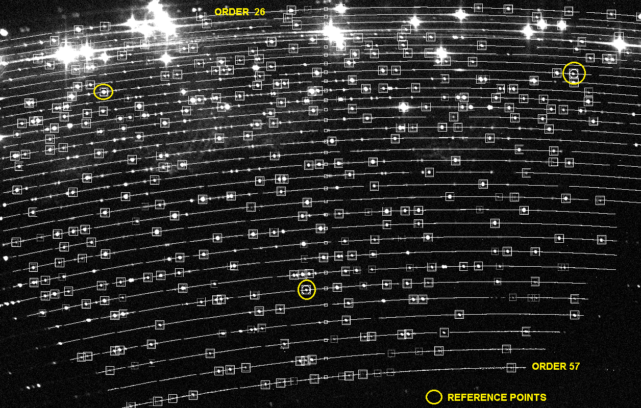

- Posts: 731

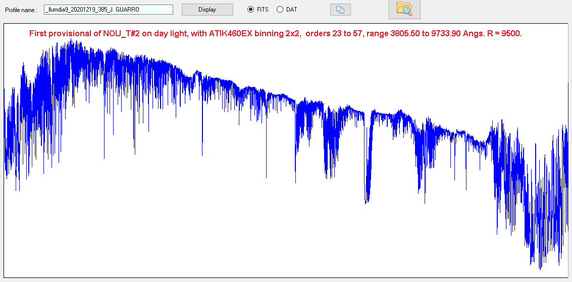

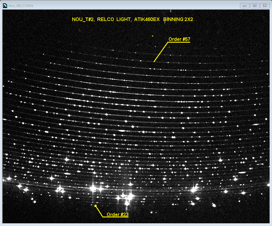

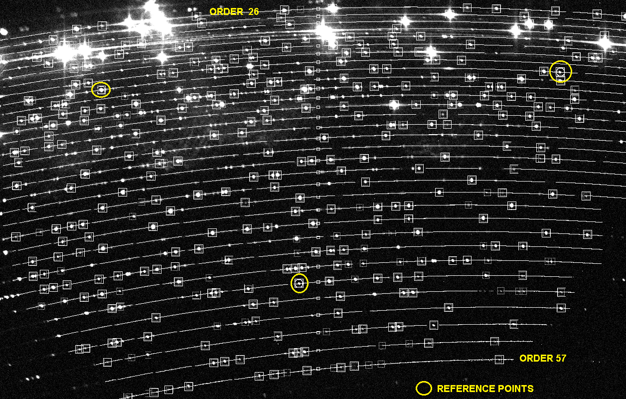

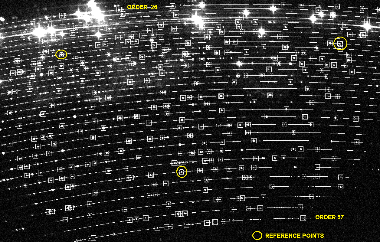

Today I can show here a provisional result of NOU_T#2 from daylight with one ATIK460EX binning 2x2. Only with a little conceptual modification it can achieve reach of Orders 23 to 57, in other words, from 3805 to 9733 Angstroms !
Of course, that little solution is also applicable at NOU_T#1 and at NOU_T#3 hwo I have sent to the observer of this Forum. I hope that in the practic the three ones work well in this sense.
Cheers, J. Guarro.
Resolution :
Order #23 : FWHM = 3.63 - Dispersion = .325 A/pixel - R = 8080.2
Order #24 : FWHM = 4.14 - Dispersion = .313 A/pixel - R = 7046.4
Order #25 : FWHM = 3.45 - Dispersion = .299 A/pixel - R = 8509.4
Order #26 : FWHM = 3.61 - Dispersion = .285 A/pixel - R = 8194.4
Order #27 : FWHM = 3.90 - Dispersion = .276 A/pixel - R = 7548.2
Order #28 : FWHM = 3.57 - Dispersion = .266 A/pixel - R = 8222.7
Order #29 : FWHM = 3.03 - Dispersion = .263 A/pixel - R = 9468.5
Order #30 : FWHM = 2.97 - Dispersion = .253 A/pixel - R = 9750.1
Order #31 : FWHM = 3.11 - Dispersion = .242 A/pixel - R = 9396.4
Order #32 : FWHM = 3.08 - Dispersion = .234 A/pixel - R = 9523.1
Order #33 : FWHM = 2.99 - Dispersion = .227 A/pixel - R = 9807.7
Order #34 : FWHM = 3.09 - Dispersion = .224 A/pixel - R = 9332.7
Order #35 : FWHM = 3.16 - Dispersion = .213 A/pixel - R = 9326.4
Order #36 : FWHM = 3.21 - Dispersion = .206 A/pixel - R = 9230.6
Order #37 : FWHM = 3.30 - Dispersion = .199 A/pixel - R = 8997.8
Order #38 : FWHM = 3.67 - Dispersion = .194 A/pixel - R = 8105.9
Order #39 : FWHM = 3.46 - Dispersion = .194 A/pixel - R = 8383.1
Order #40 : FWHM = 3.59 - Dispersion = .184 A/pixel - R = 8303.0
Order #41 : FWHM = 3.53 - Dispersion = .180 A/pixel - R = 8407.4
Order #42 : FWHM = 3.51 - Dispersion = .184 A/pixel - R = 8095.8
Order #43 : FWHM = 3.41 - Dispersion = .174 A/pixel - R = 8583.3
Order #44 : FWHM = 3.25 - Dispersion = .173 A/pixel - R = 8858.4
Order #45 : FWHM = 3.27 - Dispersion = .167 A/pixel - R = 8934.0
Order #46 : FWHM = 3.84 - Dispersion = .160 A/pixel - R = 7774.7
Order #47 : FWHM = 3.27 - Dispersion = .159 A/pixel - R = 8972.2
Order #48 : FWHM = 3.31 - Dispersion = .156 A/pixel - R = 8821.1
Order #49 : FWHM = 3.15 - Dispersion = .155 A/pixel - R = 9158.4
Order #50 : FWHM = 3.05 - Dispersion = .150 A/pixel - R = 9599.0
Order #51 : FWHM = 3.01 - Dispersion = .145 A/pixel - R = 9860.3
Order #52 : FWHM = 3.03 - Dispersion = .143 A/pixel - R = 9737.8
Order #53 : FWHM = 3.02 - Dispersion = .140 A/pixel - R = 9802.5
Order #54 : FWHM = 2.81 - Dispersion = .138 A/pixel - R = 10428.0
Order #55 : FWHM = 2.89 - Dispersion = .134 A/pixel - R = 10261.4
Order #56 : FWHM = 2.95 - Dispersion = .132 A/pixel - R = 10099.0
Order #57 : FWHM = 2.01 - Dispersion = .130 A/pixel - R = 14665.4
Cheers, J. Guarro.

- Posts: 731

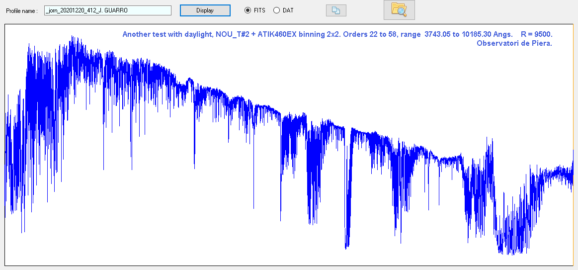

It seems that it with the little conceptual modification works pretty good. We will see which is his behavior on the sky.
I need do some more test yet, and the weather is bad here now, but I hope do
the NOU_T#2 firstlight in a few days.
Make 37 Orders is not bad, or yes?
Cheers, J.Guarro.
Cheers, J.Guarro.

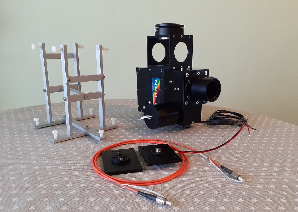

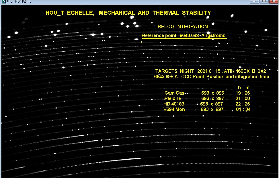

- Posts: 731

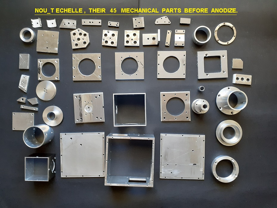

Today I show here the NOU_T3 echelle mechanical parts before bring them to anodize.
Also I show the very good, reliable and stable behavior during the observations. You know that
the NOU_T is installed directly to the telescope.
Write me If you need more information, the NOU_T is affordable for you.
Regards, J. Guarro.
Regards, J. Guarro.
- _MECANICA.jpg (242.27 KiB) Viewed 22972 times
- _MAPA.jpg (177.6 KiB) Viewed 22972 times
- Posts: 731
Hello at all,
This is a new possibility NOU_T optical fiber version, that is intended for a telescopes and mountsthat can't support the weight of a NOU_T direct to the telescope or doesn't have enoughspace or you prefer to work with optical fiber.
You need 20/30 minutes to transform the NOU_T to NOU_T with optical fiber, and 20/30 minutesmore if you want to come back to the first position.
Of course, you can connect to the NOU_T optical fiber everyone guide box that you have, such commercial or made by yourself.
The same way, due at the strong build and thermal stability of the NOU_T you don't need to putor keep this echelle into any insulating temperature box.
In these pictures you can see the NOU_T transformation to optical fiber using, I haven't mountedthe optical parts in this one yet, I will show here results with NOU_T optical fiber in the next future.I suppose that they will be the same without fiber.
Remember whether you can't afford one commercial echelle, the NOU_T could be the solution.
Regards, J.Guarro.
Regards, J.Guarro.
- NOU_T FIBRA 1.jpg (257.48 KiB) Viewed 22397 times
- NOU_T FIBRA 2.jpg (232.11 KiB) Viewed 22397 times
