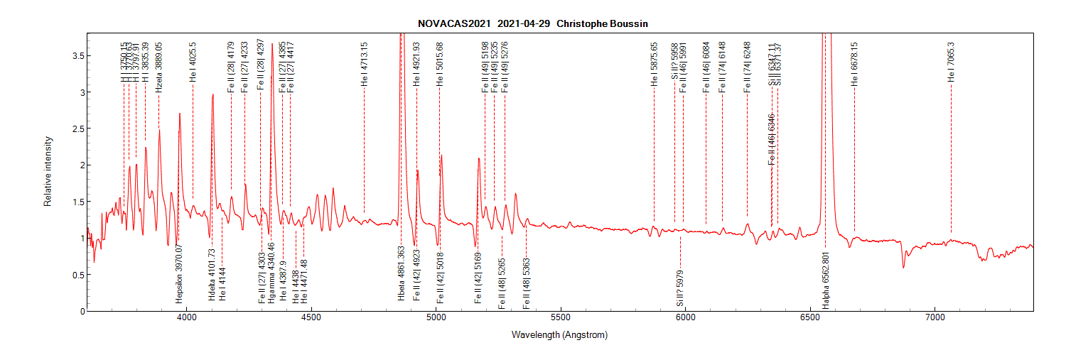

Here is our last update for the monitoring of the Nova Cas 2021 with two new spectra.

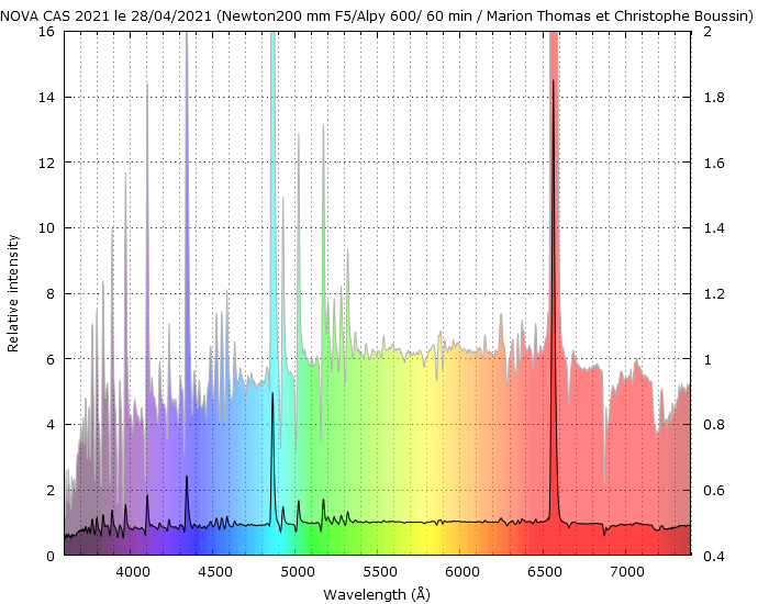

The first one was obtained the 28th of April at 1 h 49 TU (resolution of 525, JJ = 2459332.5756) with an Alpy 600 and an acquisition time of 60 min (40 x 90s) :
Nova Cas 2021 on April 28th, 2021
_novacas2021_20210428_076_Marion Thomas et Christophe Boussin_3600_7395.png (90.01 KiB) Viewed 16280 times
and the second one was obtained the 29th of April at 1 h 19 TU (resolution of 539, JJ = 2459333.5548) with an Alpy 600 and an acquisition time of 30 min (20 x 90s) :
Nova Cas 2021 on April 29th, 2021
_novacas2021_20210429_055_Christophe Boussin_3600_7395.png (103.18 KiB) Viewed 16280 times
Nova Cas 2021 on April 29th, 2021 (zoom)

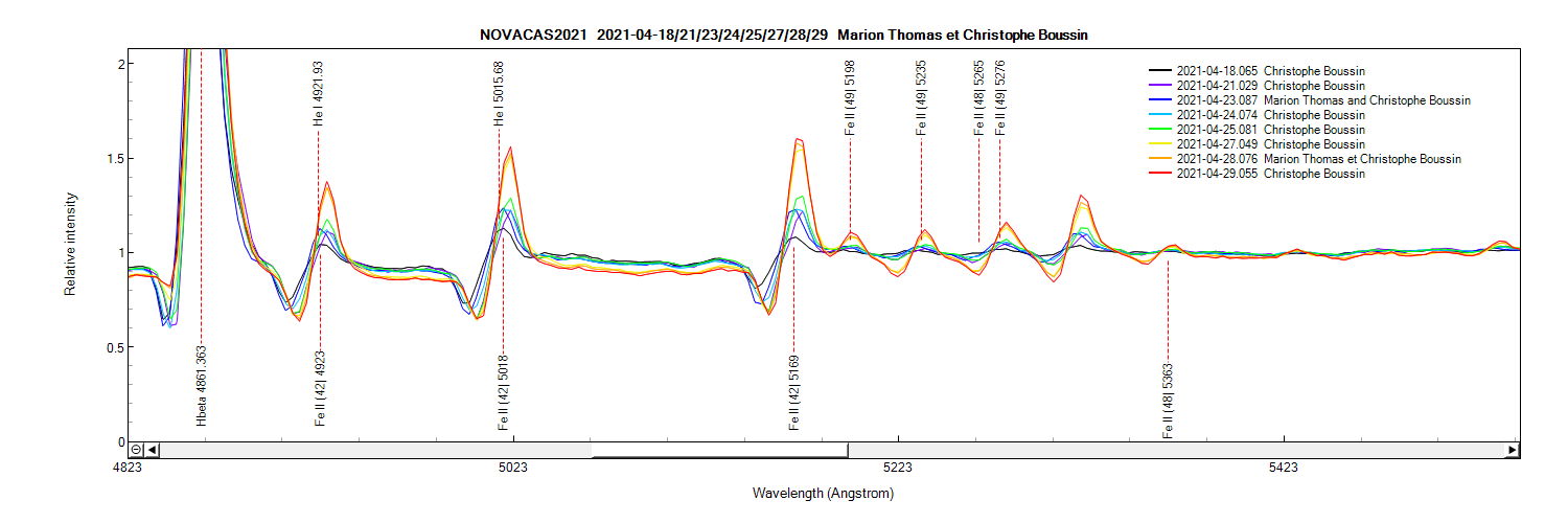

The relative intensities of the FeII lines continue to increase but it seems less rapidly between the 27th and the 29th than between the 25th and the 27th...
Evolution of FeII lines (42) between April 18 and 29 :
Fe II (42) lines on April 18th, 21th, 23th,24th, 25th, 27th, 28 and 29th 2021(zoom)

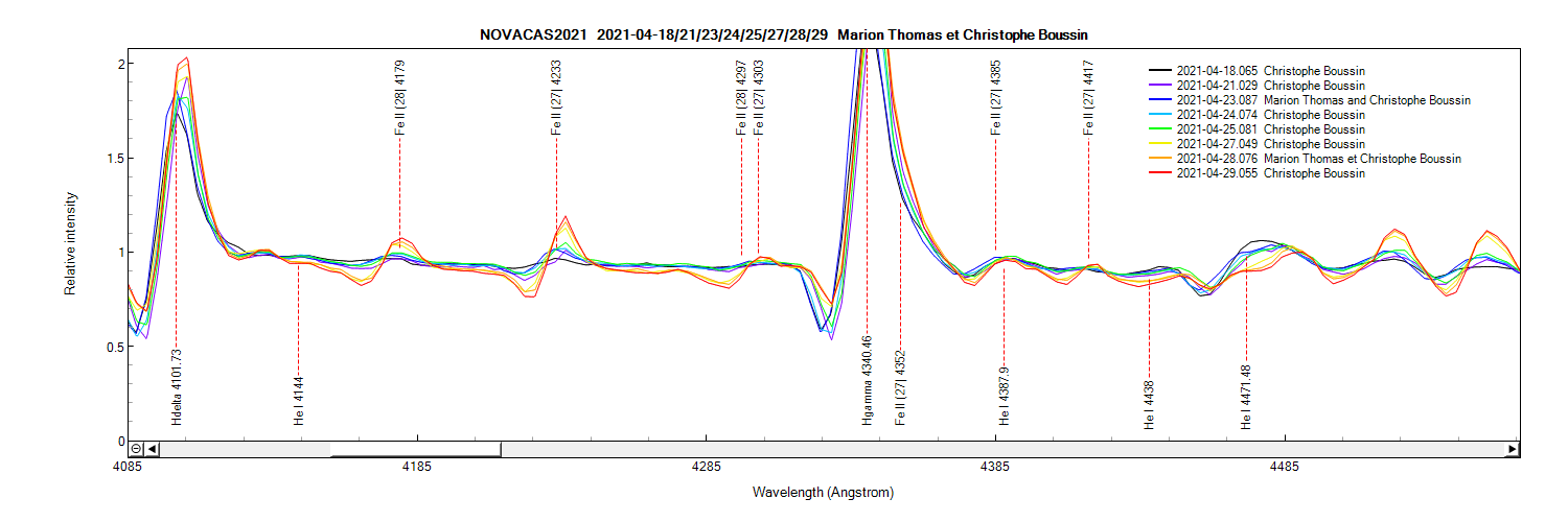

Evolution of FeII lines (27) and (28) between April 18 and 29 :
Fe II (27) and (28) lines on April 18th, 21th, 23th,24th, 25th, 27th, 28 and 29th 2021(zoom)

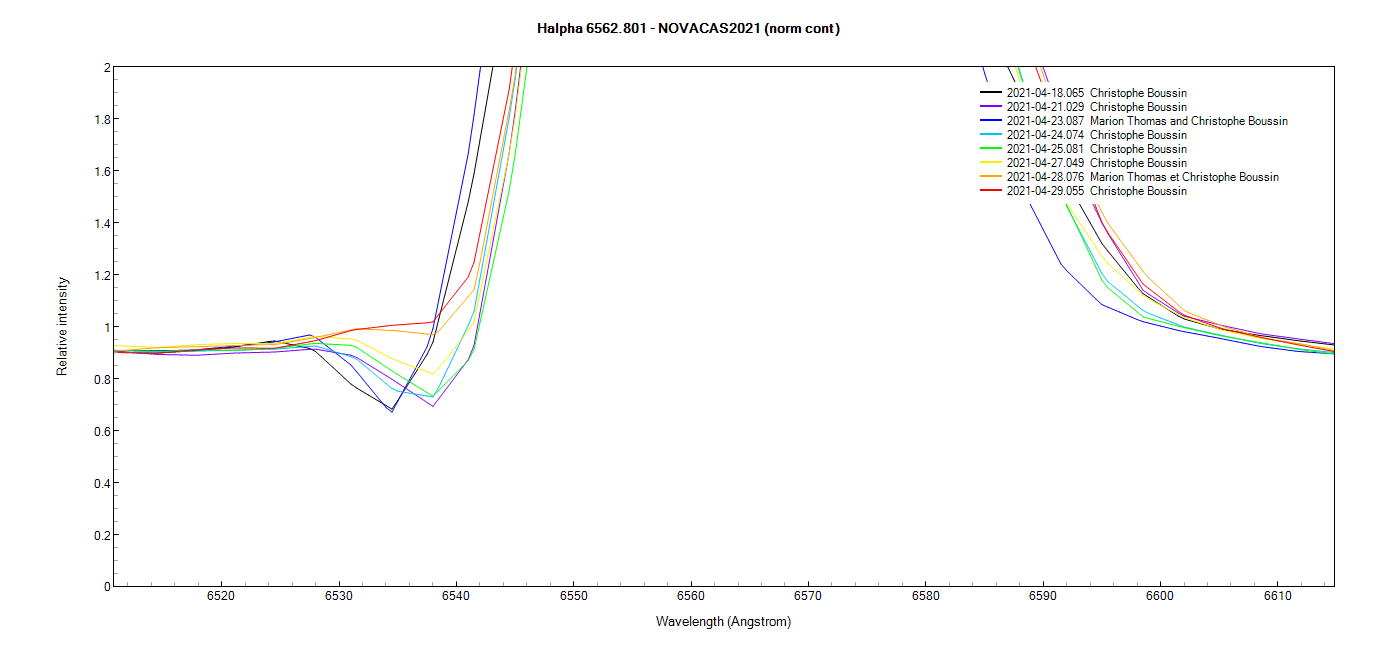

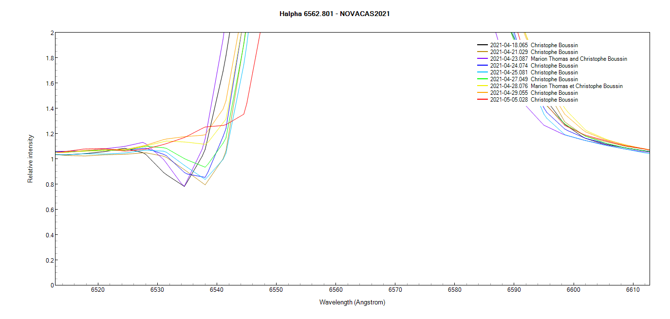

Note also the evolution of the “blue” part of the Balmer lines from Halpha to Hdelta visible even at low resolution.
Evolution of the “blue” part of the Halpha line at low resolution (for example) between April 18 and 29 :
Halpha line on April 18th, 21th, 23th, 24th, 25th, 27th, 28 and 29th 2021(zoom)

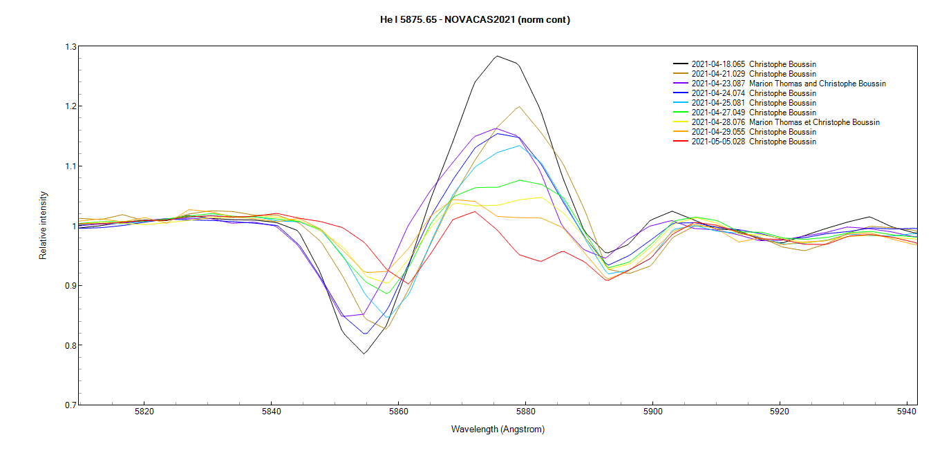

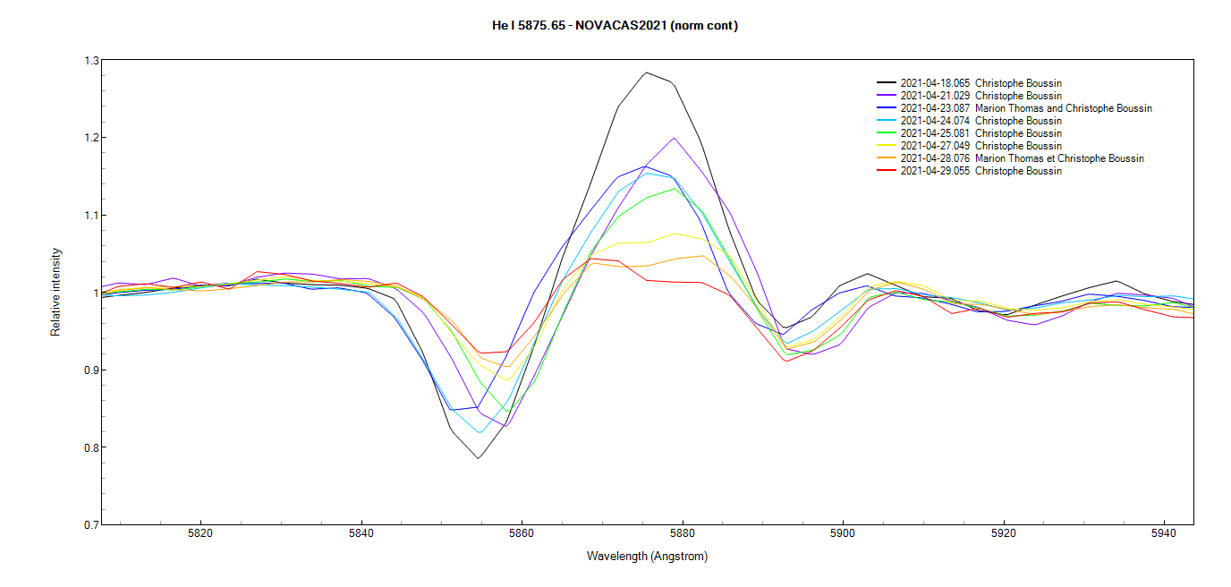

The relative intensities of HeI lines continue to decrease...
Evolution of the HeI line at 5876A (for example) between April 18 and 29 :
He I line at 5876A on April 18th, 21th, 23th, 24th, 25th, 27th, 28 and 29th 2021(zoom)

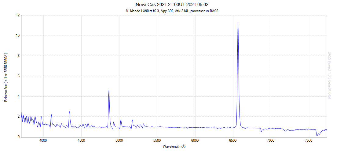

Alpy 600 spectrum from this evening 2021.05.02. The FeII lines continue to strengthen and the P Cygni profile on the H alpha emission has now disappeared at the Alpy resolution:
Hugh Allen

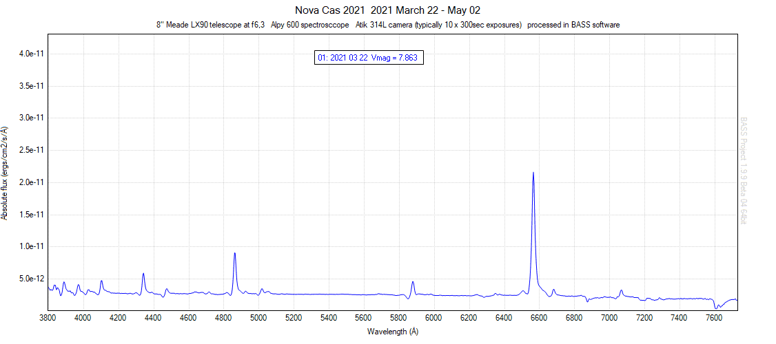

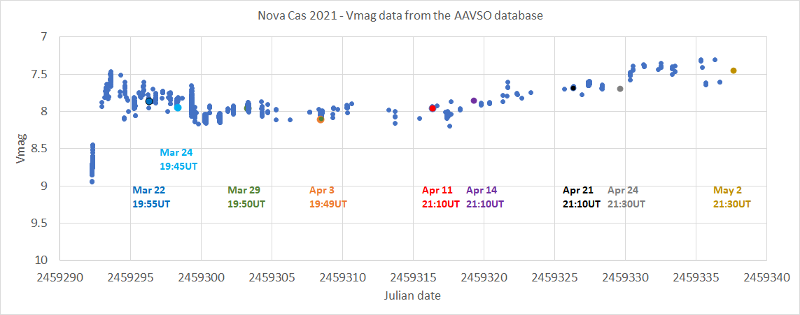

Inspired by Christophe's wonderful composites, I created an animation of the Alpy 600 spectra that I have captured up until May 2. The spectra have been flux calibrated using the Vmag data from the AAVSO database:
Nova Cas 2021 Vmag evolution to 2021 May 2 from AAVSO database.png (31.29 KiB) Viewed 16186 times
Here is the animation:

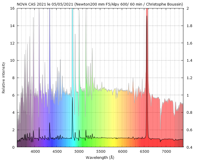

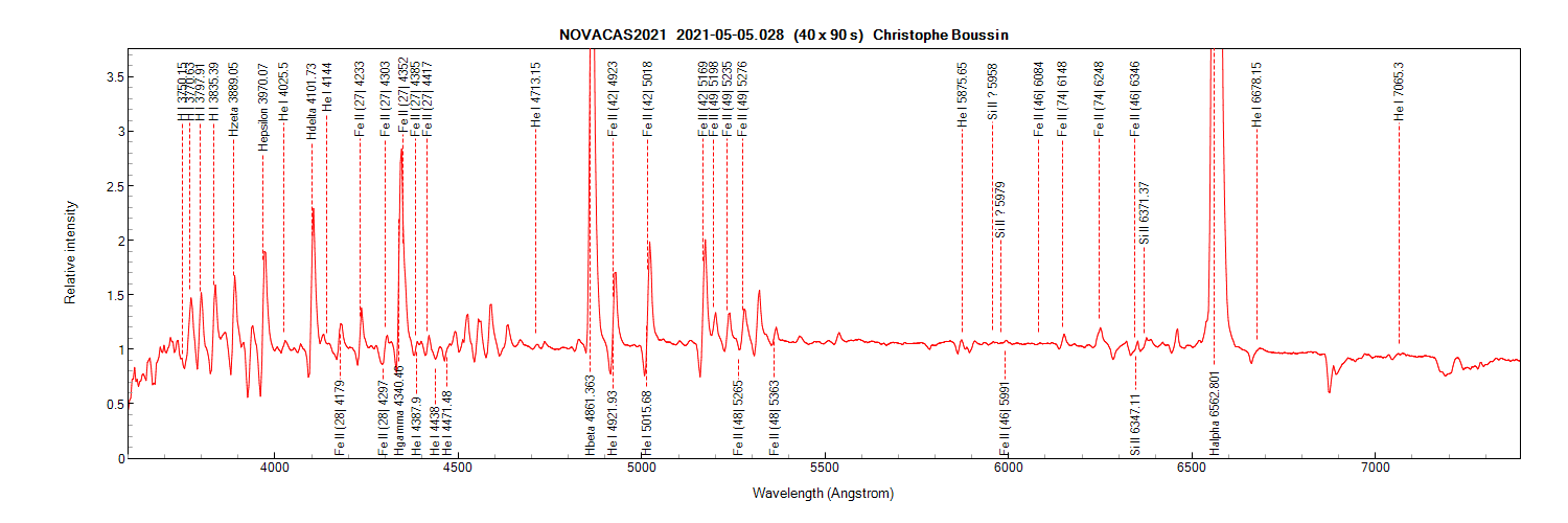

Here is my last update for the monitoring of the Nova Cas 2021.

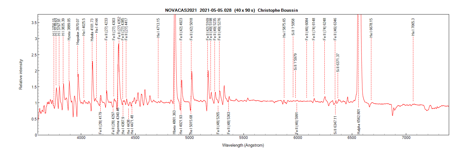

The following spectrum was obtained the 5th of May at 0 h 41 TU (resolution of 541, JJ = 2459339.5283) with an Alpy 600 and an acquisition time of 60 min (40 x 90s) :
Nova Cas 2021 on May 5th, 2021
_novacas2021_20210505_028_Christophe Boussin_3600_7395.png (96.85 KiB) Viewed 16152 times
Nova Cas 2021 on May 5th, 2021 (zoom)

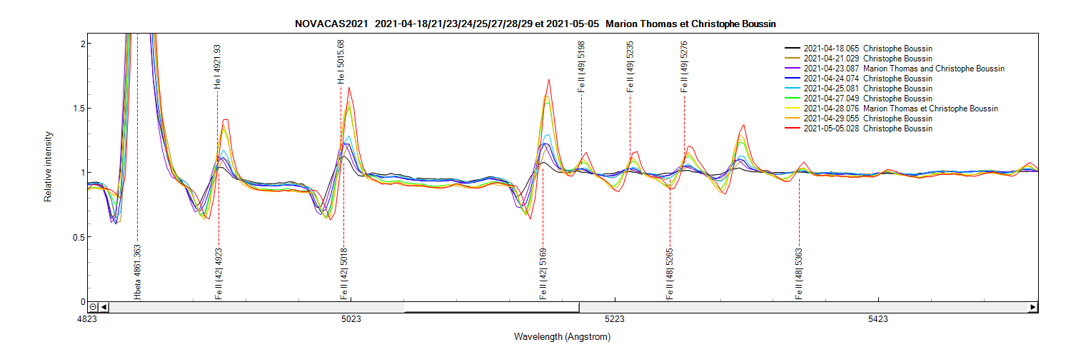

The relative intensities of the FeII lines continue to increase...

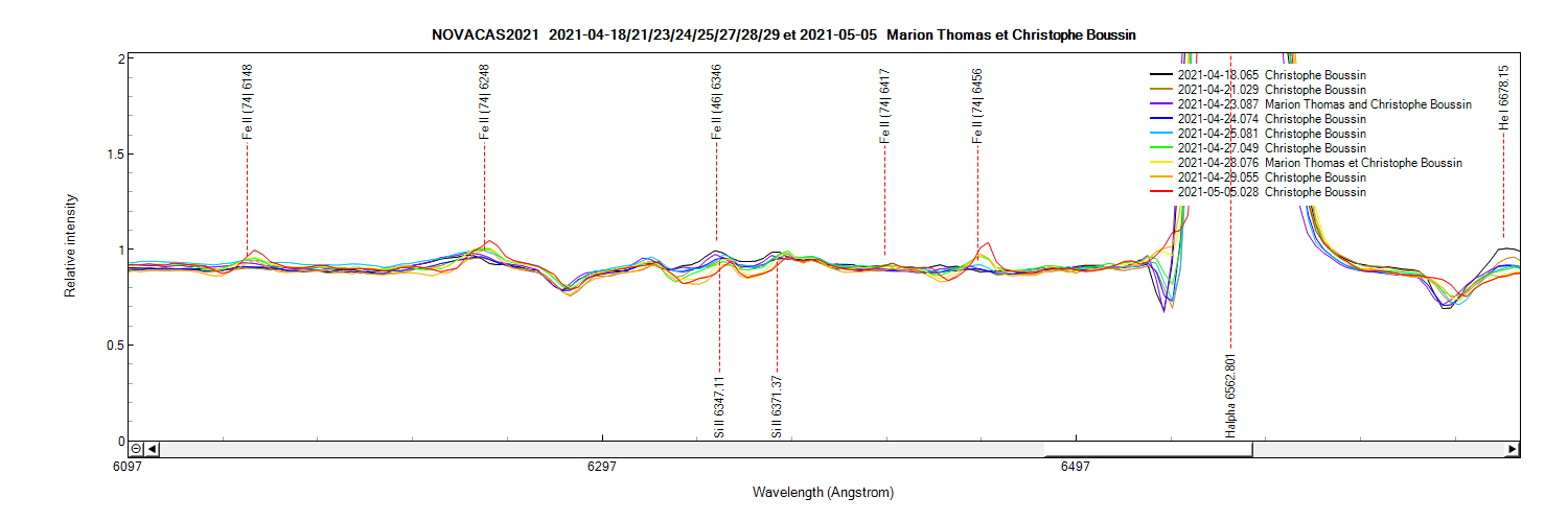

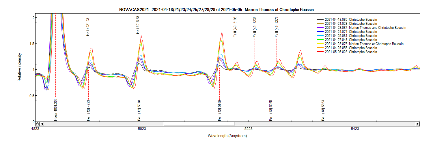

Evolution of FeII lines (42) between April 18 and May 5 :
Fe II (42) lines on April 18th, 21th, 23th,24th, 25th, 27th, 28th, 29 th and May 5th 2021(zoom)
Evolution of FeII lines (27) and (28) between April 18 and May 5 :
Fe II (27) and (28) lines on April 18th, 21th, 23th,24th, 25th, 27th, 28th, 29 th and May 5th 2021(zoom)

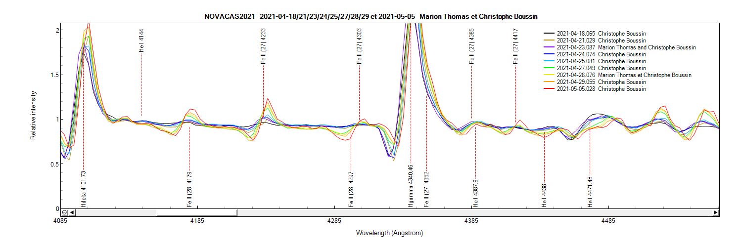

…and some Fe II multiplets are starting to be more obvious: Fe II (74) for example !
Evolution of FeII lines (74) between April 18 and May 5 :
Fe II (74) lines on April 18th, 21th, 23th,24th, 25th, 27th, 28th, 29 th and May 5th 2021(zoom)

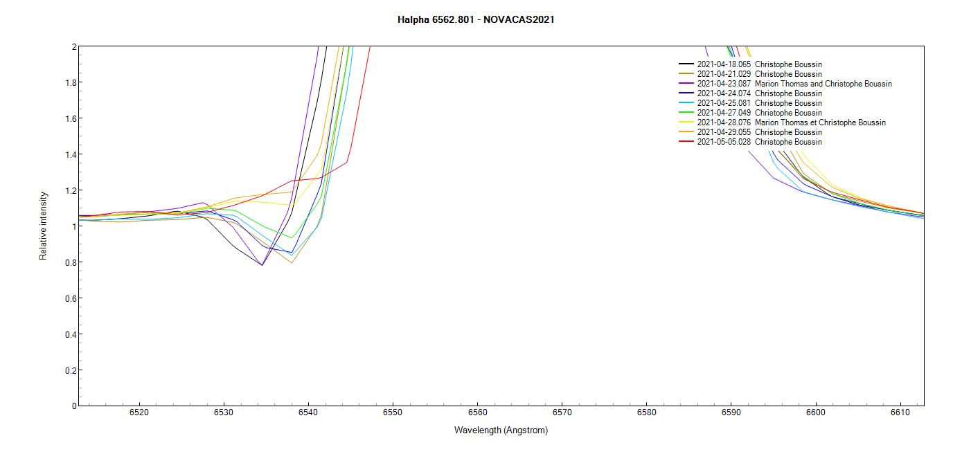

The evolution of Balmer lines continues as we can see on this enlargement of the Halpha line at low resolution between April 18 and May 5 :
Halpha line on April 18th, 21th, 23th,24th, 25th, 27th, 28th, 29 th and May 5th 2021(zoom)

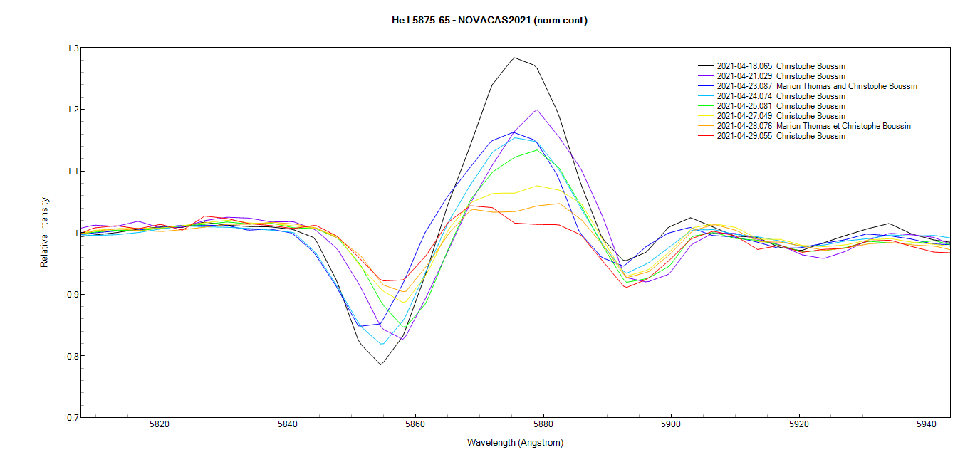

Evolution of the HeI line at 5876A (for example) :
He I line at 5876A on April 18th, 21th, 23th,24th, 25th, 27th, 28th, 29 th and May 5th 2021(zoom)

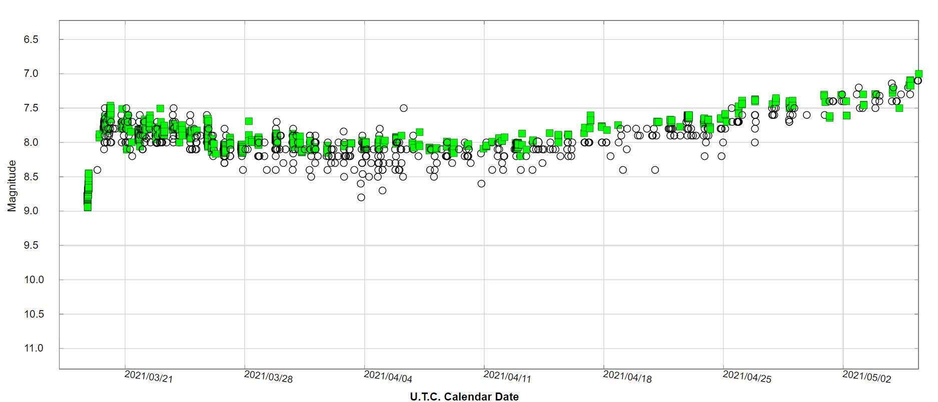

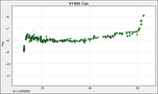

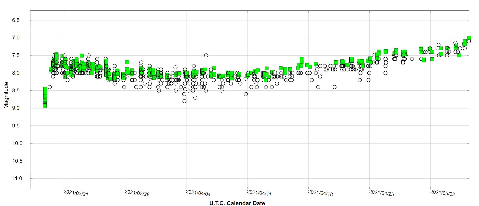

According to the AAVSO website, the magnitude of the Nova is now close to 7 !!
(visual : open circles / Johnson V : green squares)
Light curve of the Nova CAS 2021 (AAVSO)
Many more clear skies to all !!

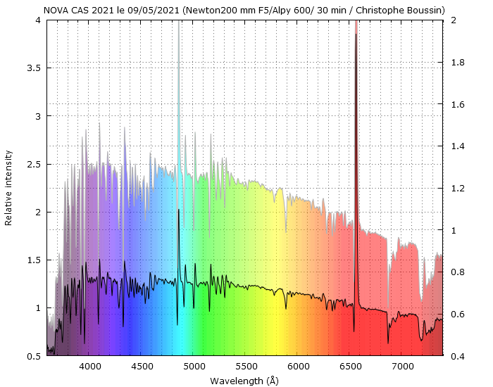

The following spectrum was obtained the 9th of May at 1 h 10 TU (resolution of 542, JJ = 2459343.5488) with my Alpy 600 and an acquisition time of 30 min (20 x 90s) :
Nova Cas 2021 on May 9th, 2021
_novacas2021_20210509_049_Christophe Boussin_3600_7395.png (101.77 KiB) Viewed 16028 times
Clear skies to all !!

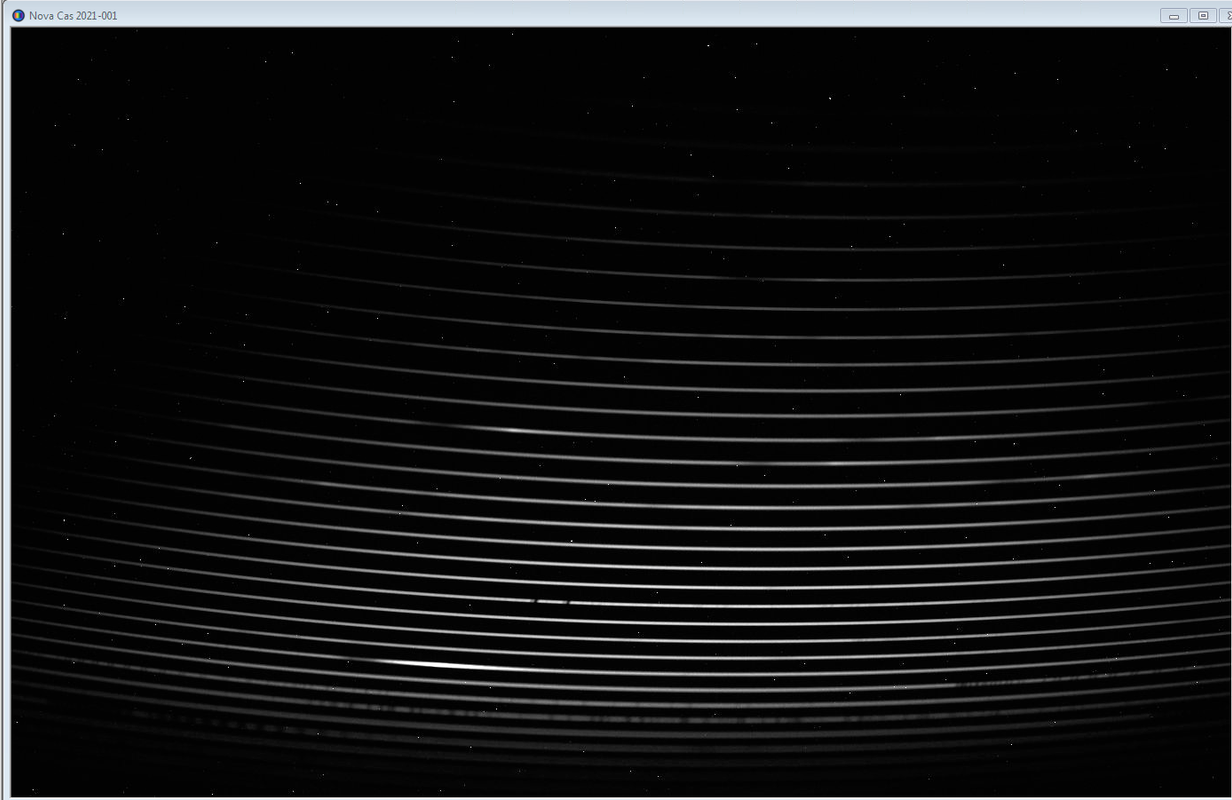

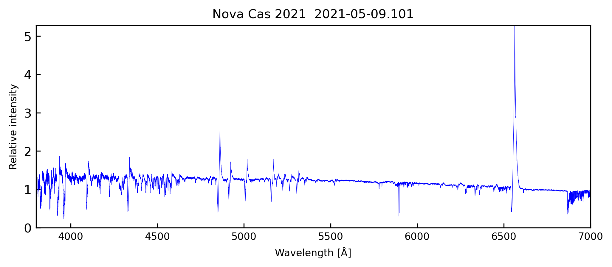

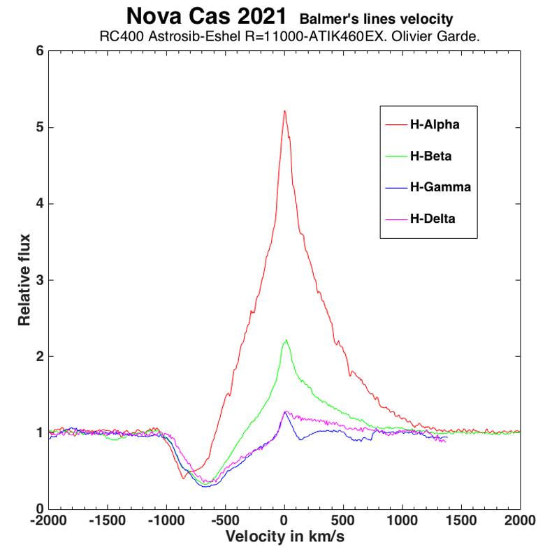

A spectrum taken this morning with an eShel spectrograph (R=11000)
The full spectrum from 3840 to 7600 Å
The Balmer's lines velocity
And others parts of the spectrum still on Balmer's lines
Stranges P Cyg profil ???

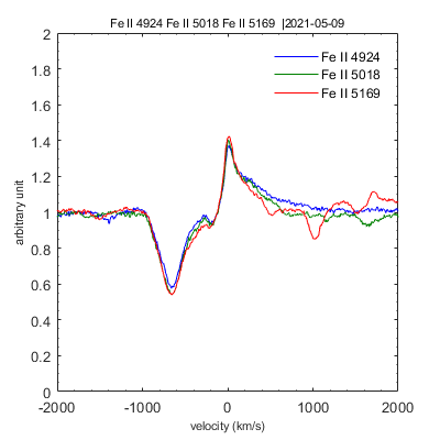

Les raies Fe II (42)
asdb_NovaCas2021_20210509_102_Fe II 4924 Fe II 5018 Fe II 5169.png (18.63 KiB) Viewed 15959 times
Deux systémes d'absorption clairement visibles avec un maximum d'absorption observé à -180 et -650 km/s respectivement, et une velocité maximale de l'absorption à -1000 km/s
Vu la luminosité et le caractére trés particulier de cette nova (really very pretty bad nova!) un suivi quotidien est souhaitable.

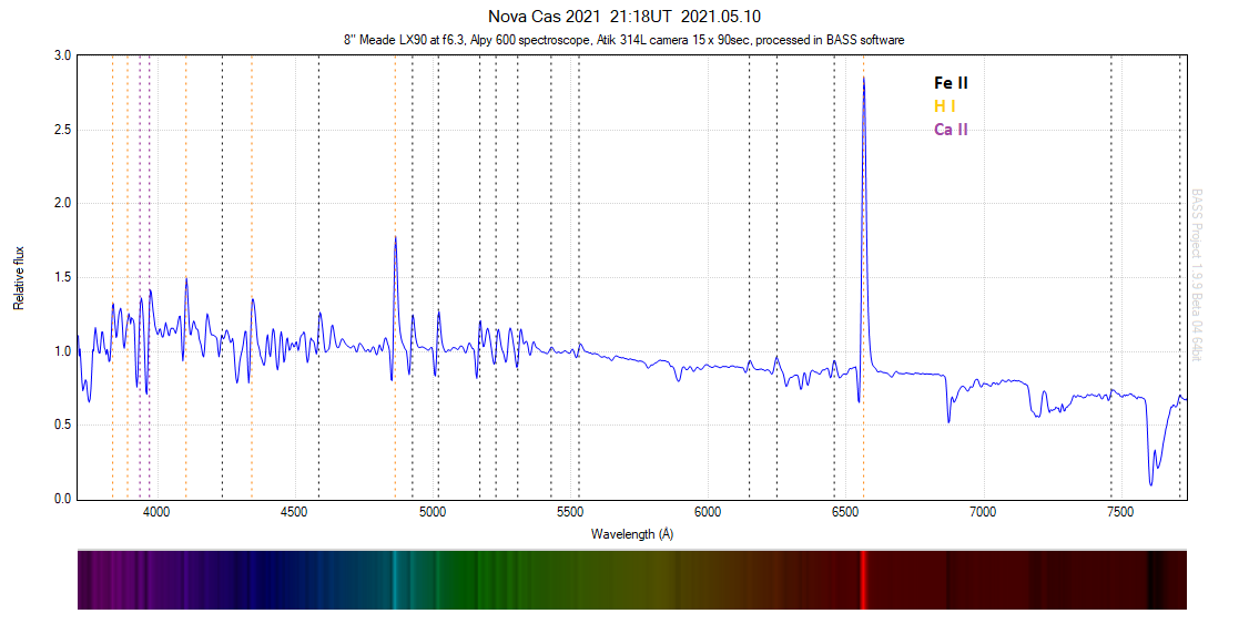

Nova Cas 2021 now around mag 5.3!
Post by HughAllen »
My Alpy spectrum from yesterday evening. I think the CaII pair in the violet is particularly striking. Really a wonderful nova to observe.
Nova Cas 2021 2021.05.10.png (50.78 KiB) Viewed 15837 times
