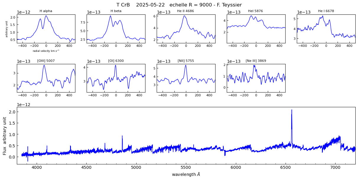

Recent spectrum
Active state with EW(H alpha) ~ 15 ans EW (He II) ~ 3.5.
Note the complex profile of H beta and He I 5876 with 3 apparent peaks.
This spectrum is a textbook case showing that H alpha is far to be the best Balmer line for astrophysics studies : too much processes leads to a fattening of the elements of the line. The physical conditions appear much more clearly in H beta.
Nevertheless, H alpha profile are very welcome, notably because the historical monitoring in the 80' and 90's are essentially based on H alpha.

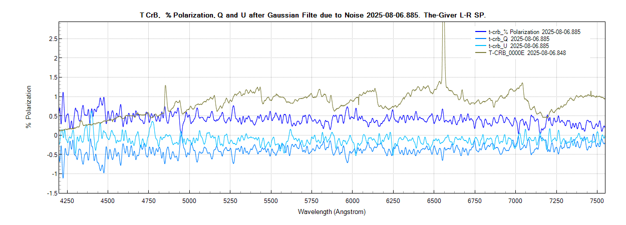

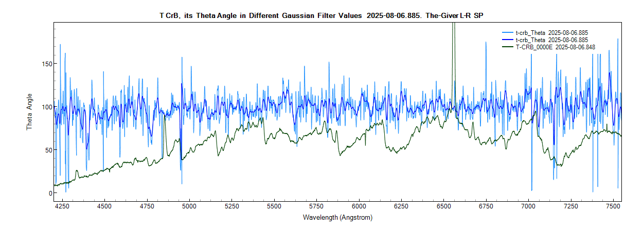

These are two graphics of a T CrB polarimetric observation.
I hope that you enjoy that.
Cheers, J. Guarro.

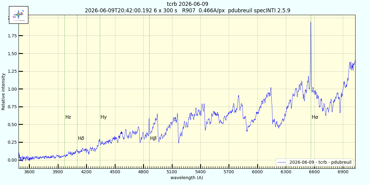

Hello
T CRb last night.
Only 6 x 300s before the clouds arrive!
UVEX4j - RC8 - slit 25µ - G300
