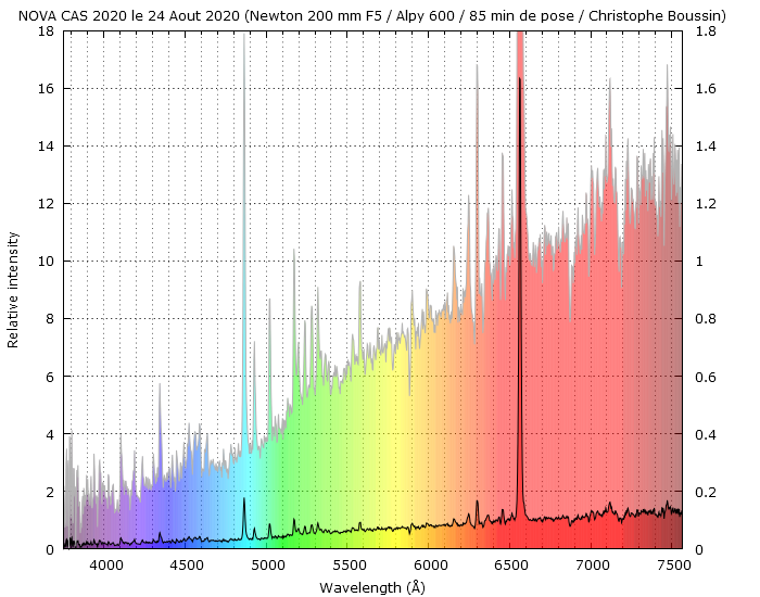

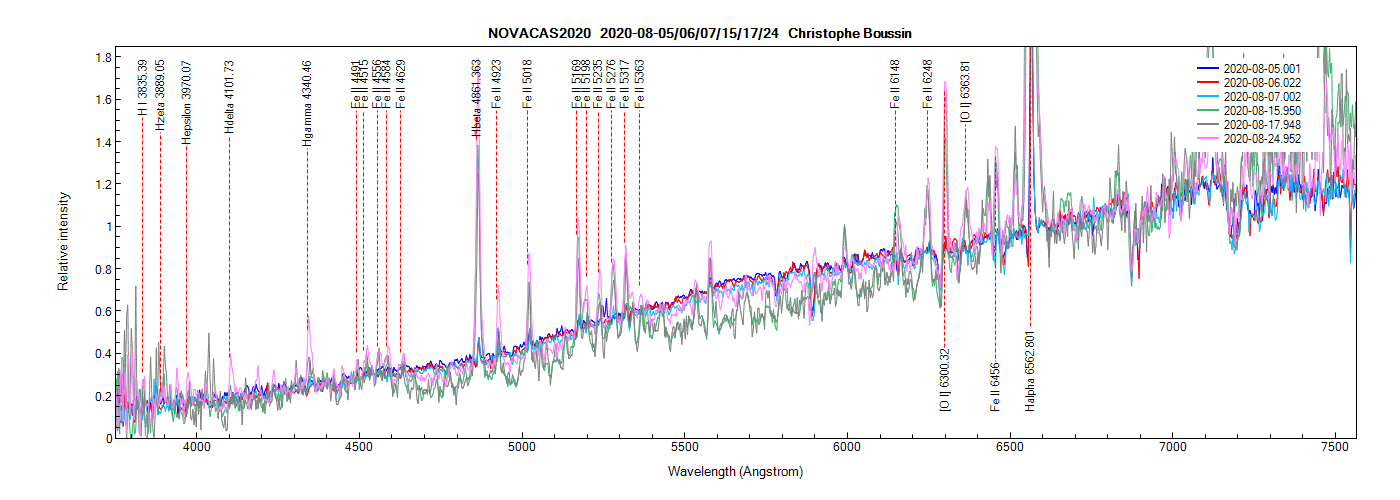

With a less favorable weather than at OHP, I think, I have, I obtained the following spectrum of the nova Cas 2020 the 24th of August at 22 h 51 TU with my Alpy 600 (resolution of 501, JJ = 2459086.4521) and an acquisition time of 85 min :
Nova Cas 2020 on August 24th, 2020
_novacas2020_20200824_952_Christophe Boussin_3750_7565.png (91.71 KiB) Viewed 9682 times

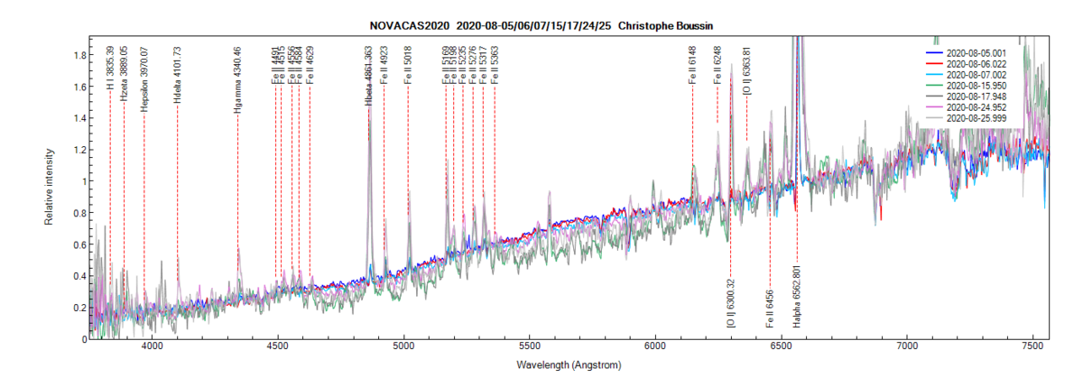

Nova Cas 2020 on August 5th, 6th, 7th, 15th and 17th and 24th, 2020 (identification of lines from PlotSpectra)
Like the Balmer lines, the FeII lines are increasingly visible !

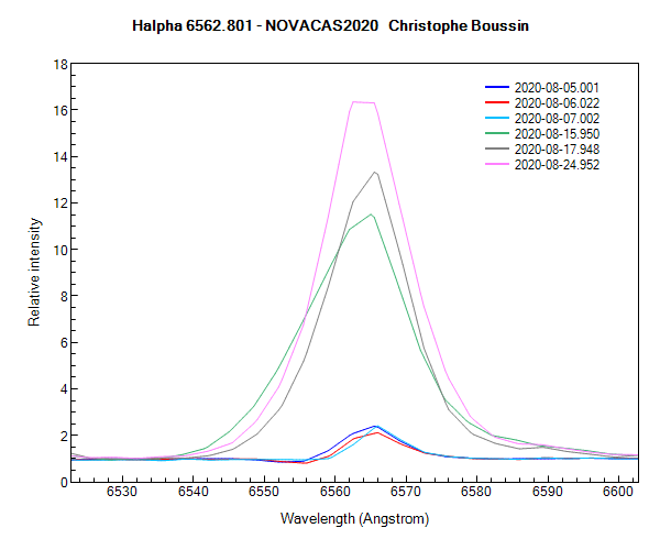

Evolution of the Halpha line :
Halpha line on August 5th, 6th, 7th, 15th, 17th and 24th, 2020
novacas2020_20200824_952_Christophe Boussin_Halpha.png (28.14 KiB) Viewed 9682 times
The relative intensity of the Halpha line is still increasing !

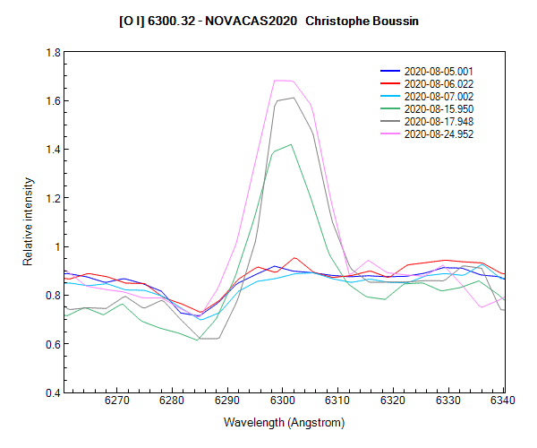

Evolution of the [OI] line :
[OI] line on August 5th, 6th, 7th, 15th, 17th and 24th, 2020
novacas2020_20200824_952_Christophe Boussin_OI.png (31.48 KiB) Viewed 9682 times
But that of [OI] at 6300A seems to have changed little ...

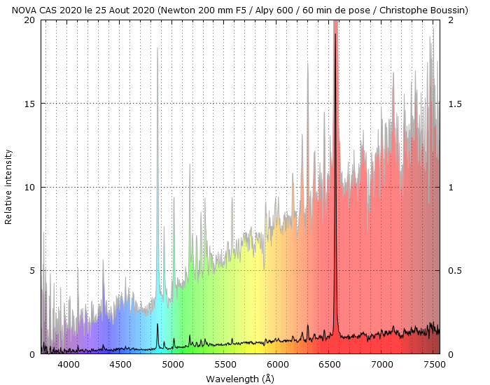

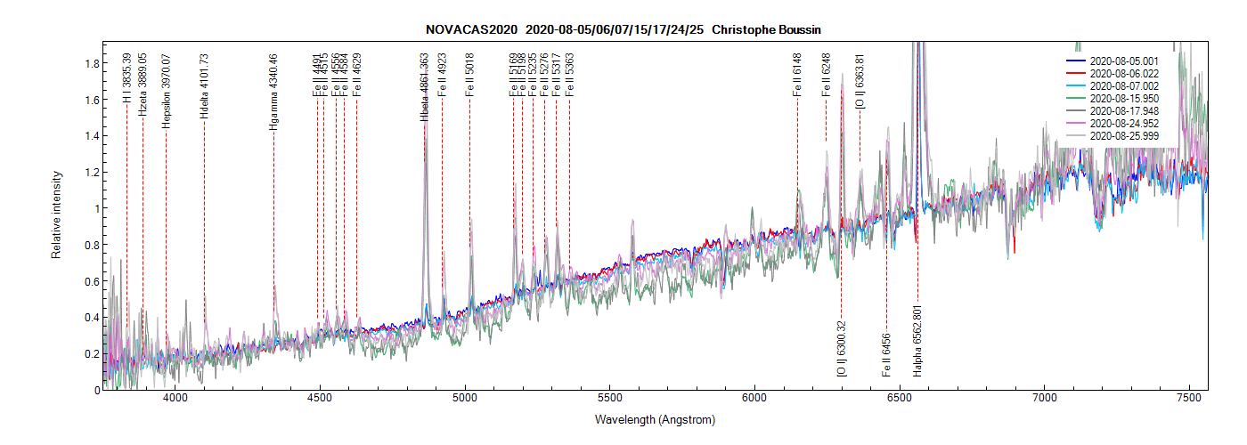

Here is my new update for the nova Cas 2020 with the following spectrum obtained last night the 25th of August at 23 h 58 TU with my Alpy 600 (resolution of 507, JJ = 2459087.4985) and an acquisition time of 60 min :
Nova Cas 2020 on August 25th, 2020
_novacas2020_20200825_999_Christophe Boussin_3750_7565.png (92.15 KiB) Viewed 9599 times
Nova Cas 2020 on August 5th, 6th, 7th, 15th, 17th, 24th and 25th, 2020 (identification of lines from PlotSpectra)

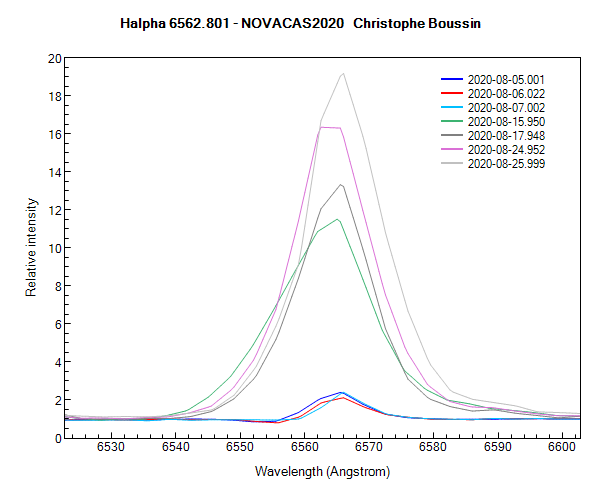

Halpha line on August 5th, 6th, 7th, 15th, 17th, 24th and 25th, 2020
novacas2020_20200825_999_Christophe Boussin_Halpha.png (32.6 KiB) Viewed 9599 times
No significant changes in 24 hours, except for the Halpha line whose relative intensity seems to increase slightly ...
Clear skies !

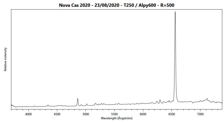

hello,
a "new" spectrum of nova cas 2020, taken during the 23-24/08 night:
clear skies,
vincent
Nova cas 2020_20200826T195647.png (23.18 KiB) Viewed 9575 times
