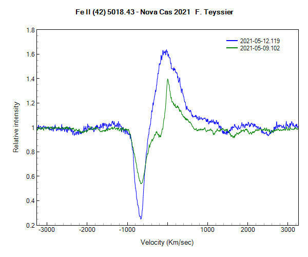

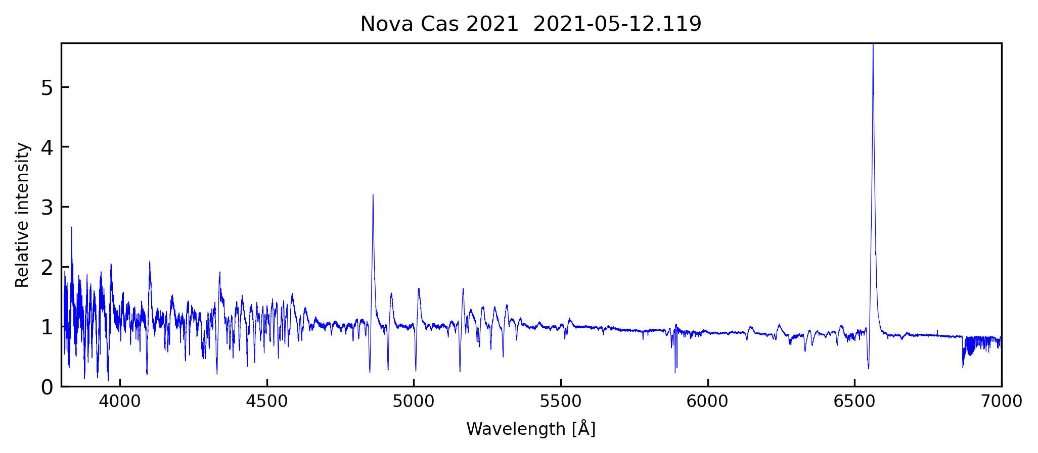

By chance (vey cloudy weather) , a new echelle spectrum secured this morning with the remote station SMM-SP equiped with a NOU-T spectrograph.
Significant evolution of the absorption system.
Fe II (42) 5018:

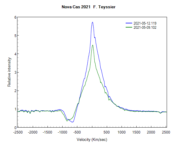

H alpha:

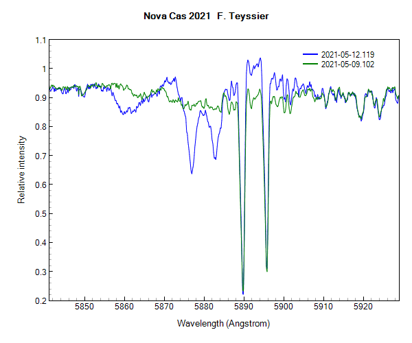

Na I D region:
Note the increase of Na I D and He I 5876 absorptions
(for beginners: the narrow lines are interstellar Na I)

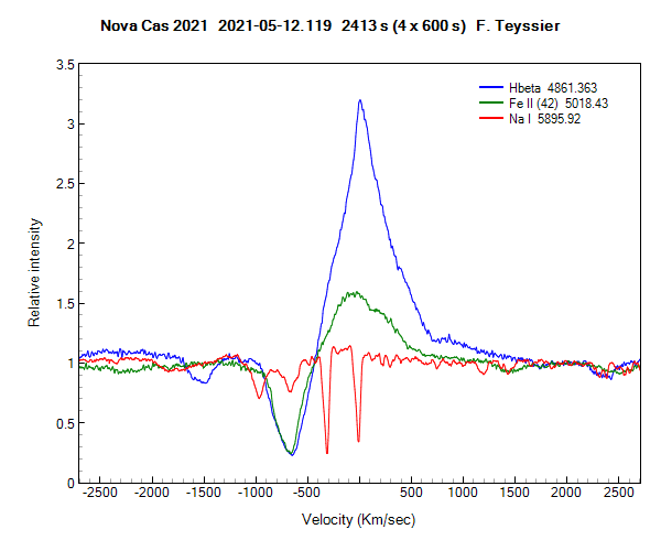

Following Steve's suggestion, a comparison of H beta, Fe II, Na I D1:
showing that the maximum absorption of Na I D has the same radial velocity than Balmer and Fe II lines.

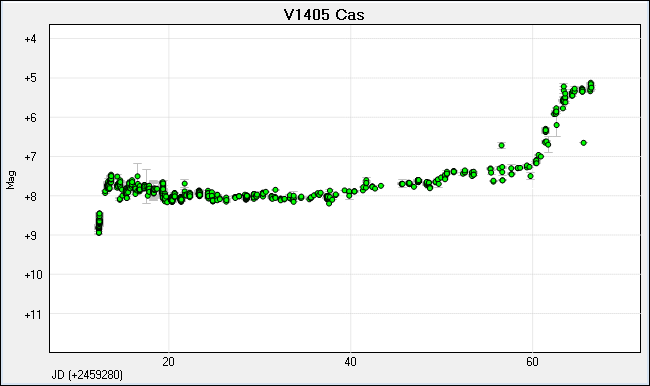

Looking at the AAVSO V light curve, it seems that the nova is reaching a new plateau at mag 5.3

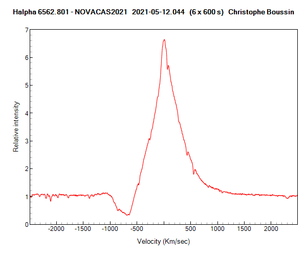

For this time, here is my contribution to the monitoring of the Nova Cas 2021 at high resolution !
The following spectrum, centered on the Halpha line, was obtained the 12th of May at 1 h 03 TU (resolution of 12568, JJ = 2459346.5439) with my LHIRES III (grating of 2400 lines / mm) and an acquisition time of 60 min (6 x 600s):
Halpha line of Nova Cas 2021 on May 12th, 2021
novacas2021_20210512_044_Christophe Boussin_Halpha.png (16.9 KiB) Viewed 15469 times
Maximum absorption is observed at a velocity of approximately -686 km/s.
Clear skies to all !!

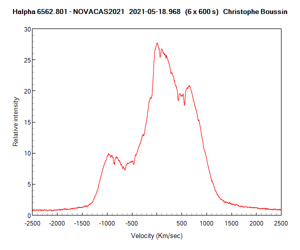

Finally a clear sky for a few hours ...
Here is my new contribution to the monitoring of the Halpha line of the Nova Cas 2021 at high resolution.
The following spectrum was obtained on May 18 at 23 h 14 TU (resolution of 12187, JJ = 2459353.4683) with my LHIRES III (grating of 2400 lines / mm) and an acquisition time of 60 min (6 x 600s):
Halpha line of Nova Cas 2021 on May 18th, 2021
novacas2021_20210518_968_Christophe Boussin_Halpha.png (17.64 KiB) Viewed 15233 times
The Halpha line profile has changed a lot since May 12 !

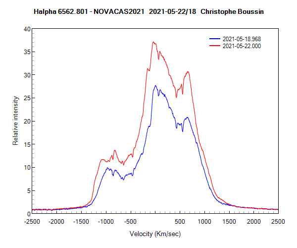

Here is a comparison between my last spectrum of the Halpha line of Nova Cas 2021 obtained at high resolution on May 22 at 00 h 00 TU (resolution of 14045, JJ = 2459356.5001, LHIRES III with grating of 2400 lines / mm, acquisition time of 60 min (6 x 600s)) and the previous one obtained on May 18 at 23 h 14 TU.
Halpha line of Nova Cas 2021 on May 18th and 22th 2021
novacas2021_Halpha_Christophe Boussin.png (23.86 KiB) Viewed 15123 times
The change of line profile is once again very obvious in only a few days but the overall appearance remains the same.

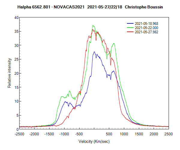

Post by Christophe Boussin »
Is it finally the return of more frequent starry nights?
This seems to be the case for the next few days ...

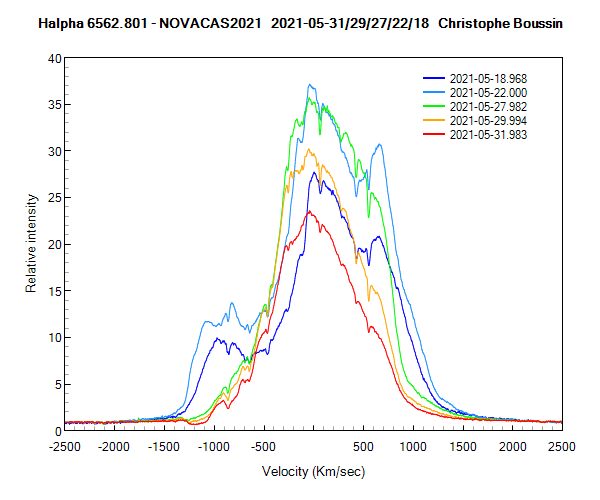

Here is a new comparison between my last spectrum of the Halpha line of Nova Cas 2021 at high resolution on May 27 at 23 h 34 TU (resolution of 13096, JJ = 2459362.4819, LHIRES III with grating of 2400 lines / mm, acquisition time of 60 min (6 x 600s)) and the previous ones obtained on May 18 at 23 h 14 TU and on May 22 at 00 h 00 TU.
Halpha line of Nova Cas 2021 on May 18th, 22th and 27th 2021
novacas2021_Halpha_Christophe Boussin.png (32.45 KiB) Viewed 14896 times
The line profile, especially in the “blue” part, has changed significantly in a few days !

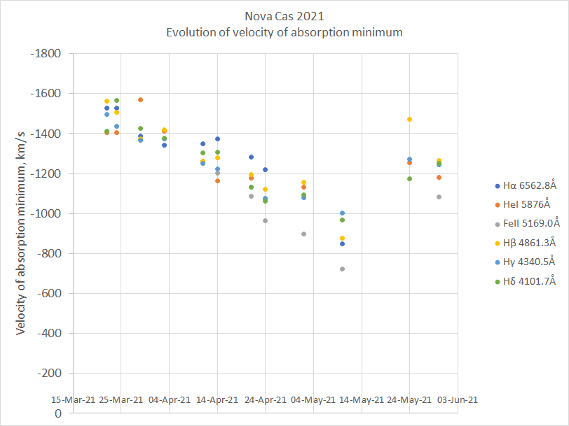

Nova Cas 2021 remarkable spectral evolution
Post by HughAllen »

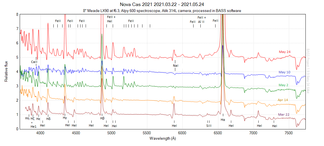

Since Mar 22 I've captured a dozen Alpy spectra of this beautiful nova, the latest last night May 30. The slow decline in expansion velocity seemed to go into reverse in my spectrum of May 24 around the time that the nova began again to rebrighten. The decline in velocity has seemingly resumed based on last night's spectrum:
Nova Cas 2021 Evolution of velocity of absorption minimum.png (30.19 KiB) Viewed 14733 times
The HeI emission seems to be returning, here's an offset relative flux plot of a few of my spectra since Marr 22:
Nova Cas 2021 Offset zoom 2021 03 22 - 05 24.png (91.43 KiB) Viewed 14733 times

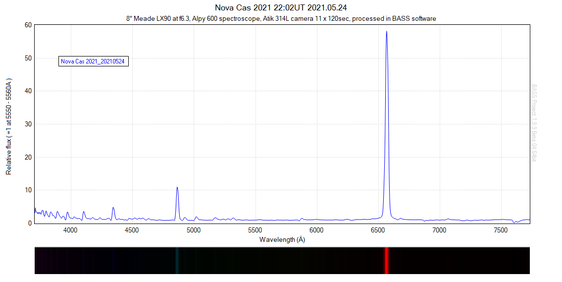

The star appears amazingly red, presumably due to the currently overwhelming relative intensity of the H alpha emission:
Nova Cas 2021 2021 05 24.png (33.32 KiB) Viewed 14733 times

Here is my new comparison between my two last spectra of the Halpha line of Nova Cas 2021 at high resolution on May 29 at 23 h 51 TU (resolution of 16788, JJ = 2459364.4938) and on May 31 at 23 h 35 TU (resolution of 14355, JJ = 2459366.4825) obtained with my LHIRES III (grating of 2400 lines / mm, acquisition time of 60 min for each spectrum (6 x 600s)) and the previous ones obtained on May 18, 22 and 27.
Halpha line of Nova Cas 2021 on May 18th, 22th, 27th, 29th and 31th 2021
novacas2021_Halpha_Christophe Boussin.png (42.12 KiB) Viewed 14649 times
The overall appearance of the line profile has changed less over the past few days...
