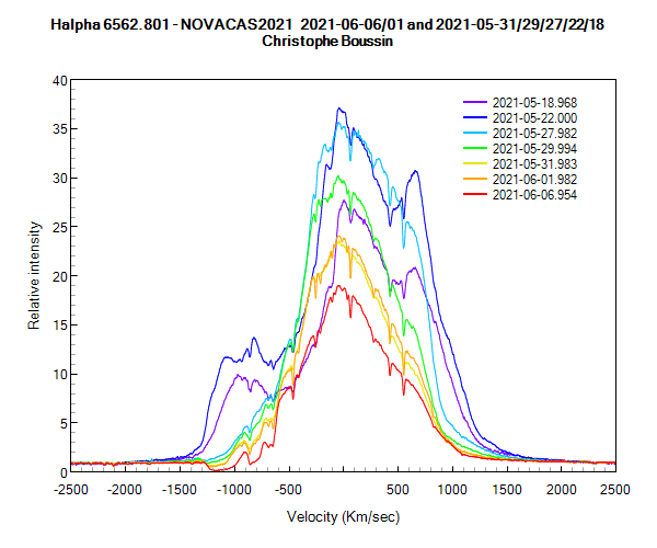

After a few very cloudy nights, the clear skies seems to be back for this week...
Here is my new comparison between my two last spectra of the Halpha line of Nova Cas 2021 at high resolution on June 1 at 23 h 34 TU (resolution of 18277, JJ = 2459367.4824) and on June 6 at 22 h 54 TU (resolution of 17957, JJ = 2459372.4542) with my LHIRES III (grating of 2400 lines / mm, acquisition time of 60 min for each spectrum (6 x 600s)) and the previous ones obtained on May 18, 22, 27, 29 and 31.
Halpha line of Nova Cas 2021 on May 18th, 22th, 27th, 29th, 31th and on June 1st and 6th 2021
novacas2021_Halpha_Christophe Boussin.png (48.25 KiB) Viewed 13733 times
Clear skies to all !!

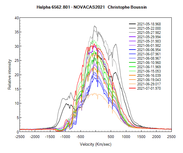

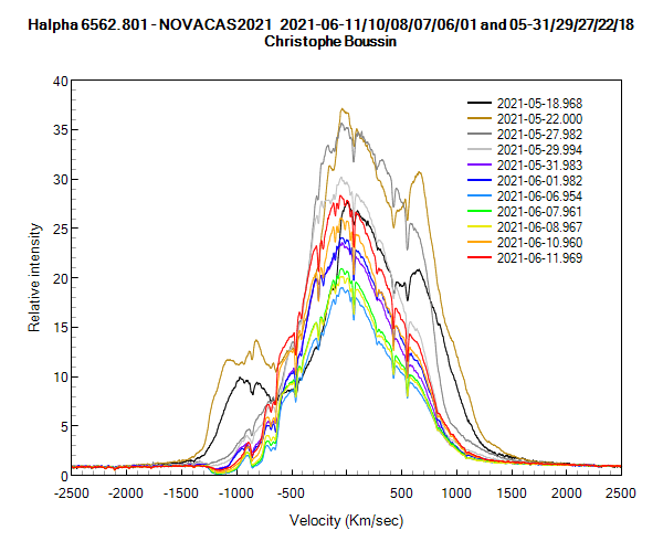

Posts: 173
Post by Christophe Boussin »
It was a good week to observe the Halpha line of the Nova Cas 2021 at high resolution almost daily !
Here is my new comparison between my four last spectra of the Halpha line of Nova Cas 2021 at high resolution on June 7 at 23 h 04 TU (resolution of 18453, JJ = 2459373.4611), on June 8 at 23 h 13 TU (resolution of 18668, JJ = 2459374.4672), on June 10 at 23 h 03 TU (resolution of 18761, JJ = 2459376.4604) and on June 11 at 23 h 15 TU (resolution of 18499, JJ = 2459377.4689) with my LHIRES III (grating of 2400 lines / mm, acquisition time of 60 min for each spectrum (6 x 600s)) and the previous ones.
Halpha line of Nova Cas 2021 on May 18th, 22th, 27th, 29th, 31th and on June 1st, 6th, 7th, 8th, 10th and 11th 2021
novacas2021_Halpha_Christophe Boussin.png (62.91 KiB) Viewed 13634 times
The following animation shows the impressive evolution of the Halpha line between May 18 and June 11 :
novacas2021_animation_Christophe Boussin.gif (95.03 KiB) Viewed 13634 times
The overall appearance of the line profile is roughly the same since early June, but this week the relative intensity of the line has increased !

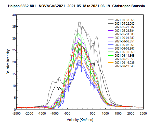

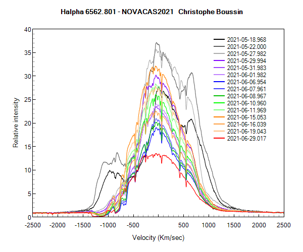

Here is my new comparison between my three last spectra of the Halpha line of Nova Cas 2021 at high resolution on June 15 at 1 h 16 TU (resolution of 17539, JJ = 2459380.5531), on June 16 at 0 h 56 TU (resolution of 18726, JJ = 2459381.539) and on June 19 at 1 h 02 TU (resolution of 18674, JJ = 2459384.5428) and the previous ones obtained with my LHIRES III (grating of 2400 lines / mm, acquisition time of 60 min for each spectrum (6 x 600s)).
Halpha line of Nova Cas 2021 on May 18th, 22th, 27th, 29th, 31th and on June 1st, 6th, 7th, 8th, 10th, 11th, 15th, 16th and 19th 2021
novacas2021_Halpha_Christophe Boussin.png (70.13 KiB) Viewed 13507 times
The overall profile of the Halpha line now remains very similar from day to day.

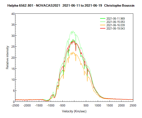

However, we can note the variation in the relative intensity (increase between 11 and 15, decrease between 15 and 16 and increase between 16 and 19 June) :
Halpha line of Nova Cas 2021 on June 11th, 15th, 16th and 19th 2021
novacas2021_Halpha_11to19June_Christophe Boussin.png (32.21 KiB) Viewed 13507 times
Christophe Boussin wrote: However, we can note the variation in the relative intensity (increase between 11 and 15, decrease between 15 and 16 and increase between 16 and 19 June)
Hi Christophe
You can only measure changes in the intensity of emission lines if you calibrate your spectra in absolute flux. The change in relative intensity in H alpha could be because the continuum brightness is changing.
For example the V magnitudes for your last 4 spectra from AAVSO are 7.1, 7.4, 6.8, 7.1 If we assume the continuum at H alpha follows V magnitude this will make the H alpha line look ~30% stronger in relative magnitude on 6/15 and ~30% weaker on 6/16
Posts: 173
Hi Robin,
Thank you for your comment !
Yes, I'm aware that the brigthness of the continuum can vary and that is why I'm talking about relative intensity.
Therefore, the variation in the relative intensity of the Halpha line does not indicate, of course, the variation in the intensity of the line but only a variation with respect to the continnuum.
I can't, for the moment, measure the V magnitude at the moment of the acquisition of the spectrum, so I limit myself to presenting it in relative intensity.
But, of course, the spectrum can be, a posteriori, calibrated in absolute flux with the measurements from AAVSO for example as you indicate it ;-)
Spectroscopically,
Christophe

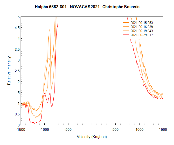

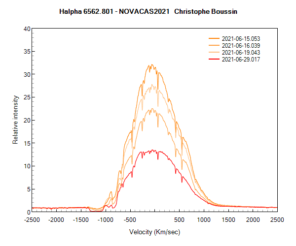

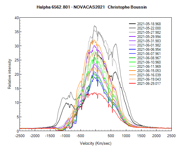

So, here is my last spectrum of the Halpha line of Nova Cas 2021 at high resolution on June 29 at 0 h 24 TU (resolution of 18771, JJ = 2459394.517) and the comparison with the previous ones obtained with my LHIRES III (grating of 2400 lines / mm, acquisition time of 60 min for each spectrum (6 x 600s)).
Halpha line of Nova Cas 2021 on May 18th, 22th, 27th, 29th, 31th and on June 1st, 6th, 7th, 8th, 10th, 11th, 15th, 16th, 19th and 29th 2021
novacas2021_Halpha_Christophe Boussin.png (72.62 KiB) Viewed 13297 times

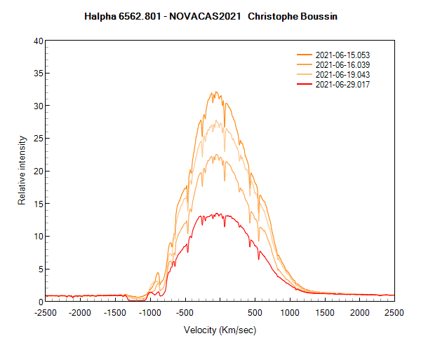

In ten days, the relative intensity of the Halpha line shows a very clear variation !
Halpha line of Nova Cas 2021 on June 15th, 16th, 19th and 29th 2021
novacas2021_Halpha_15 to 29 June_Christophe Boussin.png (31.26 KiB) Viewed 13297 times

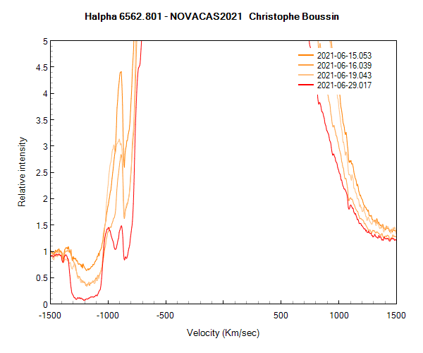

And, as the animation of the spectra of James shows very well, the absorption around -1200 km/s becomes more and more obvious :
Halpha line of Nova Cas 2021 on June 15th, 16th, 19th and 29th 2021 (zoom)
novacas2021_Halpha_15 to 29 June_zoom_Christophe Boussin.png (31.07 KiB) Viewed 13297 times

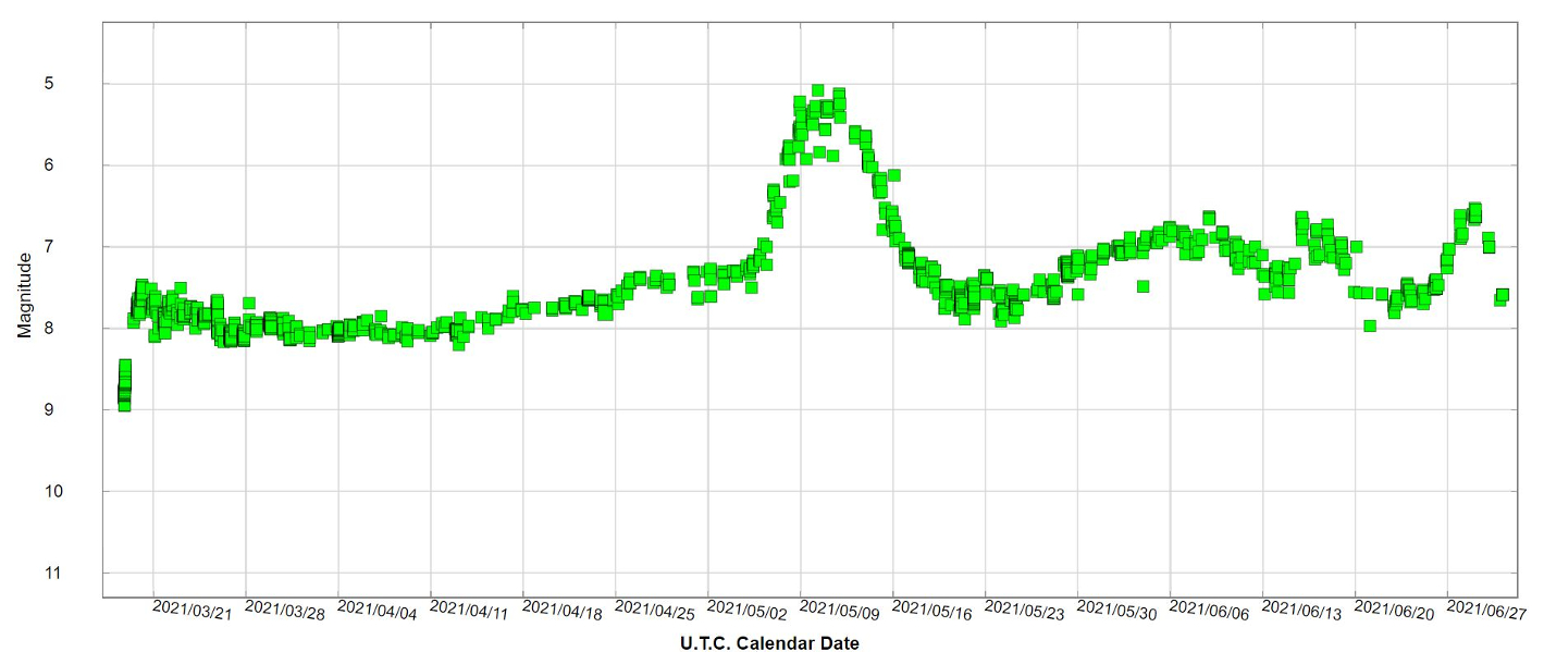

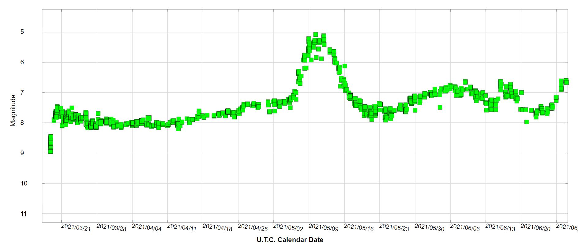

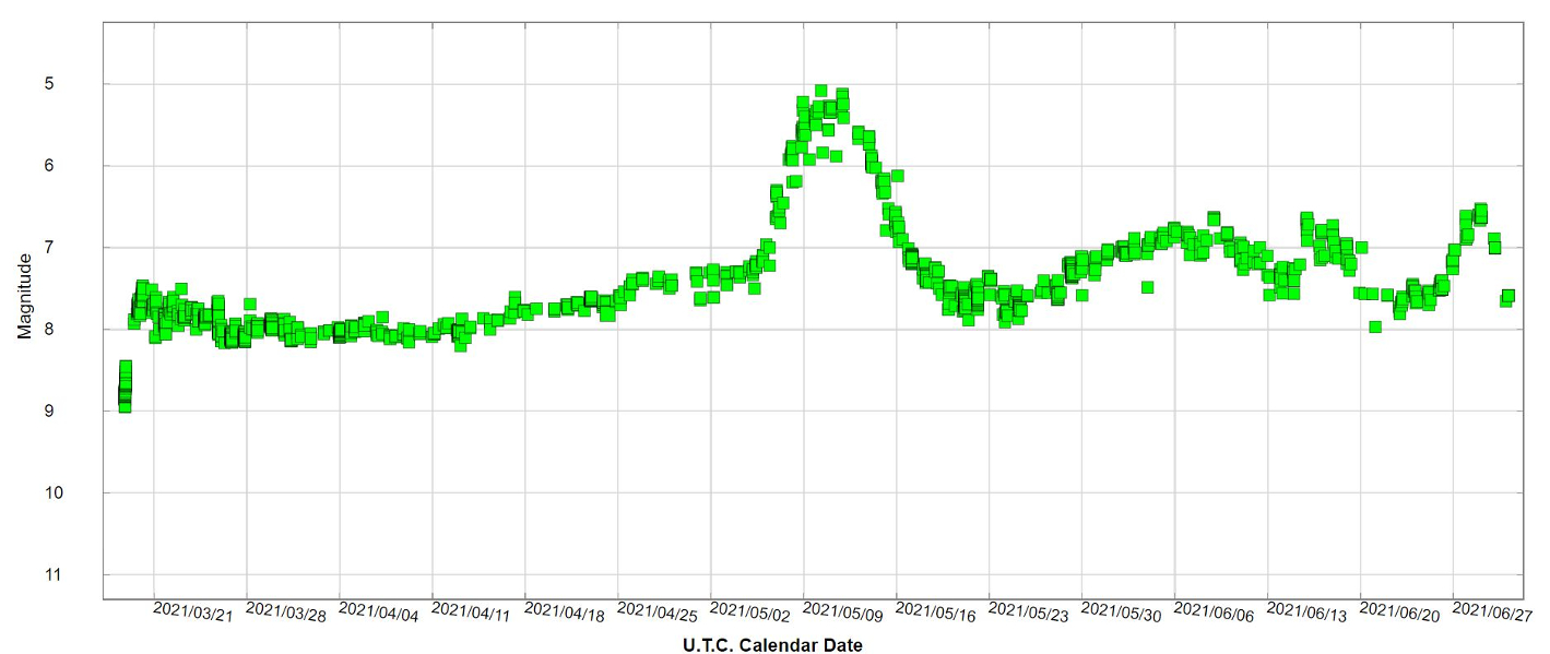

According to the AAVSO website, the brightness of the Nova increases again !!
(Johnson V : green squares)
Light curve of the Nova CAS 2021 (AAVSO)

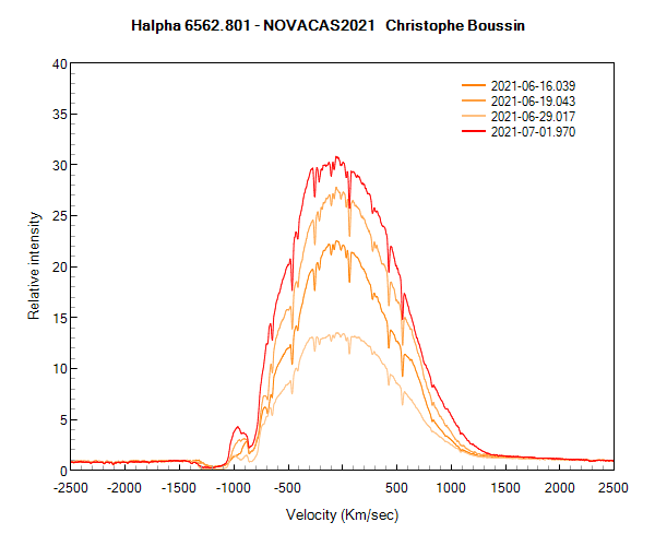

Posts: 173
Between the clouds , with some luck and perseverance, I succeeded to find a clear sky...for 2 hours ;-) !
So, here is my last spectrum of the Halpha line of Nova Cas 2021 at high resolution on July 1 at 23 h 17 TU (resolution of 18654, JJ = 2459397.4701) and the comparison with the previous ones obtained with my LHIRES III (grating of 2400 lines / mm, acquisition time of 60 min for each spectrum (6 x 600s)).
Halpha line of Nova Cas 2021 on May 18th, 22th, 27th, 29th, 31th, on June 1st, 6th, 7th, 8th, 10th, 11th, 15th, 16th, 19th, 29th and on July 1st 2021
novacas2021_Halpha_Christophe Boussin.png (76.58 KiB) Viewed 13164 times
The following animation shows the evolution of the profile of the Halpha line between May 18th and July 1st :
novacas2021_Halpha_animation_Christophe Boussin.gif (139.71 KiB) Viewed 13164 times
Evolution over the last 2 weeks :
novacas2021_Halpha_16 June to 1 July_Christophe Boussin.png (32.13 KiB) Viewed 13164 times

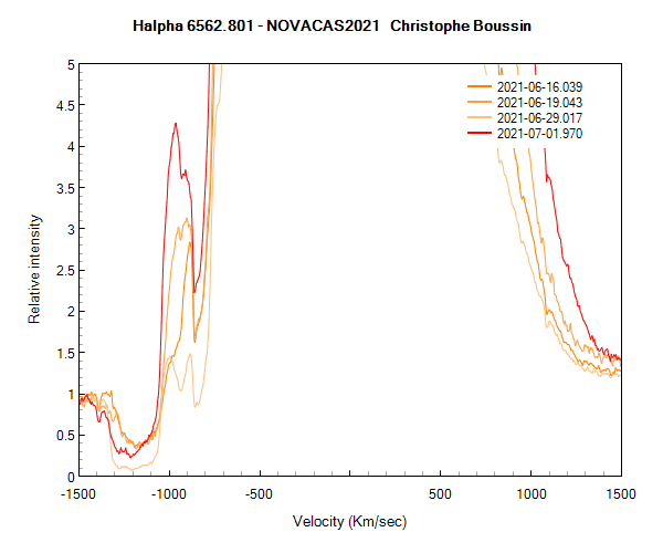

... and a more detailed view of the profile in the “blue” part :
novacas2021_Halpha_16 June to 1 July_zoom_Christophe Boussin.png (31.44 KiB) Viewed 13164 times

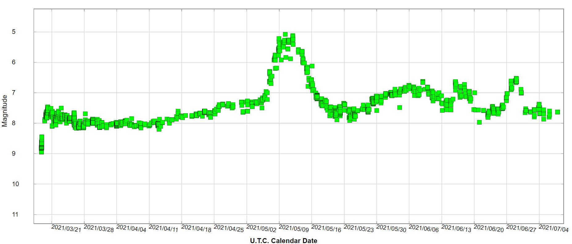

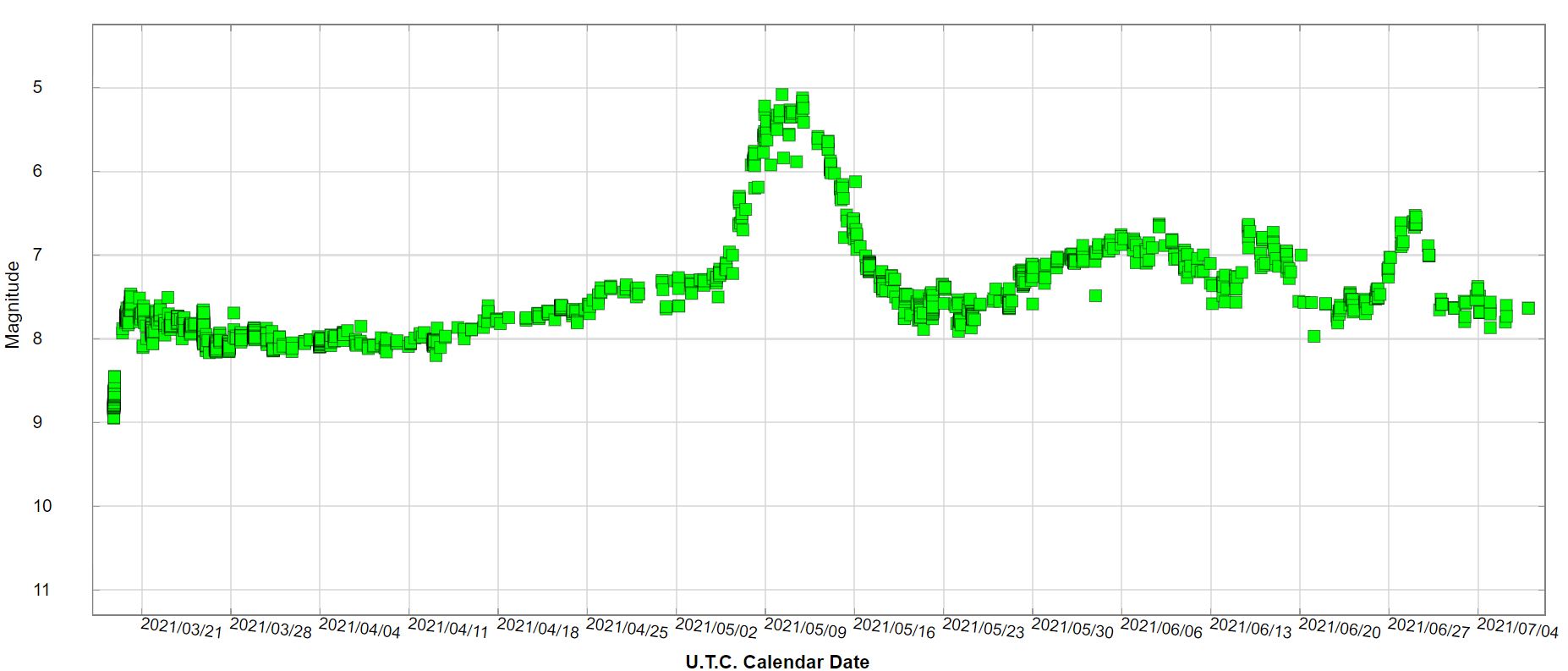

According to the AAVSO website, the brightness of the Nova drops again !!
Is this the start of more regular oscillations ?

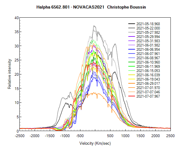

A new small “weather window”...to follow the evolution of the Halpha line of the Nova Cas 2021 !
Here is my two last spectra at high resolution obtained on July 7 at 1 h 07 TU (resolution of 18932, JJ = 2459402.5464), at 23 h 13 TU (resolution of 18662, JJ = 2459403.4672) and the comparison with the previous ones obtained with my LHIRES III (grating of 2400 lines / mm, acquisition time of 60 min for each spectrum (6 x 600s)).
Halpha line of Nova Cas 2021 on May 18th, 22th, 27th, 29th, 31th, on June 1st, 6th, 7th, 8th, 10th, 11th, 15th, 16th, 19th, 29th, on July 1st and on July 7th 2021
novacas2021_Halpha_Christophe Boussin.png (79.67 KiB) Viewed 12829 times

According to the AAVSO website, after a one magnitude drop between June 29 and July 1, the brightness of the Nova remained more or less the same between July 1 and July 7.
