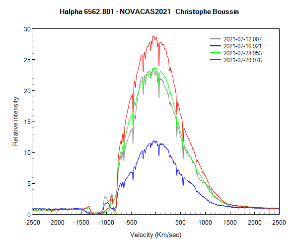

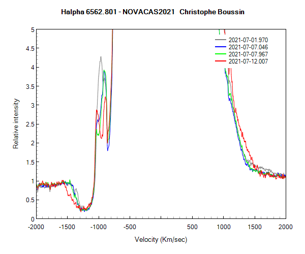

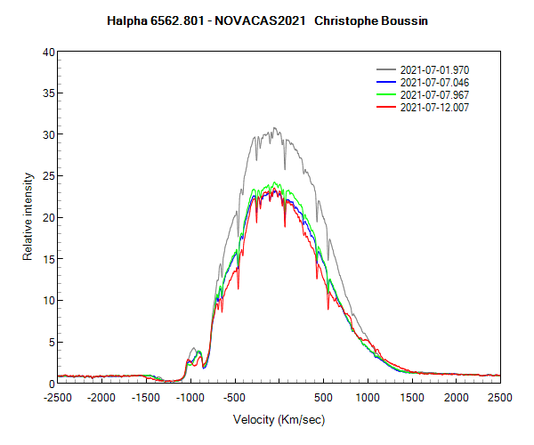

Here is a small update with one more spectrum before still several days of rain...
The spectrum was obtained July 12 at 0 h 10 TU (resolution of 18875, JJ = 2459407.5071) with my LHIRES III (grating of 2400 lines / mm, acquisition time of 60 min for each spectrum (6 x 600s)) and the comparison with the previous three ones.
The "blue" part of the Halpha line continues to evolve :
Clear skies to all !!
Matthieu Le Lain

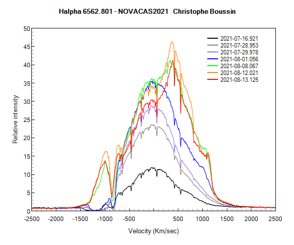

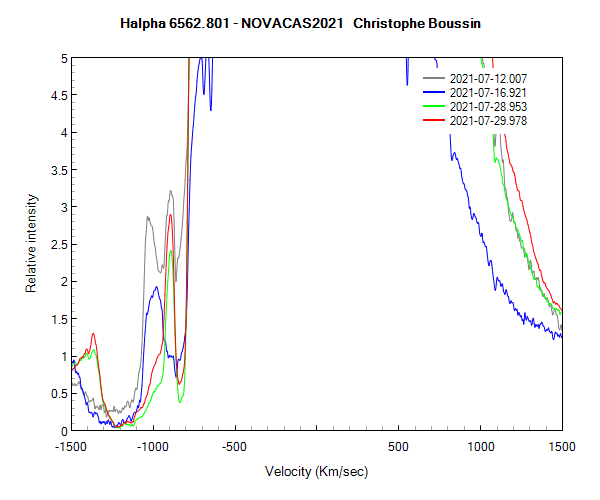

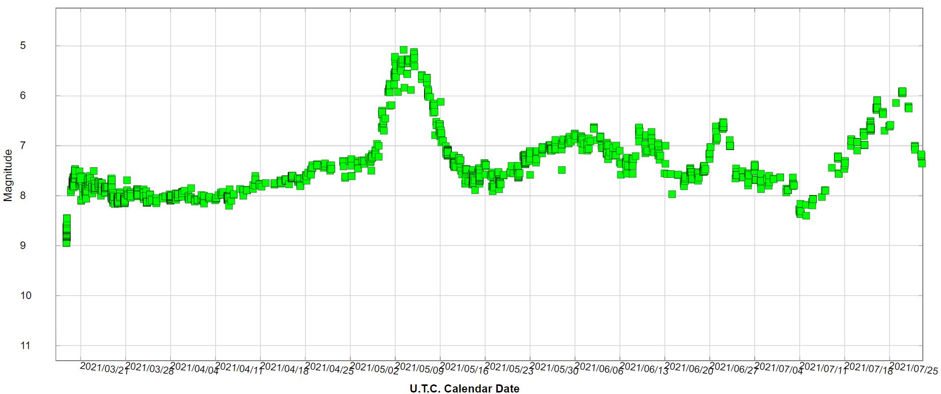

- Posts: 173
Nice spectrum Matthieu, the P Cygni profile is always well visible on the Balmer lines !
Here is my new comparison between my three last spectra of the Halpha line of Nova Cas 2021 at high resolution on July 16 at 22 h 06 TU (resolution of 18731, JJ = 2459412.4209), on July 28 at 22 h 52 TU (resolution of 19001, JJ = 2459424.453) and on July 29 at 23 h 28 TU (resolution of 18577, JJ = 2459425.4778) with my LHIRES III (grating of 2400 lines / mm, acquisition time of 60 min for each spectrum (6 x 600s)) and the previous one obtained on July 12.
Since July 16, the shape of the Halpha line profile in the "blue" part has evolved very clearly :

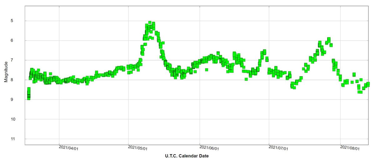

According to the AAVSO website, the brightness of the Nova increased by about 2.5 magnitudes (Johnson V) between July 11 and 26. Since then, it has decreased again by about 1.5 magnitude.
(Johnson V : green squares) Clear skies to all !!

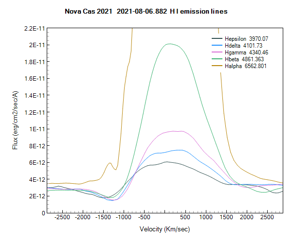

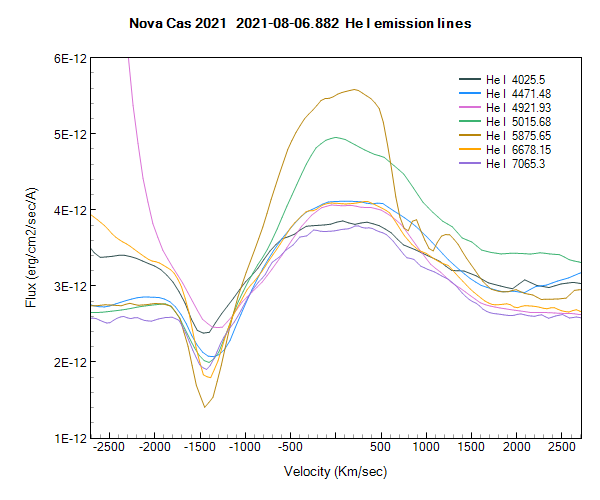

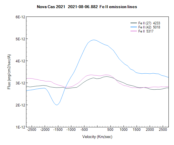

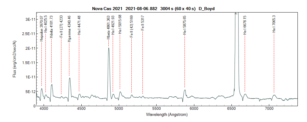

David Boyd
- Posts: 164
Here is a spectrum of Nova Cas 2021 taken on 6th August with a LISA (R~1065) and calibrated in absolute flux using a concurrently measured V magnitude of 7.70. There are broad emission lines of H I Balmer and He I, all with P-Cygni absorption dips. The Balmer emission lines have FWHM ranging from 1400 km/s at H-alpha to 1790 km/s at H-delta and FWZI from 2000 km/s at H-alpha to 2300 km/s at H-delta. P-Cygni absorption dips are at -1200 km/s in the Balmer lines and at -1400 km/s in the He I lines. Note the Na I absorption lines on the edge of the He I 5876A line. Fe II emission lines are relatively weak but also broad and have double peaks at -150 km/s and +350 km/s.

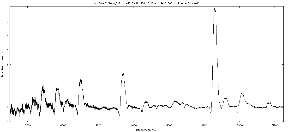

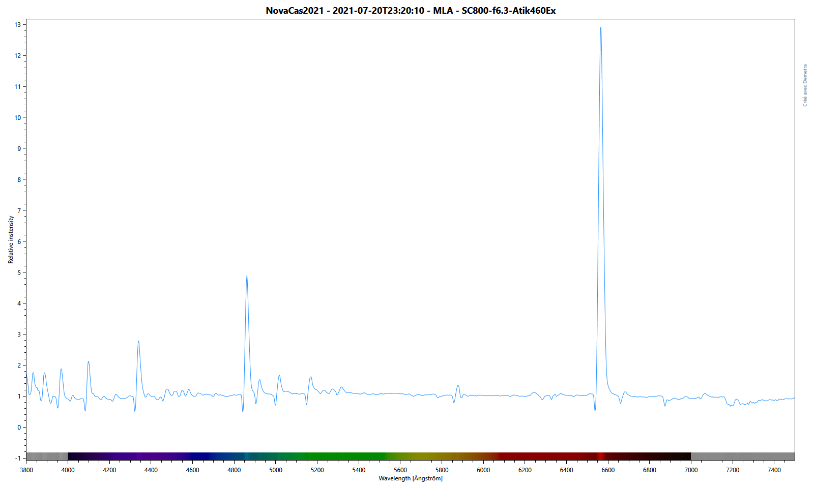

- Posts: 207
Bonsoir
Hier soir avec UVEX(4) motorisé reseau, G600 750nm sur SC8
Dans le proche UV Dans le proche IR (avec filtre d'ordre) Nova extrêmement brillante .

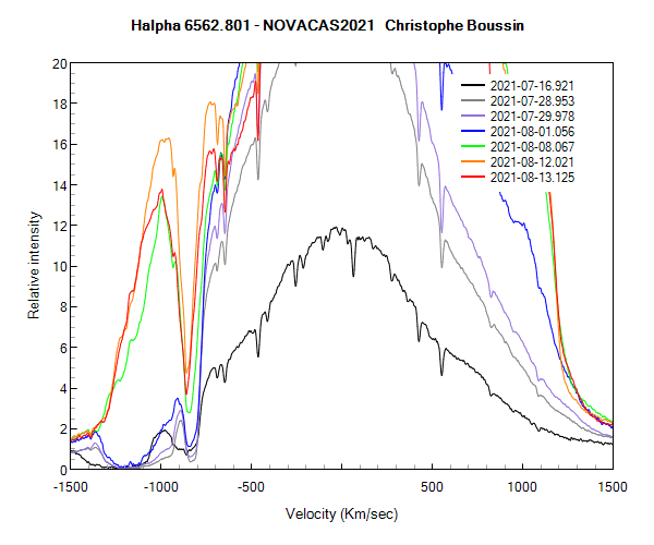

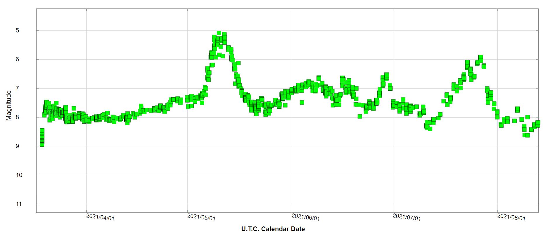

- Posts: 173
Here is my new comparison between my four last spectra of the Halpha line of Nova Cas 2021 at high resolution on August 1st at 1 h 20 TU (resolution of 18775, JJ = 2459427.5557), on August 8 at 1 h 37 TU (resolution of 18785, JJ = 2459434.5672), on August 12 at 0 h 30 TU (resolution of 18636, JJ = 2459438.5209), and on August 13 at 3 h 00 TU (resolution of 18396, JJ = 2459439.6251), obtained with my LHIRES III (grating of 2400 lines / mm, acquisition time of 60 min for each spectrum (6 x 600s) except the last one (4 x 600)) and the previous ones.
Since August 1, the Halpha line profile has undergone many striking changes. In particular with the emergence of a peak around + 390 km/s between August 1 and 8.

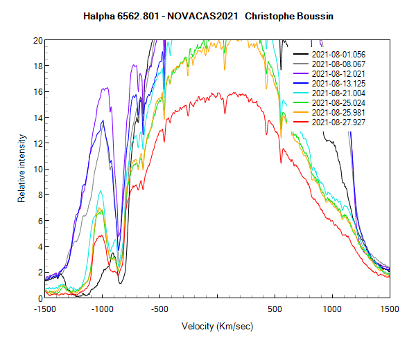

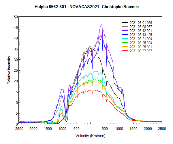

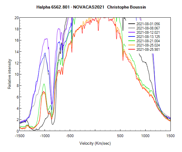

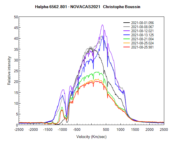

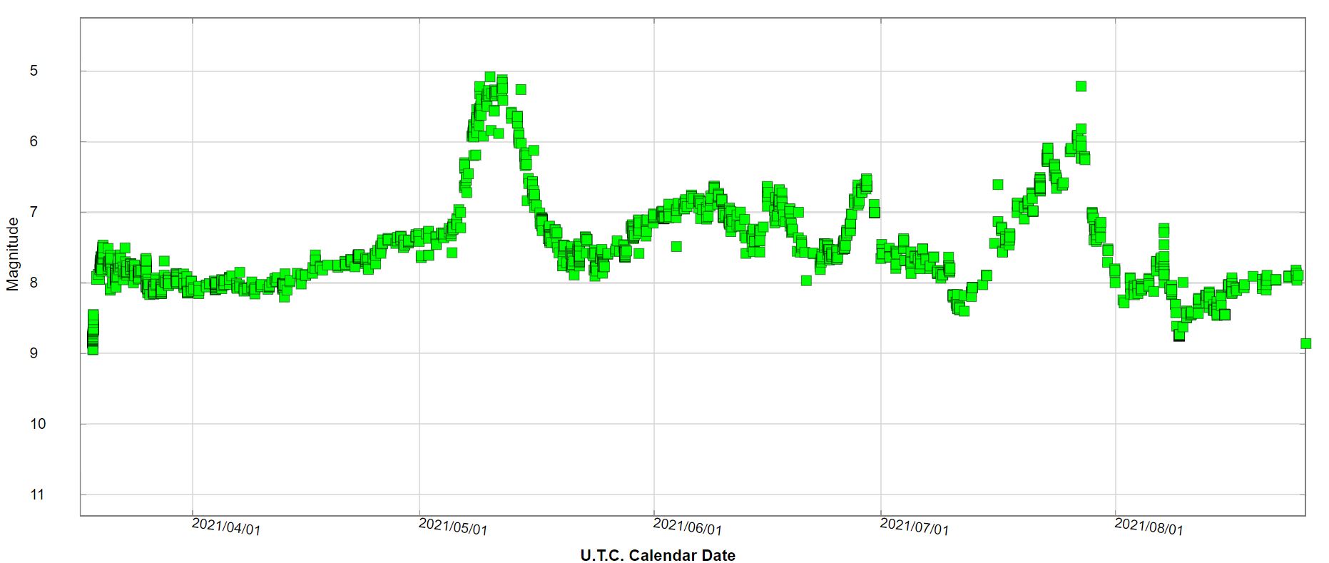

- Posts: 173
Here is my new comparison between my three last spectra of the Halpha line of Nova Cas 2021 at high resolution on August 21 at 0 h 06 TU (resolution of 18050, JJ = 2459447.5045, 8 x 600s), on August 25 at 0 h 35 TU (resolution of 17672, JJ = 2459451.5241, 7 x 600s) and at 23 h 33 TU (resolution of 17828, JJ = 2459452.4813, 6 x 600s), obtained with my LHIRES III (grating of 2400 lines / mm) and the previous ones in August.
The peak still visible in the Halpha line profile on August 13 disappeared between August 13 and 21 : The "blue" part also underwent new modifications between these 2 dates but the overall shape of this part is almost unchanged since the 21 : (Johnson V : green squares) Clear skies to all !!

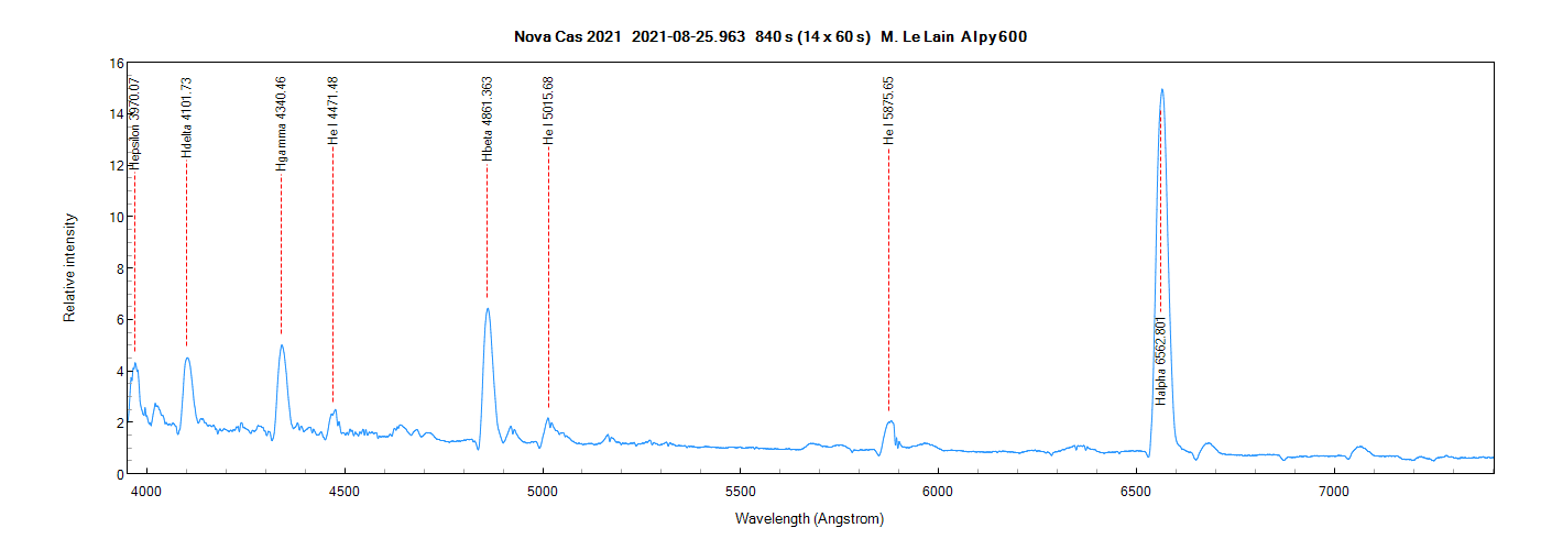

Matthieu Le Lain
- Posts: 24
- Joined: Mon Apr 15, 2019 4:33 pm
Hi all
congrats for your rigorous and close monitoring Christophe, it's very interesting so see the evolution.
Here is my new spectrum of Nova Cas 2021 with an alpy600
Matthieu
Matthieu
- Posts: 173
Thank you Matthieu !
Have you looked at your spectrum in detail ?
There are details that I think are interesting to identify...
Comparing your spectrum with other spectra in the ARAS database obtained before and after 26 August by other observers, I cannot find these details...
I wonder about these details in your spectrum...Some of these seem to be attributable to real lines !
In addition, on this date, the AAVSO's Nova Cas 2021 light curve shows a very clear decrease in brightness !
Is there a link?
Did other observers get a spectrum of the Nova Cas 2021 on the same date, 26 August ?
For my part, I continue to follow the Nova Cas 2021 with a new comparison between my last spectrum of the Halpha line of Nova Cas 2021 at high resolution on August 27 at 22 h 15 TU (resolution of 16625, JJ = 2459454.427, 8 x 600s) obtained with my LHIRES III (grating of 2400 lines / mm) and the previous ones in August.

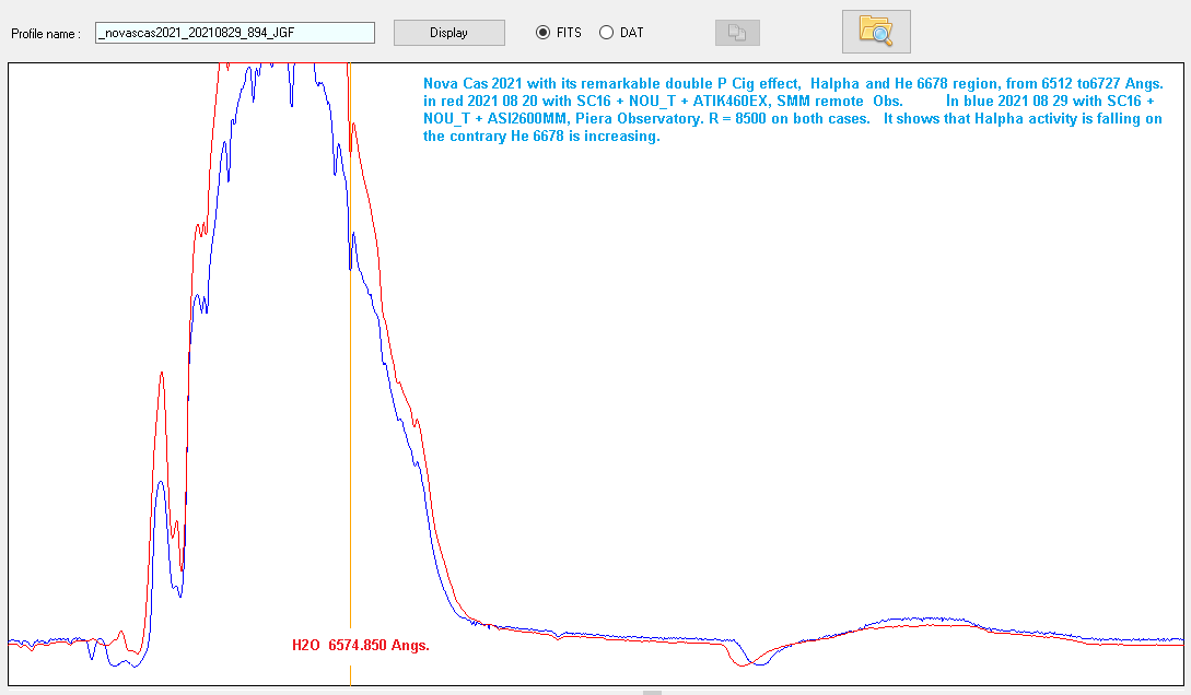

- Posts: 731
As you can see on excellent precedent observations by Christopher Bousin, David Boyd and others, I show here this interesting doble P Cyg effect.
Regards, J. Guarro.
Regards, J. Guarro.
