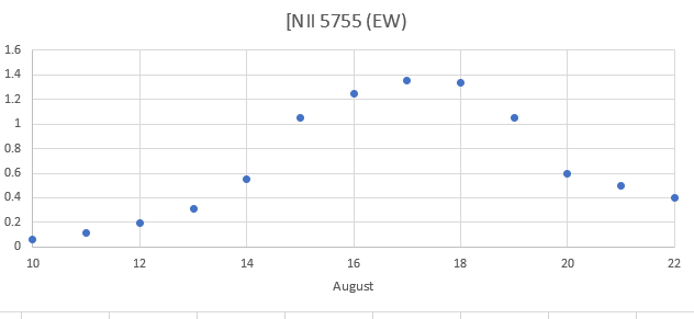

- Posts: 1566
A precision to the ATel:
[NII] 5755, formed in the symbiotic nebula is declining relative to the continuum since Aug. 17.5

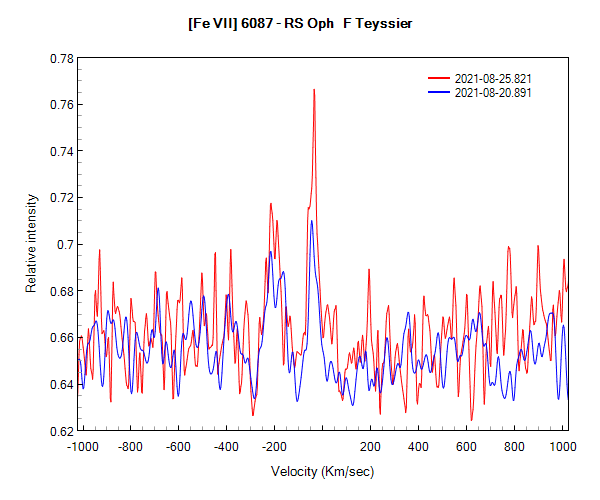

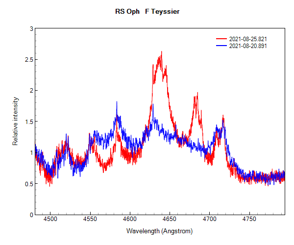

- Posts: 1566

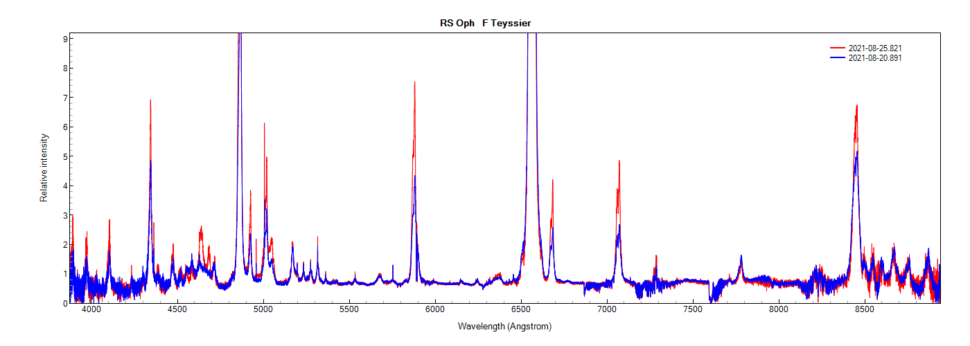

Day 16 after max.
An important milestone in the development of the spectrum: the appearence of high ionized lines in the ejecta.
NIII and He II
[Fe VII] is now obvious
[OIII] in the symbiotic nebula still raising according to the continuum
While EW([NII]) is stable at ~0.45
Now, waiting for very high ionized lines during the next month.
NIII and He II

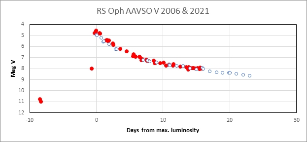

- Posts: 1566
Update of the lightcurve
(selected and smoothed V mag from AAVSO)
Short plateau around mag V = 8
The LC mimics almost perfectly the 2006 outburst.

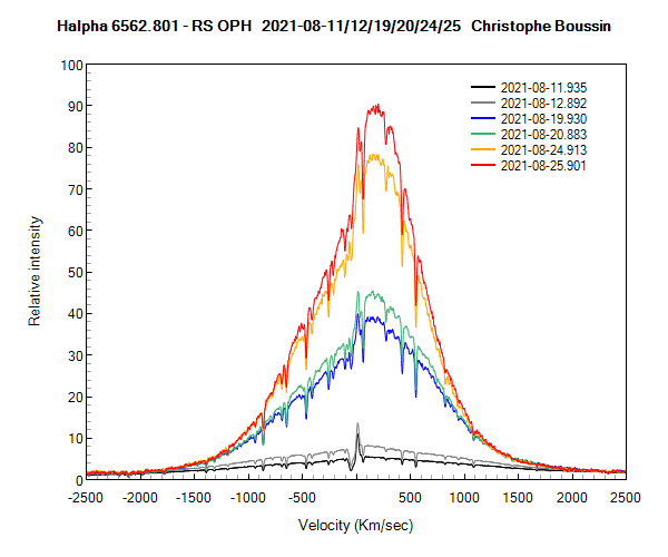

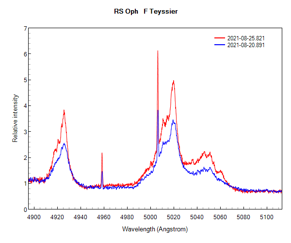

- Posts: 1432

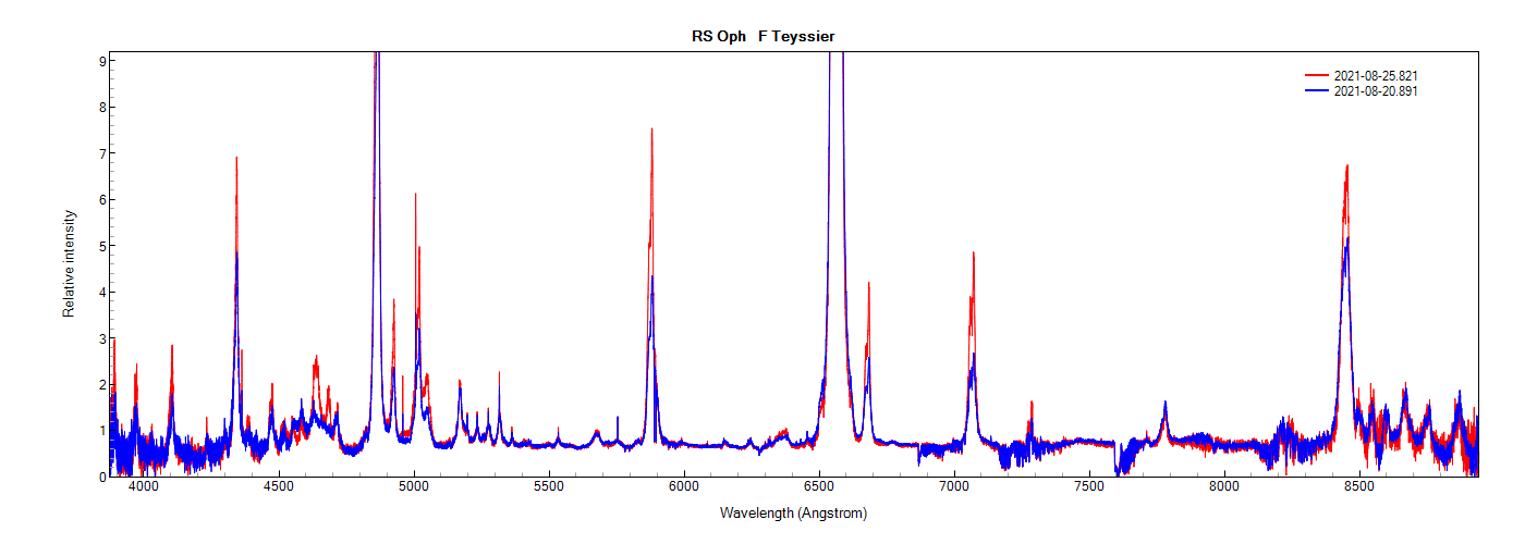

RS Oph at high resolution (R=26000) the August 19.828.(65 mm diameter refractor, Star'Ex spectrograph, slit 19 microns):
RS Oph at very high resolution (R = 40000) the August 25.879 (65 mm diameter refractor, Star'Ex spectrograph, silt 10 microns):
and a detail,
and a detail,

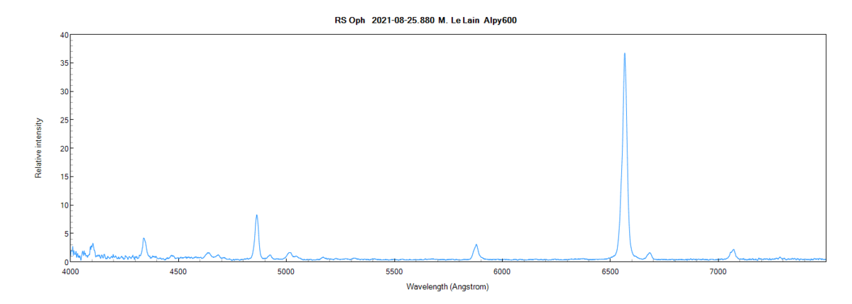

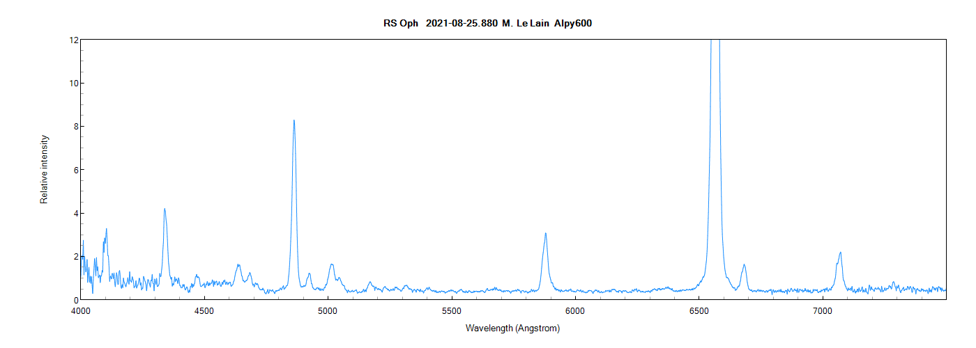

- Posts: 24
- Joined: Mon Apr 15, 2019 4:33 pm
I'm agree with Christophe, very impressive spectra Christian !

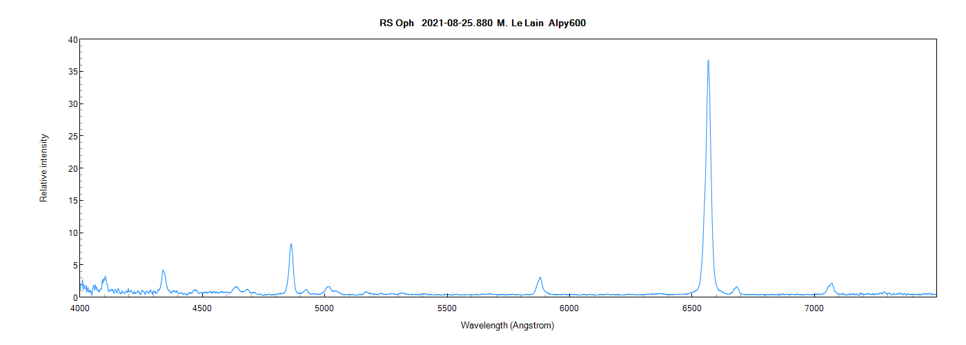

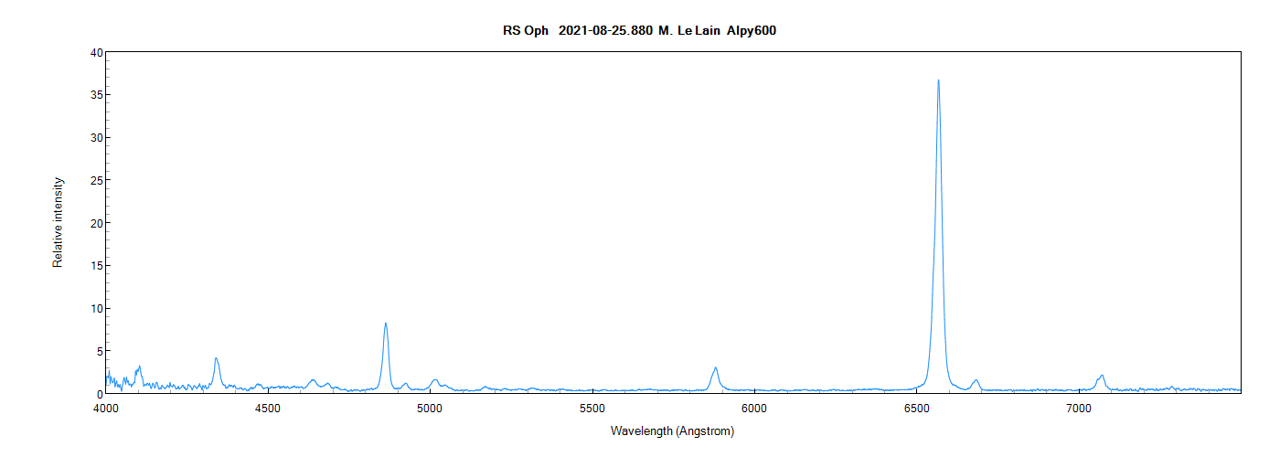

Here is a new spectrum of RS Oph with an alpy600
Zoom Matthieu
Zoom Matthieu
Last edited by Matthieu Le Lain on Sat Aug 28, 2021 12:58 pm, edited 1 time in total.

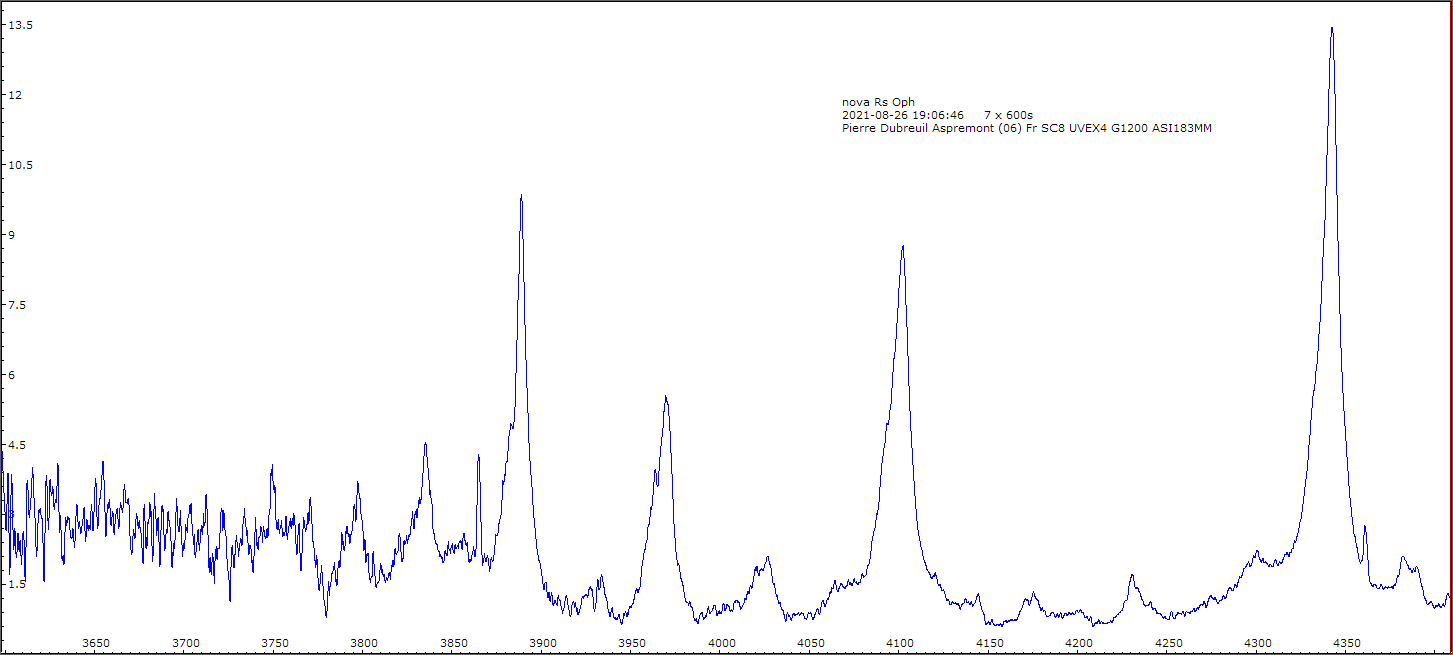

- Posts: 206
Bonjour
Région UV avec spectrographe UVEX(4)
G1200 slit 23µ
La magnitude semble avoir diminué .
Spectre zone UV
G1200 slit 23µ
Spectre zone UV

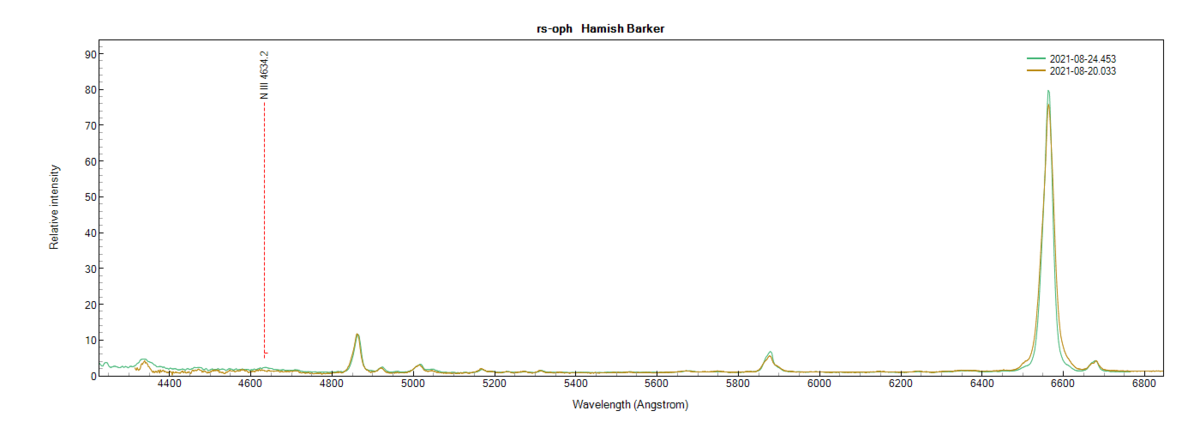

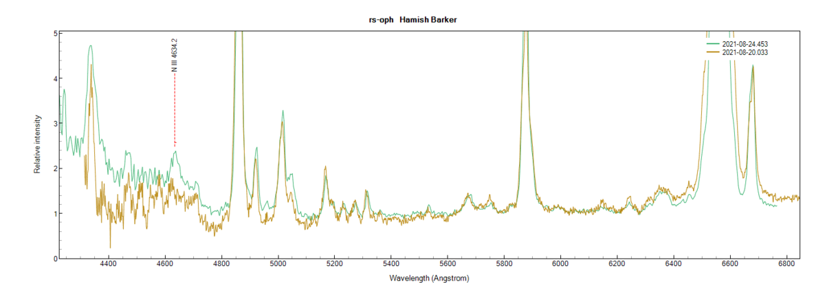

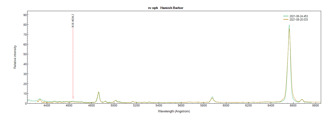

- Posts: 227

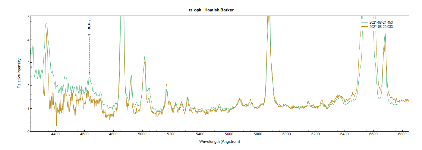

Low resolution with the L200 / 180lpmm grating from a few days ago (24. August). it's raining cats and dogs today!
