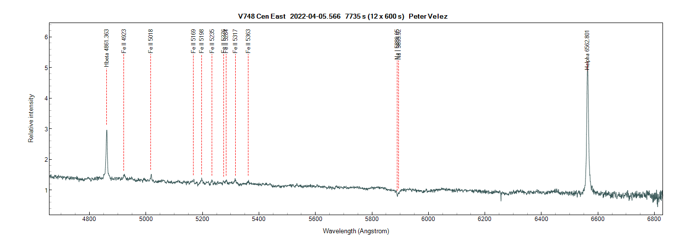

I'm late to this particular party - hopefully there is more to come.
Here is my spectrum from V748 Cen taken last night. The Balmer lines are in emission and I've marked the Fe II lines that are clear (also the Na lines). The SNR is not great as it was taken with my new automated set up. I'll look to have another crack at this later in the season.
Pete
Pete

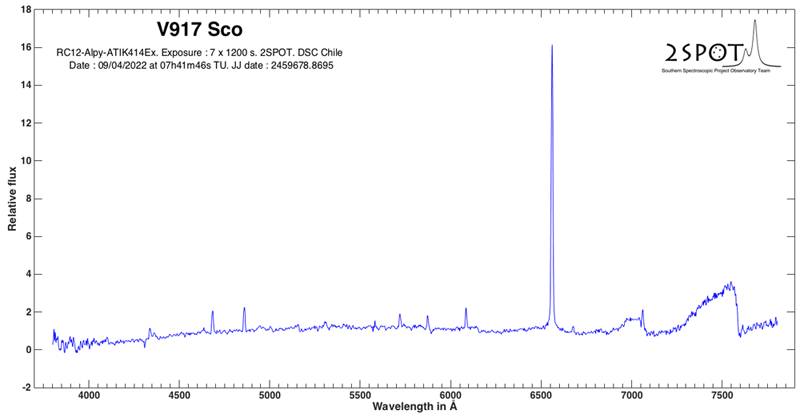

Some targets of this morning taken from Chile :

- V917 Sco :
Faint target around mag. V=15

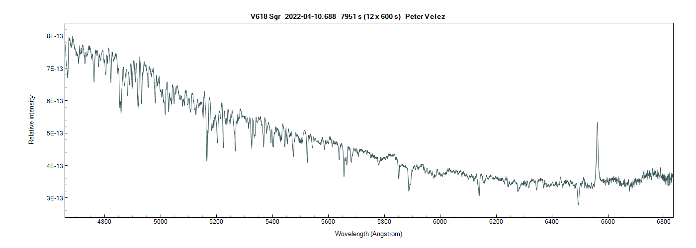

- Posts: 153
A confirmatory spectrum for V618 Sgr taken last night
I measured its V mag at 9.7 so the 2Spot team where spot on with their estimate (pardon the pun).
Its a busy spectrum!
Pete
Pete

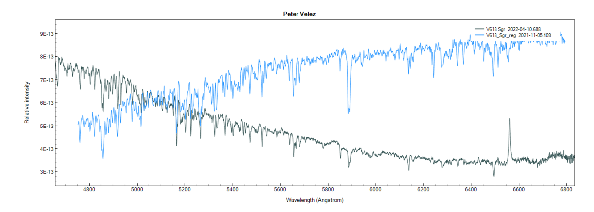

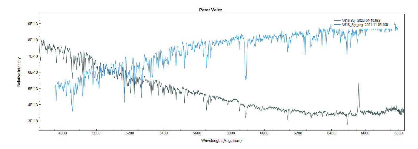

- Posts: 153
I had a look back at my last spectrum of V618 Sgr which was taken in November 2021. Here is a plot of both.
There is quite a change in continuum. Both spectra are flux calibrated so they are reasonably comparable.
The other big change is in the Ha emission.
Pete
Pete
- Posts: 1268
Hello Pete,
Nice evolution in only 5 months....
A target to follow....
Wow! that is a big apparent change in temperature for no change in V mag. (similar flux at 5200A) How does that happen?Peter Velez wrote:
- Posts: 153
Not sure Robin - hopefully not poor processing on my part!
Will have another look at it soon
Pete
Pete
