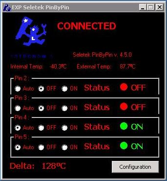

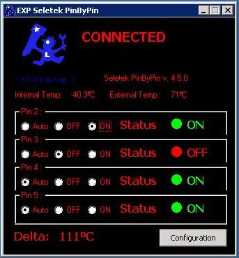

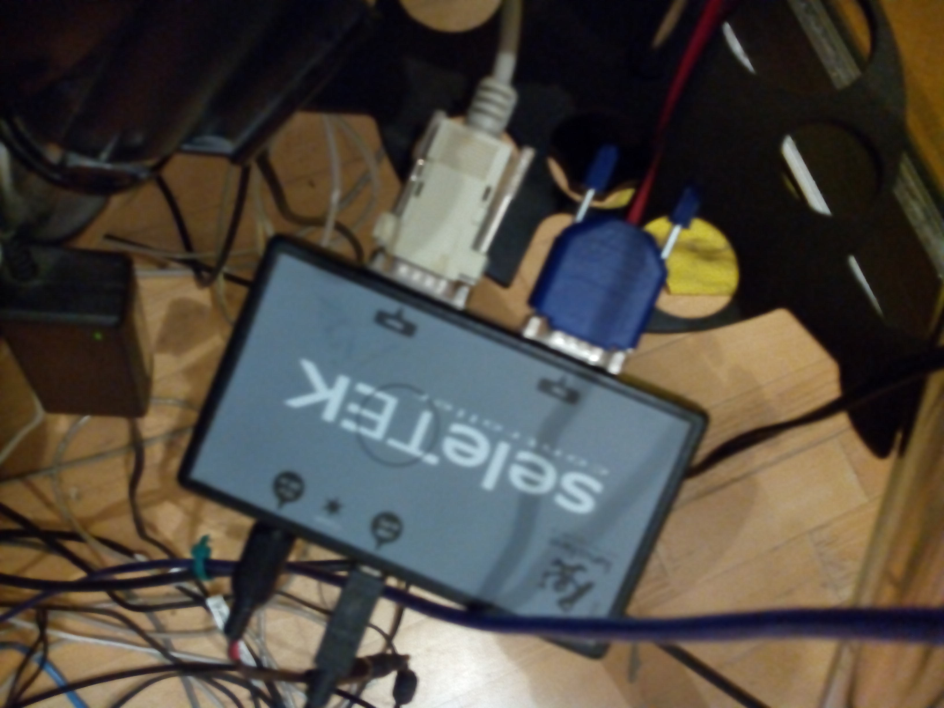

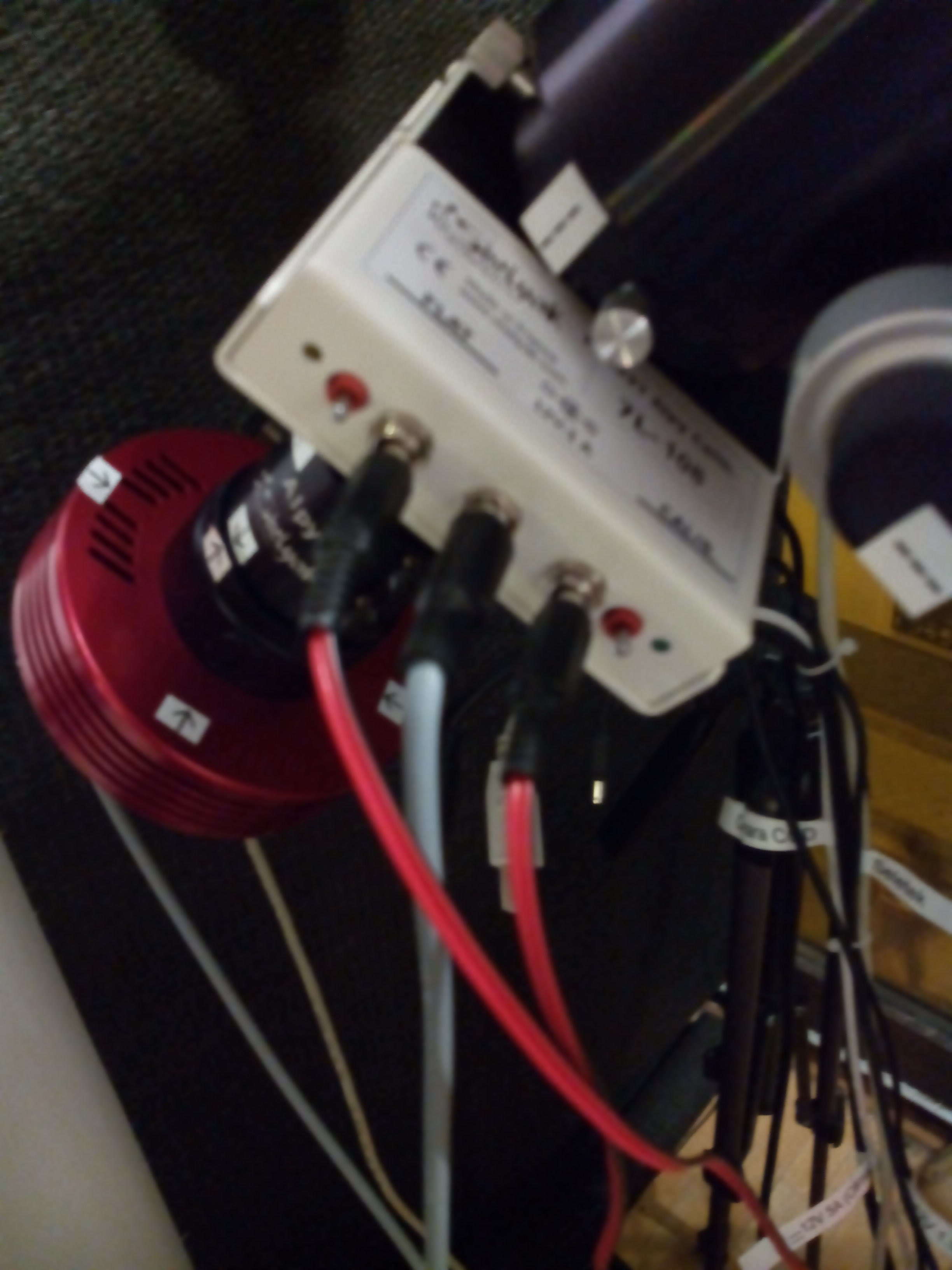

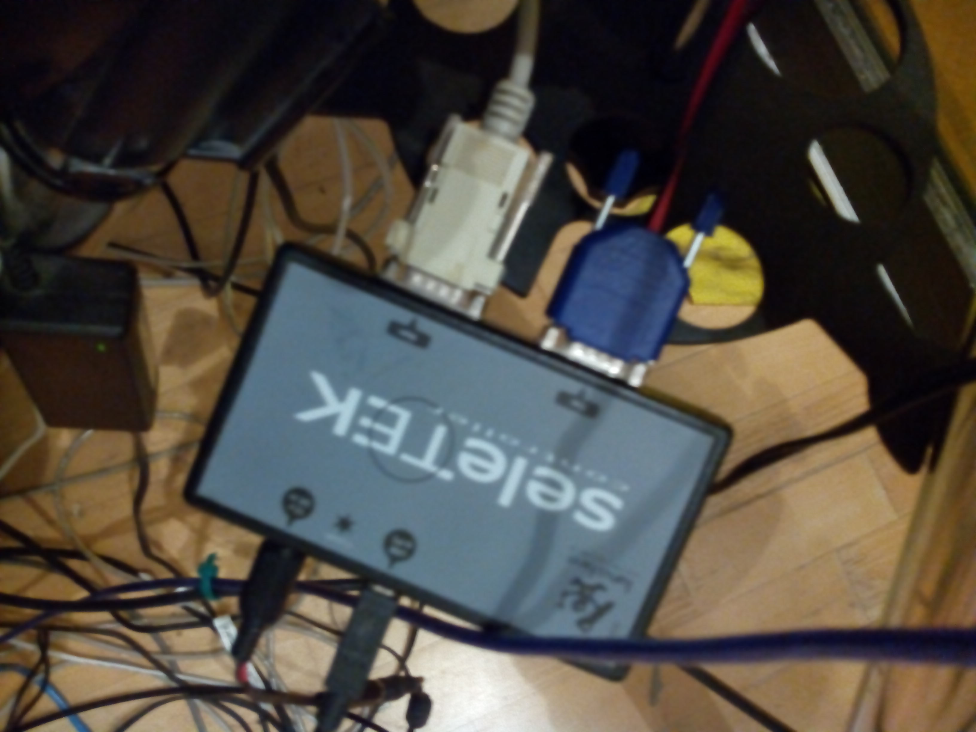

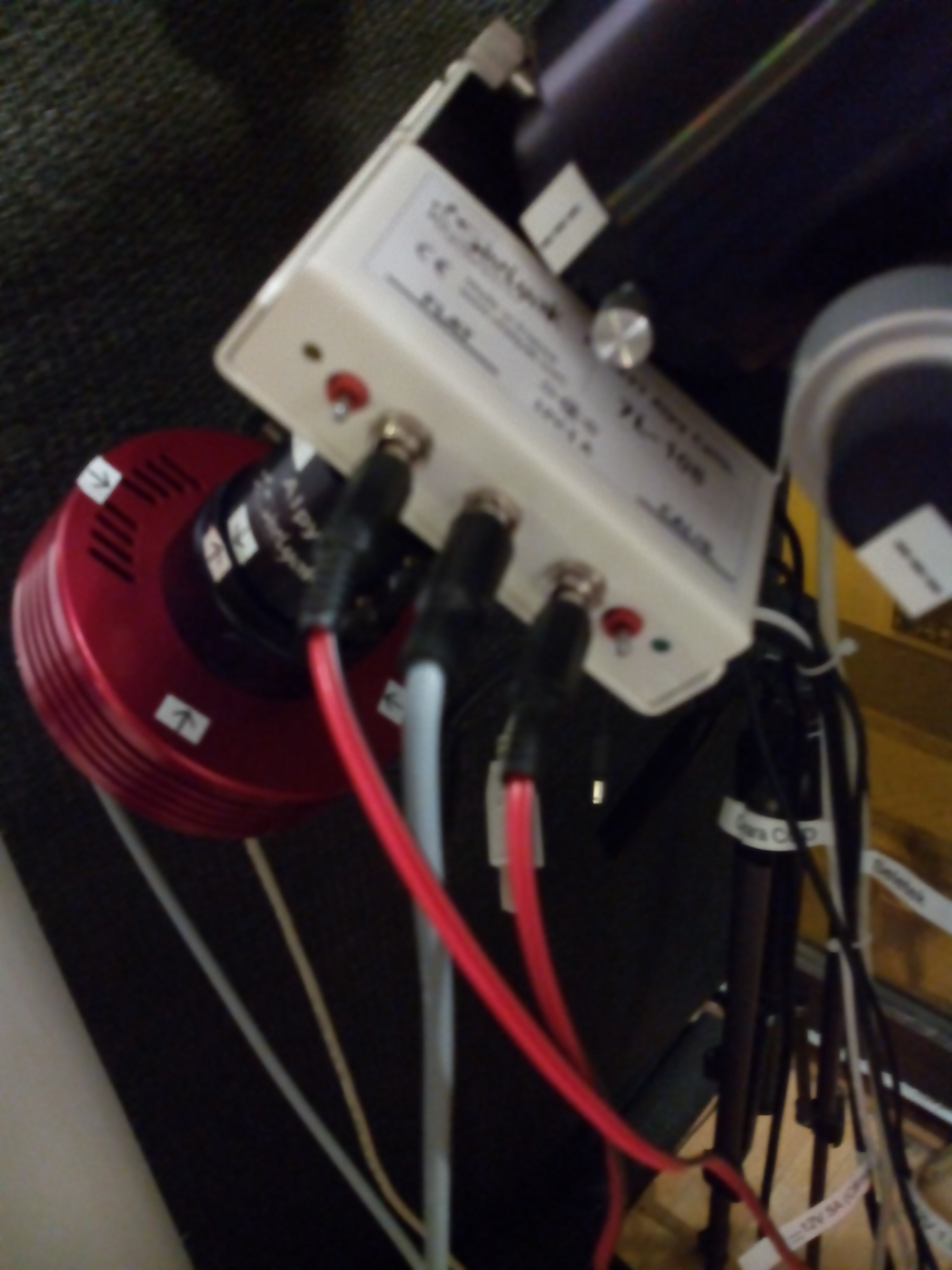

Seletek module has to output ports. On the first is attached cable to focuser motor. At the second port (EXP) is attached a two way connector which attaches to Alpy calibr. module connectors. At computer, from a program named pinbypin, I can switch ON and OFF pins number 2 and 3. Pin #2 is connected to flat lamp, and #3 is connected to neon lamp.

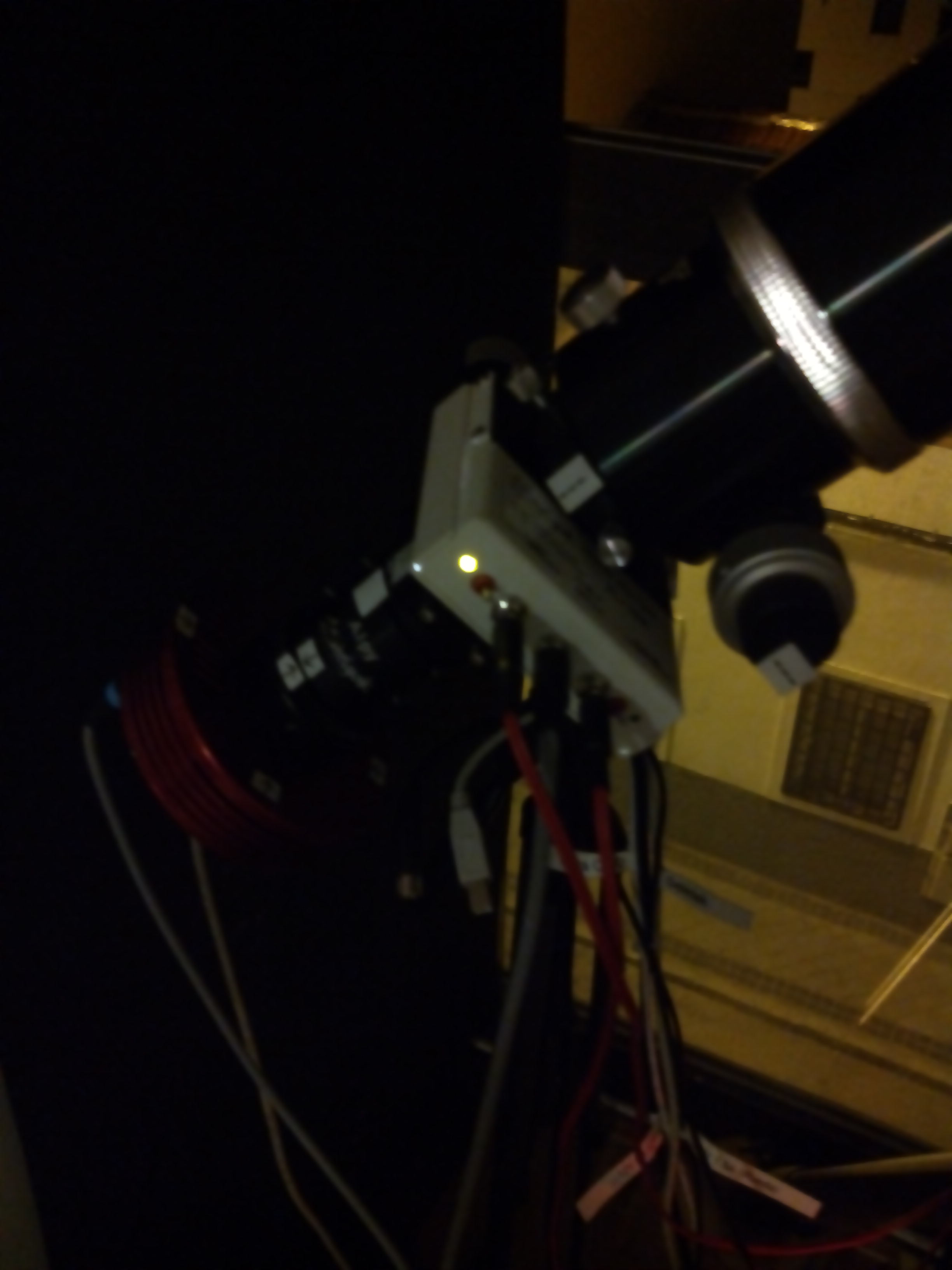

Connectors attached to calibration module
Controller module with motor cable (white) and calibration module cable (blue connector and red and black cables)

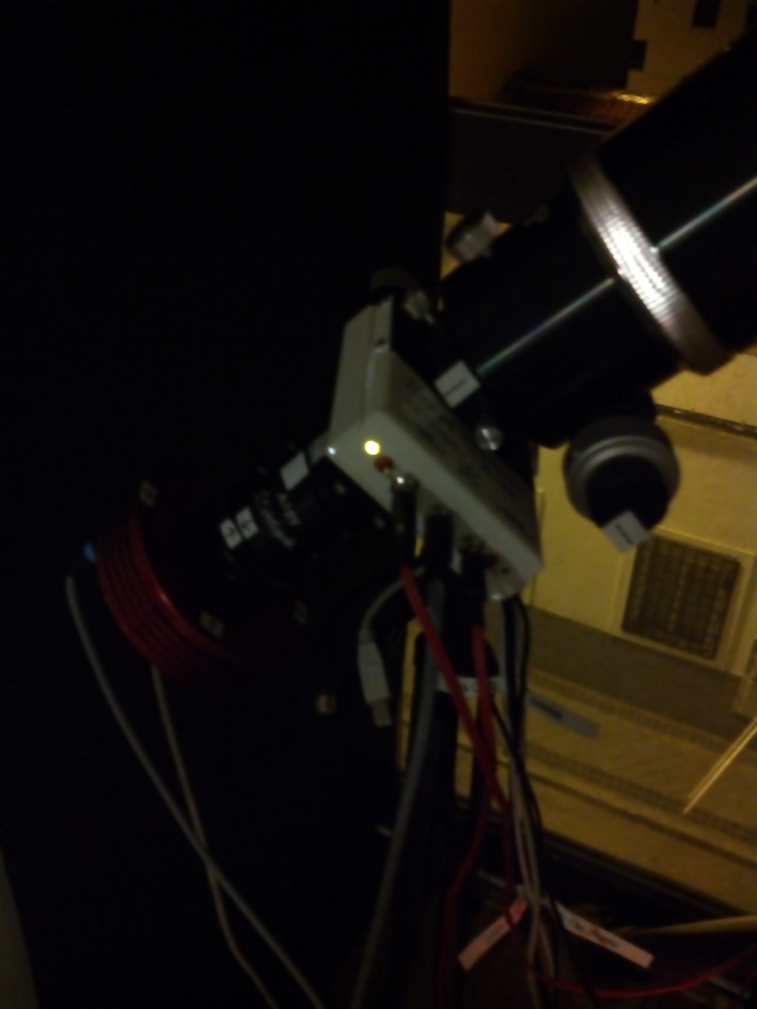

Calibration module tungsten flats light is ON
Pin 2 is switched ON
2 and 3 pins switched OFF

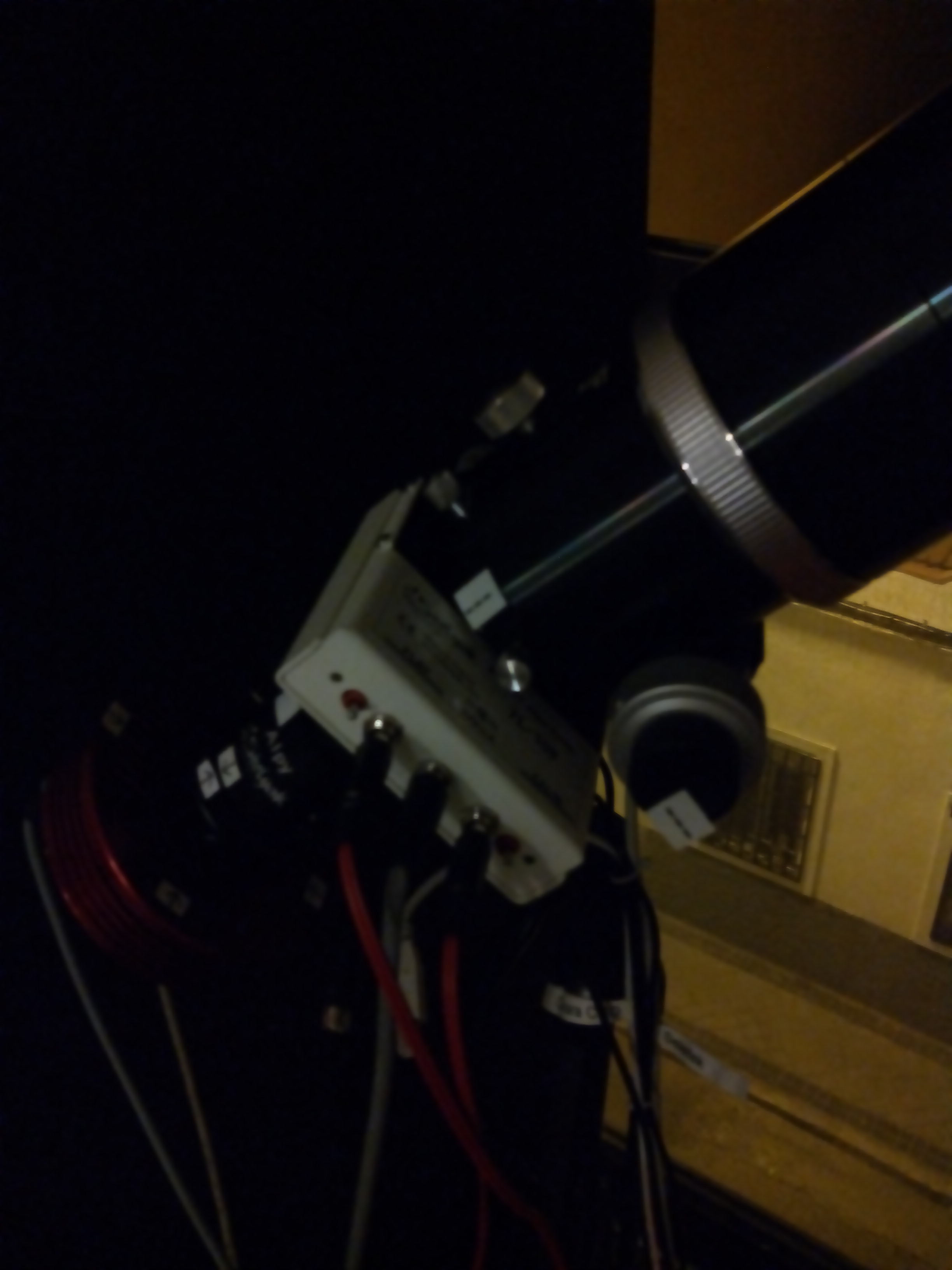

Calibration module lamps are switched off
