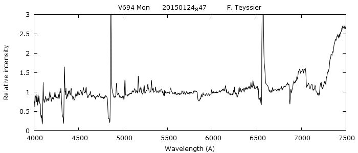

Spectrum obtained this night
Change in the absorptions since the last spectra obtained by Peter in december
Type A nr according to Iijima's classification (see : http://www.astronomie-amateur.fr/feuill ... 94Mon.html)
The velocity of the jet is about 2500 km/s

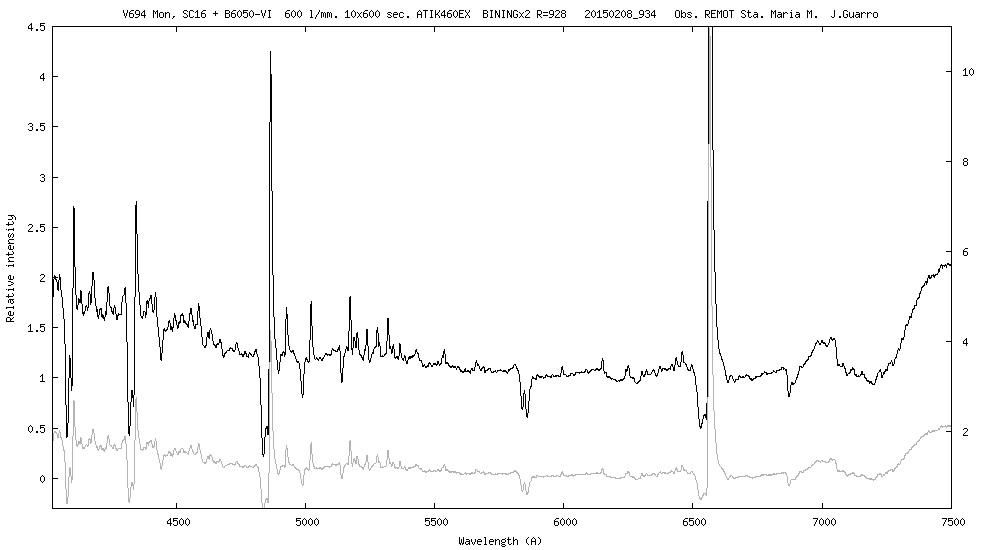

The V694 Mon, yesterday night.
J.Guarro.
J.Guarro.

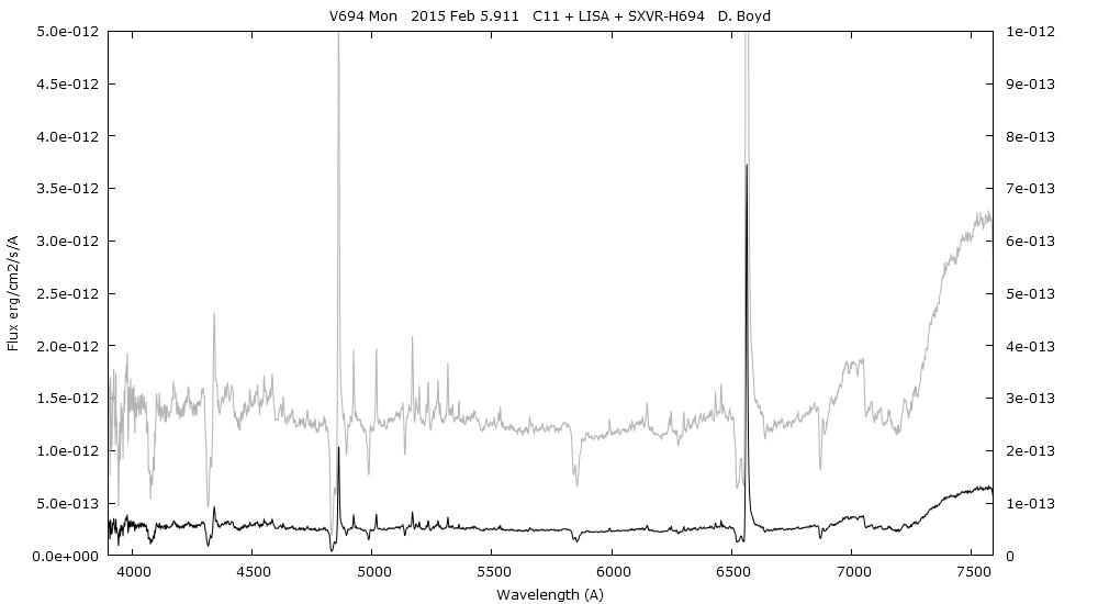

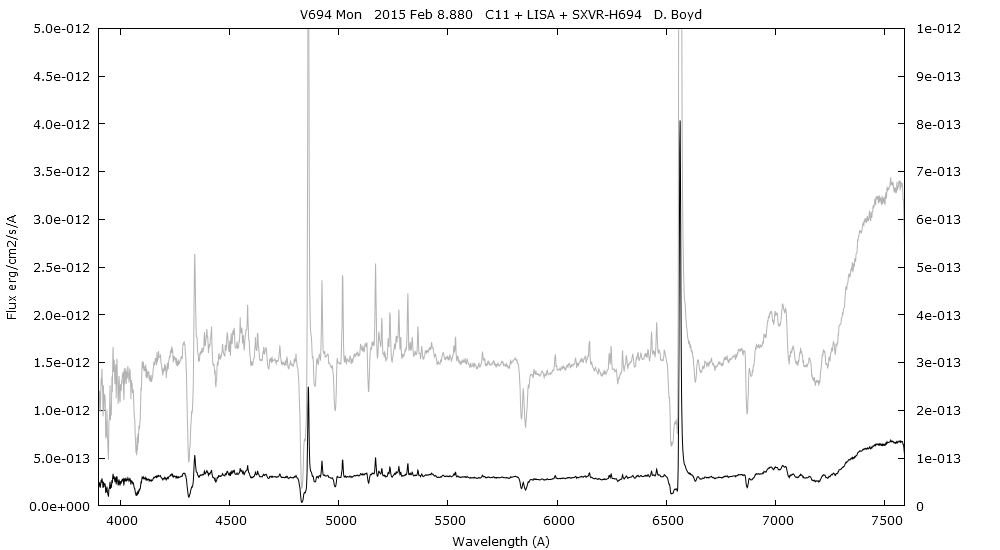

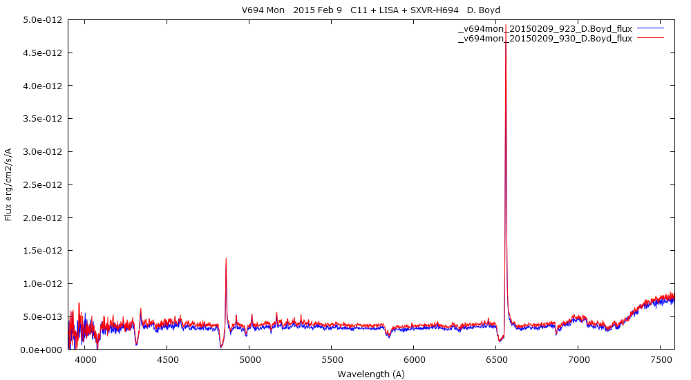

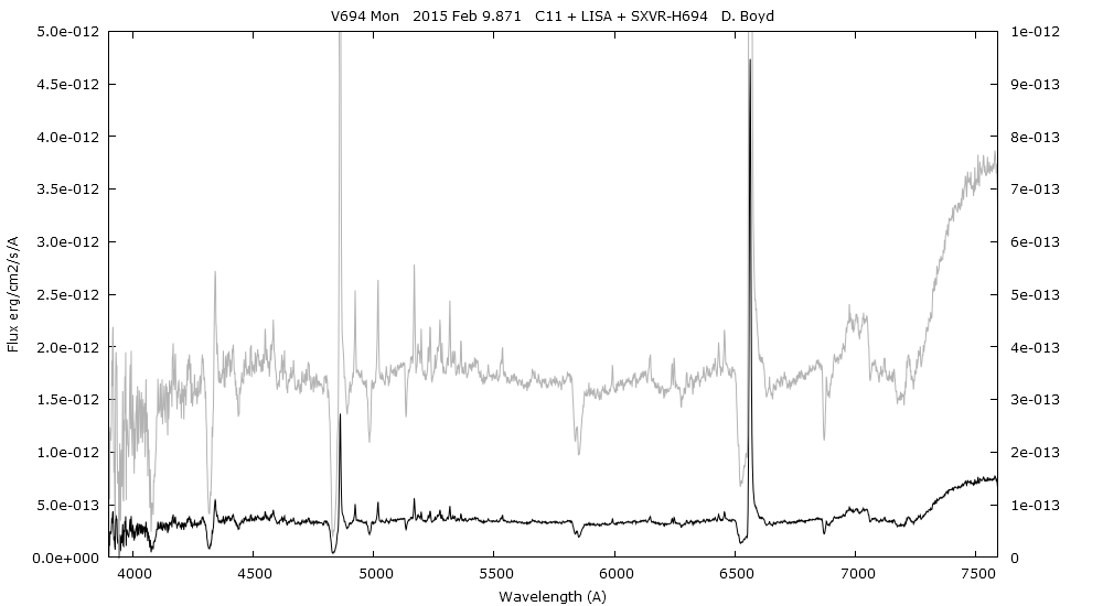

Three flux calibrated spectra of V694 Mon on 5, 8 and 9 August.
Photometric magnitudes and colours as follows:
5 Aug V=10.43 (V-Ic)=1.86
8 Aug V=10.21 (V-Ic)=1.73
9 Aug V=10.09 (V-Ic)=1.67
Hα, Hβ and Hγ line fluxes have increased David

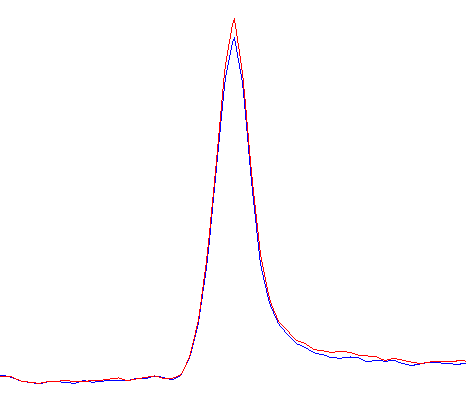

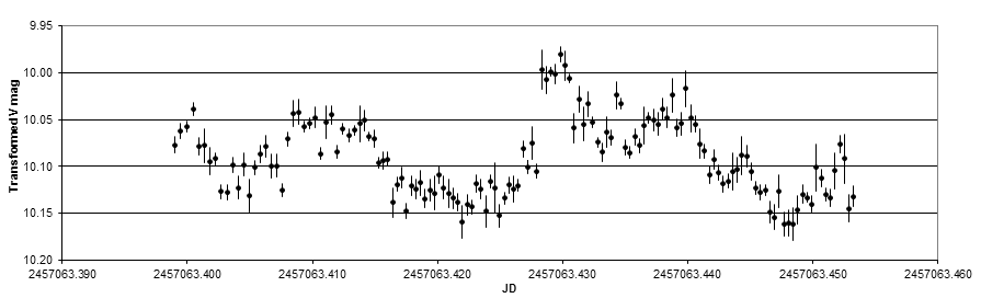

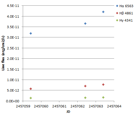

While recording the spectrum on 9 August I was also measuring the variation in V and Ic magnitudes. The V magnitude is shown below
I compared the two 5 minute spectral exposures taken at 20150209.923 (JD 2457063.423) when the mean V mag was 10.14 and at 20150209.930 (JD 2457063.430) when the V mag had risen to 10.00. During the 10 minutes between these exposures the change in the spectrum is shown below
At the Hα emission line, the flux increased by 3.4%

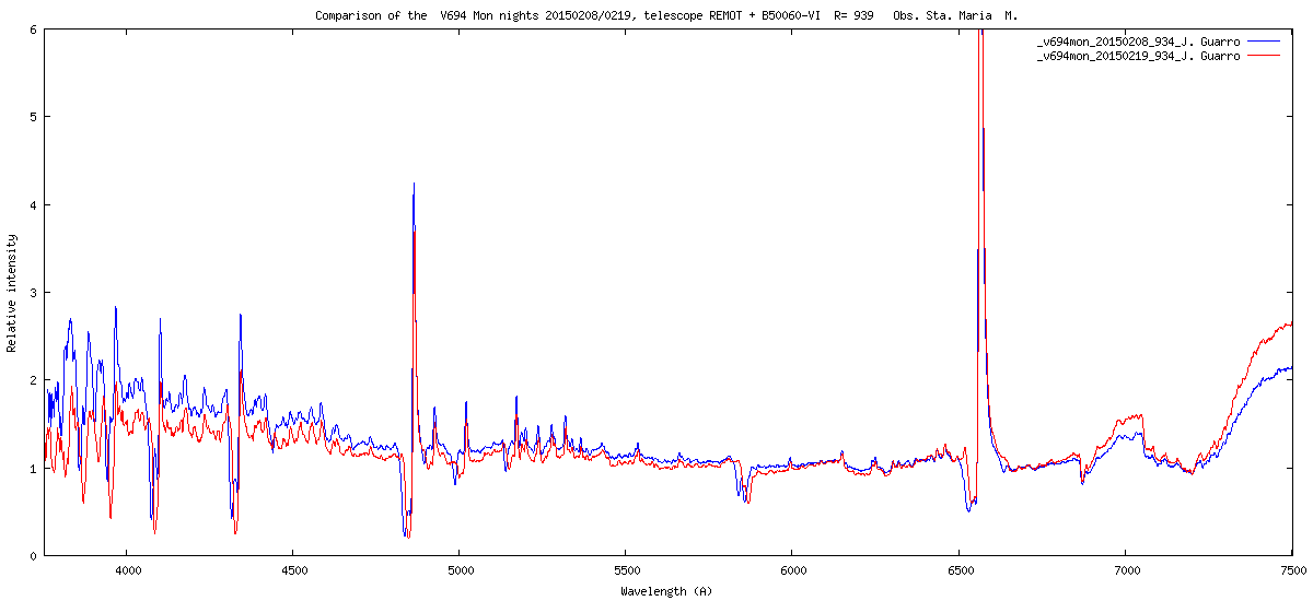

To all:
Comparison of two nights of V694 Mon.
J.Guarro.
J.Guarro.

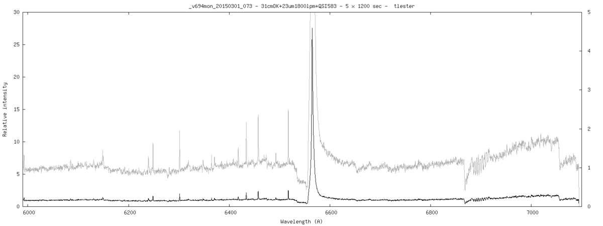

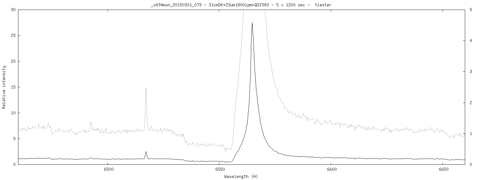

Re: V694 Mon = MWC 560

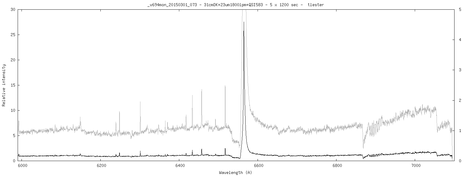

Finally after nearly two months of nights that were just too cold for me to operate we had a warm night. It only reached -17C!
After Christians's last result I decided to see what I could do with my 1800lpm grating ( R = 8900) on V694 Mon.
I am very pleased as I had not thought I could reach such faint objects at this resolution with reasonable signal to noise.

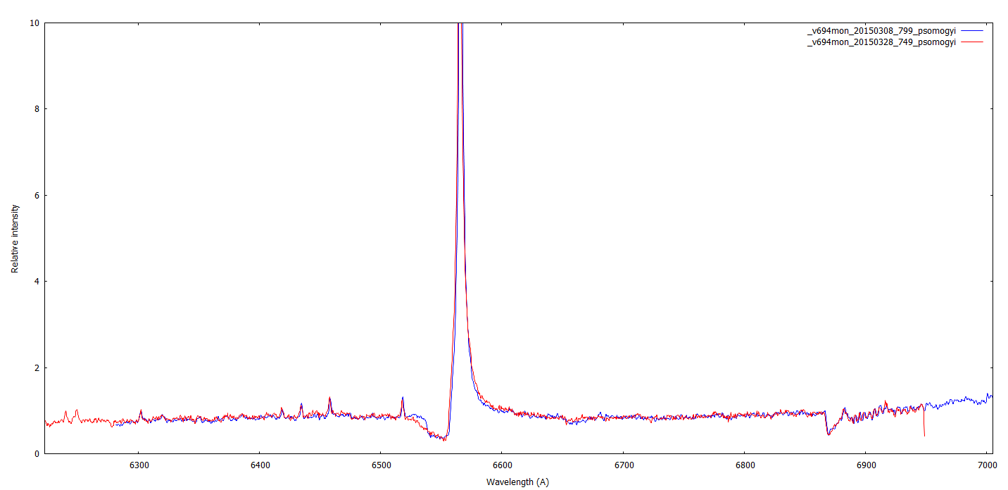

Did a weekend catch (250/1000N, APM barlow, LHires 600/mm, 23um slit):
Old was 5 x 1200 sec, new is only 3 x 1200 sec.
