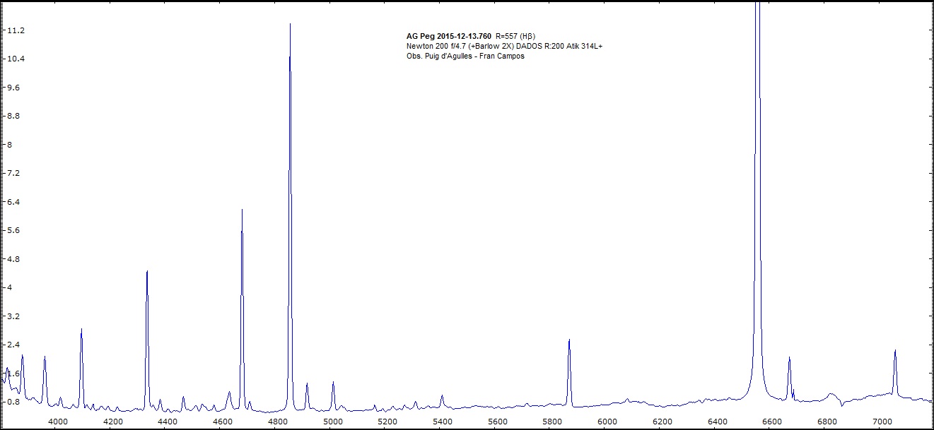

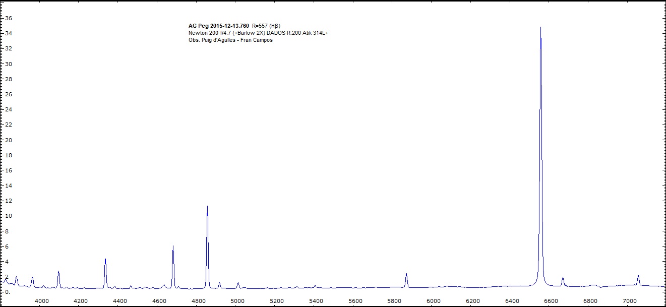

Post by Francisco Campos »

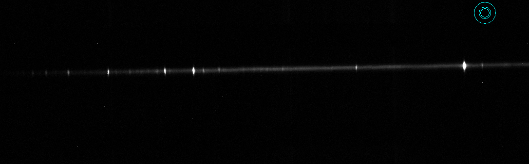

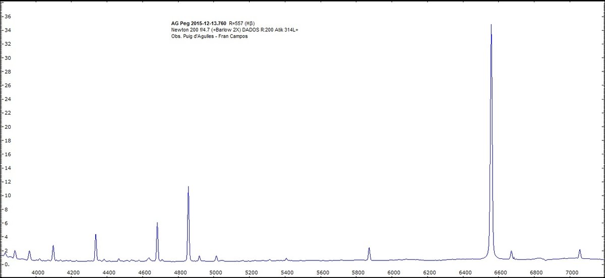

here I report observations of two symbiotic stars. After a lot of problems with ISIS, finally I had to reduce them with VSpec.
The main problems with ISIS are that, because I work with a DADOS spectrograph and there is not an internal calibration lamp, I had to use a current energy-saving lamp and calibrate the spectra using only 5 lines (those of mercury at 4046, 4358, 5461 and 5770 A, and one of argon at 6308 A). Very soon I will built a better calibration lamp based on a RELCO starter.
Due to this issue, I have failed trying to calibrate the spectra with ISIS. So I proceded in a similar way with VSpec:
Firstly, I took single spectra of the variable star (8-10 single spectra) and the comparison stars (HD 208565 for AG Peg and HD 39357 for UV Aur). Without moving the scope, I took the calibration image with the lamp and a paper covering the scope objetive. Then, I took bias, darks and flats.
Then, with MaximDl, I rotate and calibrate the images with bias and darks only, because if I calibrate with flats, I don't know why, the spectra took a strange appearance and the intensities of the emission lines became completely altered and unreal :? What are the Maxim doing bad?
So, with VSpec. I calibrate all the images in lambda. I do binning of the star and background. I substract the background. Repeat the same with the comparison star (I think it is a good way to remove light pollution).
Then, I use the comparison star to determine the instrumental response, using the VSpec library.
Finally, I divide the profile of the variable star with the instrumental response.
Problem: I can't save the spectra in BeSS format: VSpec saves a fit image but if I try to load it, VSpec returns the error: "file fit with more than two plans: unreadable".
Well, I hope to do all this work in the future with ISIS. But I got stuck trying to calibrate in lambda only with the calibration lamp.

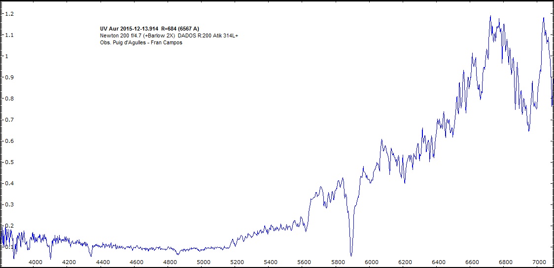

And here is a spectra of UV Aur. Please, if it is something bad, tell me how to correct it

Re: AG Peg and UV Aur
Hi Fran,
If you save the spectrum profile as a fits file (for example using "file" "export fit for BeSS" it is saved as a 1D profile, not a 2D image. You should be able to reload it (or any other spectrum profile saved as a fits file) back into Vspec using the "file" "open profile" command (not "file" "open image" which expects a 2D image)
Hope this helps

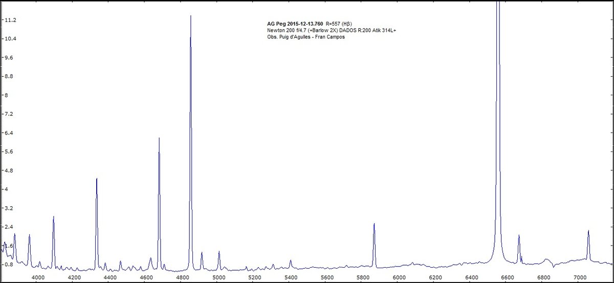

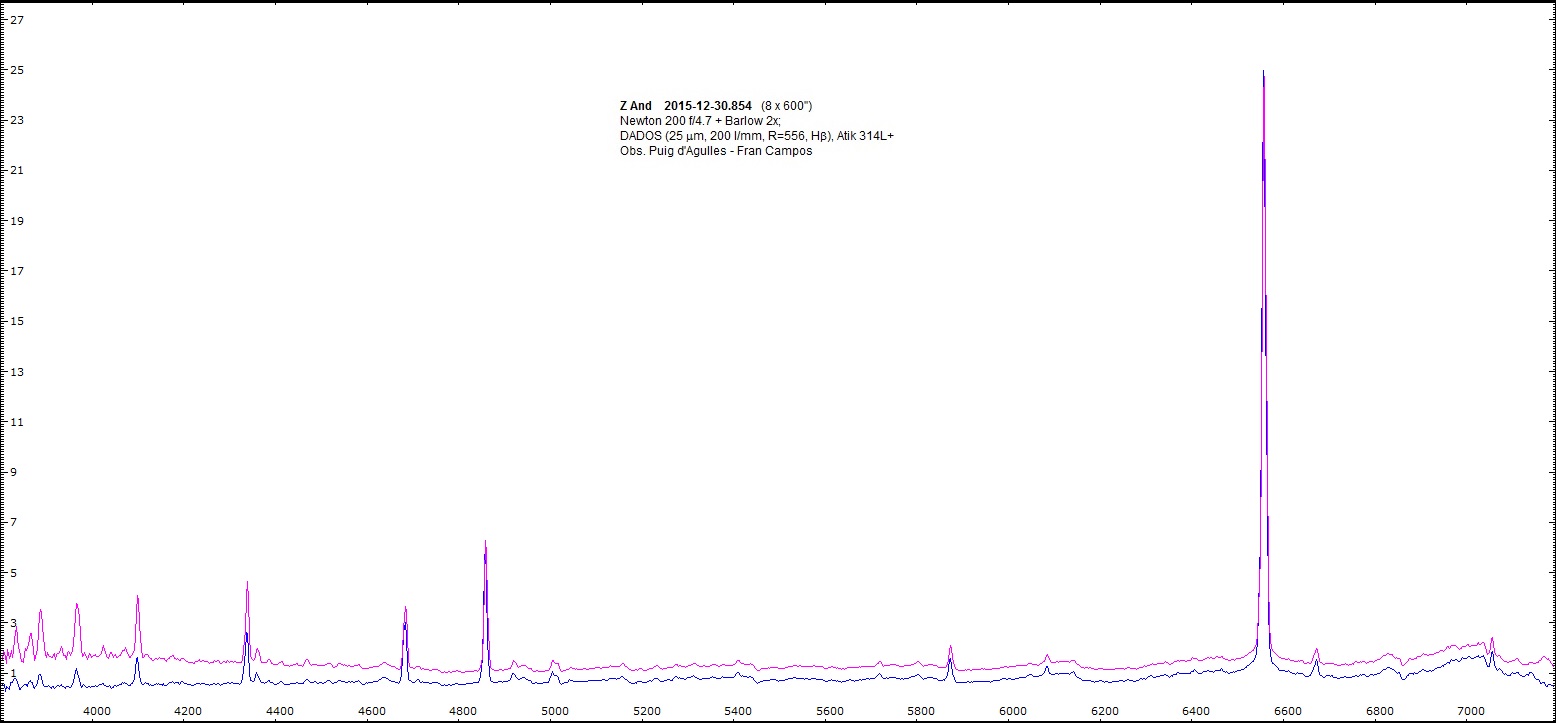

Well, I have reanalyzed an observation of Z And with all the images calibrated with bias, darks and flats. The light pollution has been removed by substracting the background of the same spectra. The instrumental response has been calibrated using the star HD 222439 (A0 V). In the next figure you can see both spectra: in blue the original spectra obtained from images without flat treatement; in pink, the spectra calibrated with flats. The difference are quite relevant. Do you think the spectra is ok?

Hi Fran,
I think summing or (floating point) averaging the flats should give the same result.
Yes the difference between the flat corrected and uncorrected spectra does look strange. Any flat field corrections are normally at small scales, not broad differences in scale at the blue end like this. (Any broad shape effects should be removed by the instrument response). I can suggest a few things to check.
Have you corrected your flats with flat bias and darks ?
Are you bias and dark correcting your spectrum images before flat correcting ?
VSpec has a limited dynamic range compared with more modern image processing packages so check that the preprocessed spectrum images are not saturating in VSpec
If you process the reference star star spectra with and without flat correction using the instrument responses you have calculated do they both look the same and agree with the library version ? (This will check that your flat corrected instrument response is working ok)
Francisco Campos wrote: And yesterday, while I was treating a spectra of Z And and his calibration star, I noticed that the calibration star seemed saturated in the blue zone (the raw images had up to 26.000 ADU's only): VSpec measures intensities of 32767 ADU's in the blue zone, so I am worried about doing something bad.
Yes I think that could be the problem. If the flat corrected image of the reference star is saturated in the blue in VSpec, the calculated instrument response will be too low at the bue end which will make the flat corrected Z And spectrum too high. You could try scaling the reference star flat corrected image (divide by 2 say) before loading it in VSpec to see if this corrects the problem

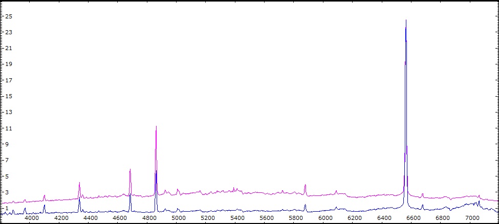

Ok, I reanalyzed the spectra of Z And and checked how MaximDl does the pretreatment: flats have been treated (substracted) by bias and darks. To avoid saturation problems, I have stretched the histogram (linealy) with MaximDl in order to avoid saturation in VSpec. The final spectra is quite different and closer to the raw one, but I still see differences, specially if I compare the Balmer bands intensities. And this one concerns me specially, because all the data that I could extract from the spectra won't be valid.
In this image, the raw spectra is the pink one, and the new corrected one, in blue.
z and tratada y strech con el flat.jpg (58.32 KiB) Viewed 9451 times
What it is clear is that correcting images with bias and darks, the resulting images change very little (removes hot pixels and very few more). But the real problem comes with flats. When I process pictures or photometric images with flats, the image changes litte (basically, vignetting dissapears) but now, I don't understand what's happening.

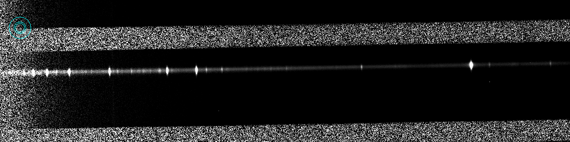

Here's an image of the Z And spectra with only darks anb bias:
espectre cru.PNG (233.29 KiB) Viewed 9451 times
and here's the same image with darks, bias and flats. My spectrograph has 3 slits and, because I fill 3/4 of the full histogram and the slit I use is the narrower one, the two others are fully saturated (I don't use it, of course).
Espectre tractat.PNG (153.95 KiB) Viewed 9451 times
Hello Fran,
Your flat corrected spectrum image looks ok but you might need to average more flats to reduce the noise at the extreme blue end.
I will try to explain more clearly why the flat corrected raw spectrum looks different to one which has not been corrected
Consider a perfect spectrograph with no flat defects and ignoring atmospheric absorption, then :-
uncorrected measured spectrum = true spectrum * instrument response ------ 1
and the flat = flat lamp spectrum * instrument response
so when you do a flat correction:-
flat corrected measured spectrum = uncorrected measured spectrum / flat
so
flat corrected measured spectrum = (true spectrum * instrument response) / (flat lamp spectrum * instrument response)
so
flat corrected measured spectrum = true spectrum / flat lamp spectrum ------- 2
Note how ---1 is different from ---2 This is why you see a big difference in raw spectrum shape between the flat corrected and uncorrected raw spectrum
It also explains why the intensity of the flat corrected spectrum is much higher at the blue end (the halogen flat lamp spectrum is very low here)
The effect of the flat lamp spectrum will be the same for both target and reference stars so the effect of the flat lamp spectrum will cancel when you
correct for "instrument response"
Actually, as you can see, if you do a flat correction, you are in fact using the reference star to remove the flat lamp spectrum (and corrrect for atmospheric absorption), not to correct for the instrument response but most people still describe it as an instrument response correction
