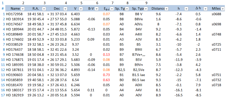

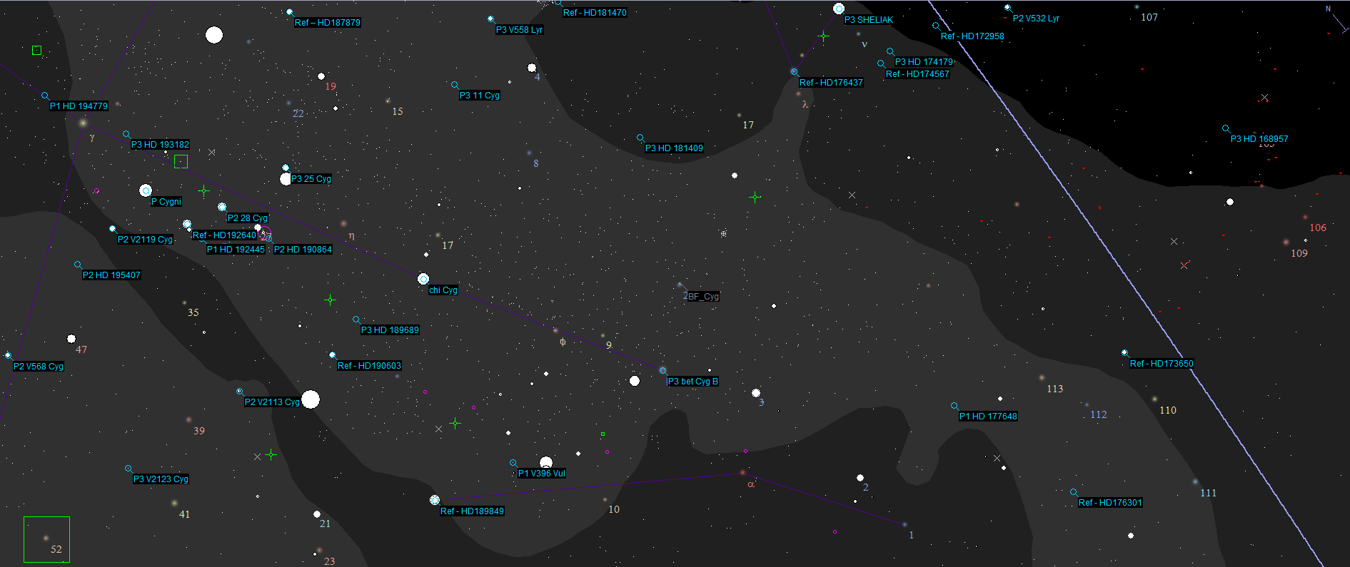

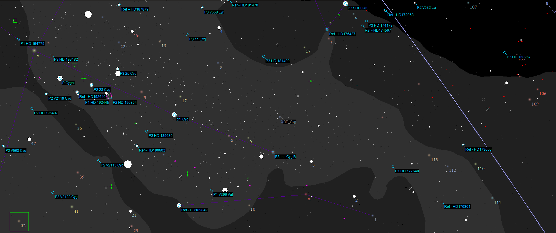

A question was asked among the OHP spectroscopy workshop participants: which reference star for BF Cygni?
>>JJB>>In the reference star finder, I found HD 180317 for the reference star for BF Cygni. Is it OK?
>>FMT>>Correct, you also have HD 189395
>>FMT>>Most importantly, there are several MILES reference stars, using the non de-red'ed catalog
>>FMT>>Here is a list around BF Cygni:
>>OTz>>For BF Cygni reference star, I would take a MILES star which is close by (the star marked 'ref' are the MILES ones; the P1/P2/P3 are Be stars with BeSS priority from last week); hd176437 seems a good & bright one:
>>OTz>>Attached is the "object to observe" list I used to create this charte in PRISM v10...
20160719_BeSS_Ref.zip
List of BeSS Be stars with priority (from 19-july-2016) and MILES reference stars, in PRISM v9 or v10 'objects to observe' format.
(14.37 KiB) Downloaded 559 times

Here is the updated MILES references + Be stars + key targets file I am using with PRISM v10. I updated with today's ARASBeAm priorities for Be stars...
I also included there an excel spreadsheet with the data. It is in three parts:
-my usual or current targets
-the Be stars. See also the ARASBeAm daily robot file: http://arasbeam.free.fr/robot/ObsC2A.txt
-the MILES stars I am using for reference stars
20160728_BeSS_Ref.zip
MILES reference stars, Be stars (with priority) & some key targets, to be used with PRISM software.
It also includes an excel spreadsheet with the data.
(45.09 KiB) Downloaded 577 times

In personal mails, Olivier proposed HD 176437, François proposed HD 189395.
François said me tu use Miles library.
So , I will use HD 176437 which is in the Miles Base, and able in ISIS.
My question is: with the Lhires III at 2400l/mm, for H alpha, is it important to use the Miles Base? I read the document about "dérougissement" from François. It's mainly in the blue part we need to correct the spectrum.
Regards
Jean-Jacques Broussat
Re: Stage Spectro - OHP 2016
S'il y a une Miles dans la liste, comme c'est le cas ici, il est toujours préférable d'utiliser la Miles, dès lors que la différence de hauteur n'est pas trop importante.
Avec les autres étoiles, il y a toujours une incertitude 1. sur le type 2. sur le rougissement.

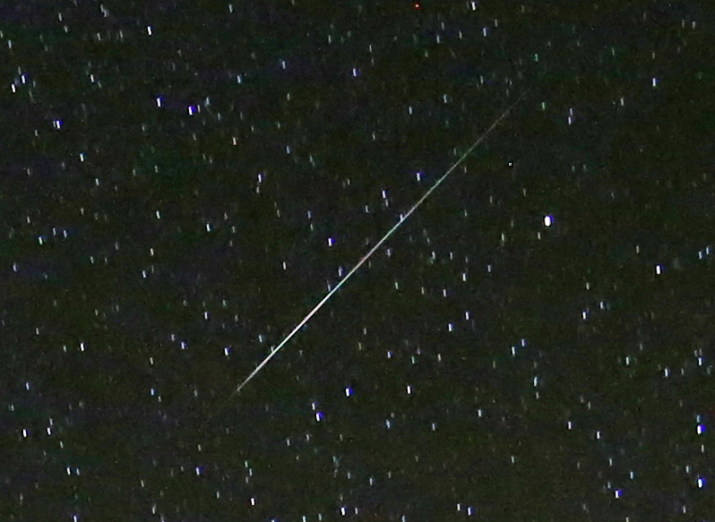

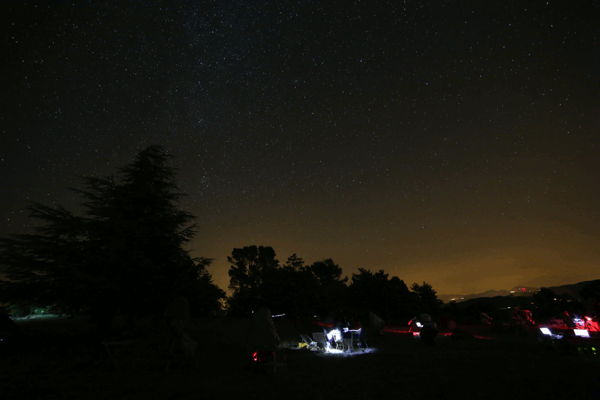

prequel of the spectroscopy workshop at Observatory of Haute Provence yesterday... with already about 30 people there and the field full of telescopes/spectrographs!
Here are couple of images/animation from last night - a clear and beautiful night with a nice milky way; EOS5D Mark III + Samyang 14mm F/5.6 / 45sec ISO3200:
Long meteor
Long meteor
Long meteor (zoom)
Long meteor (zoom)
web_BN3A5782 Meteor-zoom.JPG (209.74 KiB) Viewed 12448 times
Bright meteor going over two frames
web_BN3A5855 Meteor-all.gif (1.78 MiB) Viewed 12448 times
