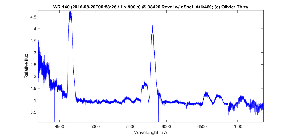

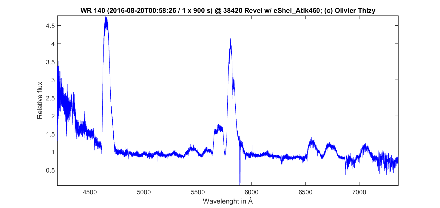

Here is one single 900s exposure I took tonight; sky very cloudy so I couldn't do more and signal/noise is very poor. I use a C11 (0.28m) telescope and echelle (R=10000) spectrograph. Despite low signal/noise I can see the CIV line with some features in the middle: Here is the full spectrum but I should be able to get better profile under better sky conditions: I also include the FITS files (one for the merged spectrum and an archive with indidual echelle orders):
thank you for the information, this seems a ery interesting project but challenging as Cygnus will be low at that time of the year; I also have trees & city light pollution in that direction in the evening and mountains/trees in the morning so I do not think I'll be able to follow up after periastron but I can try.

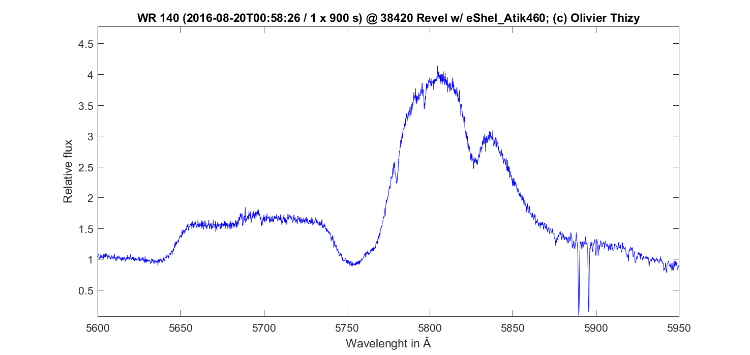

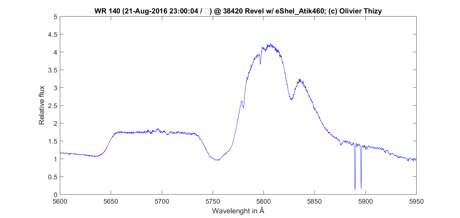

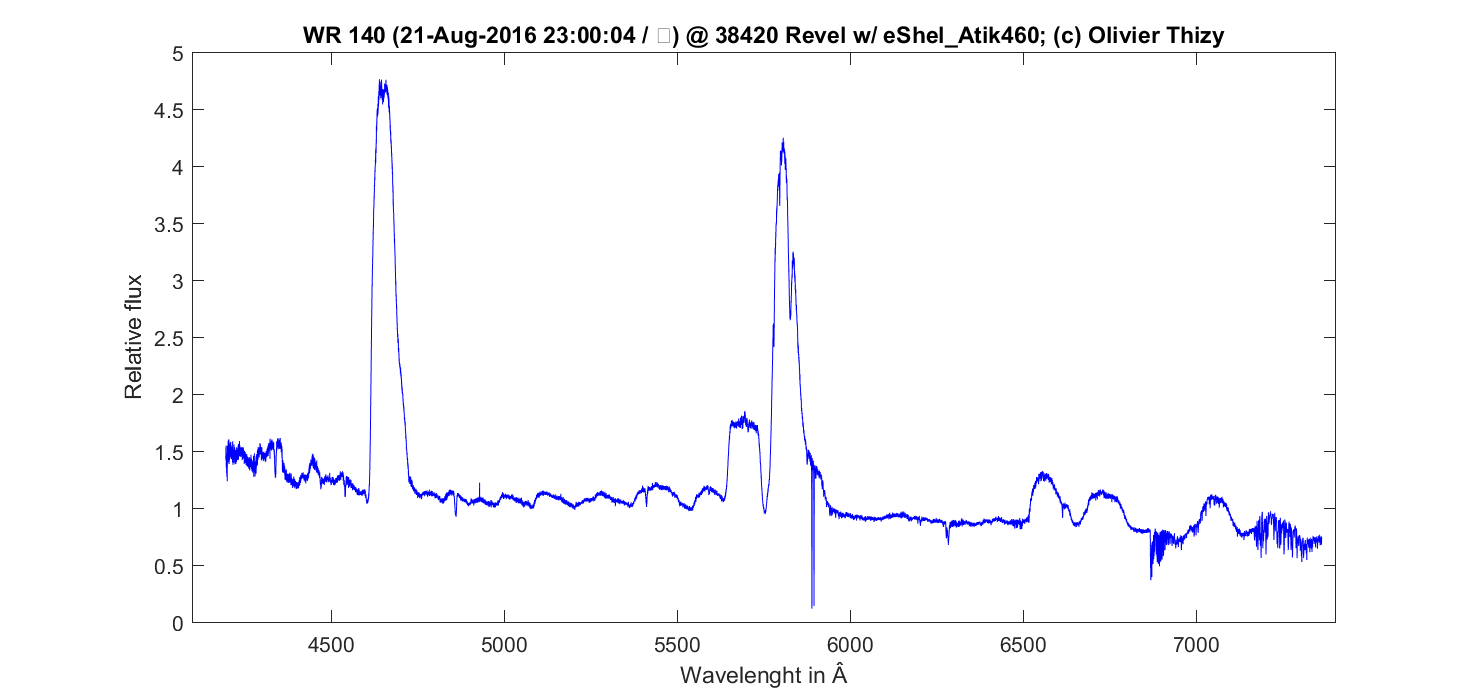

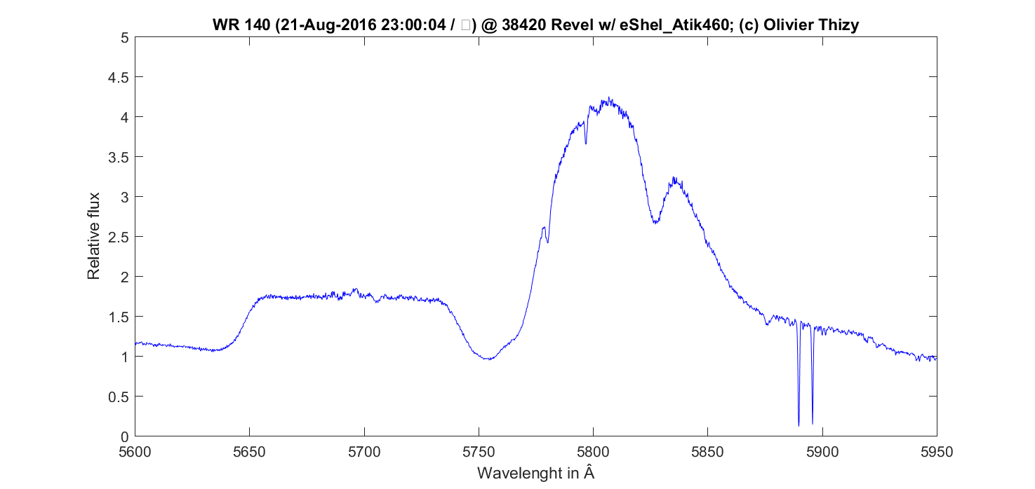

I had better skies tonight and was able to take a 40min (4x10min) exposure on WR140 with the 11 inch telescope and echelle spectrograph. Result is a better signal/noise ratio and a nice overall spectrum:
If there is some interest, here is the spectrum (merged & individual orders):

Thank you Olivier for sharing this, I must confess I gave a lot of try over the past 2 weekends for high resolution of WR140 to analyse the ripples I have between 5750A-5900A with the 414 EXm (+ LHires + 2400/mm + 35um). No luck yet, even with trying the hot star method - somehow the ripples I see dependent of the actual shape of the feature, and quite reproducible and not a flat skew. Hope once I can come up with a method.

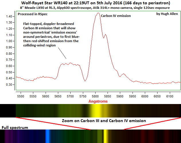

I am interested to know whether the changes in the CIII emission around periastron may be visible at the resolution of the Alpy 600. I looked at your report on your website Robin, on the last periastron in 2009, and the scale of the changes in your excellent animation look to me like they should be resolved. What do you think? I am in any case taking baseline spectra on the assumption that the results will be positive as December approaches
I attach a baseline that I captured back in July, using the Miles database star SAO68678 for calibration
Hugh
Hugh
- WR140_050716-9 calib SAO69678 resp corr SAO69678 zoom composite.png (24.29 KiB) Viewed 11284 times
Hugh Allen
Alpy 600 user
Alpy 600 user

Hi Hugh,
Yes I would say the change on the top of the line as the winds collide would easily be visible at ALPY resolution,though higher resolution would needed to pick up the precise nature of the changes and the moving clumps in the wind. Based on what I saw last time, I recommend keeping the SNR as high as possible, making sure your zero level is good (ie good dark and background subtraction) and rectifying the spectrum using a low order spline fit to the pseudo-continuum using the points that Marchenko used. See fig 5 of this paper
http://adsabs.harvard.edu/abs/2003ApJ...596.1295M

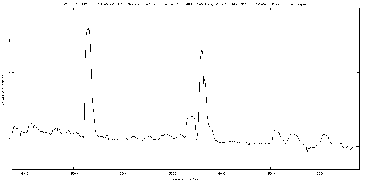

talking about comparison stars, do you think it is a good idea to choose a unique comparison star, in order to minimize possible systematic errors? Well, because I don't have still experience in high-resolution spectroscopy, maybe it is not necessary to be so stricty on this point, But in photometry I believe that it is highly recommended.
Here is a low-resolution spectrum taken with the DADOS and HIP 100518 (B8 V) as comparison star.
Greetings
Fran
