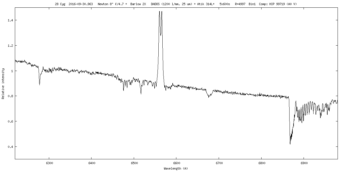

My contribution with a spectrum of 28 Cyg taken last night.
In BESS database now.

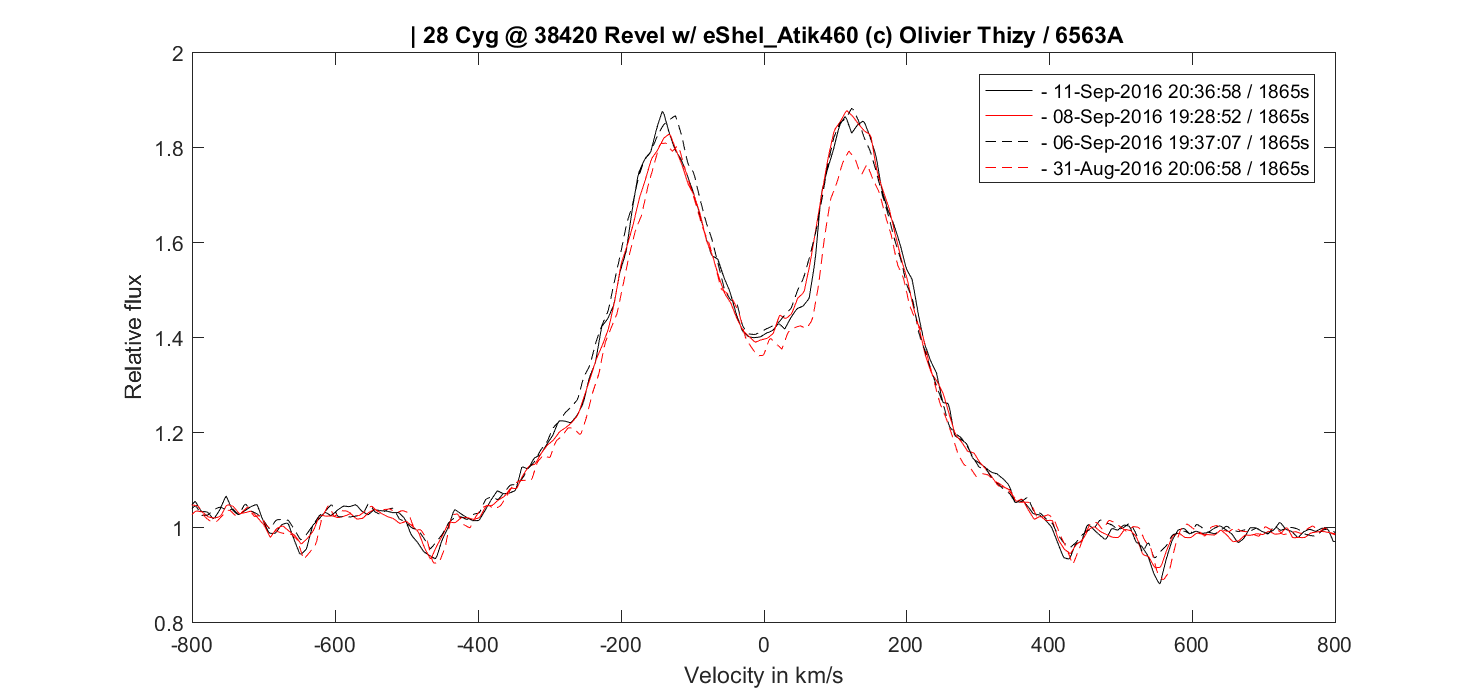

I have taken 28 Cyg for four nights now and while there is some small evolution, it seems fairly stable at the moment:
Olivier

Excellent your spectra! My modest contribution from the last night. I don't know if this resolution is good enough for this campaign, but a dados is not (of course) an eShel. Hope it will be useful.
Greetings
Fran
