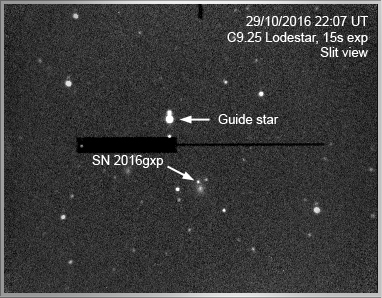

Slit view through the Lodestar camera:

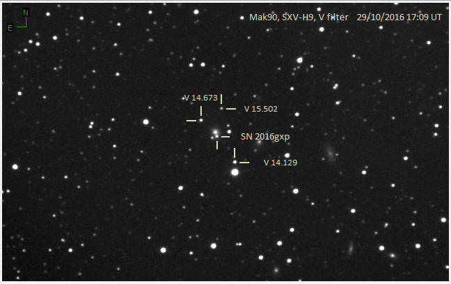

Simultaneous photometry with a small telescope (Mak90, SHV-H9, photometric V filter) returns a V mag ~ 15.0 (not an easy task for me due to host galaxy shaded glow).

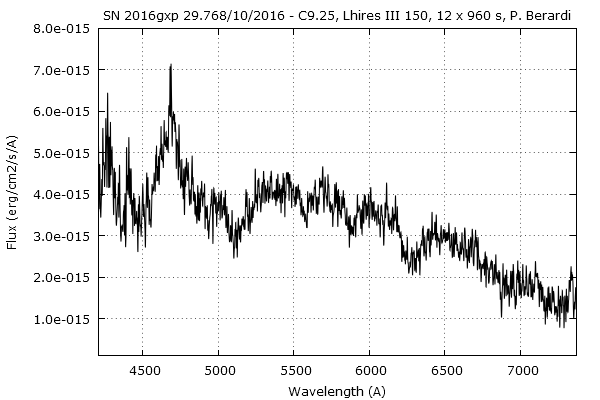

Absolute flux calibrated profile from V mag:

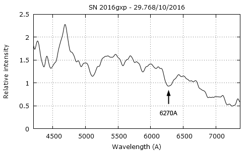

From the filtered profile I measured the main Si II absorption line minimum at ~6270A:
corresponding to about 9500 Km/s expansion speed of the gaseous shell (I considered the galaxy recession speed, 5351 Km/s).

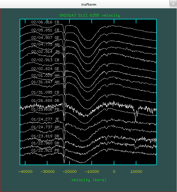

Michel, by comparing our spectra there is a big general shift (your is blueshifted relative to mine). That seems to me a really big change for one day. From some past SN observations, I saw that velocities decrease with time. So, the minimum of Si II absorption should move towards red wavelengths. For example (Malcolm Locke work):
download/file.php?id=1399
But instead, the comparison shown by Robin suggests its opposite. Perhaps a peculiar SN behaviour? We were wrong the WL calibration? What do you think?

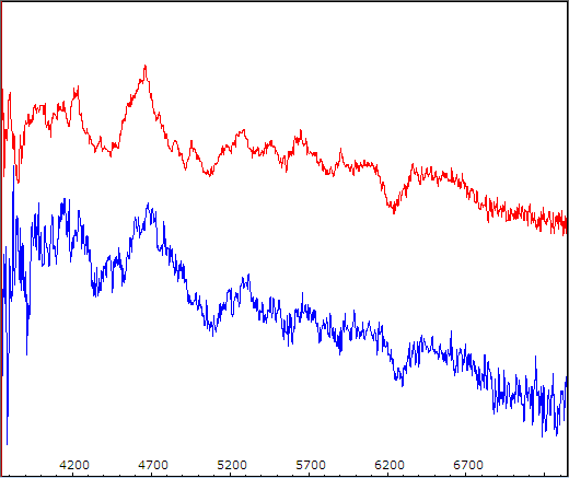

Hi Paolo, Michel,
I agree that there could be a wavelength calibration problem. Here is a comparison of our three spectra(filtered). Mine (Green) and Paolo's (Blue) agree in wavelength but Michel's (Red) only agreed when I applied a 40A red shift.

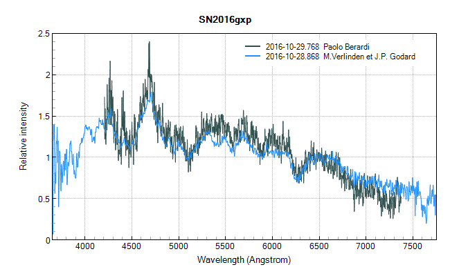

Michel, it seems ok now. This is a profile comparison with mine (I do not have the Robin spectral profile), plotted with the new application PlotSpectra by Tim Lester:
Etienne, I used a Gaussian filter (button Filter in ISIS profile window or Operations, Gaussian filter from VSpec menu) with a parameter about 20. Supernovae spectra have very broadened lines (except narrow lines that in some cases appear, formed in external regions), so you can convert the "extra-resolution" into SNR.

Hi Paolo,
I thank you for the comparaison and Tim for Plotspectra, a nice tool !
Michel
