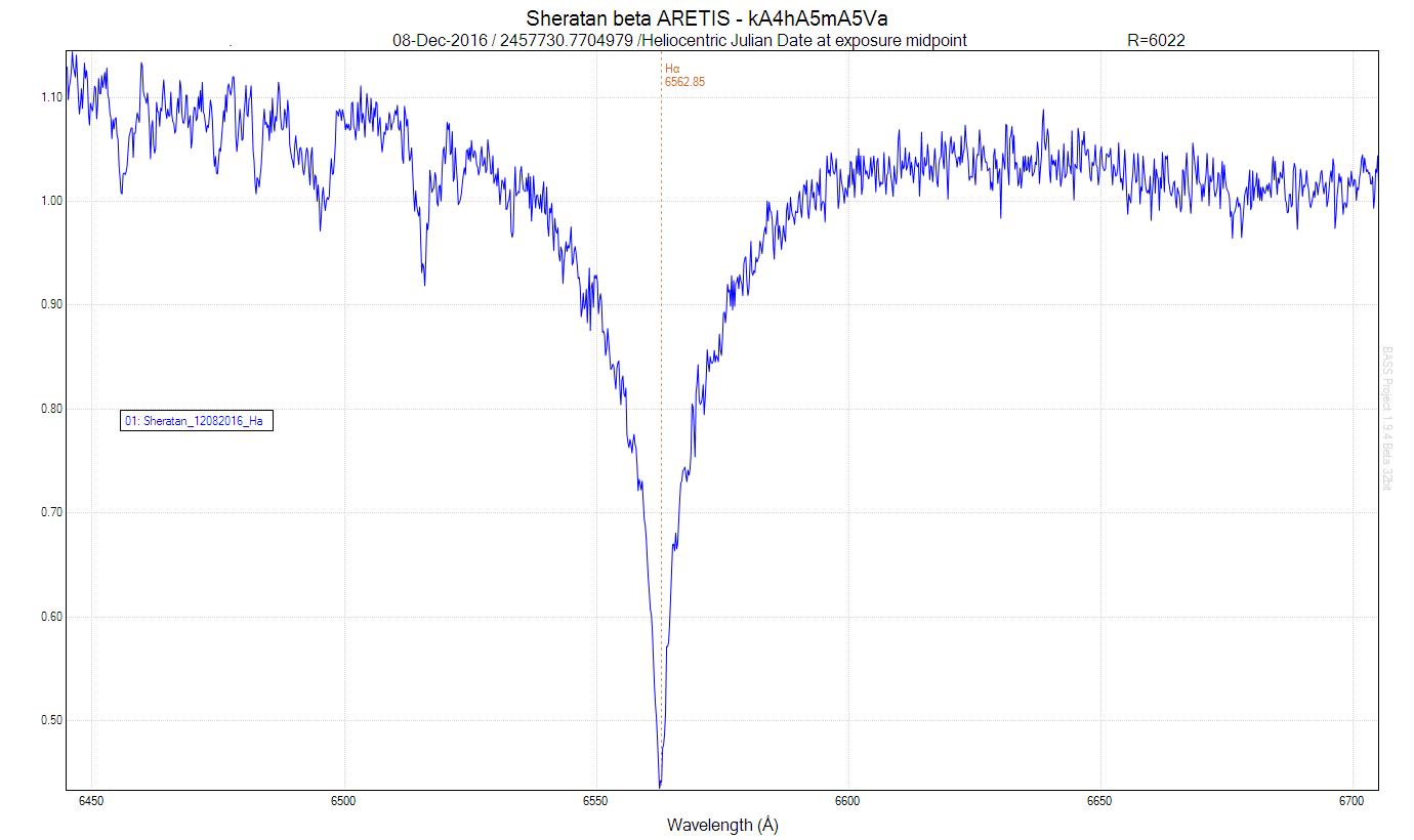

Sheratan (beta ARI)
Posts: 457
Sheratan (beta ARI)
In pursuit of getting another bright A-type star (now that Vega is gone)
for image response (IR) of my Spectroscope with the 1800 l/mm grating, here
are some spectra (all Normalized except the CaK spectra) of Sheratan:
CaK region:
H-gamma region:
H-beta region:
H-alpha region:
Any feedback appreciated.

Re: Sheratan (beta ARI)
Hi James,
Do you have a reliable reference spectrum for bet Ari? It looks like all those metal lines (presumably from the companion K star) will be tough to cancel accurately. From here (Northern England) for bright stars for high resolution work I generally use Castor and then Regulus when Vega and Altair are not around, which have good quality UVES reference spectra.

To: Robin,
Thanks for the reply. I'll try Castor and/or Regulus for IR.
In reply to your question, I used the A5V miles spectrum to divide by my Sheratan spectrum
to get my IR. I avoid tracing the "obvious" absorption/emission spikes as seen in my example here:
Vega centered near CaK line......(images 01, 02, 03, 04; only 04 labeled):
01: Ne-Ar, 02: Line calibrated Vega spectrum, 03: Miles A0V spectrum, 04: image 02 divided by image 03:
I did see some change when I applied my older (Vega, 19Sep16) IR than the Sheratan derived IR.
Not sure if its because of the different A-stars used or my optics getting "dirtier" from the
nearby freeway and/or humidity sticking dust to my exposed optical surfaces!
