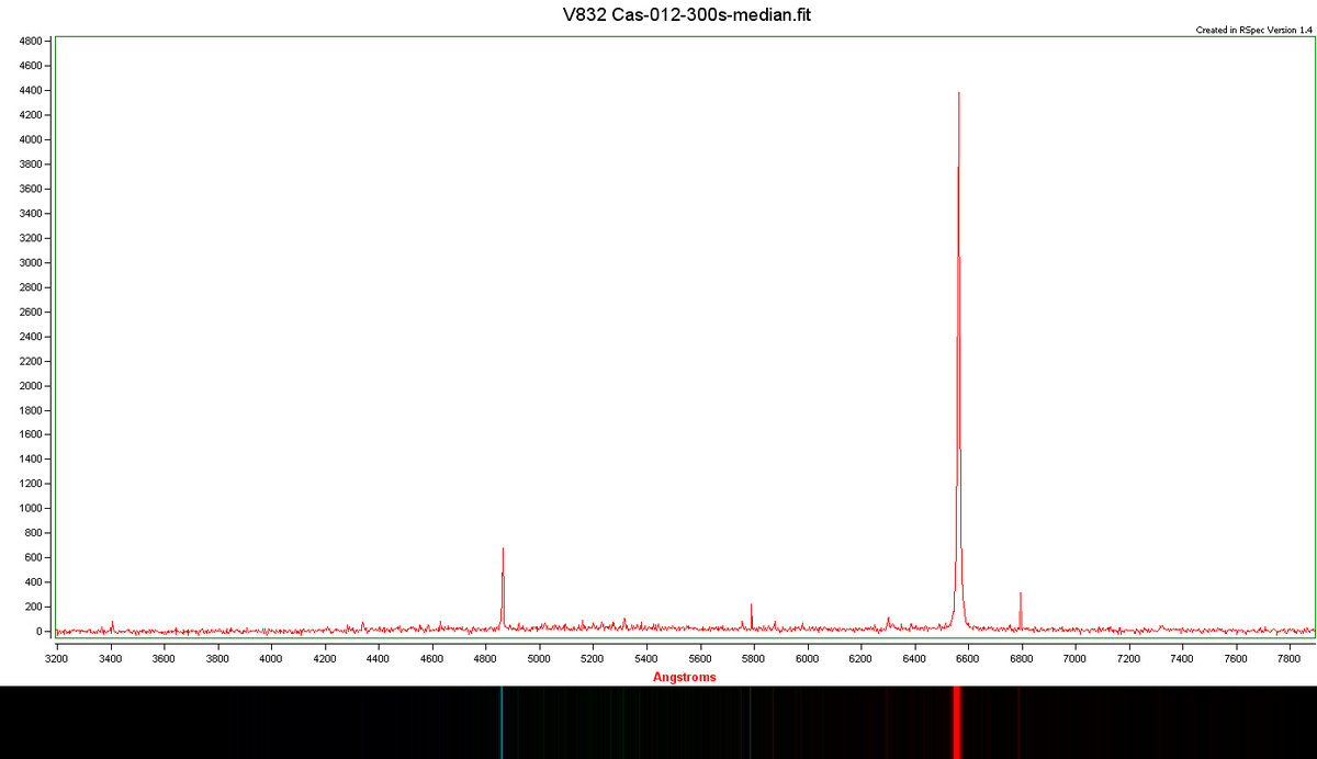

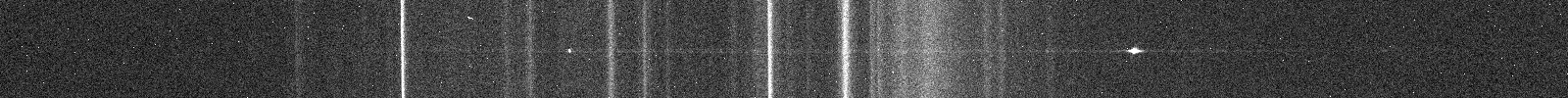

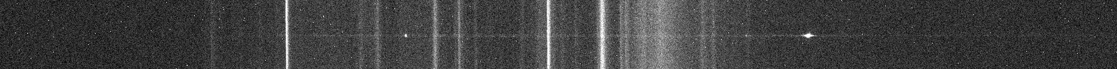

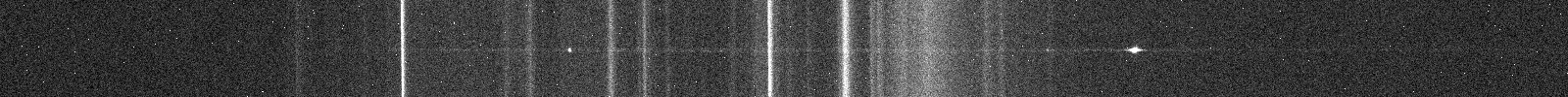

Reading this forum I found the message about the FS Cma stars and thought I make a trial on V832 Cas as it is in a good position :o Was a bit difficult to find it but after a test imge and seeing the strange spectrum I knew I had nailed it :mrgreen:
Here are my results beginning with the spectrum image. 12 subexposures of 300s exposure time each = Total 60 minutes. Taken with LISA 23µ slit on an AstroTech 8" Ritchey-Cretien telescope and a QSI520i CCD camera. Median combined and Dark frame applied.

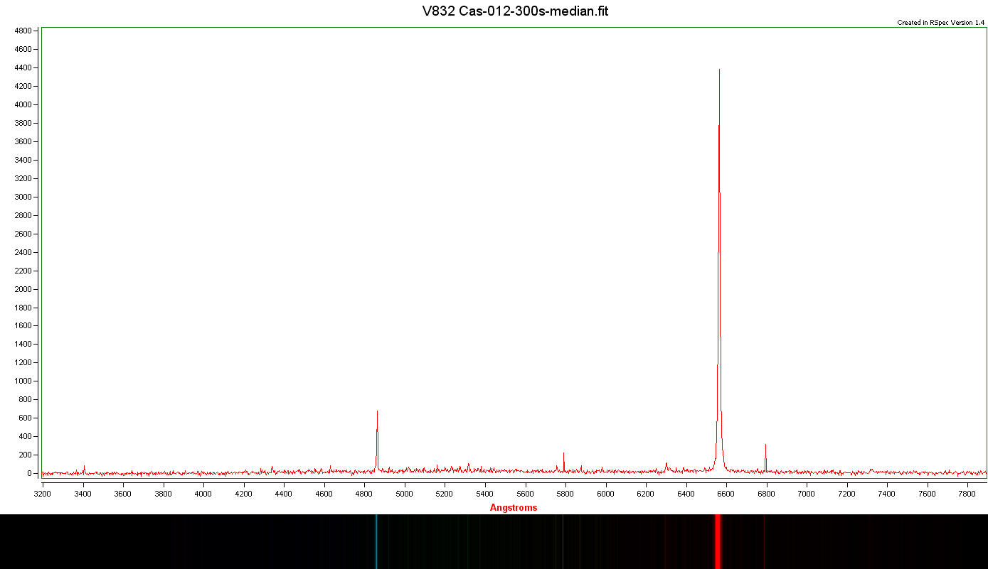

Below the worked out spectrum
and here the *.dat file http://astroforo.net/astro/rspec/v832ca ... median.dat
Thanks for reading, looking and your comments :)

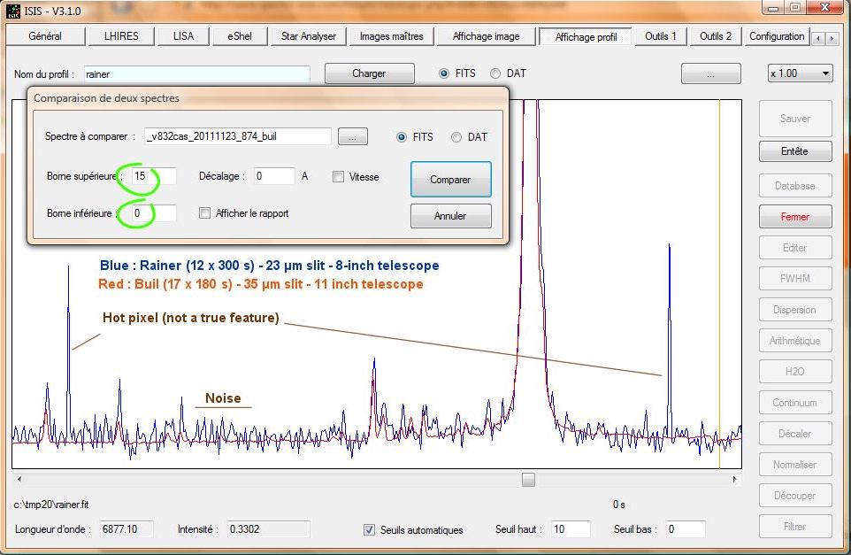

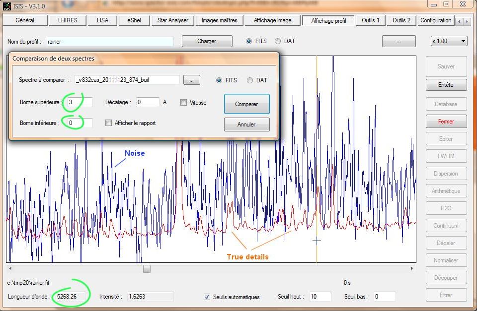

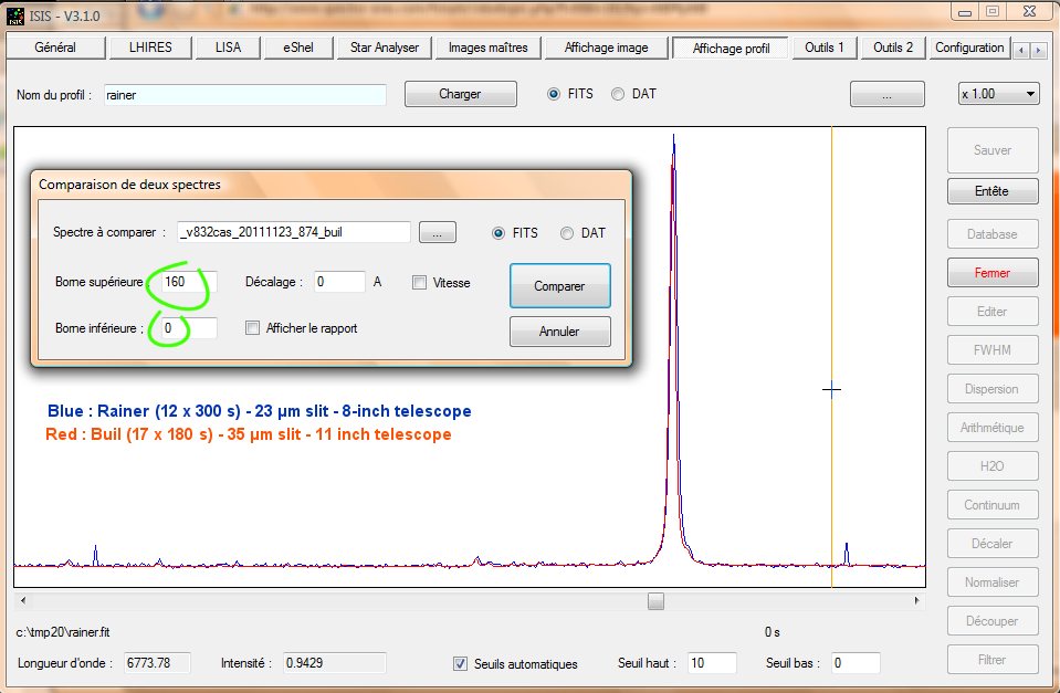

Here, my version of V832 Cas spectrum http://astrosurf.com/aras/surveys/fscma/
(you can download the spectrum file).
Your configuration efficiency :
12 -------- x -------- 300 seconds ----- x ----------- 8 ------- x ----- 8 -------- x ----------- (1) --------- = -------- 230 000
Number -------------------- Elementary ------------------ Mirror surface ----------- Slit relative coefficient
of frames ------------------ exposure time ---------------------------------------------------- (24 microns)
My configuration efficiency :
17 x 180 seconds x 11 x 11 x (2) = 740 000
Number Elementary Mirror surface Slit relative coefficient
of frames exposure time (35 microns)
I collect 3X more photons, OK, but... see attached comparison - your spectrum is more noisy, more than the
flux ratio.
Many hot spots are present and the continuum signal is very faint in your data (dominated by noise).
First : the median stacking is not a very good idea for spectroscopy (because the variable level between elementary exposure induced by seeing and guiding errors)
Second : could you display a one shot raw image (300 sec exposure). for a first look, the telescope focus seem correct.
Third : could you precise the processing sofware used
High contrast (green region)
Medium contrast
Medium contrast
Low contrast visu (near Halpha)

Hi Christian,
Thank you very much for that big amount of time you took in order to do a comparison of your and my spectrum. Very interesting.
I invested yesterday some more time for optimizing my hardware and it looks like I am getting better results now.

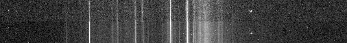

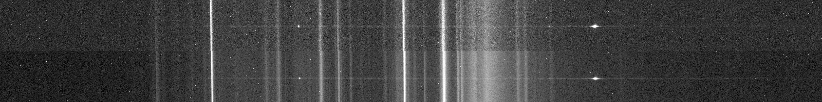

I did read it a few times in order to understand it but there are still some black holes for me :lol: Comparing your C11 to my AT 8" then you have already there a big advantage. Your mirror has 2 times the surface as mine. Is that the number you used (1) and (2) ? C11 = ~616cm² and AT8" = ~314cm²

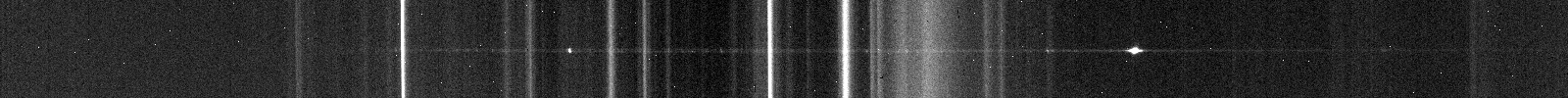

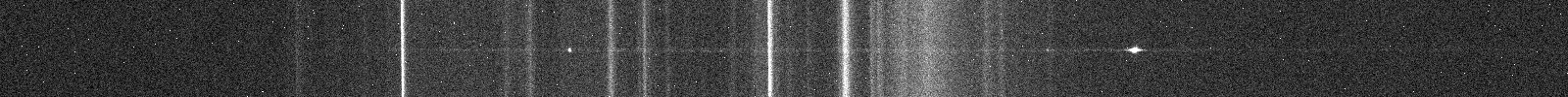

Here are 2 single images of 300s of the series of 12 I took
If median is not a good stacking method for spectra ¿ Which one is it ? I stack my images with MaxImDL.
I use R-Spec for developing my spectra.
Question: ¿ If for getting more signal of faint objects like the one we are talking about I need to change to the 35µ slit, what happens if I use that slit for bright objects like Vega ?
More questions maybe later, still have to digest this one :shock:

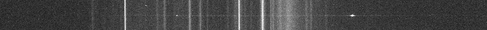

Yesterday I made a new series on V832 Cas with the same setup but instead of 300s I used 600s exposure. That is at the moment the only solution I have for getting a higher SNR. Look at the comparison below
I will later do a comparison of the spectra of 300s and 600s so I can see the difference. In both cases I have 3600s of exposure time.
