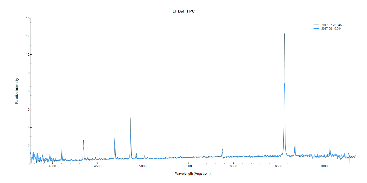

LT Del continues in outburst and the last spectrum I took last night shows a strong intensity increment in the Balmer bands. He I at 5876 A is also stronger but He I (6678A) and He II (4686 A) remain practically unchanged.
Interesting...

ltdel_ 20170722_946_FPC amp.png (22.77 KiB) Viewed 6149 times
Greetings
