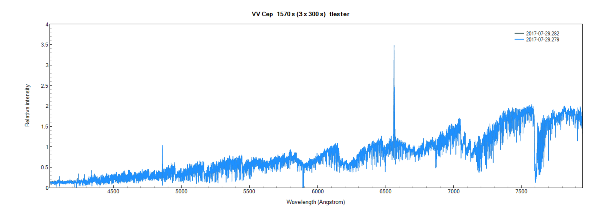

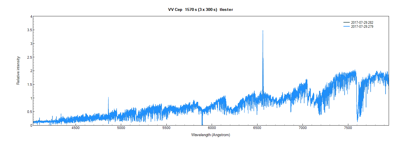

Here is an example for VV Cep that has no smooth regions in the continum for noise evaluation.
First the two spectra derived from exposures 1,3,5 and 2,4,6.

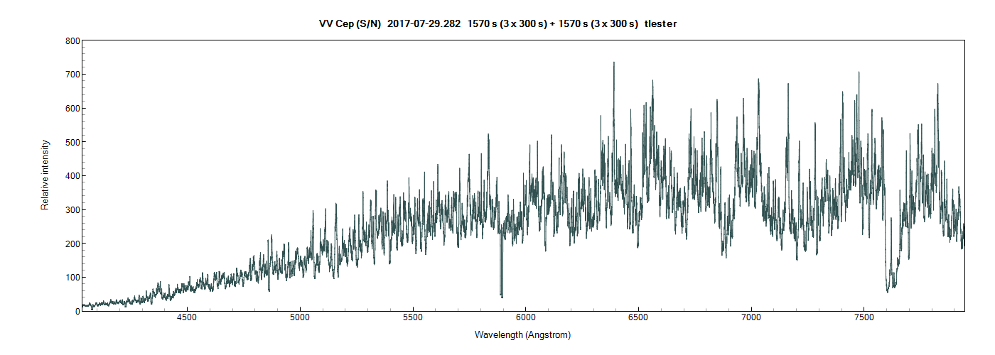

And the generated S/N plot ( ignore the fact that y axis still says relative intensity)
The noise estimate used 100 points along the wavelength axis. Note that the noise estimate is very sensitive to any wavelength shifts of strong lines between the two sets of data.
The "noisy" nature of this S/N plot is due in part to the fact that VV Cep has a great many lines at this resolution.
Although it will require care to use and interpret I think this calculation will be useful.

Thanks Tim ! I will have a play with that. How did you calculate the SNR from the two spectra ?
Tim Lester
Posts: 168
Location: Arnprior Ontario
Re: Version 1-5-4 of PlotSpectra available
Post by Tim Lester »
Robin - After normalizing one spectrum with the other I simply calculate the sdev of a set number of points along the wavelength axis, centred on the wavelength of interest. These values are divided by 2 to represent the noise that would be present if all the exposures had been used and were normalized by a noise free spectrum. The s/n plot uses the inverse of the resulting values, calculated for each point on the wavelength axis.
