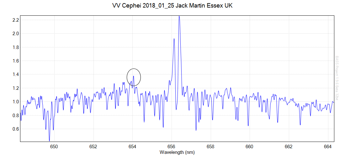

Gentlemen,
YES observation confirmed.
Can someone explain the astrophysics of what's going on here ?
Regards,
Jack
Essex UK
Posts: 458
Re: VV Cep emission line near 6540 Å ?
I have this feature on my last LhiresIII H-Alpha spectrum taken on 29Dec17:
I labeled this emission near 6540A, via BaSS Project V1.98, with nearest element "praseodymium." I doubt is the actual emission line in question; atomic number
59 (cerium ← praseodymium → neodymium)!
There was an article discussing heavy metal abundances (including this element) in the atmosphere of Aldebaran seen here:
http://adsbit.harvard.edu//full/1990SvA ... 0.000.html

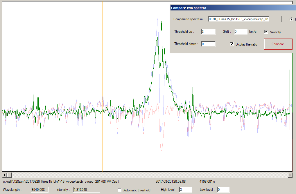

I've made an experiment on 2017.08.20 with the 15 micron slit, including a mu. Cep - that also have a peak at there:
Heliocentrically uncorrected all for now, I've shifted mu. Cep using ISIS->Misc->Radial velocity tool to align the actual VV Cep here.
The ratio difference is below noise I think (above 1 hour exposure for VV Cep that time, mu. Cep is only 3 minute but also noiseless, say SNR > 100), or it may also come from the fact that B component was not subtracted for now, as I neglected that small elevation when B was still up.
The narrow peaks on the ratio unfortunately all correlate with tellurics places (and their tiny shift when aligning both stars), so no real difference.
Of course, any real change is still possible since 2017 aug, I just wanted to point out here that feature is also existing on mu Cep.
To show and quantitize weak differences, I recommend subtracting a properly aligned mu. Cep (attaching here my example: R~26000 - you need to shift it and decrease resolution for your spectrum), or someone need to get an alpha Ori.
mucep_sh.zip
(13.49 KiB) Downloaded 785 times
Subtracting mu cep also reveals noise level (including continuum reproduceability errors), making it out easy e.g. whether it falls under such an error level (e.g. resolution change) or this was a real change.
All the shift, B comp. elevation (should affect small, or none today - see BAV Umag curve whether needed), subtraction are easy to do in ISIS for anyone, who feels there was such a change to present it.
