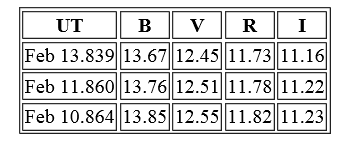

We are intensively following StHa 32 both photometrically and spectroscopically since 2005. Its photometric behavior in B band begun to deviate from the P=626 days orbital modulation at the beginning of November 2017. The initial rise has been very slow, gaining pace with passing time. The following are some of our most recent measurements:
The brightness gain in B band is already 0.85 mag compare to quiescence value at the same orbital phase, with all colors turning bluer.

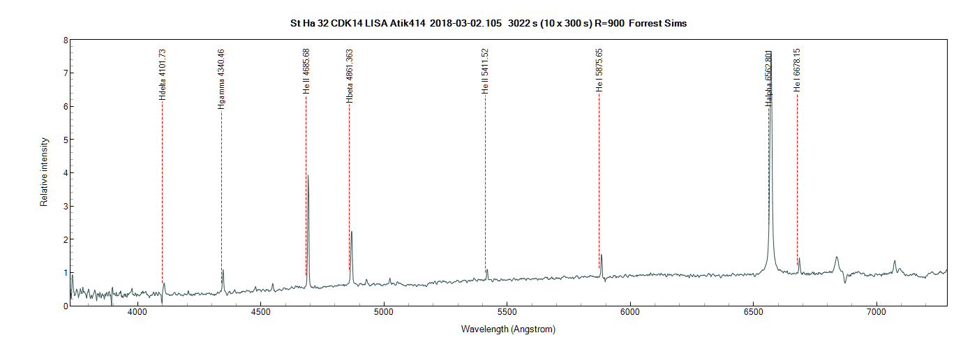

Greetings!
I had a go at StHa 32 tonight. The full Moon was not ideal but the target and reference stars were not at all close to the Moon. I took (8) 300sec guided exposures of StHa 32. I took (7) 30 sec exposures of the Miles star HD041692 for determination of the instrument and atmospheric response curve correction. All of the emission lines in the spectrum appear red shifted.
Comments appreciated:)
Woody
Re: Symbiotic Star StHa 32
That's great Woody! A new symbiotic in the database
You have also intense Raman OVI bands, so the ionization level remains very high >> 100 000 K
P Cygni profiles on the lower members of Balmer lines
It looks to be an outburst of an accretion disk around the white dwarf
Of course monitoring of the outburst is welcome

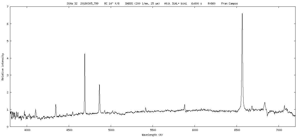

my contribution, not as good as Forrest's one, but still valuable, I hope...
Greetings,
Fran
