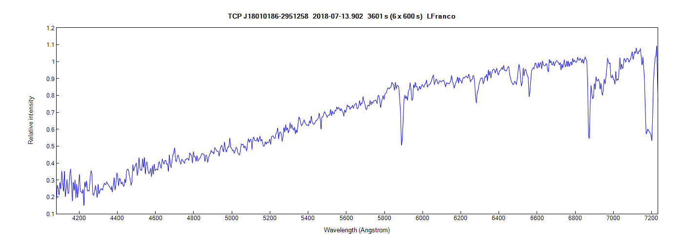

Lorenzo Franco also got a spectrum of the event

I wonder if lines are conserved through the deviation of the light by the lens object. I suppose it is not apochromacticAssuming it is a hot star with very high extinction, what objects have a narrow H alpha in absorption and no other obvious stellar features ?

Hi Francois,
I think the lensing effect itself is achromatic (all wavelengths deflected equally) but there are some reports of chromaticity in lensing, perhaps caused by different extinction in different paths or because emission at different wavelengths come from different locations in lensed extended sources. I think in general though the spectrum should survive the lensing. It did here for example.
http://www.threehillsobservatory.co.uk/ ... tra_30.htm
The Atel #11883 proposing that the deviations from the binary/extended source lensing model are due to pulsations of a red giant is strange. Pulsations might be a good explanation but surely the spectrum rules out this being a red giant (no molecular lines) ?

Thank you for the explanations and the link, Robin
