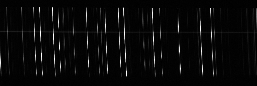

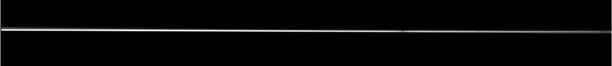

This is a single exposure 60 sec exposure of tet1 Sgr (a spectroscopic binary).
Processing in ISIS gives ~R=5000
This is a filly lamp calibration exposure.

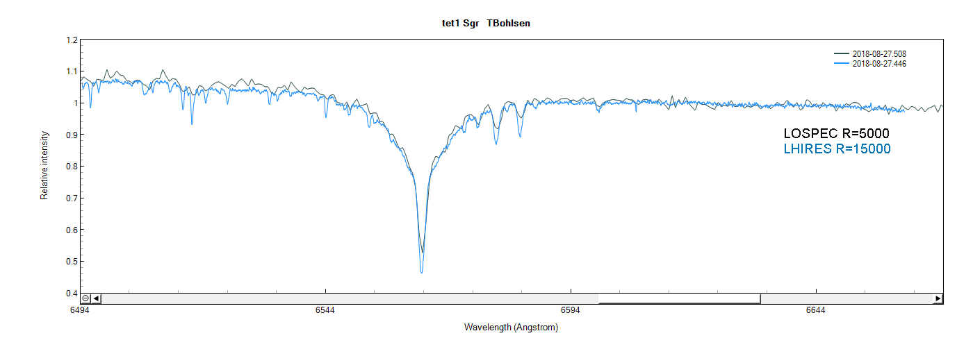

I had taken a spectra of the same star with my LHIRES earlier in the night and have compared the 2 images below. The LOSPEC image is 300s. The LHIRES is 1200s

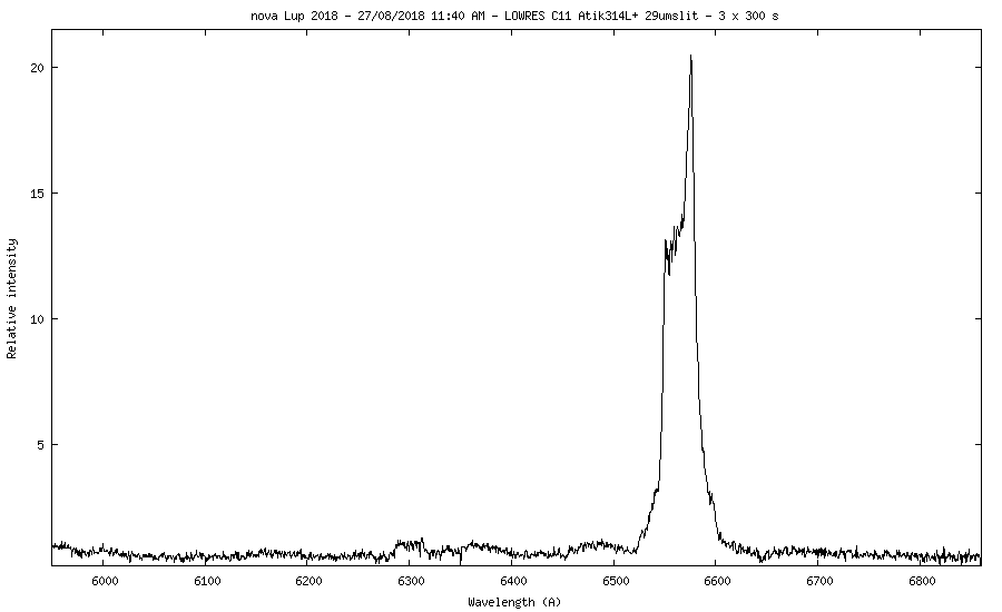

Nova Lup 2018 at about mag V=12 900s exposure.

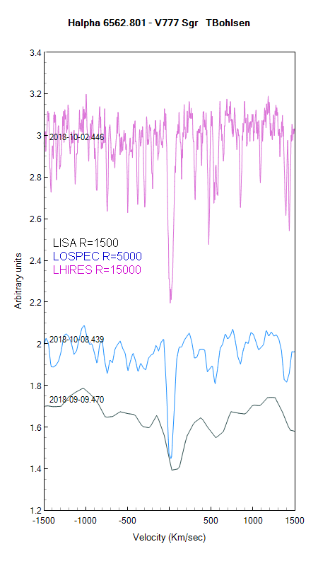

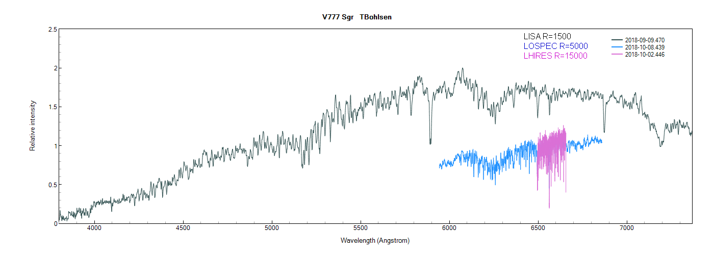

I have made a comparison between my 3 spectrographs that I found quite interesting. I have taken spectra of V777 Sgr (a very slow eclipsing binary) through all of them. The difference in resolution is very obvious as is the spectral range. They are taken with different cameras but all display the usable extent of each without moving the grating and re-exposing.
V777Sgr comparison_2.png (61.18 KiB) Viewed 10468 times
Terry
