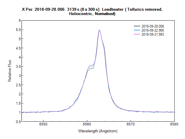

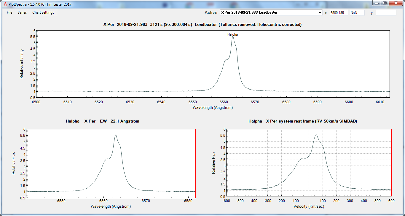

This is what the H alpha line looked like last night 2018-09-21 (LHIRES 2400, R~15000)
Re: Call for monitoring of Be/X-ray binary X Per
Evolution of H alpha over 6 days

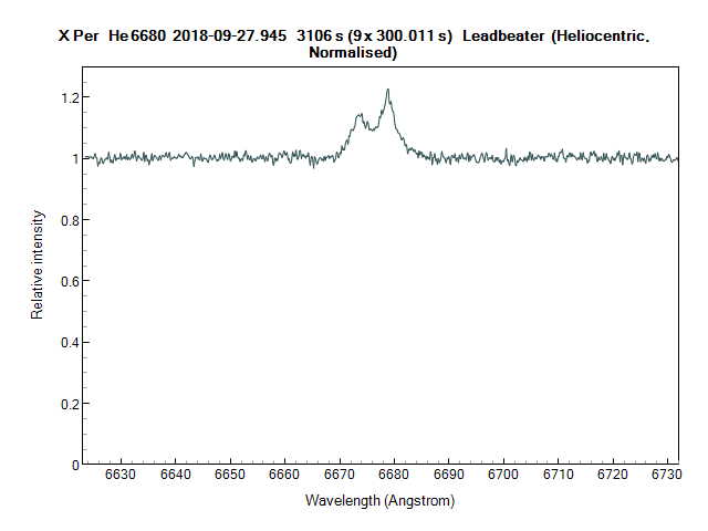

He I 6680 line (approximately 15x weaker)

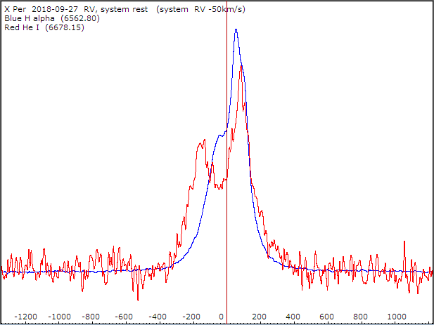

RV of both lines in system reference frame

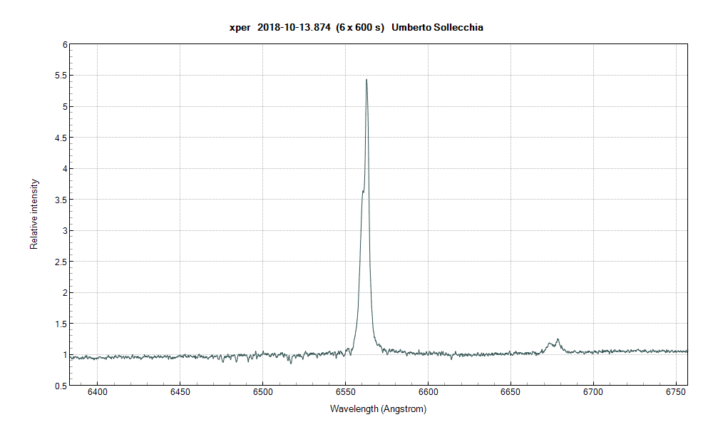

Post by umberto sollecchia »
Bonsoir à tous, voici ma contribution. Umberto
xper_20181013_874_Umberto Sollecchia.png (29.32 KiB) Viewed 43166 times
