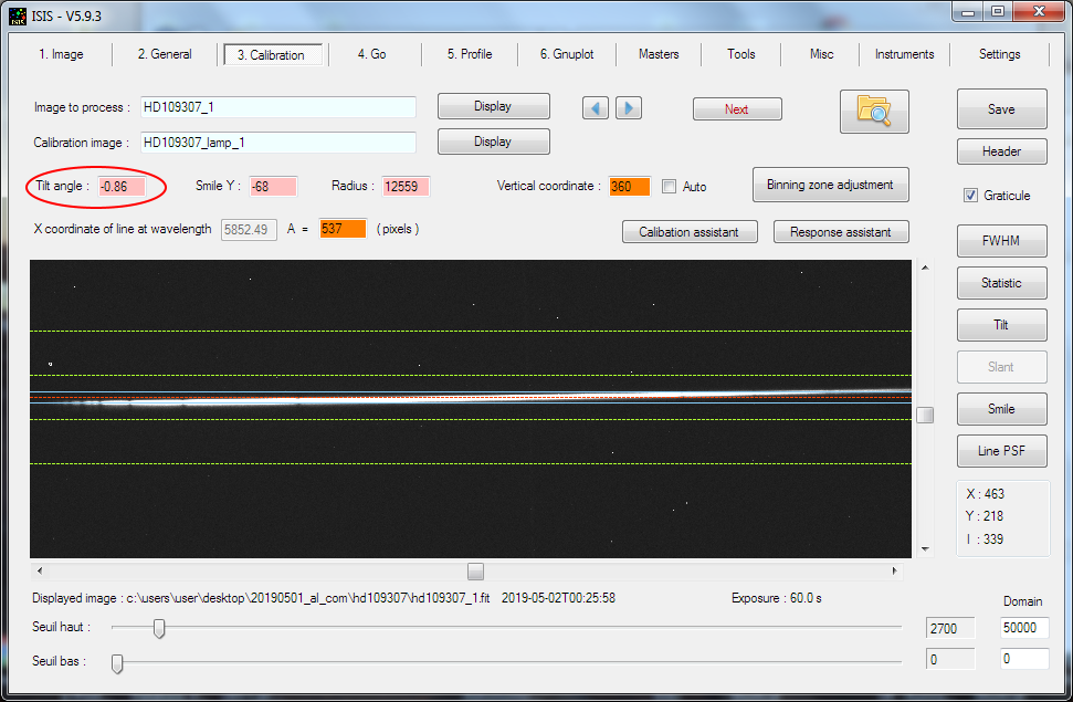

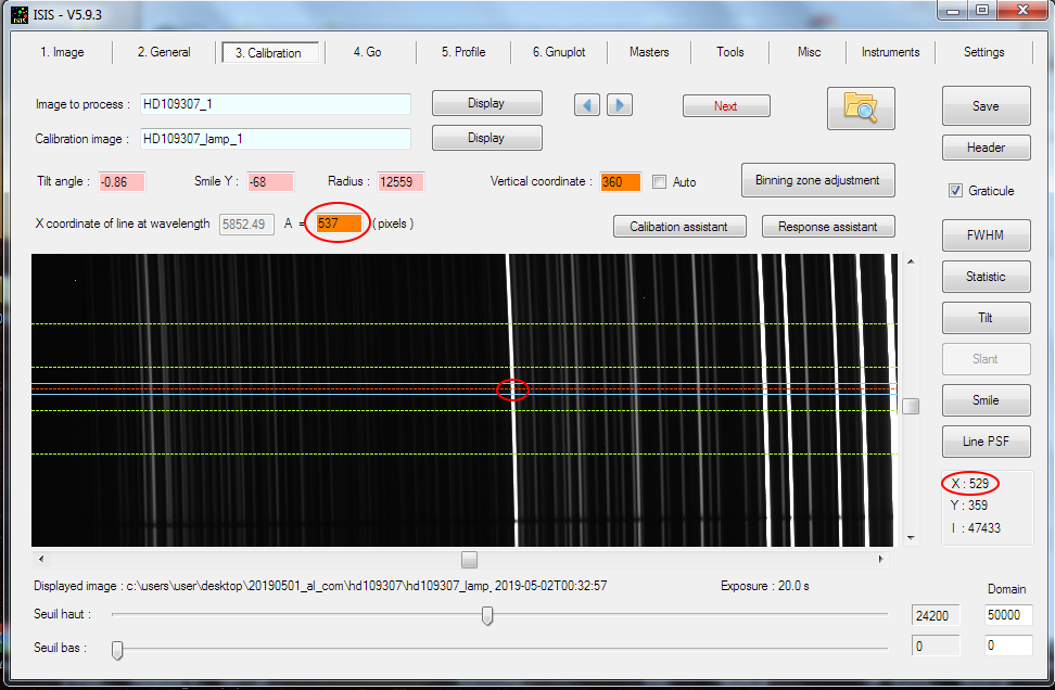

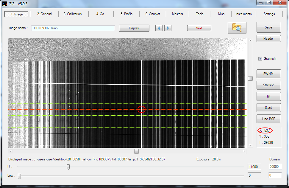

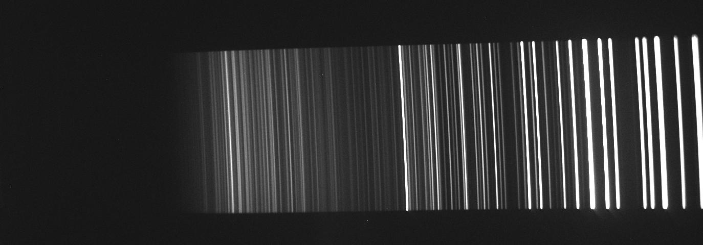

I have just had this problem myself. The ALPY automatic calibration would not run. When I looked at the geometric corrected lamp image, the position of the reference line had moved 8 pixels. The camera had rotated slightly so the star image had a 0.8 deg tilt. This, combined with the smile correction, was enough to stop the automatic wavelength calibration running. It ran perfectly when I entered the reference line position from the corrected image.
screen shots attached
Had to use reference line position from  the corrected image for the calibration to run correctly

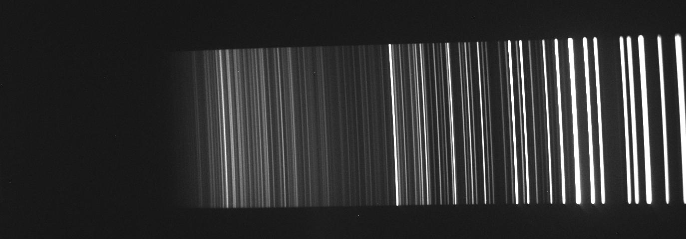

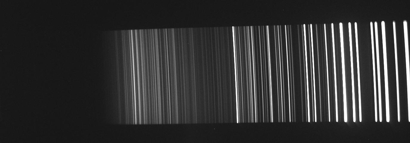

The geometric corrected lamp image

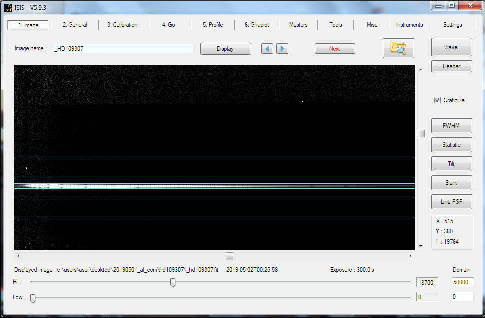

The original star image
