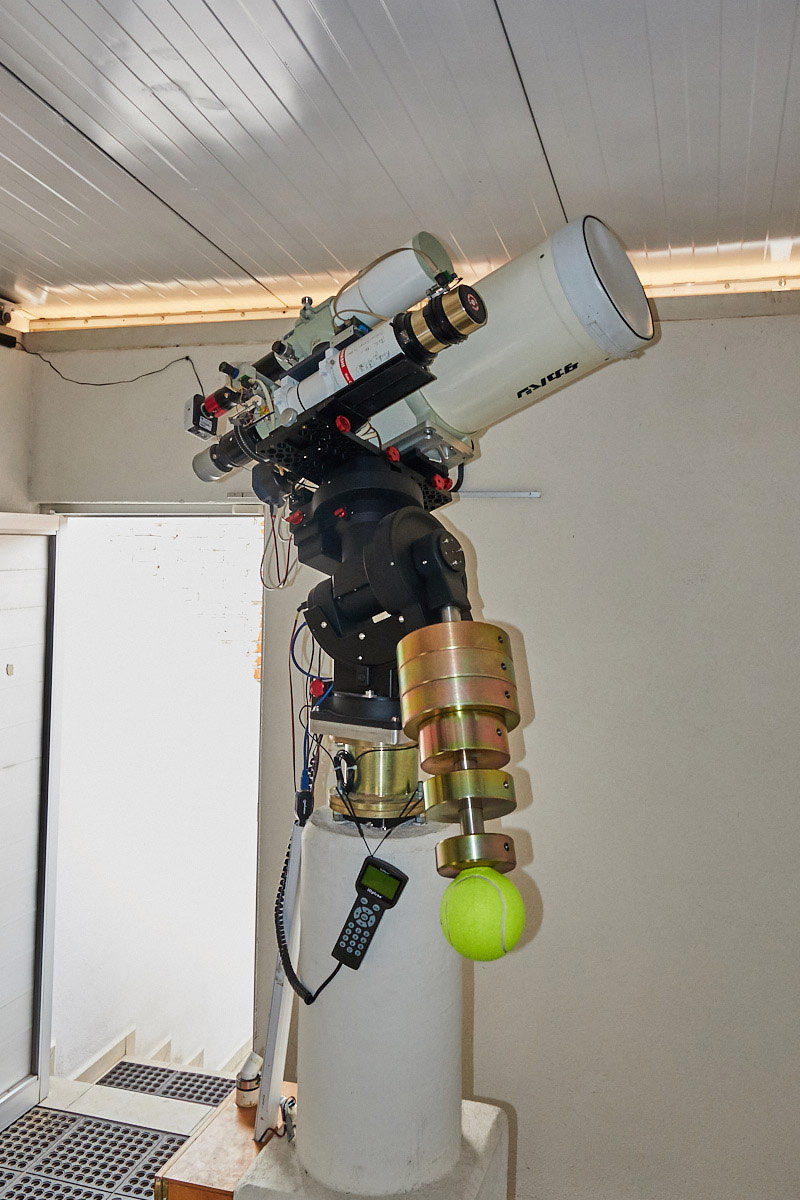

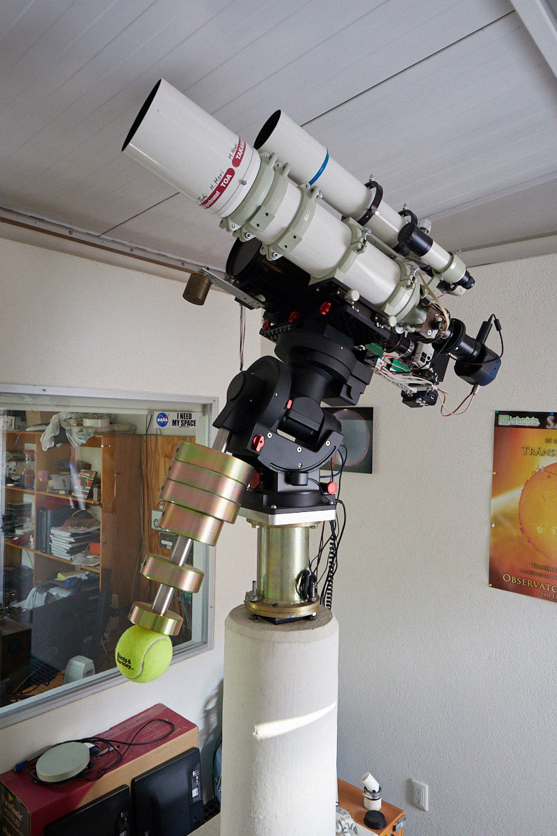

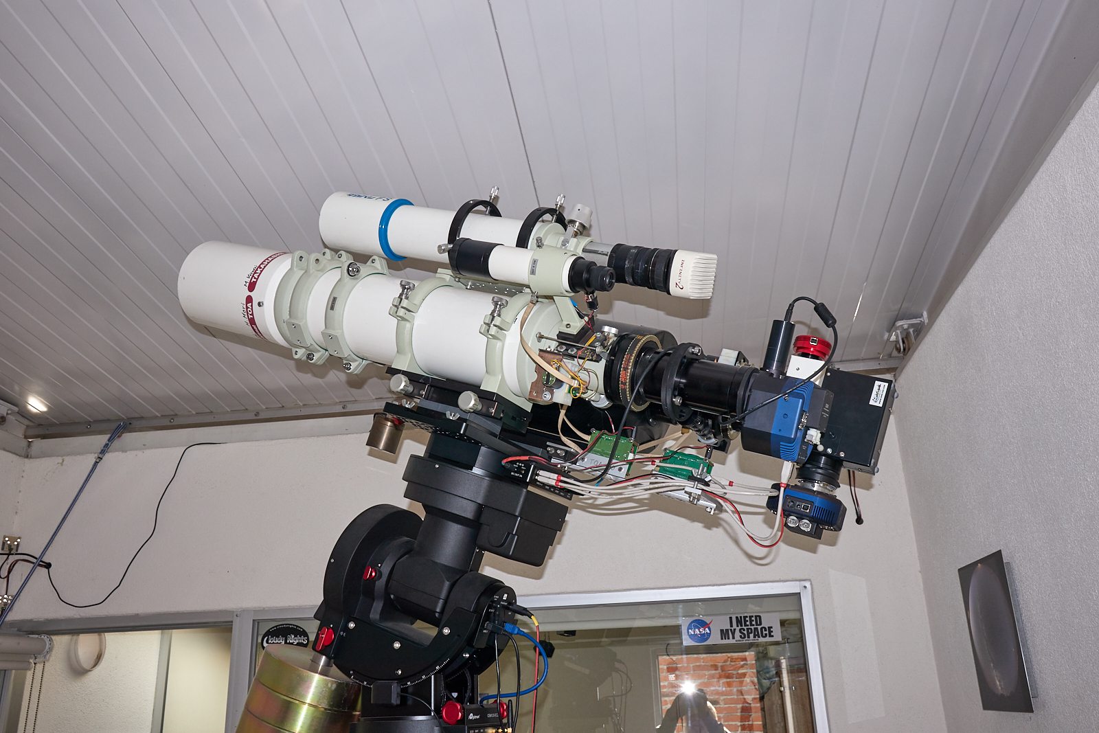

PD on the attached image you can see LISA in the back scope as well as how my equipment looks now

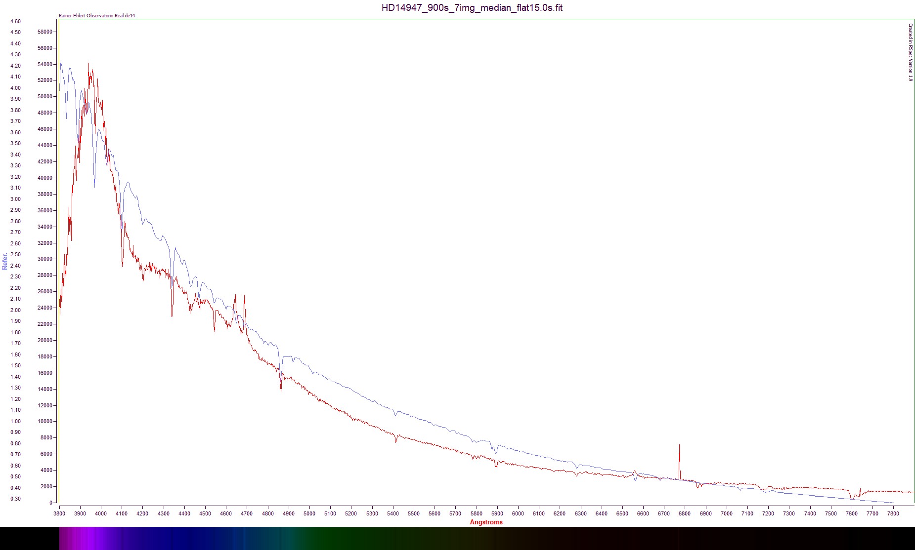

Well I am getting better results and I know why I had a strange profile after applying a flat image.
Here is an example of HD 14947 of the test which is much better then before.
Exposure time was 900s for each image and I made 7 of it and processed in MaxIM DL.
Will keep testing the developping ...
Would somebody please explain me why I have that steep fall off in the Blue side or UV area ? Is this due to the fact of the protectyion window of the camera ? I have no filter at all except the window which covers the CCD chamber.
Rainer

Hi Rainer,
Rainer Ehlert wrote:Hi,
Is this the spectrum after applying the instrument response? If so I suspect you have not accurately fitted the instrument response at the blue end. This can be difficult because the signal is low in this area because of the camera and grating sensitivity and the low output from the flat lamp. See this recent thread for example.
http://www.spectro-aras.com/forum/viewt ... f=8&t=2201
(Google translates from French quite well)

Re: Best practice for developing ...
Post by Rainer Ehlert »
Robin Leadbeater wrote:Hi Rainer,
Hi Robin,
Happy New Year 2019.
Thanks for the answer in regard to the blue part of the spectrum. I read the topic in question but still do not know what to do. There is no conclusion so far I understoos or perhaps I am just dense.
Can I use daylight for making FLATS ? or must it be exactly those 4700 K color temperature ?
regards Rainer
