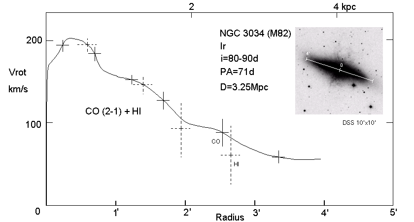

Re: M82 : calcul de la vitesse des vents en rotation
Etienne,
I like the way your H alpha line exactly reproduces the whole rotation rate curve in just one measurement (Dark matter makes the rotation rate constant except close to the centre)
https://www.researchgate.net/figure/Rot ... _232238180

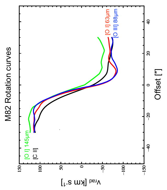

Thanks you, friends, your answers and reflexions is always productive for goods ideas and reflexions.
Exellent Robin your graph of the dark matter. You have explication on the graph ? (my english is not very good)

Hi Etienne
etienne bertrand wrote: Exellent Robin your graph of the dark matter. You have explication on the graph ? (my english is not very good)
Not my measurement. Just one I found on the internet. :-) I rotated the graph to match your spectrum image. The vertical scale is in arcsec from the centre of the galaxy and the horizontal scale is RV in km/s.
Actually I dont think this graph goes far enough away from the centre to show clearly the difference between with and without dark matter. (The RV should reduce further out without dark matter but should stay constant if dark matter is present)

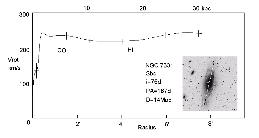

Actually I see from this source
http://www.ioa.s.u-tokyo.ac.jp/~sofue/rotation/fig2.htm
that the full curve for M82 (NGC3034) does not appear to show the dark matter effect for some reason
NGC7331 for example does show it though
Thank Robin, I discover this web source concerning galaxy rotation. Here an ancient measure on NGC7331 (LISA spectrograph at the 60 cm of Pic du Midi observatory, 2011) :

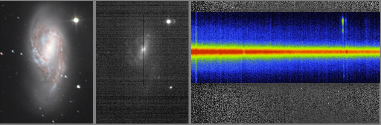

Post by JP Nougayrede »
Similarly, we might have seen the rotation of M66 with an Alpy on the T60 (thread : http://www.spectro-aras.com/forum/viewt ... f=6&t=1682)
