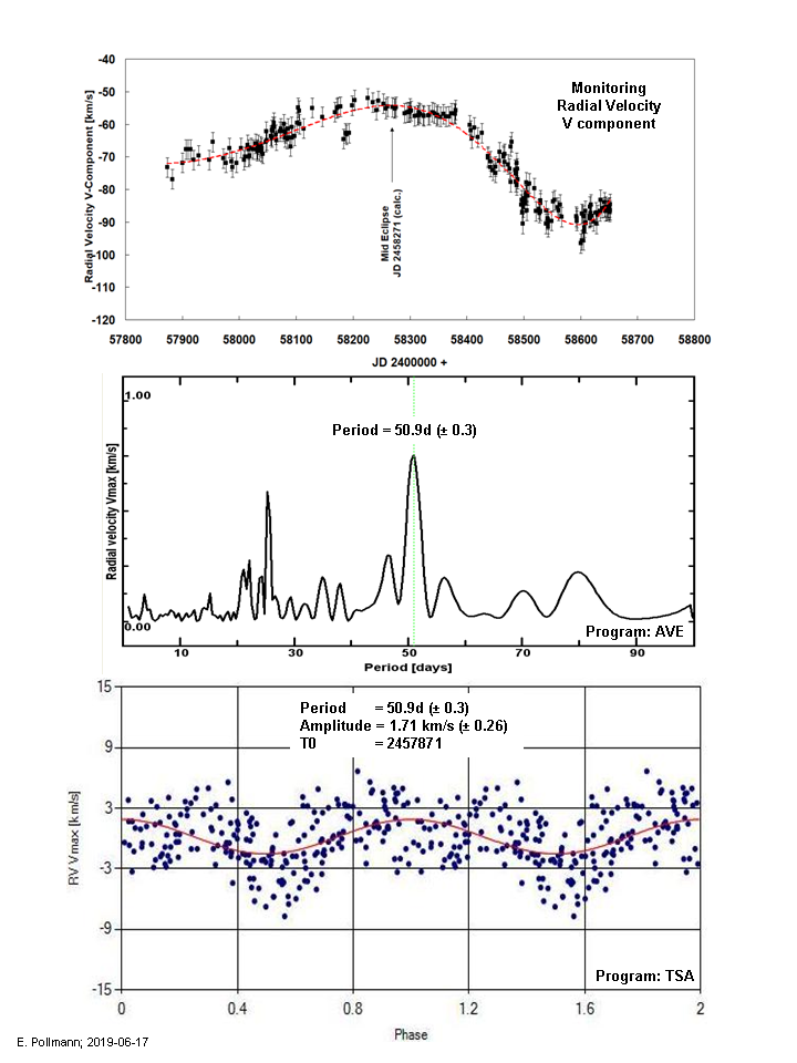

the gravitational force of the M supergiant exerts a forced angular momentum on the B star disk that triggers the 45-day precession period of the disk rotational axis. But a precessing disk rotation axis with a period of 45 days, would inevitably have to result in a simultaneous variation of radial velocity of the V(max) flux. Precise radial velocity (RV) measurements of the Hα V component, based on LHIRES III spectra of the ARAS observers (Schwarz, Kalbermatten, Bryssinck, Foster, Bertrand, Sawicki, Martin, Stiewing, Pollmann) seem to confirm the periodic precession movement of the B star disk rotational axis.
The first signs of such a movement have been discovered during the period analysis of the flux and EW time behavior of the Hα V and R components. Because of the small average RV amplitude of approx. (+/-) 1.7 km/s, this is not as simple as it seems. In spite of the high accuracy in wavelength calibration (order 10-3 to 10-4 Angströms) by using the new program SpectroCalc (developed by M. Schwarz, Austria), the error in RV is in the range of (+/-) 3 km/s in one observation night. All spectra have been calibrated with metal lines of the M star around Hα:
FeI 6546.245
TiI 6556.066
CaI 6572.781
FeI 6593.878
This method of calibration led to a radial velocity relative to the M star and without any influence of the system velocity. But the period of approx. 51 days still is unclear at this time, compared to 45 days found in analysis of the precession period of the disk rotational axis.
The upper plot shows the monitoring of RV measurements from 220 spectra from January 2018 to June 2019. The period analysis of the detrended RV data (in the upper plot) shows the plot in the middle, and finally the phase diagram of the found period of 50.9 days is shown in the plot bottom.
To better understand the RV of the V(max) flux, I recommend looking at the orbital animation, which I can send upon request.

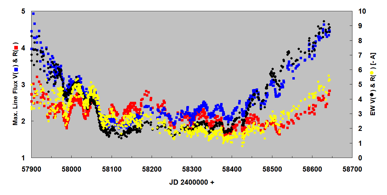

the current state of the ARAS campaign observation results seems to explain the periodic time behavior of the equivalent width and the flux of the Halpha emission components V & R.

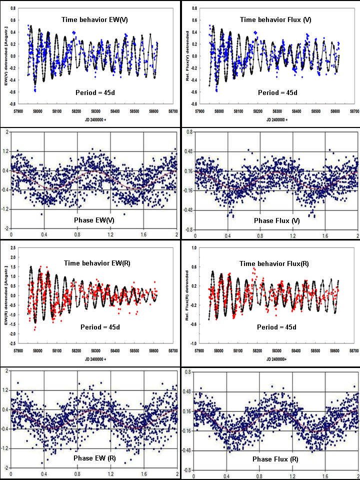

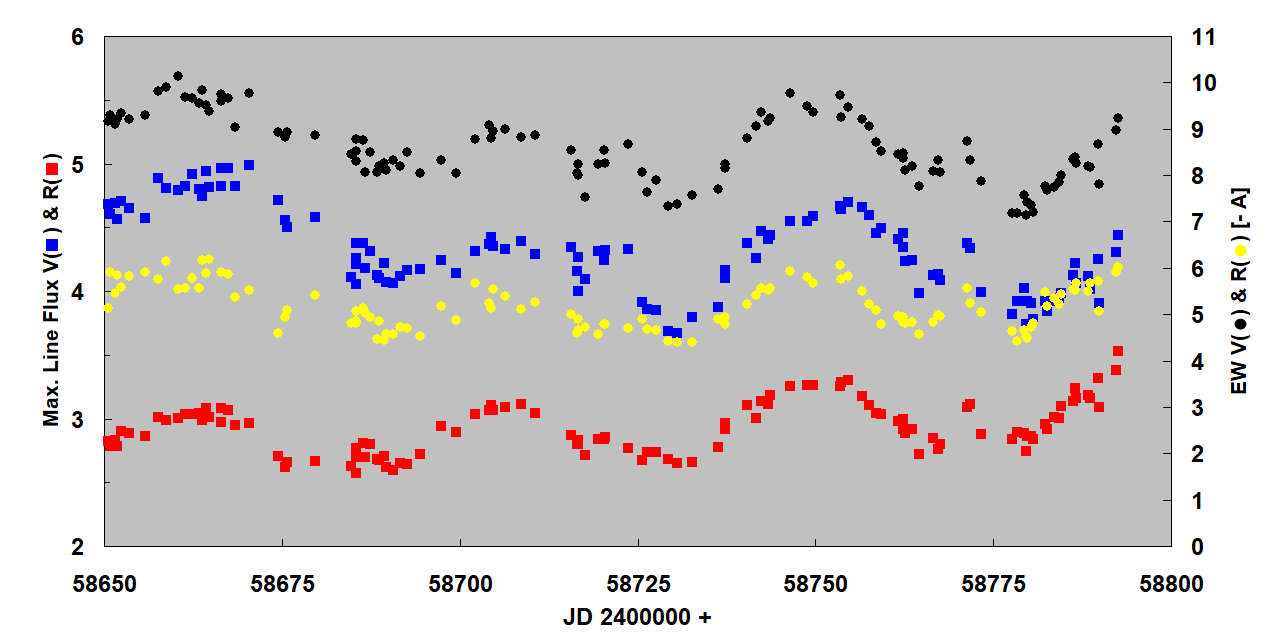

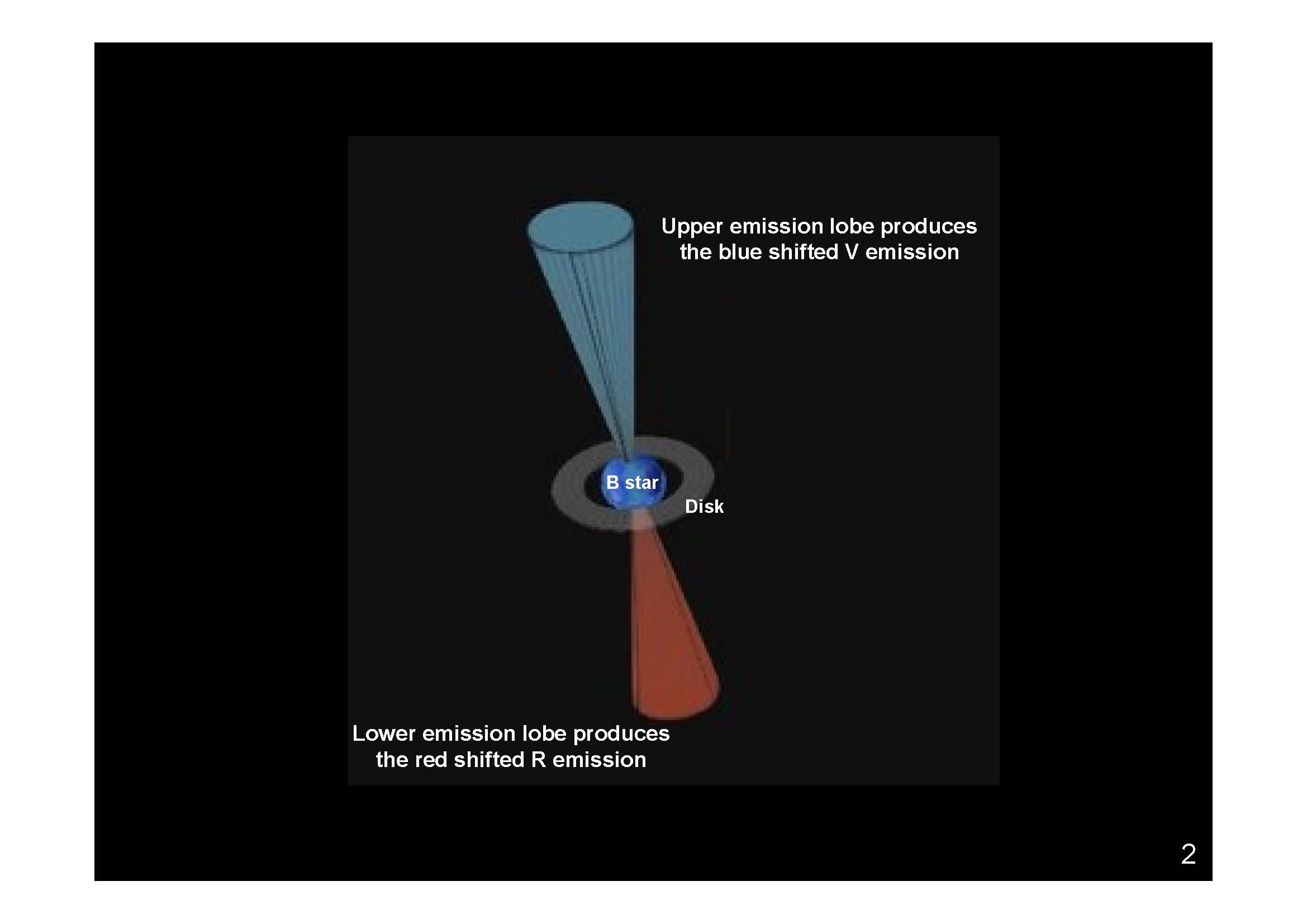

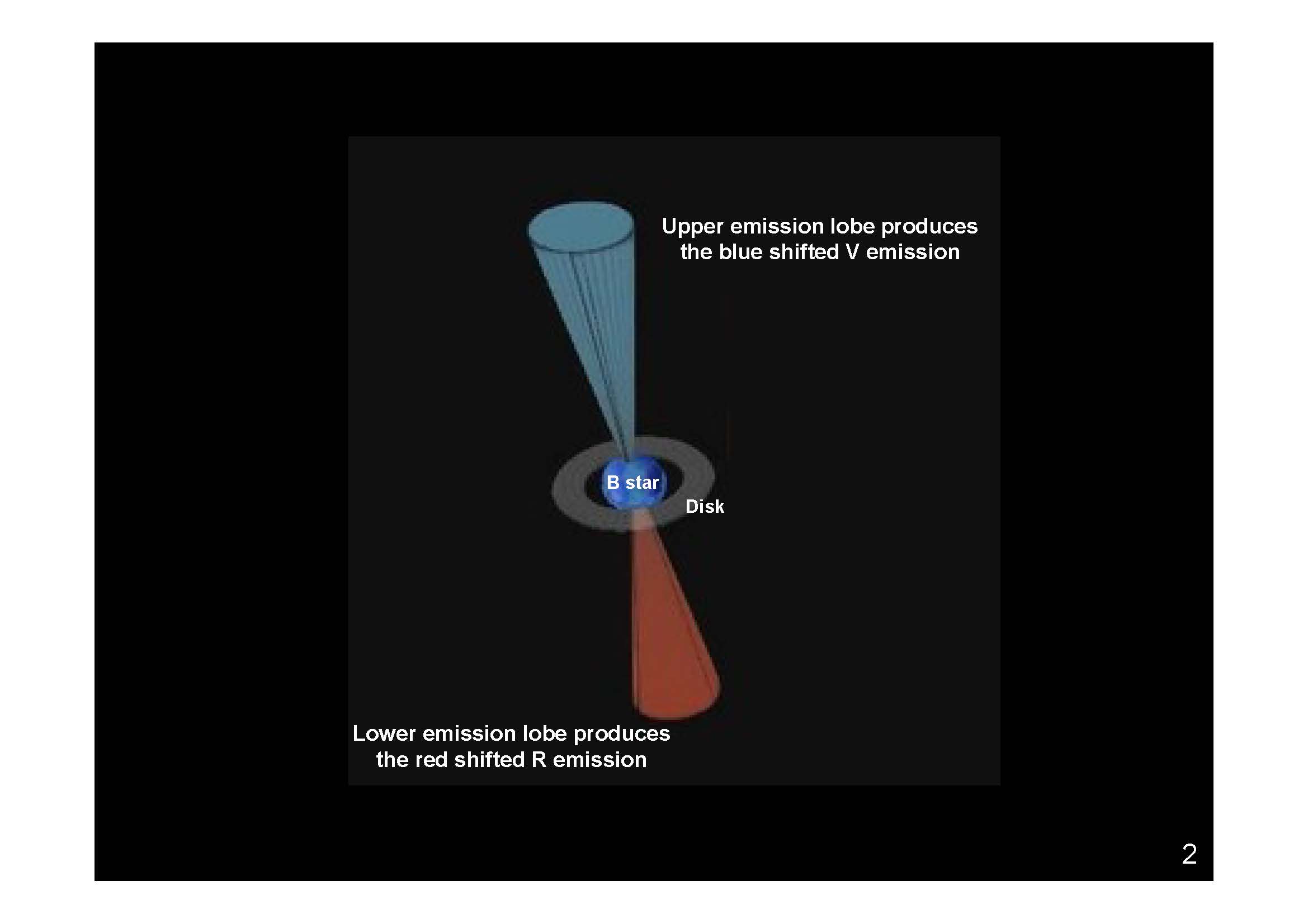

For friends of pretty pictures in spectroscopy:
a "nice overview" of the newly-discovered 43 day period of the both emission lobes above (the blue V emission) and underneath (the red R emission) the accretion disk in VV Cep out of eclipse. To draw this nice Figure was only possible on basis of the high spectra cadence of Carl Sawicki, Al Stiewing, Eric Bryssinck, Jack Martin, Juan Guarro and me. Many thanks to them!!
