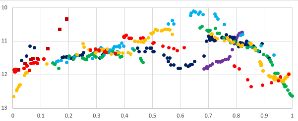

The recent spectra in the database (D. Boyd, W. Sims, C. Boussin, F. Campos) and photometry obtained by David Boyd show that the prototypical symbiotic star AX Per is in strong outburst (V = 10.3)
V mag according to phase (P = 680 days)
Current cycle (brown squares) strongly different from former ones
Classical symbiotic outburst (expansion and cooling of the accreting layer on the white dwarf)

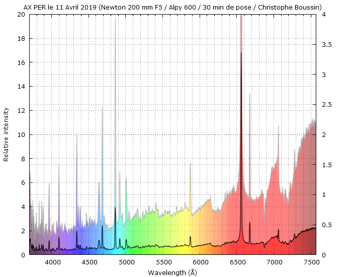

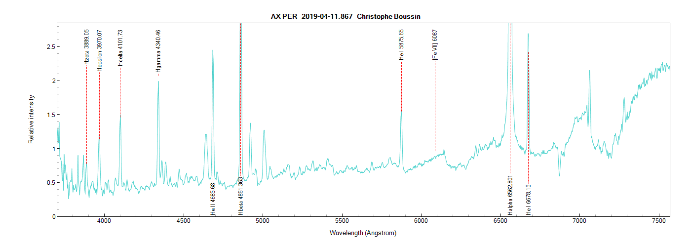

I obtained the following spectrum the 11th of April at 20 h 49 TU with a resolution of 507 (JJ = 2458585.3675) and an acquisition time of 30 min :
AX Per on April 11th, 2019
_axper_20190411_867_Christophe Boussin_3700_7570.png (77.92 KiB) Viewed 12338 times
As an indication, identification of some lines :
AX Per on April 11th, 2019 (identification from PlotSpectra)

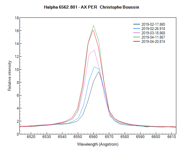

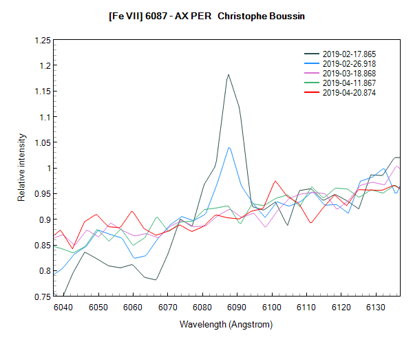

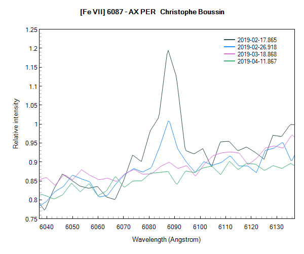

The comparison of my spectra between 17 February and 11 April that shows the disappearance of the [FeVII] line at 6087A :
Fe[VII]6087_axper_Christophe Boussin.png (29.04 KiB) Viewed 12338 times

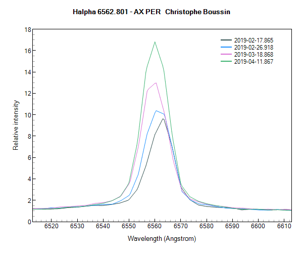

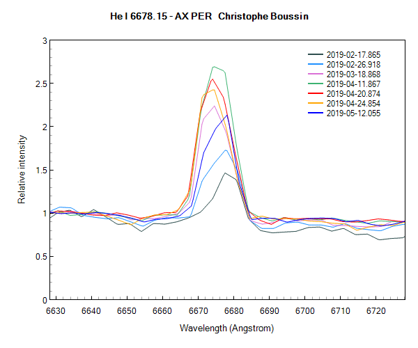

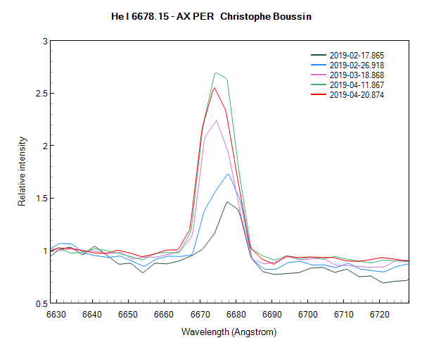

At the same time, for example, the relative intensities of the Halpha line and the HeI line at 6678A increase :
Halpha
Halpha
Halpha_axper_Christophe Boussin.png (27.26 KiB) Viewed 12338 times

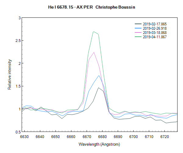

HeI line at 6678A
HeI line at 6678A
HeI6678_axper_Christophe Boussin.png (26.81 KiB) Viewed 12338 times

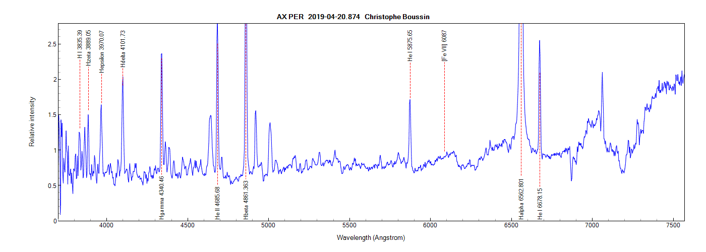

Here is my last contribution to the monitoring of AX Per outburst.

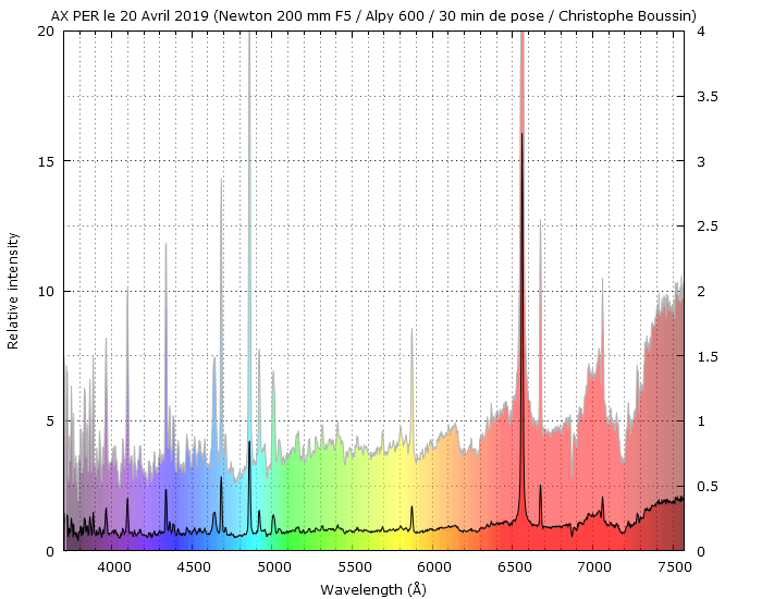

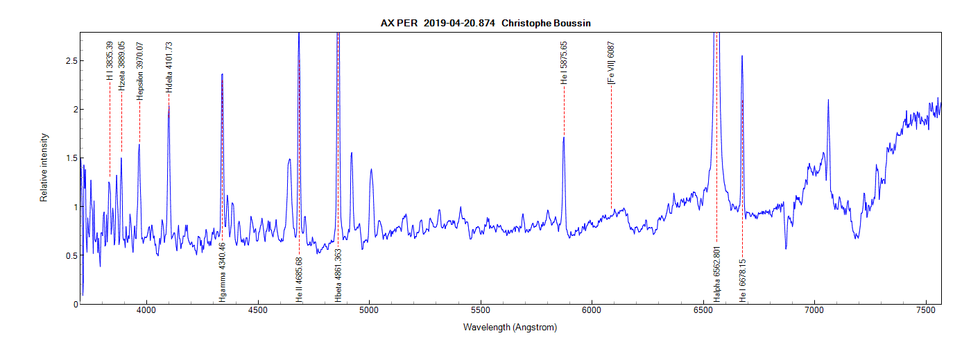

I obtained the following spectrum the 20th of April at 20 h 58 TU with my Alpy 600 (resolution of 505, JJ = 2458594.3738) and an acquisition time of 30 min :
AX Per on April 20th, 2019
_axper_20190420_874_Christophe Boussin_3700_7570.png (80.16 KiB) Viewed 12250 times
AX Per on April 20th, 2019 (identification from PlotSpectra)
As in the spectrum of April 11, the absence of the [FeVII] line at 6087A is noticeable :
Fe[VII] line at 6087A
Fe[VII]6087_axper__Christophe Boussin.png (32.88 KiB) Viewed 12250 times

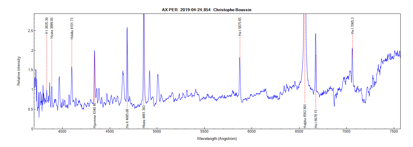

After a cloudy day, I was lucky to see the sky clear again in the early evening on April 24th !
The weather has improved long enough to allow me to get another spectrum of AX Per with a perfectly clear sky...before the clouds came back !

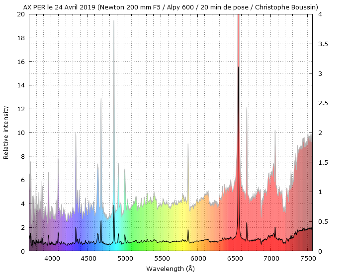

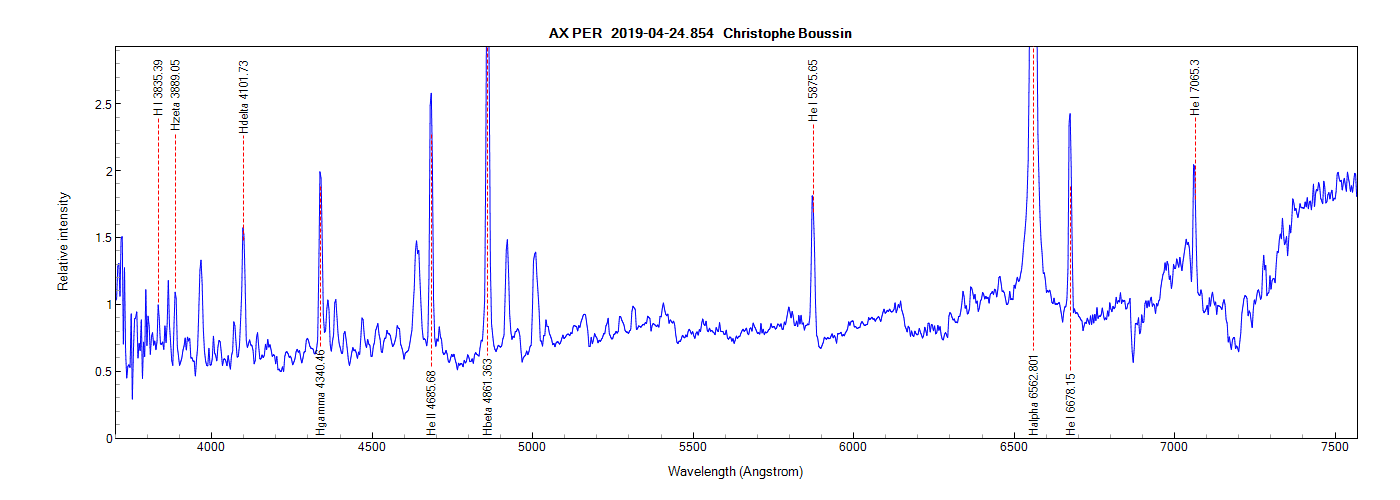

So, I obtained the following spectrum the 24th of April at 20 h 29 TU with my Alpy 600 (resolution of 504, JJ = 2458598.3541) and an acquisition time of 20 min :
AX Per on April 24th, 2019
_axper_20190424_854_Christophe Boussin_3700_7570.png (80.01 KiB) Viewed 12188 times
AX Per on April 24th, 2019 (identification from PlotSpectra)
Clear skies,

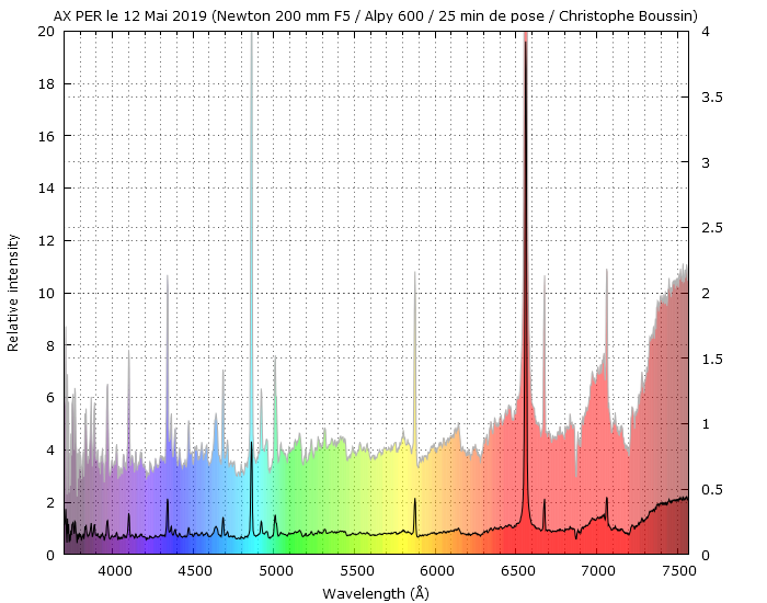

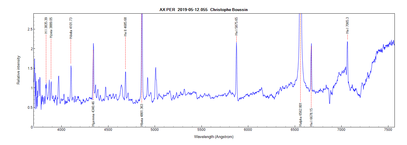

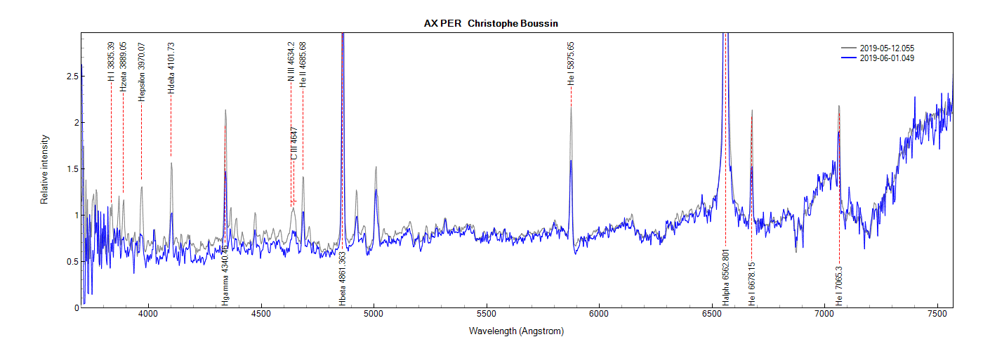

The spectrum below, obtained this morning (12th of May at 01 h 19 TU, resolution 501, JJ = 2458615.5551) with my Alpy 600, is the result of 5 exposures of 300 s each :
AX Per on May 12th, 2019
_axper_20190512_055_Christophe Boussin_3700_7570.png (77.07 KiB) Viewed 12100 times
AX Per on May 12th, 2019 (identification from PlotSpectra)
The relative intensity of the Halpha line is still increasing...
Halpha
Halpha
Halpha_axper_Christophe Boussin.png (35.25 KiB) Viewed 12100 times
...but that of the HeI line at 6678A, for example, seems to be decreasing :
HeI line at 6678A
HeI line at 6678A
HeI6678_Christophe Boussin.png (35.11 KiB) Viewed 12100 times
Does anyone else notice a similar evolution?
Clear skies,

AX Per is now more easily visible in the morning sky, so I was able to resume the monitoring...

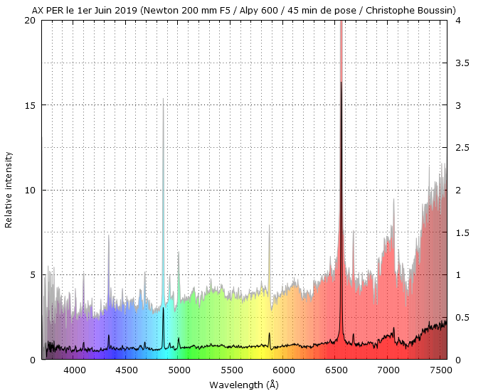

The spectrum below, obtained this morning (June 1st at 01 h 10 TU, resolution 500, JJ = 2458635.5489) with my Alpy 600, is the result of 9 exposures of 300 s each :
AX Per on June 1st, 2019
_axper_20190601_049_Christophe Boussin_3700_7570.png (74.97 KiB) Viewed 11925 times

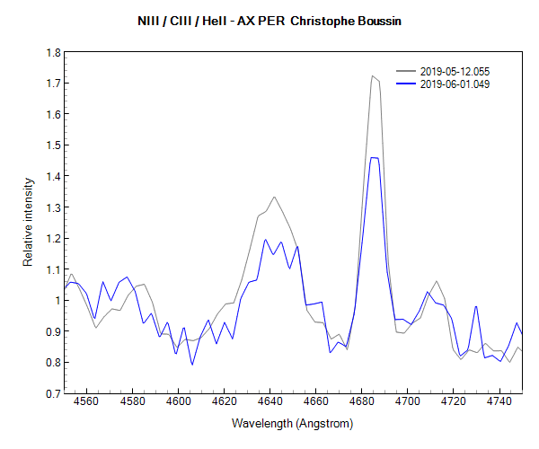

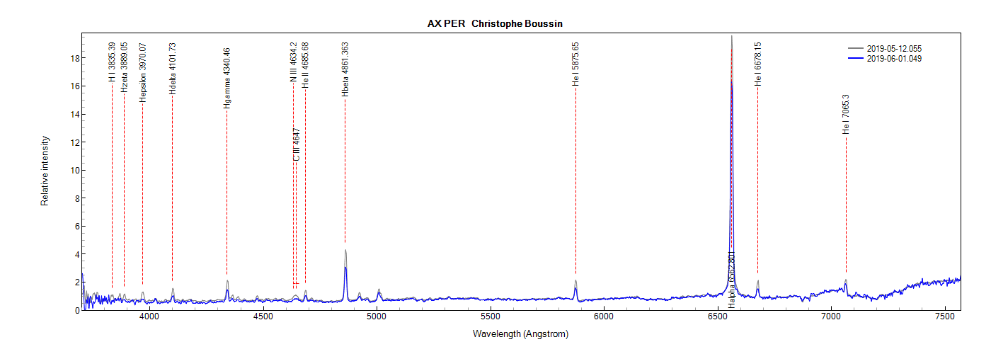

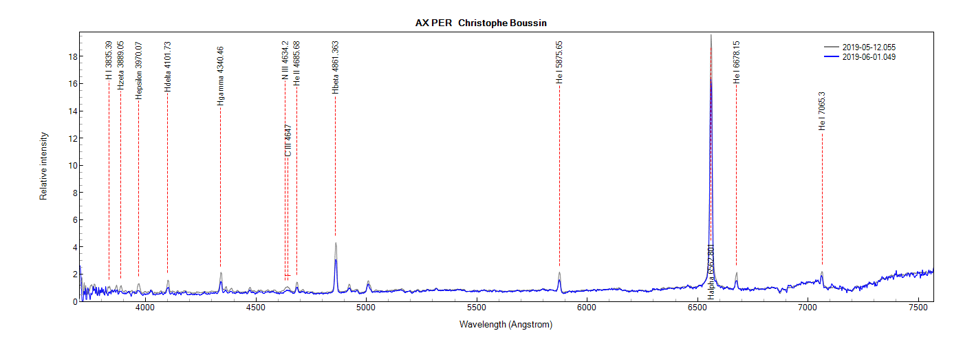

Comparison of the spectra of May 12th and June 1st :
AX Per on May 12th and June 1st, 2019 (identification of some lines from PlotSpectra)
AX Per on May 12th and June 1st, 2019 (zoom)
We can note the decrease of the relative intensities of the spectral lines (like those of the CIII/NIII blend and the HeII line at 4686A) :
AX Per on May 12th and June 1st, 2019 (NIII/CIII blend and HeII line at 4686A)
CIIINIII_axper_Christophe Boussin.png (26.59 KiB) Viewed 11925 times
Clear skies,
Re: AX Per Stong outburst
C'est excellent, Christophe
Cela fait un trou de 2 semaines seulement dans le suivi.
A poursuivre tout au long du déclin, pour voir réapparaître [Fe VII]
