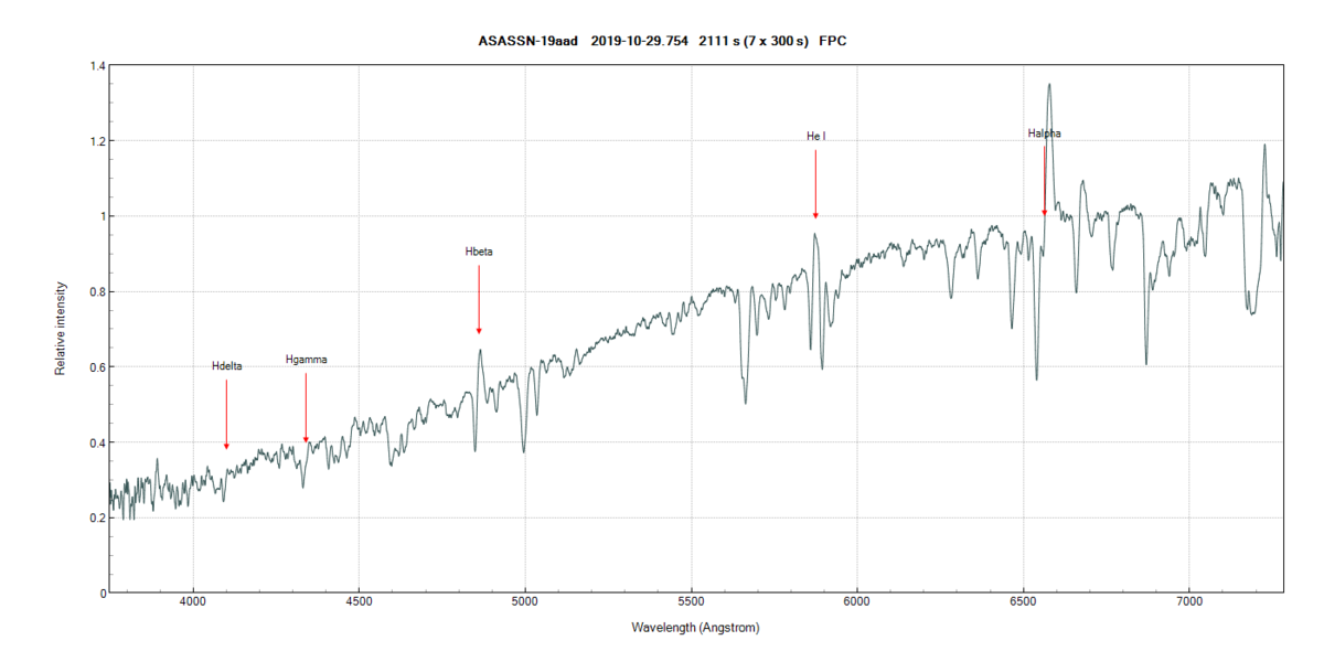

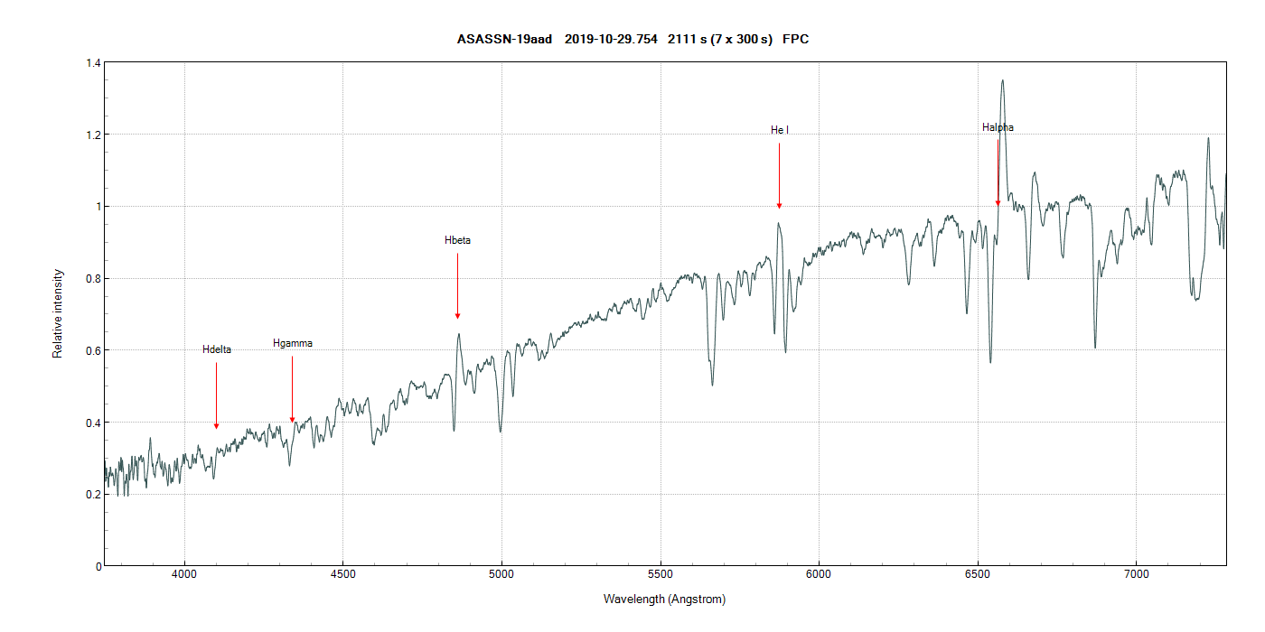

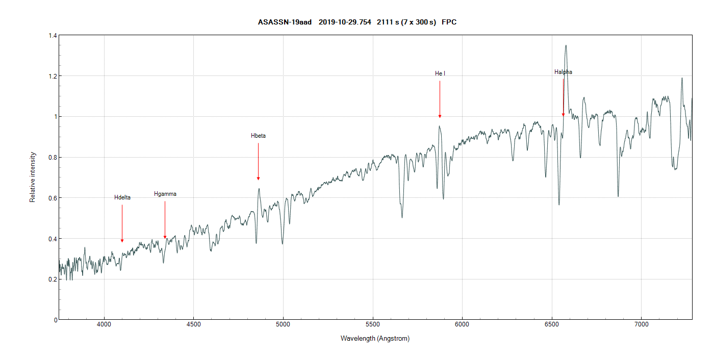

I have received an alert about ASASSN-19aad as a possible reddened nova. Here is a spectrum taken "in extremis" before the star went out of vision, Very strange, this spectrum.
Star was about mag. 9 yesterday, the day of discovery.

- Posts: 1562
Re: ASASSN-19aad, possible nova
Congratulations for this excellent spectrum
Very red continuum.
The opacity is strong
You have also He I 6678

- Posts: 1562
Confirmation
ATEL #13241 ATEL #13241
Title: Spectroscopic Classification of AT 2019tpb/ASASSN-19aad as
a Galactic Nova
Author: S. C. Williams (Turku), M. J. Darnley (LJMU), M. W. Healy
(LJMU), F. J. Murphy-Glaysher (LJMU), C. L. Ransome (LJMU)
Queries: s.williams7@lancaster.ac.uk
Posted: 29 Oct 2019; 20:53 UT
Subjects:Optical, Nova, Transient
We obtained a spectrum of the transient AT 2019tpb/ASASSN-19aad (TCP J18395972-1025415;
see also <a href="http://www.cbat.eps.harvard.edu/unconf/ ... html">CBAT
TOCP</a>) with the FRODOSpec spectrograph (resolution R ~ 5400; <a href="https://ui.adsabs.harvard.edu/abs/2012A ... ">Barnsley
et al. 2012</a>) on the 2-m Liverpool Telescope (LT; <a href="http://adsabs.harvard.edu/abs/2004SPIE. ... 9S">Steele
et al. 2004</a>) on 2019 Oct 29.81 UT.
The spectrum shows Balmer lines, which exhibit P-Cygni profiles. We measure
the maximum velocity of the Hα absorption component to be ~1500 km/s.
We also find lines from He I (6678, 7065Å) and O I (7773Å)
at the red end of the spectrum, which also all show P-Cygni profiles. There
are numerous lines blueward of Hβ, mainly absorption lines, although
some may have weak emission components. Our spectrum of AT 2019tpb also
shows absorption lines originating from N II and C II.
This spectrum shows that AT 2019tpb/ASASSN-19aad is a Galactic nova in
the early stages of eruption.

great spectrum!

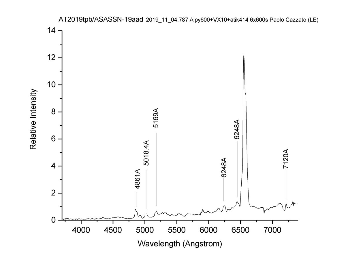

Paolo Cazzato
- Posts: 7
- Joined: Sat Nov 14, 2015 10:58 am

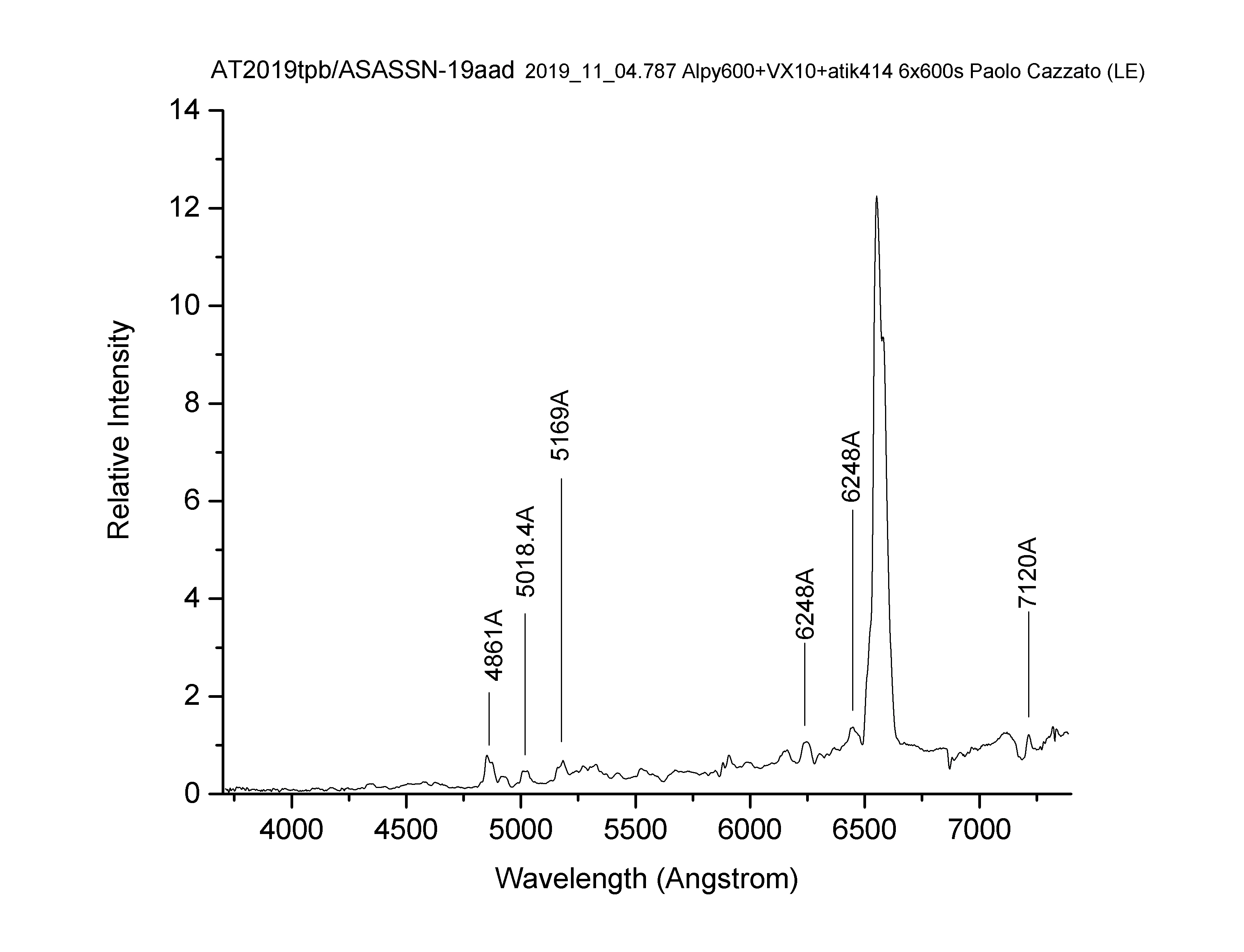

Hallo everybody,
here my last spectrum of ASASSN-19aad taken yesterday evening.
The profile evolved over the days showing a very broad and pronounced H Alpha emission line. In my low resolution spectrum we can see also weak emission lines as FeII (5018.4 A, 5169 A, 6248 A, 6456 A) and maybe a CII line at 7120A.
I hope the weather conditions will improve next week.
Finger crossed
Finger crossed

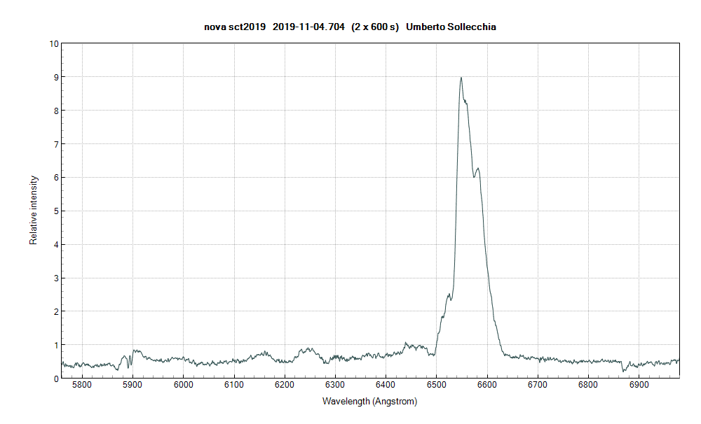

- Posts: 247

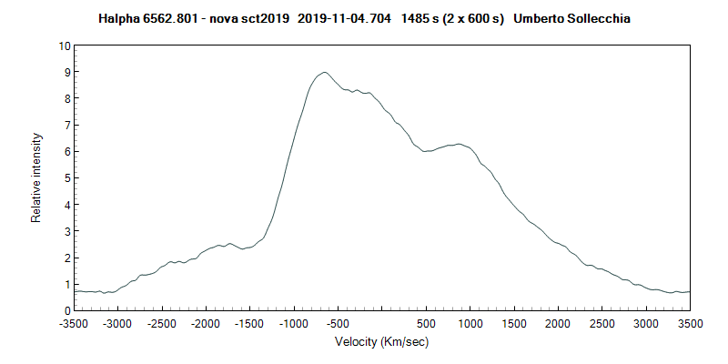

Bonsoir, voici le profil de la nova observée le 04.11.2019 dans les nuages.
vitesse radiale
vitesse radiale

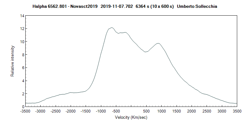

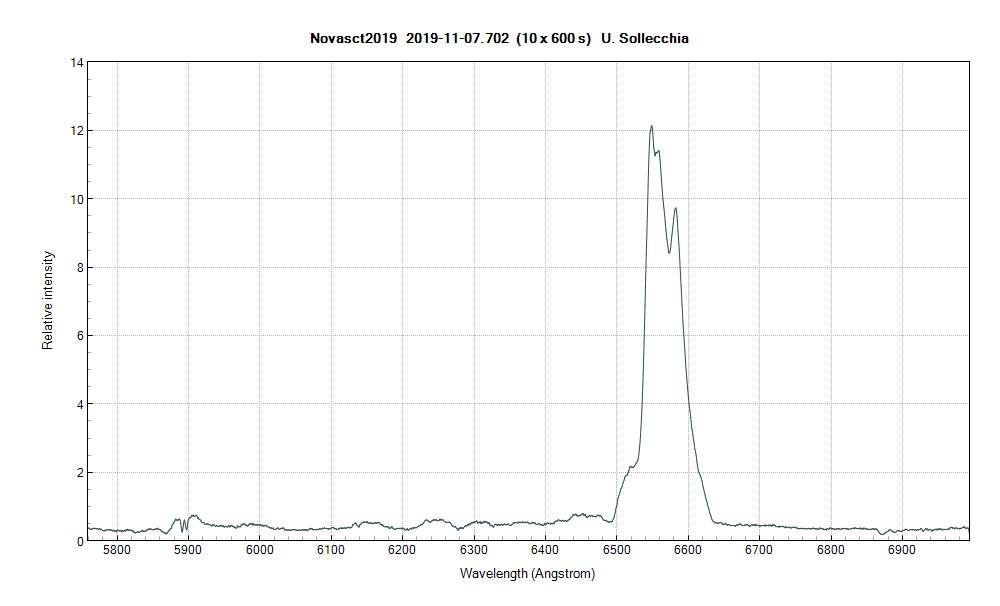

- Posts: 247
Bonsoir à tous, ce soir le temps a permis une excellente observation de cette nova qui va prendre sa retraite. Placez le profil et le graphique du V.R.
Viresse radiale
Viresse radiale

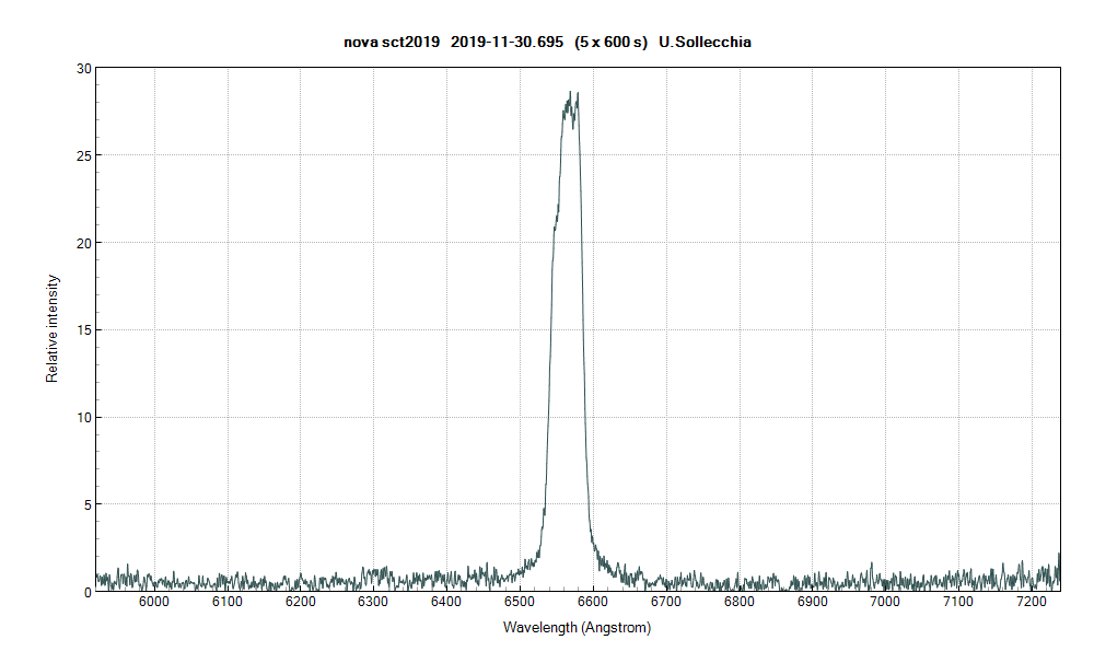

- Posts: 247
Bonjour à tous, très difficile à observer de mag.13, peut-être maintenant dans la phase nébulaire, fixée environ une heure après le coucher du soleil. Ma tentative a été faite le 30/11/2010 avec la grille de 600l / mm et un horizon sans nuages, une vraie fortune avec ce temps!
Vitesse radiale
Vitesse radiale
