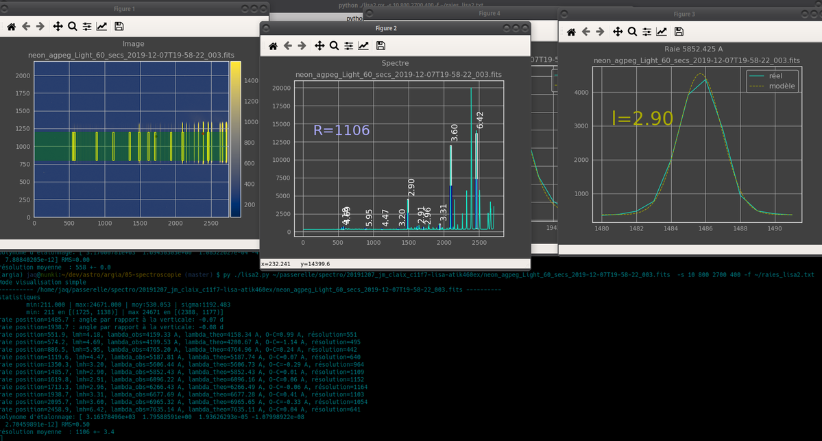

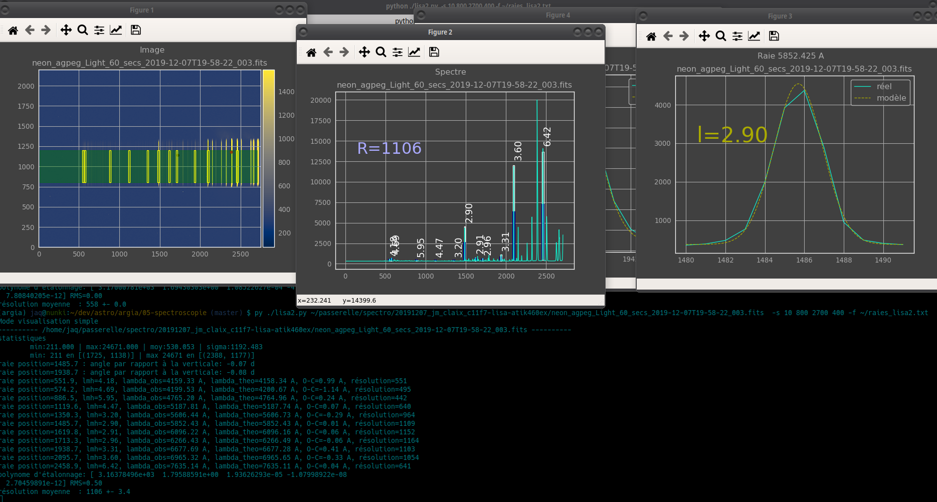

As spectrometers need to be fine-tuned, a 'live-tuning' module may be quite helpful in Demetra.
For instance, for slit spectrometers, such a module would help to adjust precisely the output lens to make some lines of the calibration lamp as thin as possible. As the Demetra software already includes an acquisition and a calibration tools, I think that this would not be too complex to develop. To show what I am thinking of, attached is a screenshot of the outputs of a small piece of code I have written in that purpose to adjust my Lisa spectro.
Some other adjustments may be relevant, too, but I am not familiar with all Shelyak spectrometers.
Well, that's just an idea.
Best regards,
Jacques
Exemple d'aide au réglage d'un Lisa
Francois Cochard
Posts: 39
Joined: Fri Sep 30, 2011 2:30 pm
Re: What would you like to see in Demetra ?
Post by Francois Cochard »
Hello Jacques,
This is a good idea!
We started something long time ago, to help focusing the Alpy 600 ; this is still to be improved.
But the LISA focusing way is very different: we do it on the calibration light.
Well... I put this in the list, and we'll see what can be done.
Anyway, making tools to help the tunning of the instrument is exactily in the "Demetra spirit".
Friendly,
